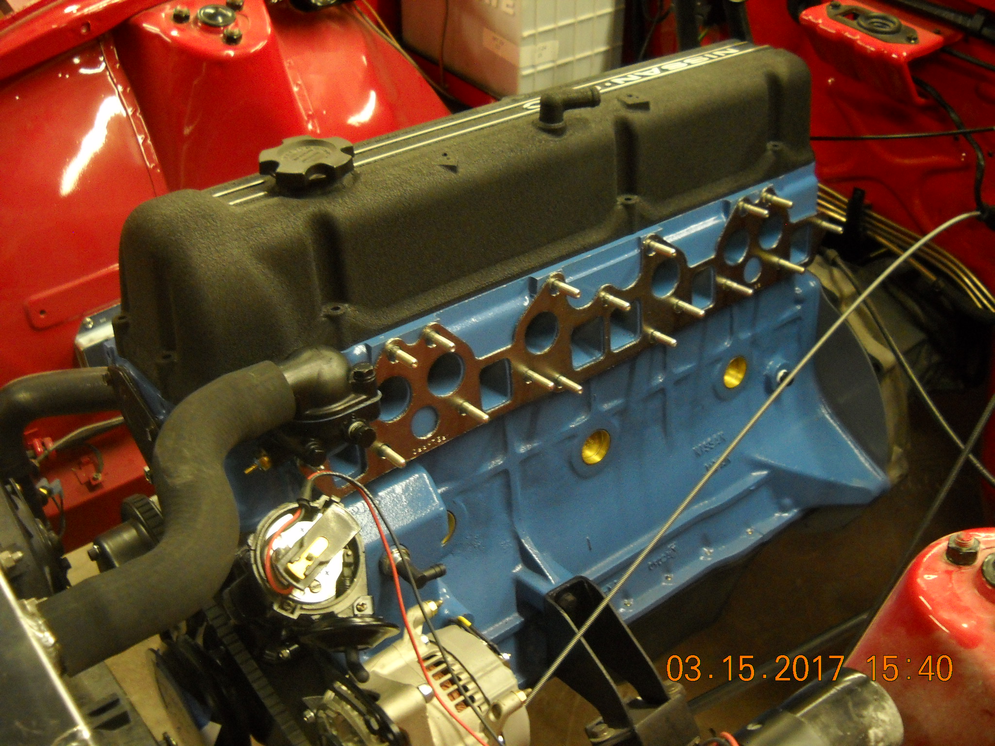

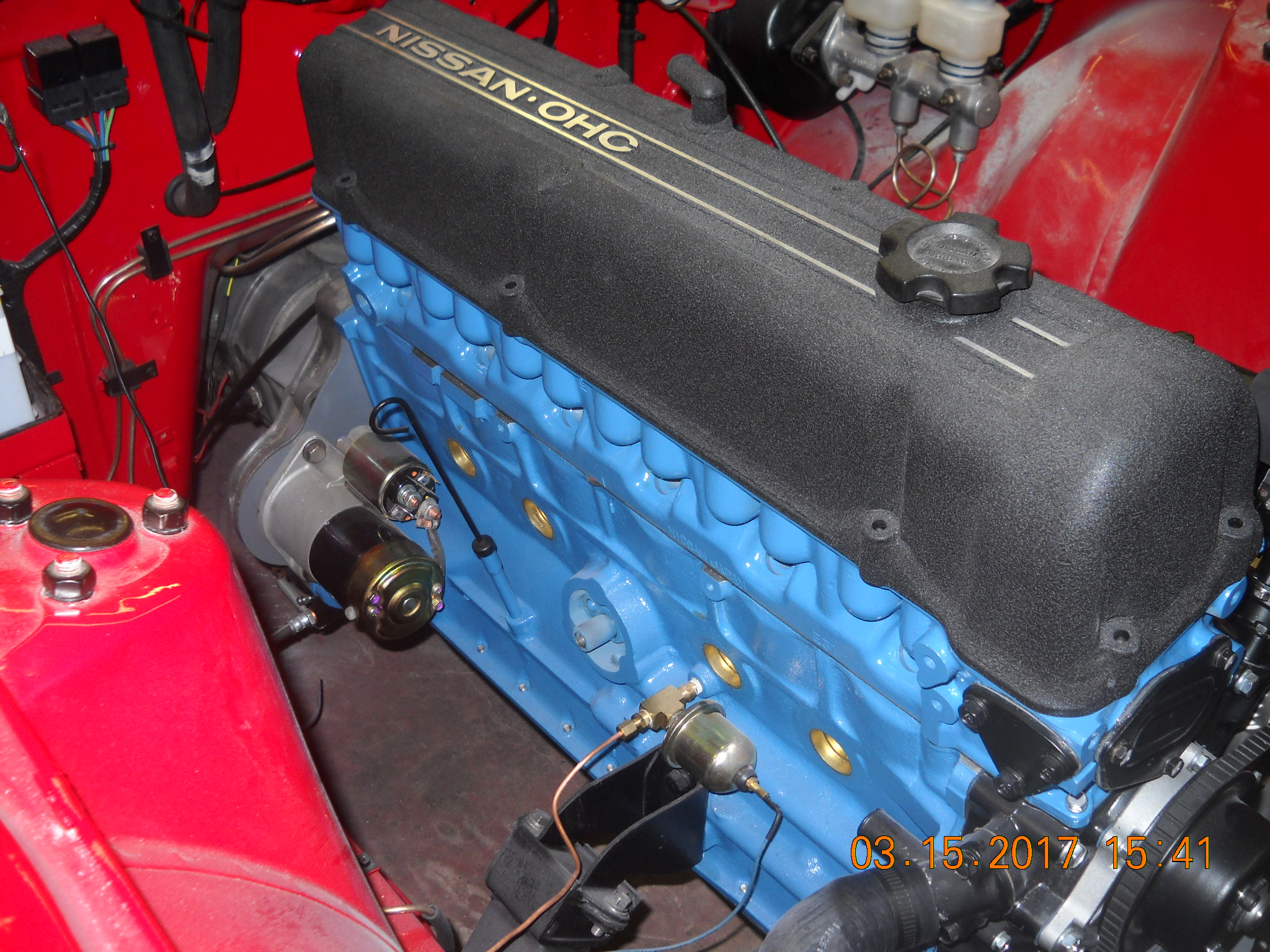

its been a good week to be sweaty! valve spring shims came in yesterday, and i got all the springs within .009 of the specs. so with that done...........
the head is finally on the block. i ordered lash caps today, and should have the exhaust system done this week end. hoping for a start-up by the following week-end. i cant wait to hear that camshaft  :victorious:
today was a great day to be sweaty!!
msa exhaust came yesterday. got the header wrapped and the rest of it installed today. this is just the basic system and everything fit just like it should. here is a pic with the O2 bungs and pcv bung welded in
header wrapped and intake installed
carbs and air cleaners on. all im waiting on is lash pads and it'll be ready to fire up
