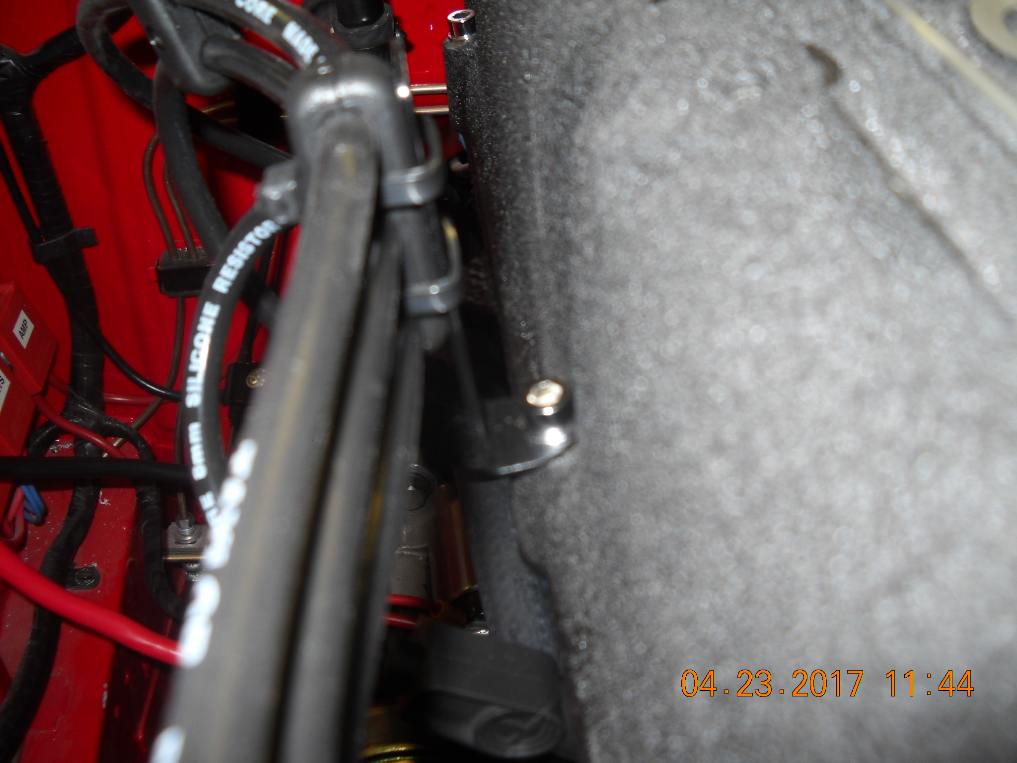

April 23, 20178 yr Author comment_518900 22 hours ago, dmorales-bello said: Great job on the wire routing. Are the wire holders fixed onto the valve cover somehow? thanks. basically, i made an angle with a hole in the short side that the valve cover bolt goes through, then i zip tied the separators to the angle. the angles are maybe 3" on the long side, 1" on the short side and 3/4" wide Link to comment https://www.classiczcars.com/forums/topic/52787-sweatys-rebuild/?&page=23#findComment-518900 Share on other sites More sharing options...

April 24, 20178 yr Author comment_518964 here is a close-up of the bracket t Edited April 24, 20178 yr by sweatybetty Link to comment https://www.classiczcars.com/forums/topic/52787-sweatys-rebuild/?&page=23#findComment-518964 Share on other sites More sharing options...
