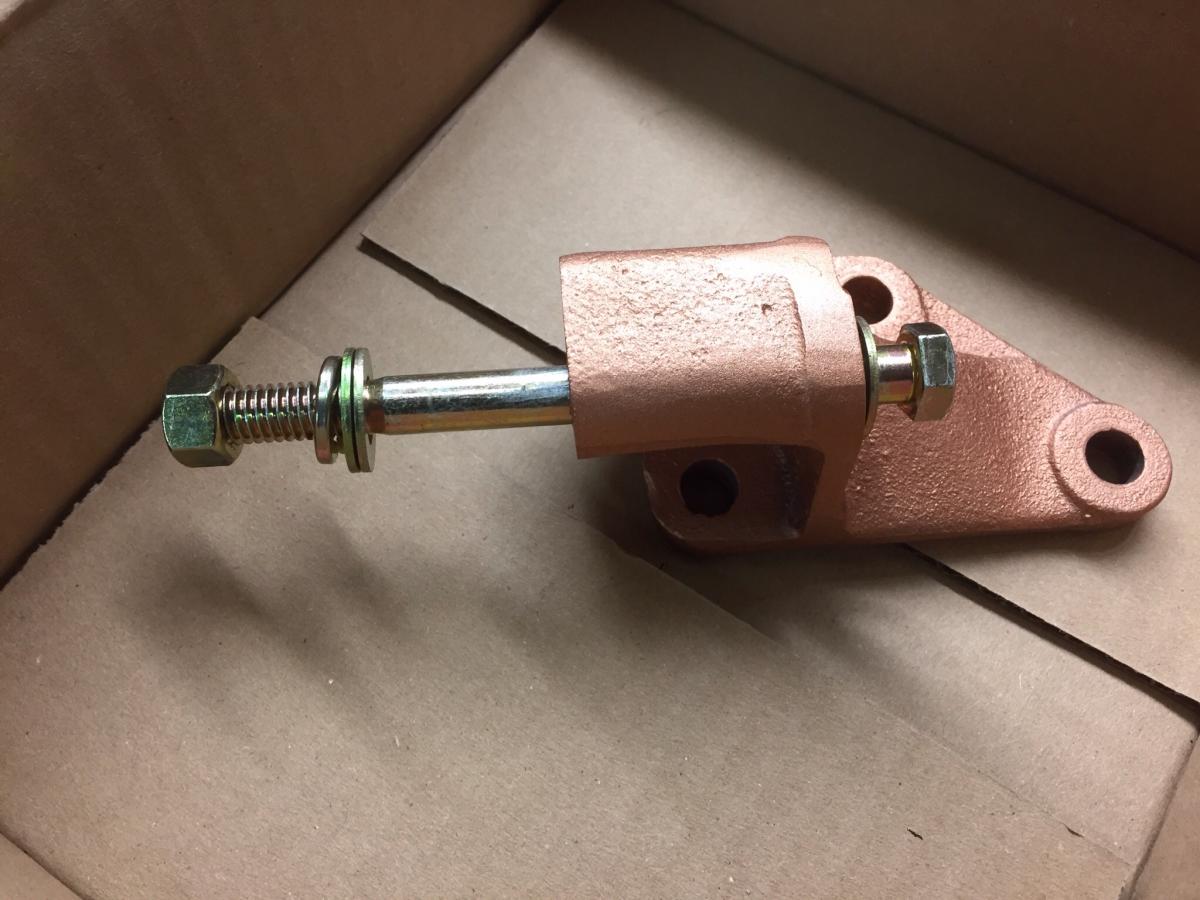

Got a couple made up and one sent out to a member
Degreased, sand blasted, machined and drilled, copper bearing weld thru primer applied (all I had for primer handy, looks real 70's).
Includes a 4.5" x 3/8 NC GR 8 bolt and plated hardware including two nice thin spacer washers to get the pulley alignment just right.
$35 USD + price of a stamp.
