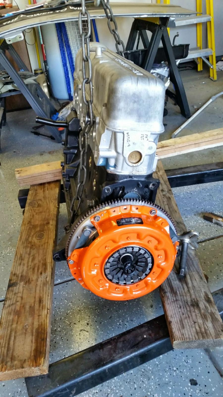

I have a fidanza aluminium flywheel with a centerforce II clutch running on the larger (240mm) flywheel size .  Clutch operation feels great and i called centerforce to get their recommendation which was this clutch.  I dont have many miles on it but it feels good so far.
The first pic is the flywheel with clutch attached.  Also be sure to check the length of the bolts holding your starter in.  This may have just been my car but the stock looking bolts were too long and interfered with the new centerforce clutch.  The clutch rotated but the whole motor made a clunking sound that resembled a broken crank or some horrible dead-motor sound.
