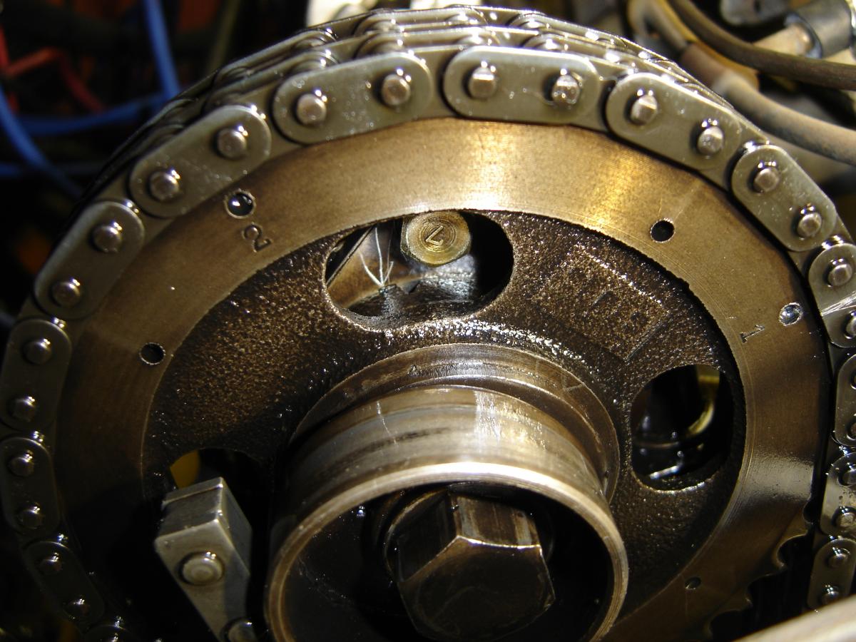

Have you looked at the cam sprocket marks?  It'll show retarded or advanced mechanical timing.  Maybe you can move the cam sprocket to the next number and get closer.  Timing chain stretch and guides that are worn causes slack in the chain making it retarded, like me.

Infoformation on what it means,
http://atlanticz.ca/zclub/techtips/timing/mechtime.html
Ok got it all timed correct ever thing is lined up and runes good but only thing is the engine squeeks some times when reving it
