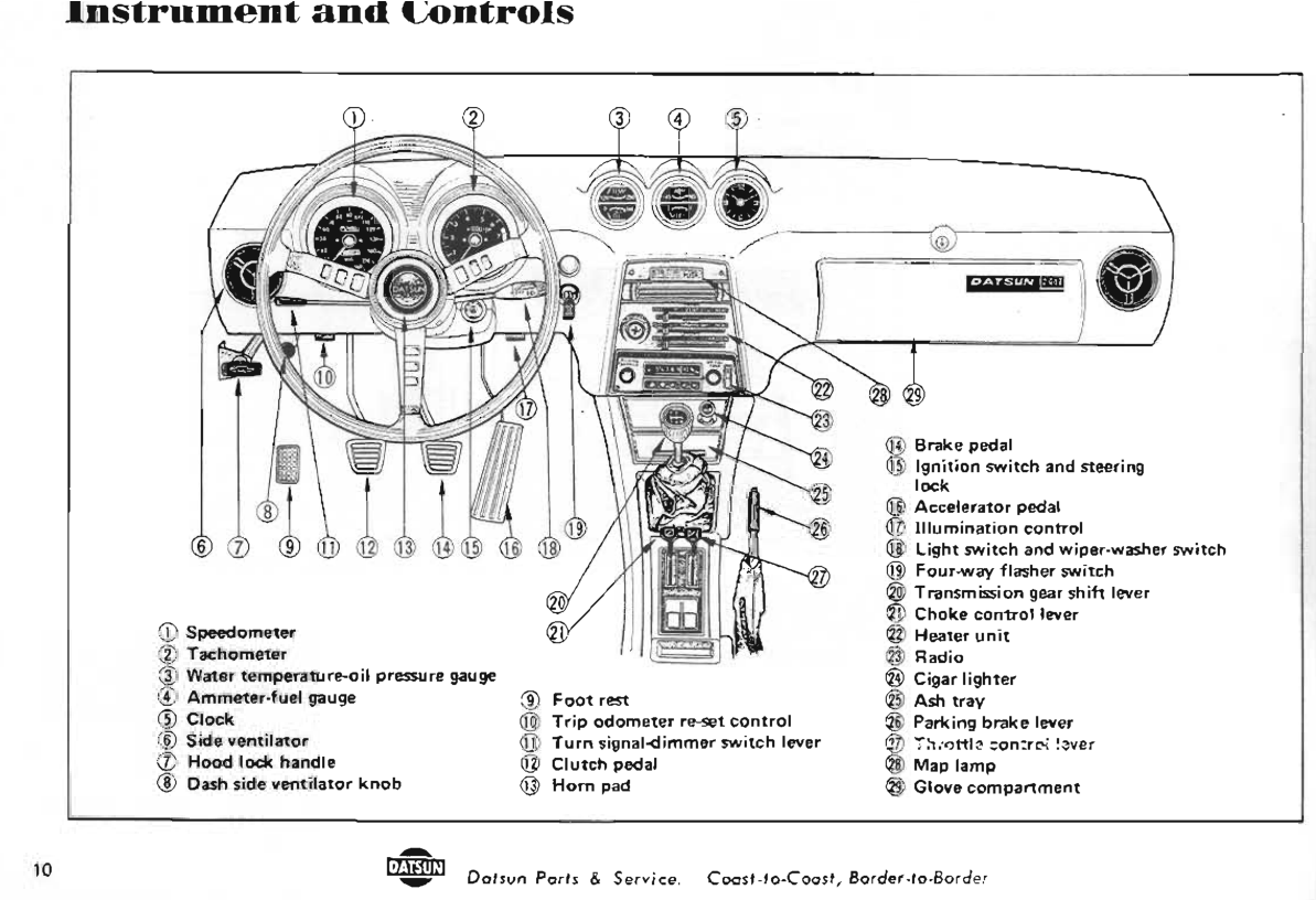

According to the manual there's an adjustment for the parking brake. Looks a bit tricky, though.
