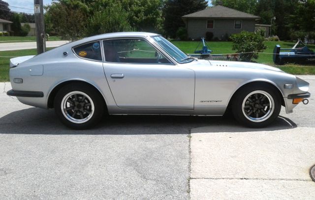

August 5, 20178 yr comment_527431 This is mine with Vogtland springs and KYB shocks. Front shock travel is short. Link to comment https://www.classiczcars.com/forums/topic/51969-vogtland-springs/?&page=6#findComment-527431 Share on other sites More sharing options...
August 5, 20178 yr comment_527438 I like the stance Lumens. I have a 280 and need to replace the springs and struts. So the search is on. Link to comment https://www.classiczcars.com/forums/topic/51969-vogtland-springs/?&page=6#findComment-527438 Share on other sites More sharing options...
