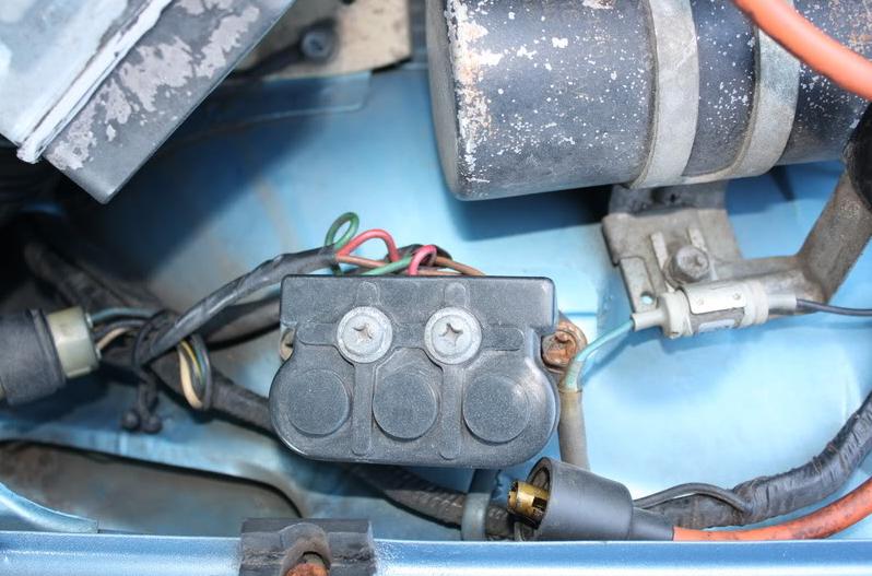

July 12, 20159 yr comment_473690 Here's the module on a '77, thanks Blue. Passenger's side, left of the fuse panel. Link to comment https://www.classiczcars.com/forums/topic/51762-to-dream-the-impossible-dream-redwings-z-cars/?&page=8#findComment-473690 Share on other sites More sharing options...

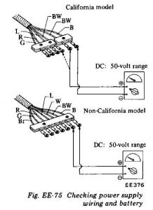

July 12, 20159 yr comment_473691 Jai has a 1976 model which had two versions for the TIU (Transistor Ignition Unit). The californian model looks just like Siteunseen's photo and the federal version will have an aluminium casing with cooling fins. The federal version also have dual pick-up in the distributor. The FED used a D6F4-01 & 02 dual pickups for manuals an automatics. The auto had 2° more advance when hot. The Cal version was D6F4-03 singel pickup. There are a couple of ways to tell them apart. 1. If you look at the terminal block next to the coil. The FED models have 4 wires coming out of the distributor (2x Green, Red and Brown) and the Californian has two (Red and Green) 2. The TIU in the FED model has a one piece terminal 7 wires going to the TIU. The californian model has a two piece terminal block and 6 wires, See photo Siteunseen post #95. A photo of either will tell which type of system it is. BTW: I starting to loose track of what it happening with the starting issues. A lot of posts in a short time. I assume its starting and running until it gets hot then stops and will not start/run which sounds a lot like a failing TIU. Cooling it is a good test. Cool packs will work, but they take a while to remove the heat. I removed the cover on mine and mounted it back in position without the cover. When it stopped I could spray the circuit board with electrical contact cleaner and let it evaporate to cool it quickly. It started straight away after that. Link to comment https://www.classiczcars.com/forums/topic/51762-to-dream-the-impossible-dream-redwings-z-cars/?&page=8#findComment-473691 Share on other sites More sharing options...
