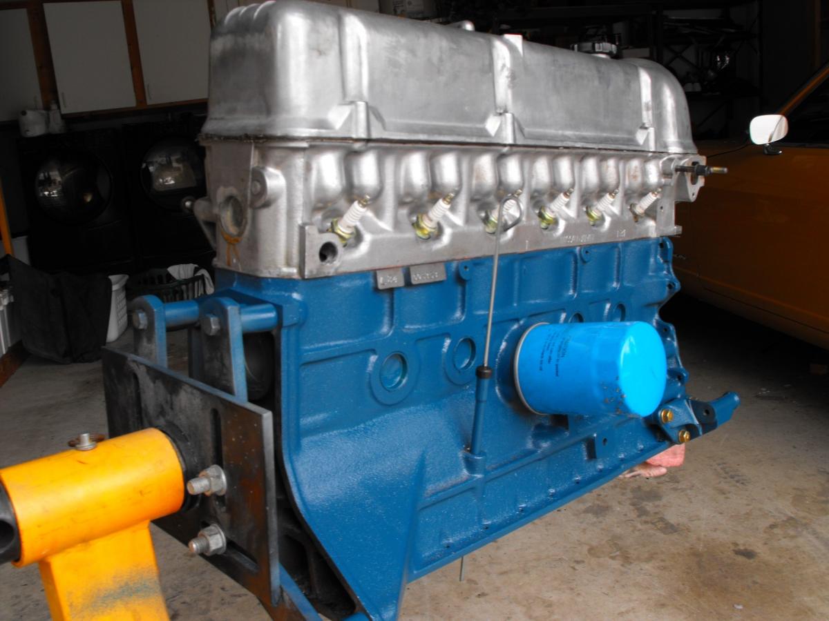

Got this reply from the California Datsun
We reproduced this color from a Genuine Nissan painted NOS alternator arm that was never subjected to weather or abuse. Much of the shade has to do with the primer and prep work put into it also.
 Your engine has 45 years of heat, dirt and road grime and that color is faded over the years. We have sold hundreds of these cans over the last several years without a single complaint. Our engines have won national z car conventions with that shade of blue green. In addition we paint 90% of every engine we sell in that color.
Nissan/Datsun had also been known to use a variety of shades from the factory too, so there is not real correct answer to the correct shade, I would not loose sleep over it.

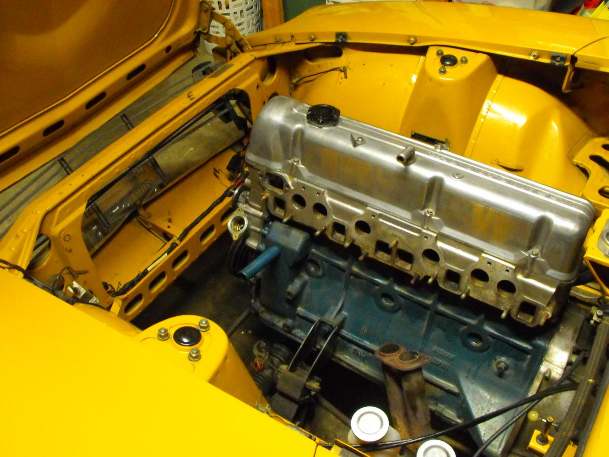

Yet, this is the image I have that was taken of the engine as it came out:
should I buy from Banzai? this colour is too dark. yet, the alternator bracket has the darker colour on it as well, for some reason...

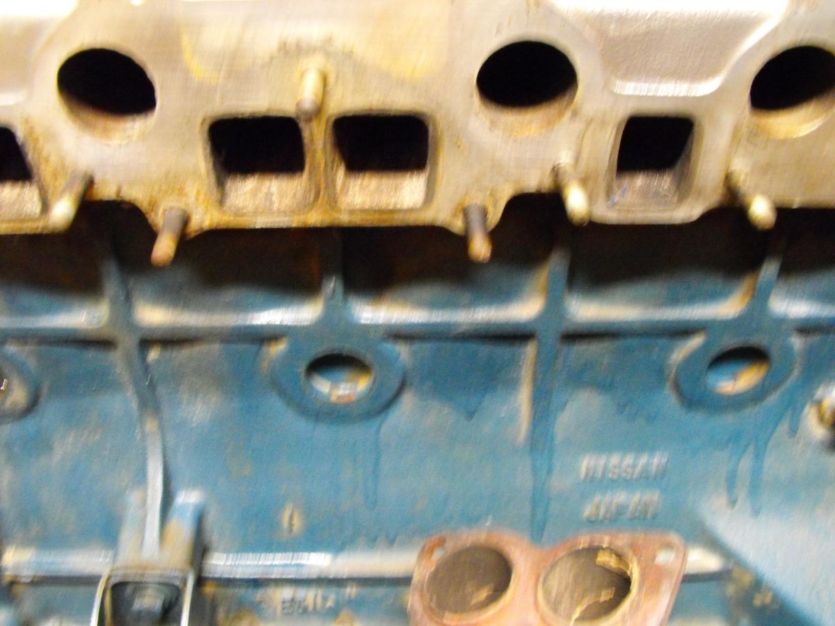

I'm 2nd owner of 9/70 built Z that's very original. I'll be pulling the engine in next month or two. I already have alternator and smog pump (CA car) off. I can try to get some photos tonight that show the color of the brackets and block for comparison to yours.
Attached are pics of my original 4/70 motor complete with factory drips.  Attached is the repaint with paint from Classic Datsun Motorsport.  I think it is a very good match.

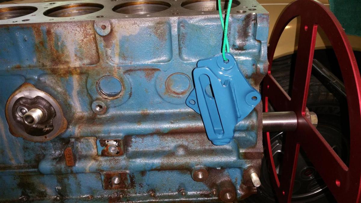

What djwarner said regarding cameras has also been my experience. The color correction of the monitor you are using matters too. The photo I have attached shows my original 24k mile block from my 72 240z. Hanging with it is a bracket I painted using the Classic Datsun Motorworks aerosol paint. Live, the block and the bracket look to be the same color and darker than this photo shows up on my monitor. The key difference between my block and the bracket is the gloss on the newly painted bracket vs the 43 year old paint on the block. Hope this helps.
post-7021-0-76684000-1435250394_thumb.jp
You bring up an interesting point. The finish will change the appearance of the color. I wonder if the original blue paint was satin or matte finish. That could explain the difficulty matching the color. I don't remember a gloss finish on my original Zs' engine, but it was 2 years old when I got it.
