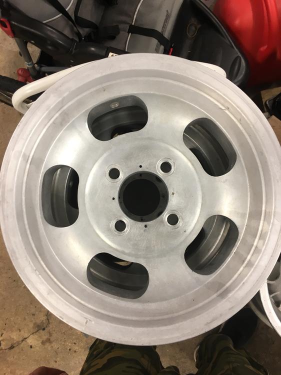

 Post a pic of the wheels. Back in the day the aluminum wheels often didn't use tapered lug nuts. The slotted U.S. aluminum wheels that were on my 71 used a straight lug nut that fits into a hole in the wheel.

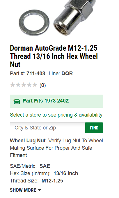

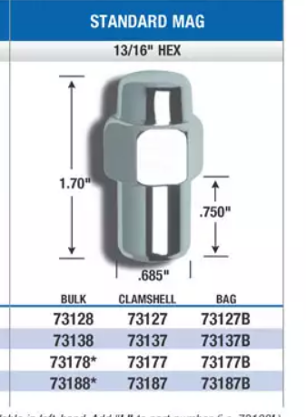

Looks like OReilly also carries a Dorman lug nut.  They show the size as correct for a 240Z.  SAE/metric hybrid.  You could go down and buy a single one just to check.  Pretty sure that's the size.
https://www.oreillyauto.com/shop/b/tire---wheel-16779/lug-nuts-and-studs-25062/wheel-lug-nut-12670/835b5ec42d53/1973/nissan/240z?prodAttr_10648=M12-1.25&prodAttr_10633=Mag

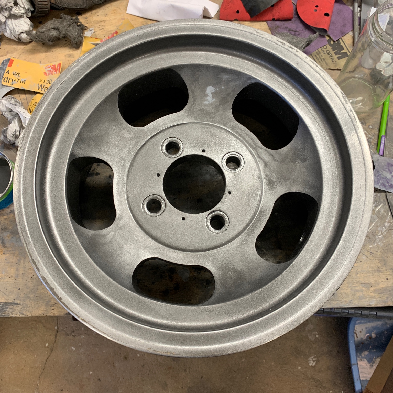

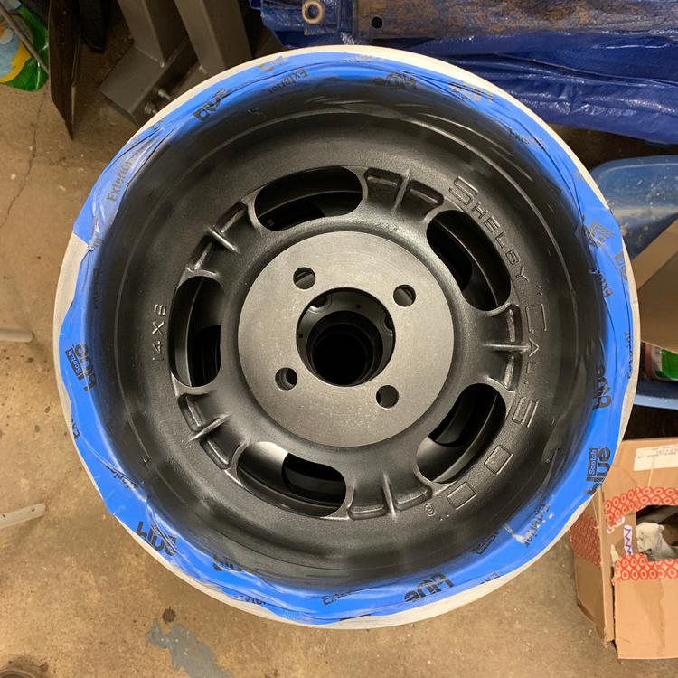

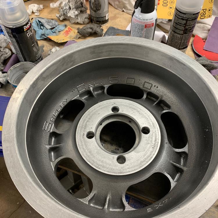

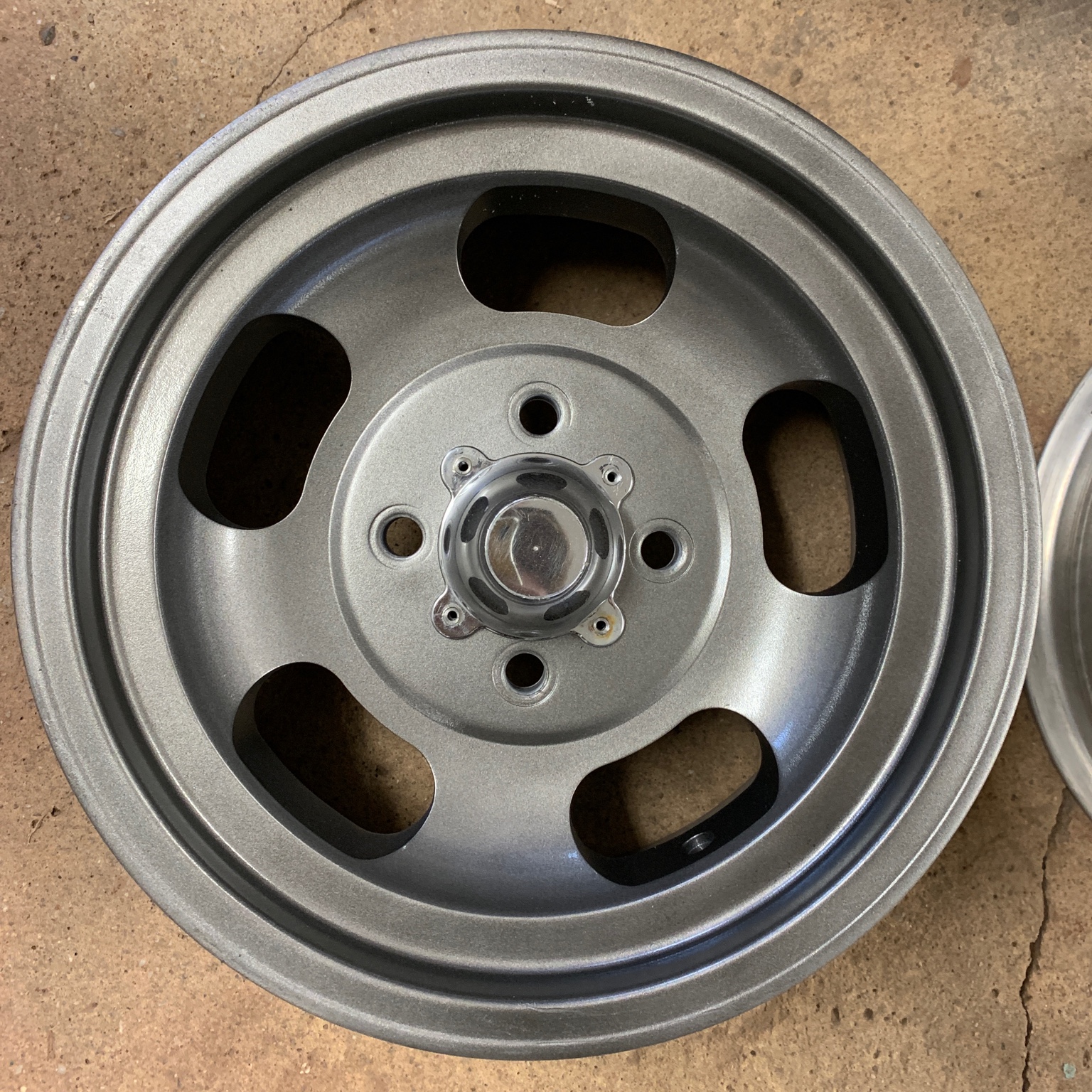

Yeah, I think I’m going to have to open up the lug holes on the wheels somehow. This is the closest thing.

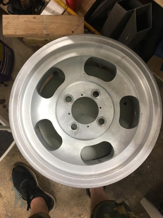

 Dug out one of my previously mentioned U.S. wheels. The holes measure 5/8" and have no taper at the top, just the indent for the washer. What is the hole size on your Shelby's and is there any taper at the top of the hole?

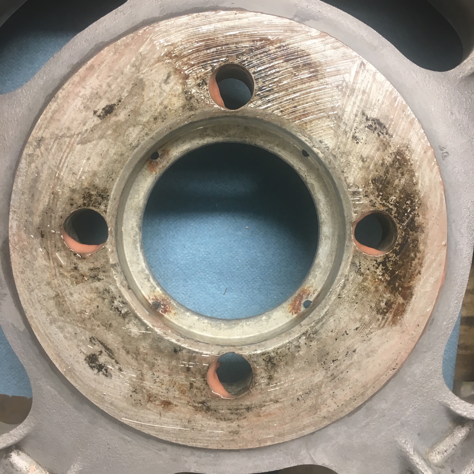

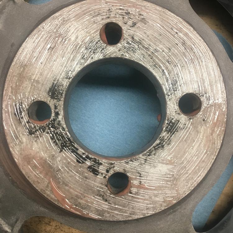

When I was trying to find lug nuts for my old aluminum wheels, I had a little trouble getting an accurate measurement number for the hole diameter. Seemed the hole diameter as measured at the front face of the wheels was smaller than the hole diameter at the back side. But the holes were never meant to be tapered, so wtf?
Under magnification, the issue became clear... All the years of lug nut tightening by previous owners had extruded the aluminum at the wheel face a little bit and actually squeezed a metal ridge into the lug hole. So when I measured that hole at the front, I was actually measuring the diameter inside that burr. But the diameter at the back side (with no burr) was the accurate measurement.
So I'll second Zed Head's mention of a round file. On mine, some quick work with a fine round file to remove the burr and my lug choice went up dramatically. Hopefully that's what's going on with yours as it was an easy fix.
 The Cap'n scores again. I checked for a bur on mine, not feeling one I measured 5/8" on the face side. Well just to make sure I just measured the backside. Sure enough, 13/16". No wonder the lugnuts got more difficult to install after twenty years.
