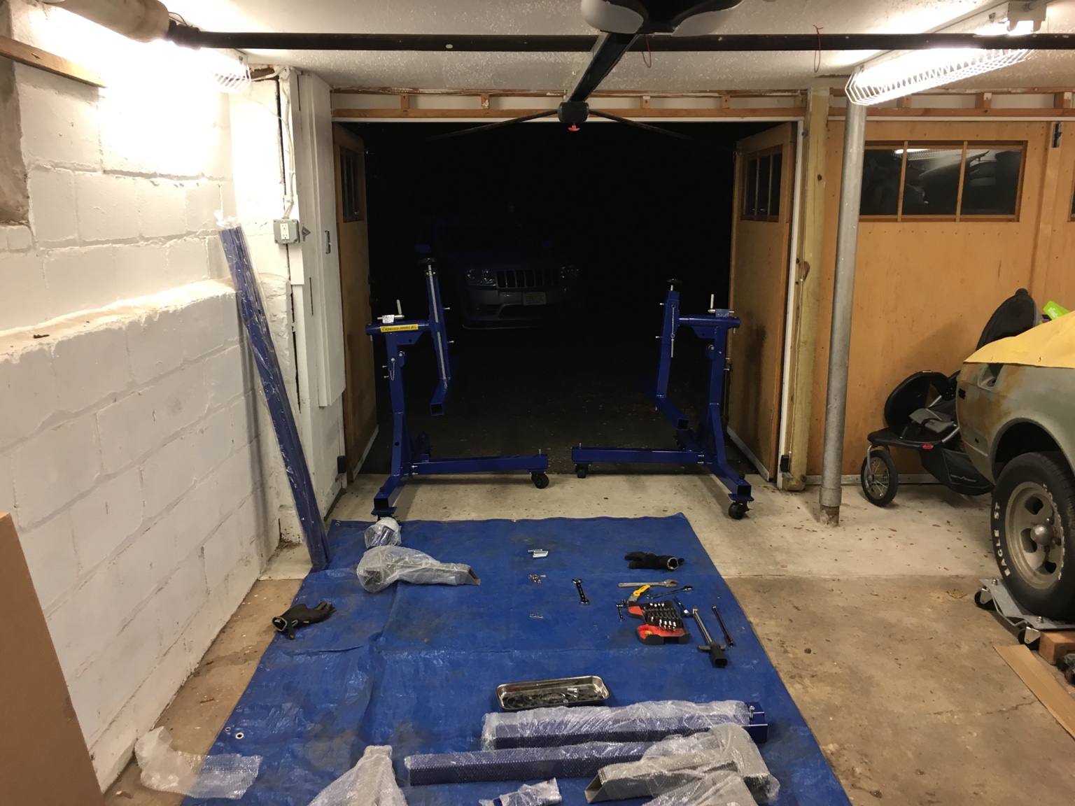

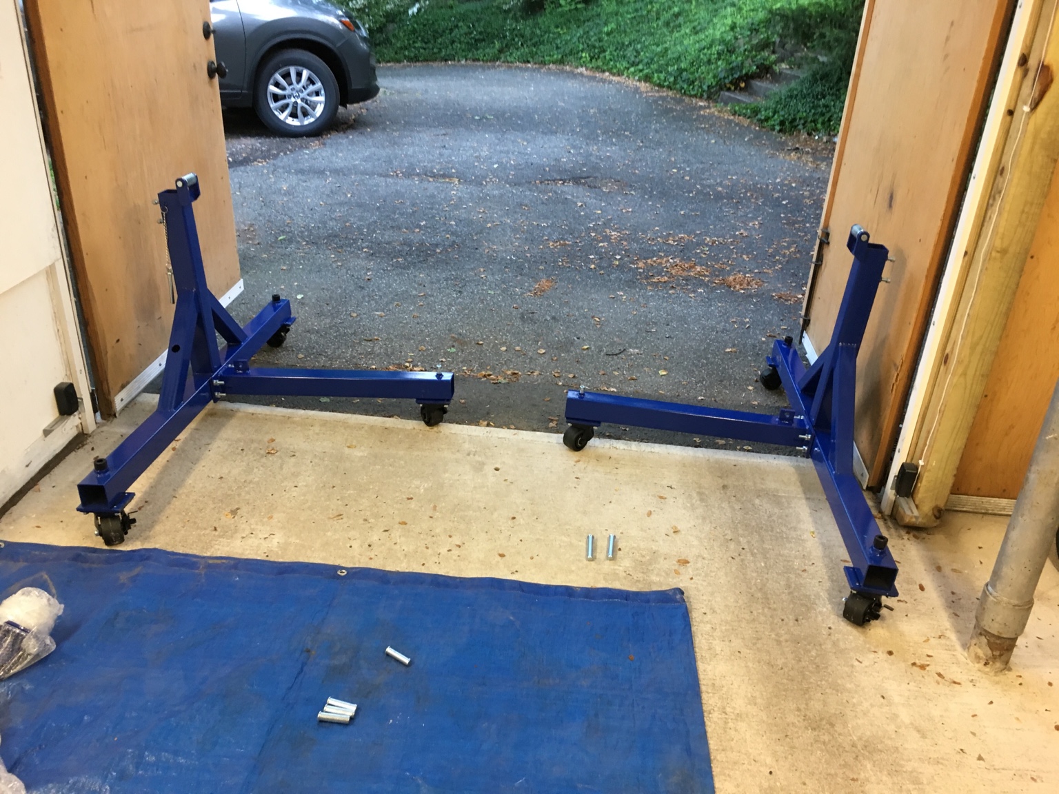

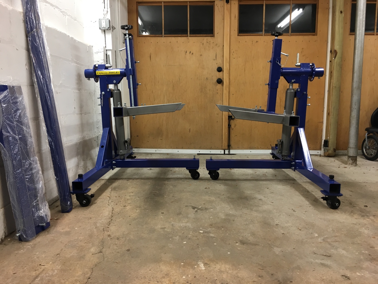

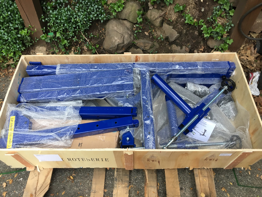

May 22, 20178 yr Author comment_521530 Saturday night: This is the Tuxedo CR-3000, $917 from Best Buy Automotive Equipment, not including lift-gate service, shipment tracking, brackets, and tip for the driver who muscled it up my driveway on a hand lift while I was at work. I was nervous it was going to be cheap and maybe even dangerous, but my assessment is that this thing is going to be perfectly fine once I upgrade 8 of the bolts to better hardware. The fact that the T-arms are 2.5" tubes instead of 3" might actually make it more usable because I can get more creative with how I make the rear brackets. Could I have gotten a better one? Sure, but this is good enough to get the job done, which is what matters on this budget. If you do get one for yourself, remember not to over tighten the nut on the end of the screw that adjusts the height of the T-arm. If you do it won't spin when you turn the handle, which will cause the handle to come off because of the way that it attaches. Edited May 23, 20178 yr by Matthew Abate Link to comment https://www.classiczcars.com/forums/topic/51541-1973-rebuild/?&page=48#findComment-521530 Share on other sites More sharing options...
May 22, 20178 yr comment_521533 Looks good. I have bought enough stuff for mine I thought about creating an LLC and using all of it to lower my gross income. Â What's less than zero? Â Maybe Uncle IRiS would pay me? Link to comment https://www.classiczcars.com/forums/topic/51541-1973-rebuild/?&page=48#findComment-521533 Share on other sites More sharing options...

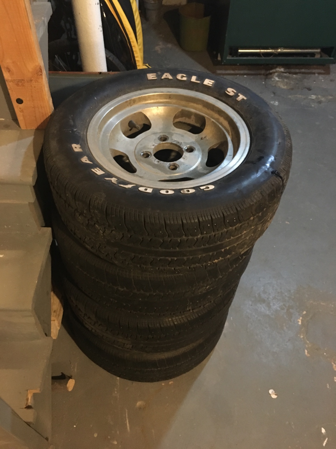

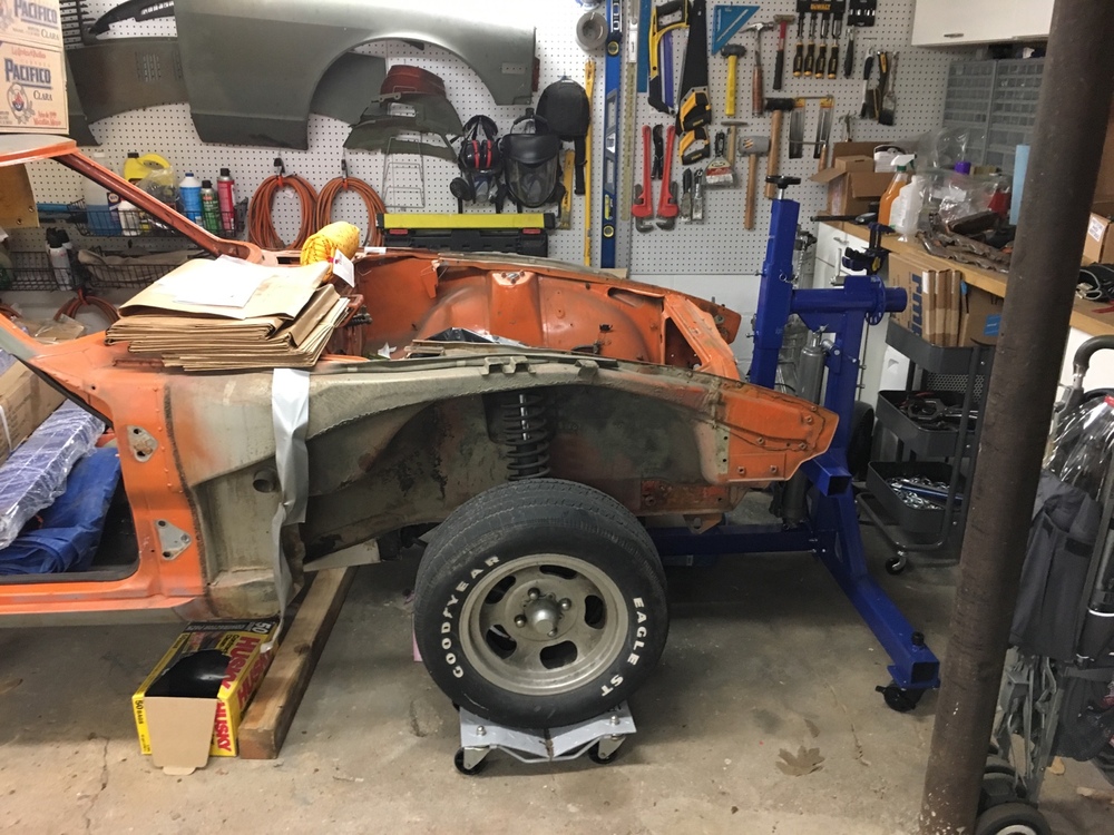

June 7, 20178 yr Author comment_522479 The rotisserie arms are ready to mount on the front. I feel like I need to make an insert to spread the pressure from the bolts in order to prevent mushrooming, and then wait for the rear mounts to arrive in the mail, which should happen tomorrow. Â Â ... Â In other news, can anyone identify these wheels? I've seen them discussed before but can't begin to think of how to search for that discussion. I believe the manufacturer starts with M but I'm blanking on it. Â Â Link to comment https://www.classiczcars.com/forums/topic/51541-1973-rebuild/?&page=48#findComment-522479 Share on other sites More sharing options...

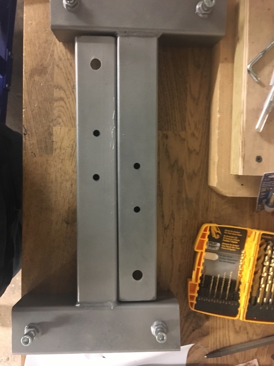

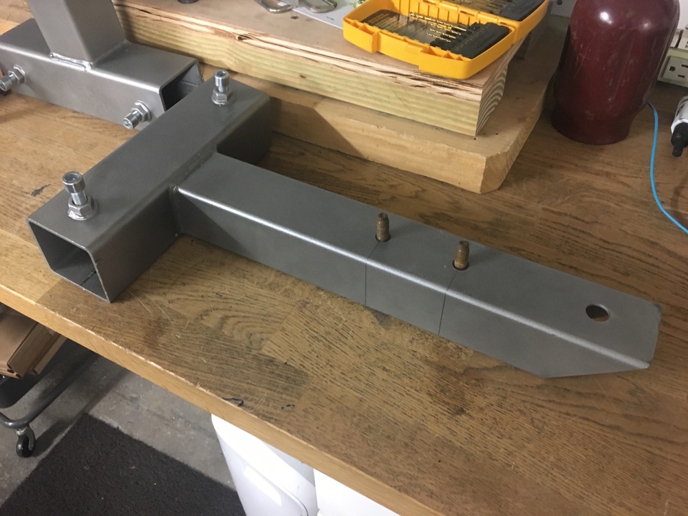

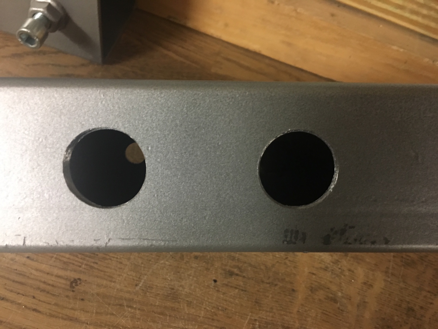

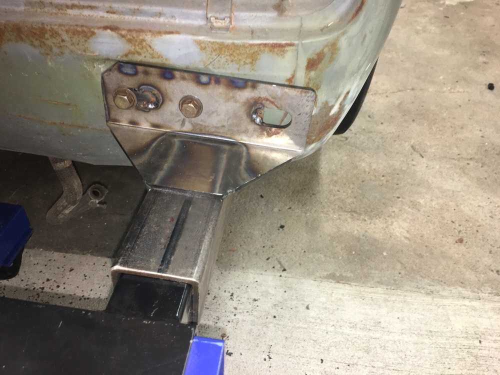

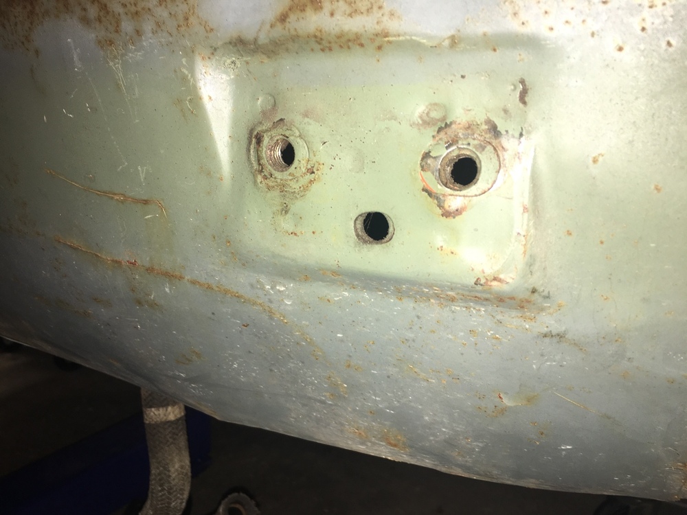

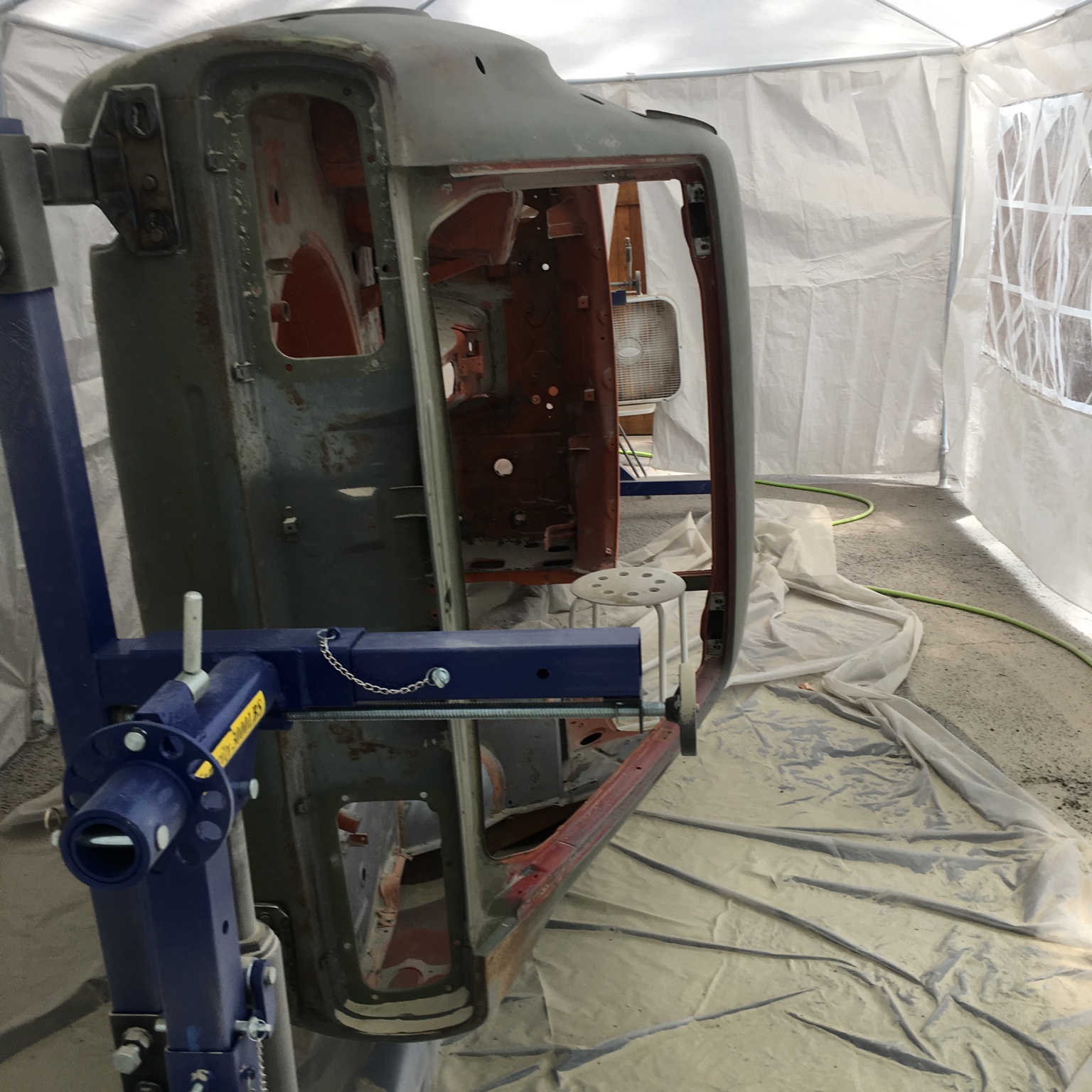

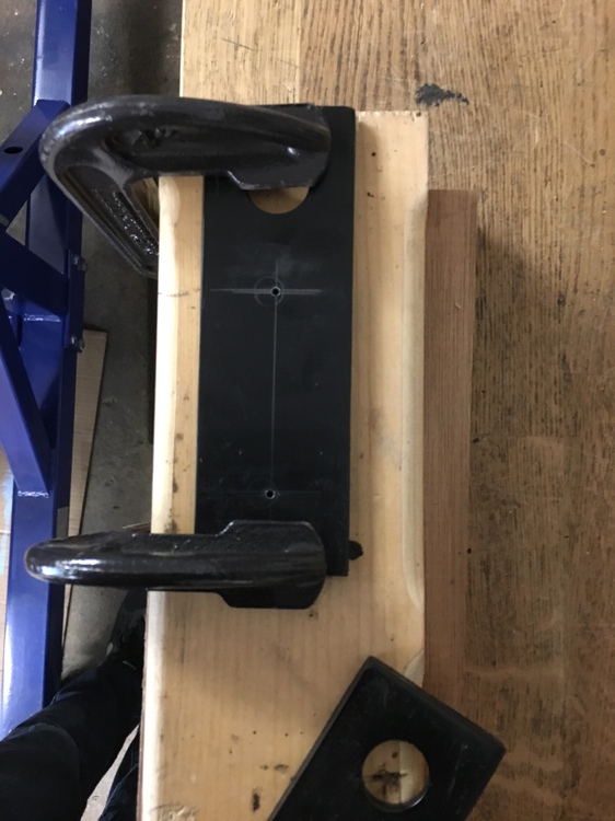

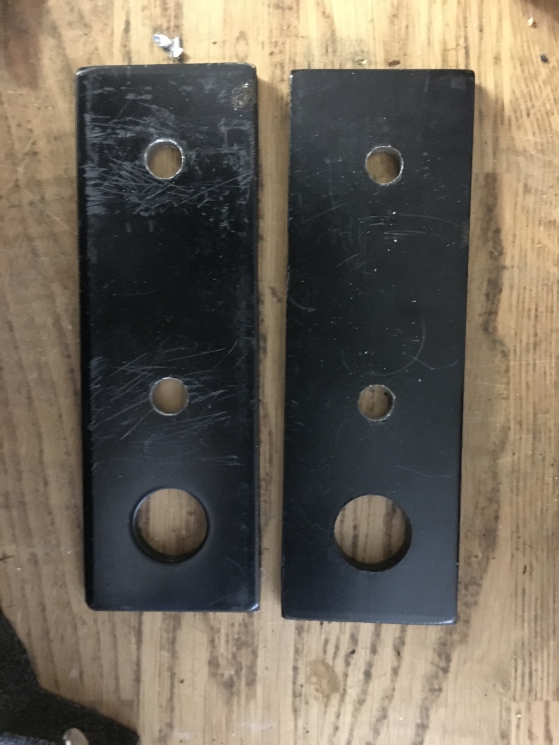

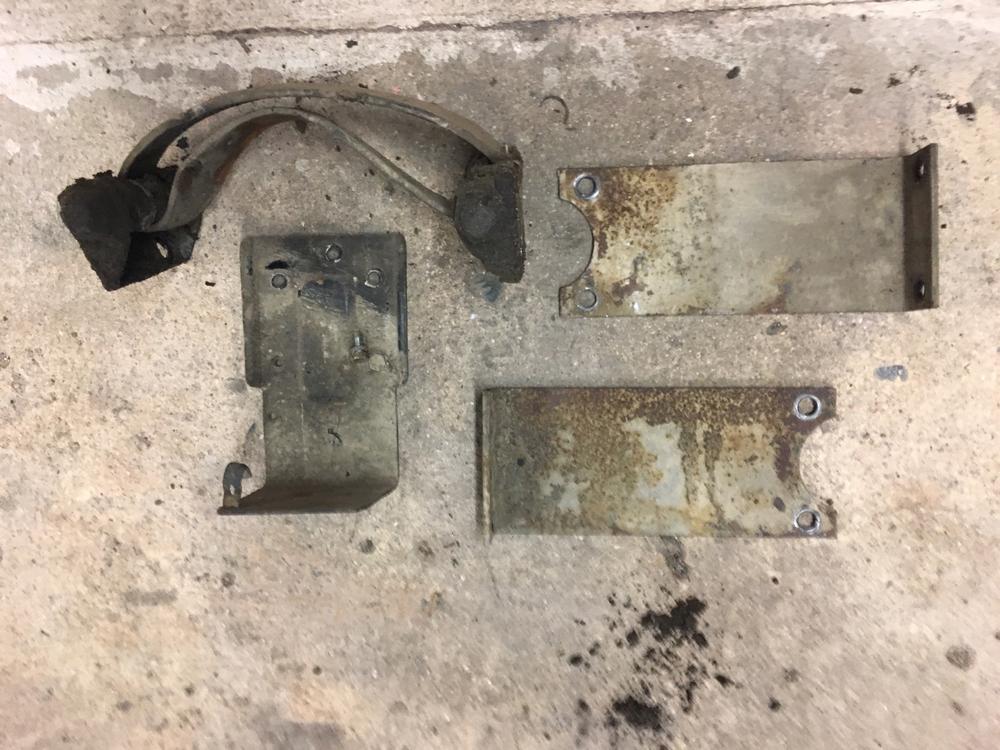

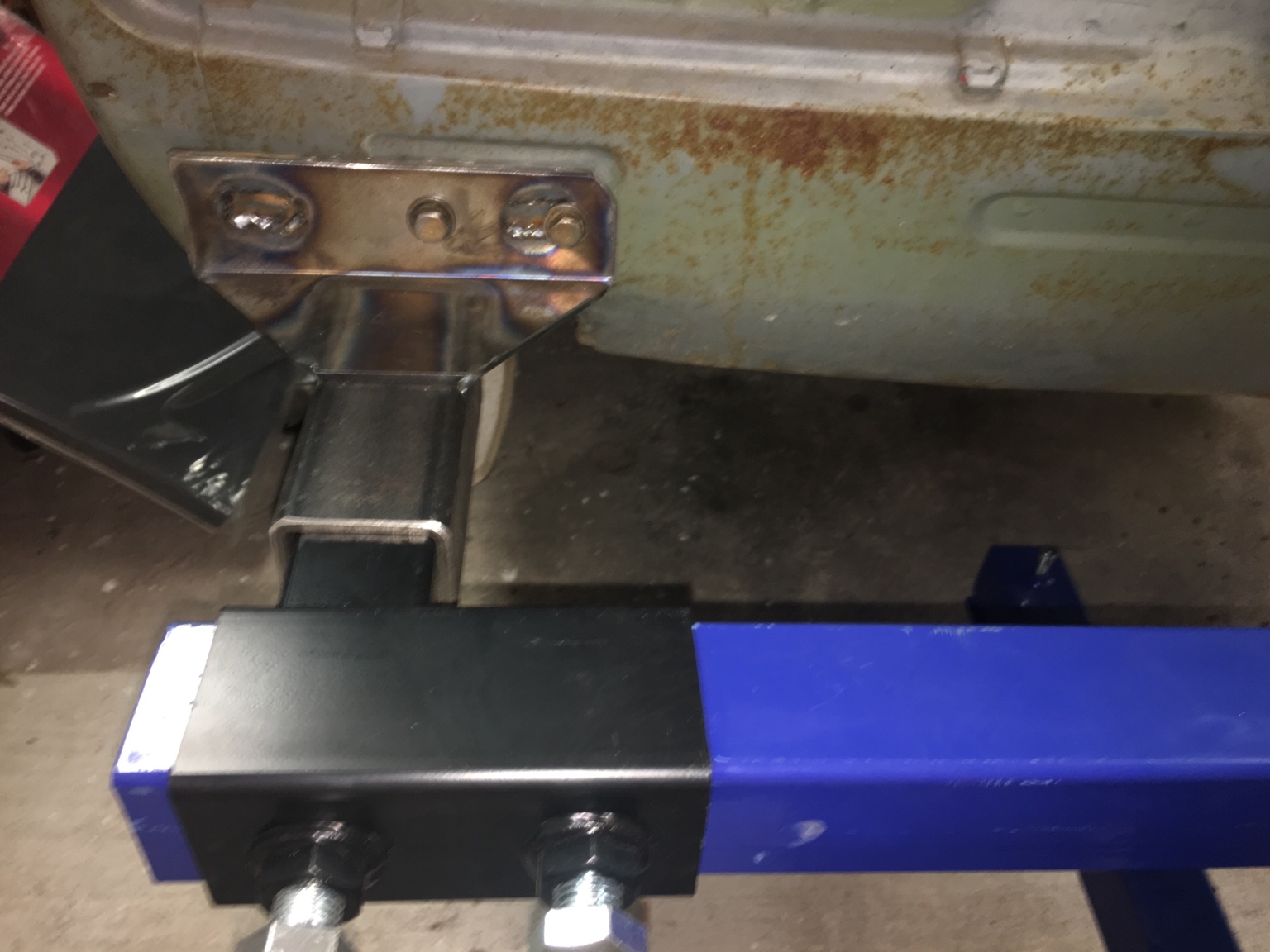

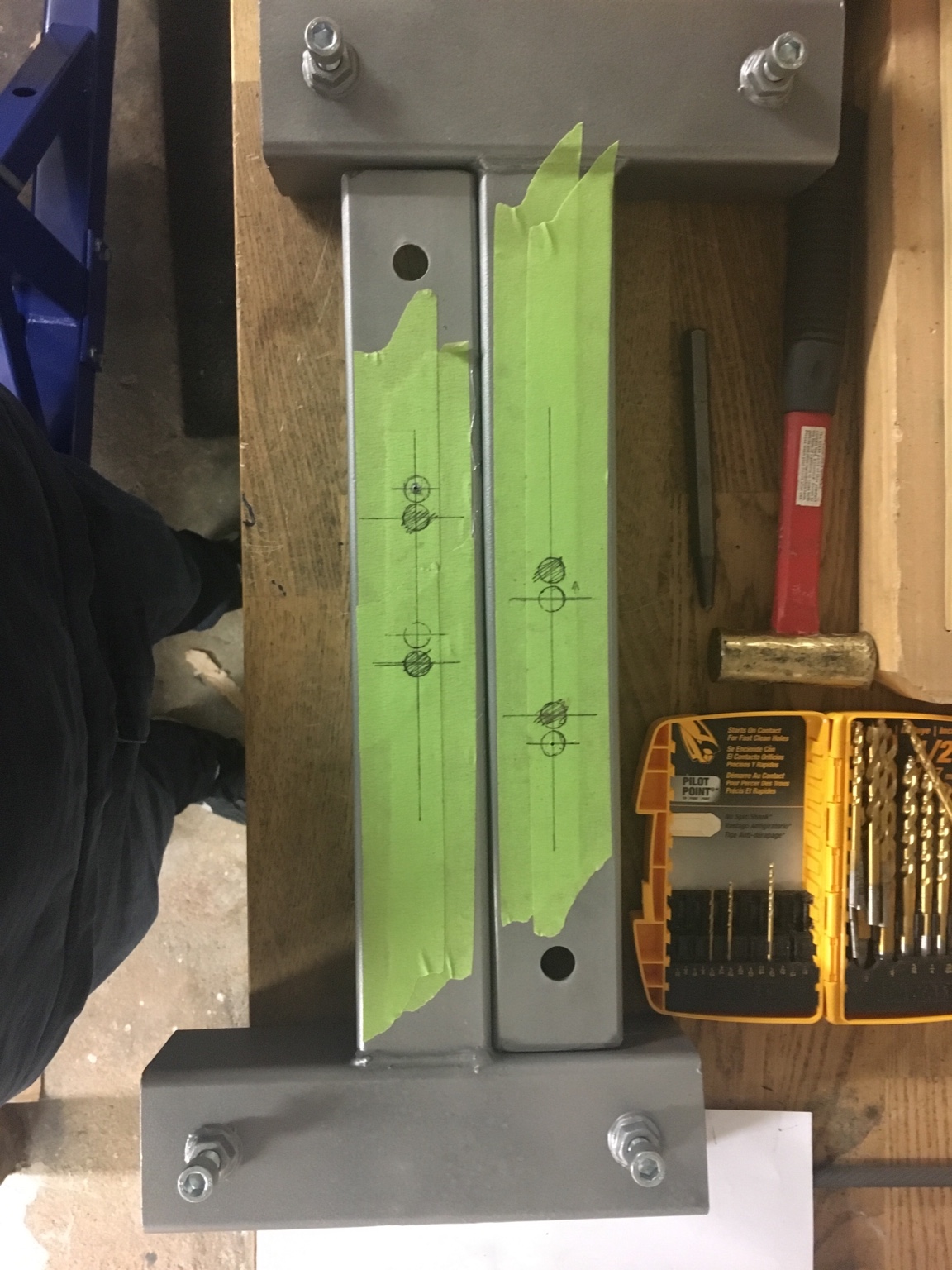

June 10, 20178 yr Author comment_522794 Â I think this Tuxedo/Kernel rotisserie is going to be just fine for home use. The real question ended up being how to mount it. I bought a few sets of brackets but ended up not using everything. Here's how it went... First, I had read that the Auto Twirler mopar valence mounts attach to the the 240z front bumper mounting holes. This is not the case. I tried turning them 90 degrees and fitting them to the tow hook mounting spot just under that, but I did not think this through correctly and drilled the brackets in such a way that the Tuxedo valence arms could quite reach the brackets. I ended up drilling the silver Tuxedo arms to mount to the tow hook mount point as a solution. This meant a small set of holes for the bolts in the top and a larger set of holes underneath to get the socket in (see previous post). I was concerned about the potential for mushrooming, so I drilled some of the Tuxedo valence plates to act as a washer to spread the pressure and hopefully mitigate that. Â Next I made some plates to go between the Auto Twirler Mopar rear bumper brackets and the car. I drilled these plates and the brackets, then welded them together and ground them down to fit into the cavity for the bumper brackets. Â Last was just mounting the brackets and lining up the T-arms with the brackets. I tightened it all up and now the car is hung! Â The next steps are to remove the suspension and balance the car on the rotisserie. Then I'm in business. Â Â Â Link to comment https://www.classiczcars.com/forums/topic/51541-1973-rebuild/?&page=48#findComment-522794 Share on other sites More sharing options...
June 11, 20178 yr Author comment_522806 On 6/6/2017 at 10:20 PM, Matthew Abate said: In other news, can anyone identify these wheels? I've seen them discussed before but can't begin to think of how to search for that discussion. I believe the manufacturer starts with M but I'm blanking on it. Â Â Found the answer to my own question. They are M.A.G. Princess Anne Alloys, most commonly found on British cars like MGBs and Scimitars. They are not the Dunlops that I have seen floating around here. Apparently these are crazy hard to find, although it looks like they cam in a 15x7" version. Link to comment https://www.classiczcars.com/forums/topic/51541-1973-rebuild/?&page=48#findComment-522806 Share on other sites More sharing options...

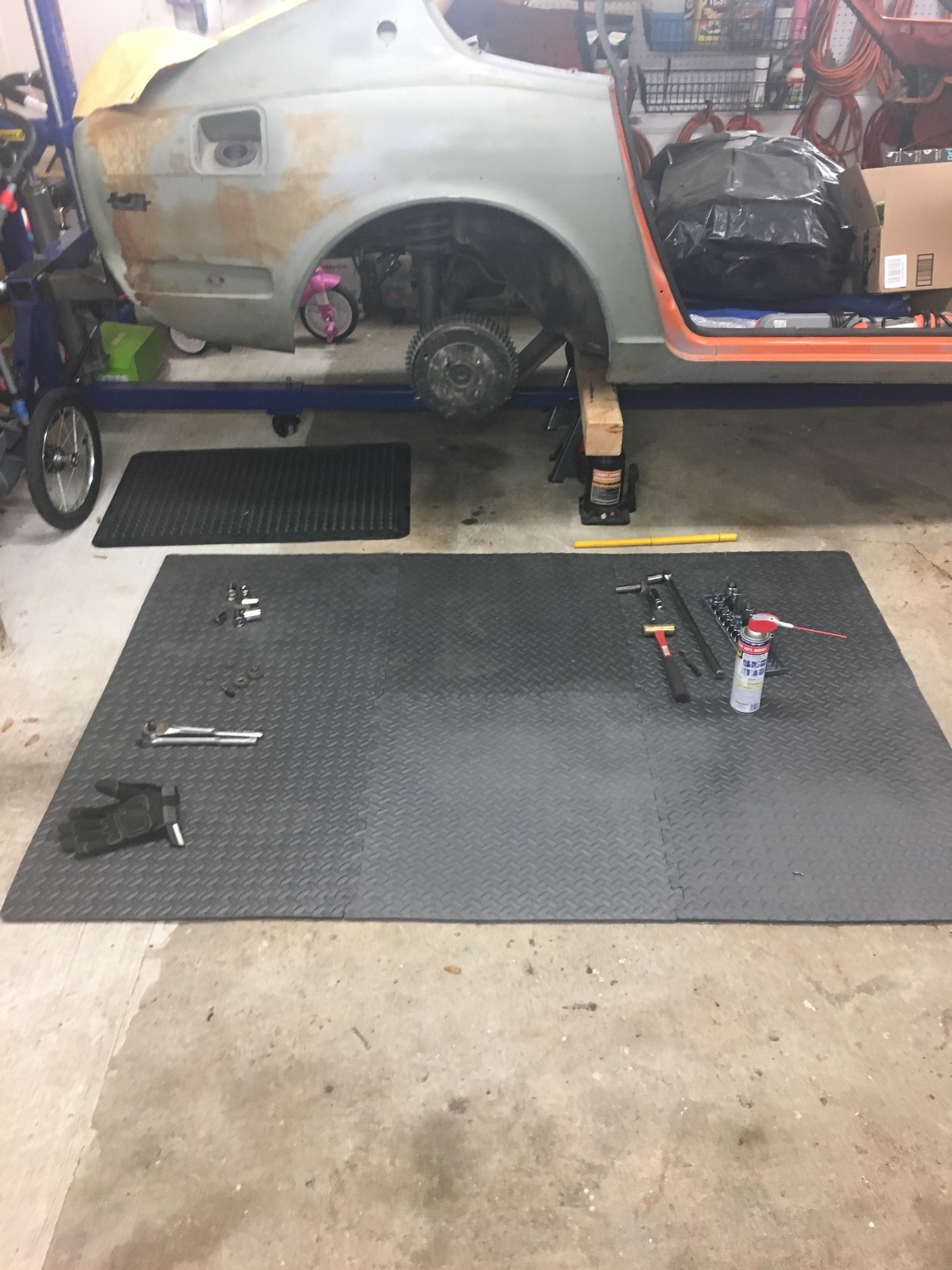

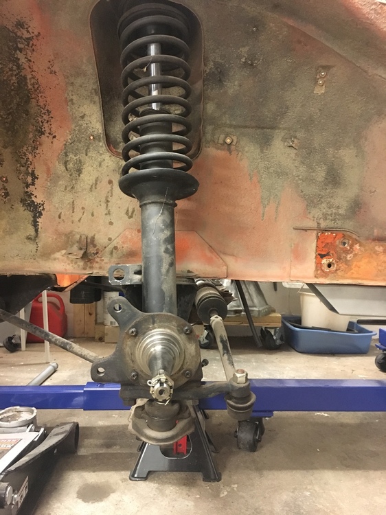

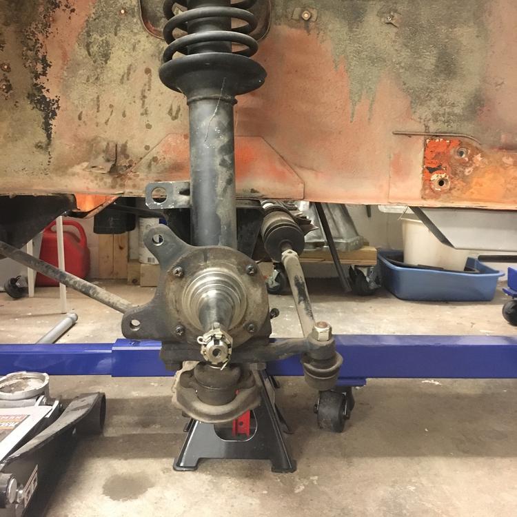

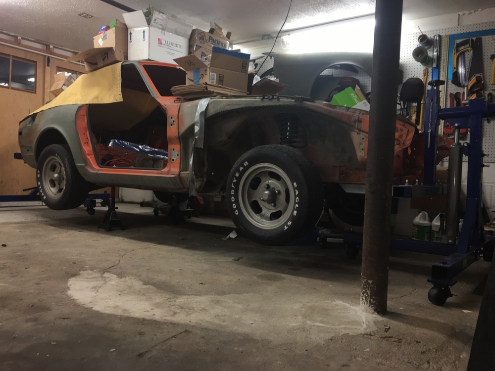

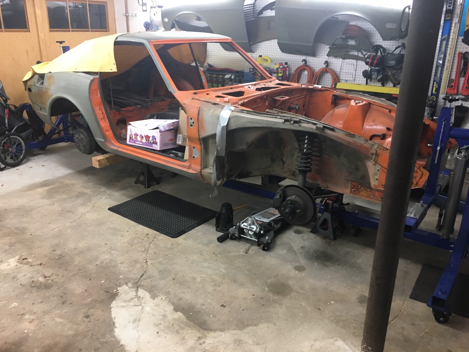

June 17, 20178 yr Author comment_523303 Front wheels are off. I'm down to just the suspension in the front. This is about an hour's work (rusted in lug nuts). Link to comment https://www.classiczcars.com/forums/topic/51541-1973-rebuild/?&page=48#findComment-523303 Share on other sites More sharing options...

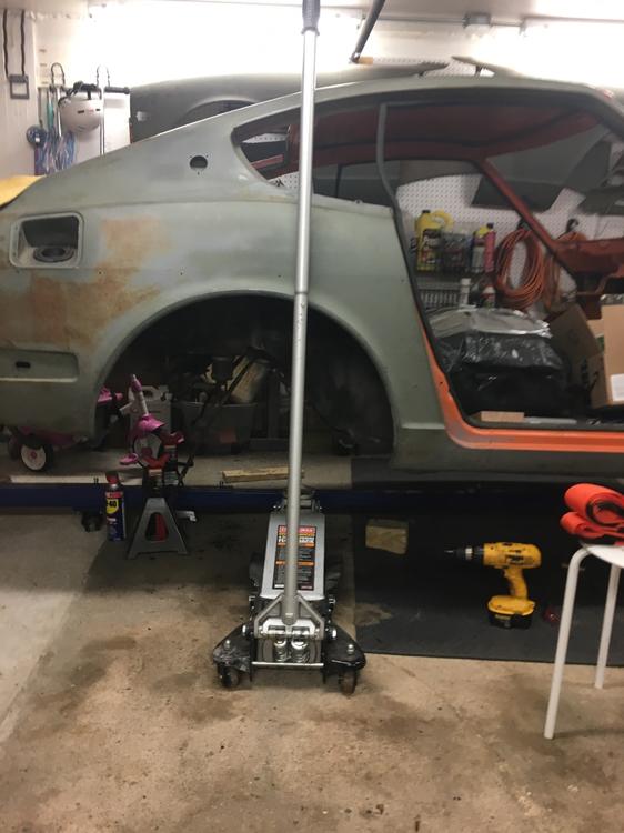

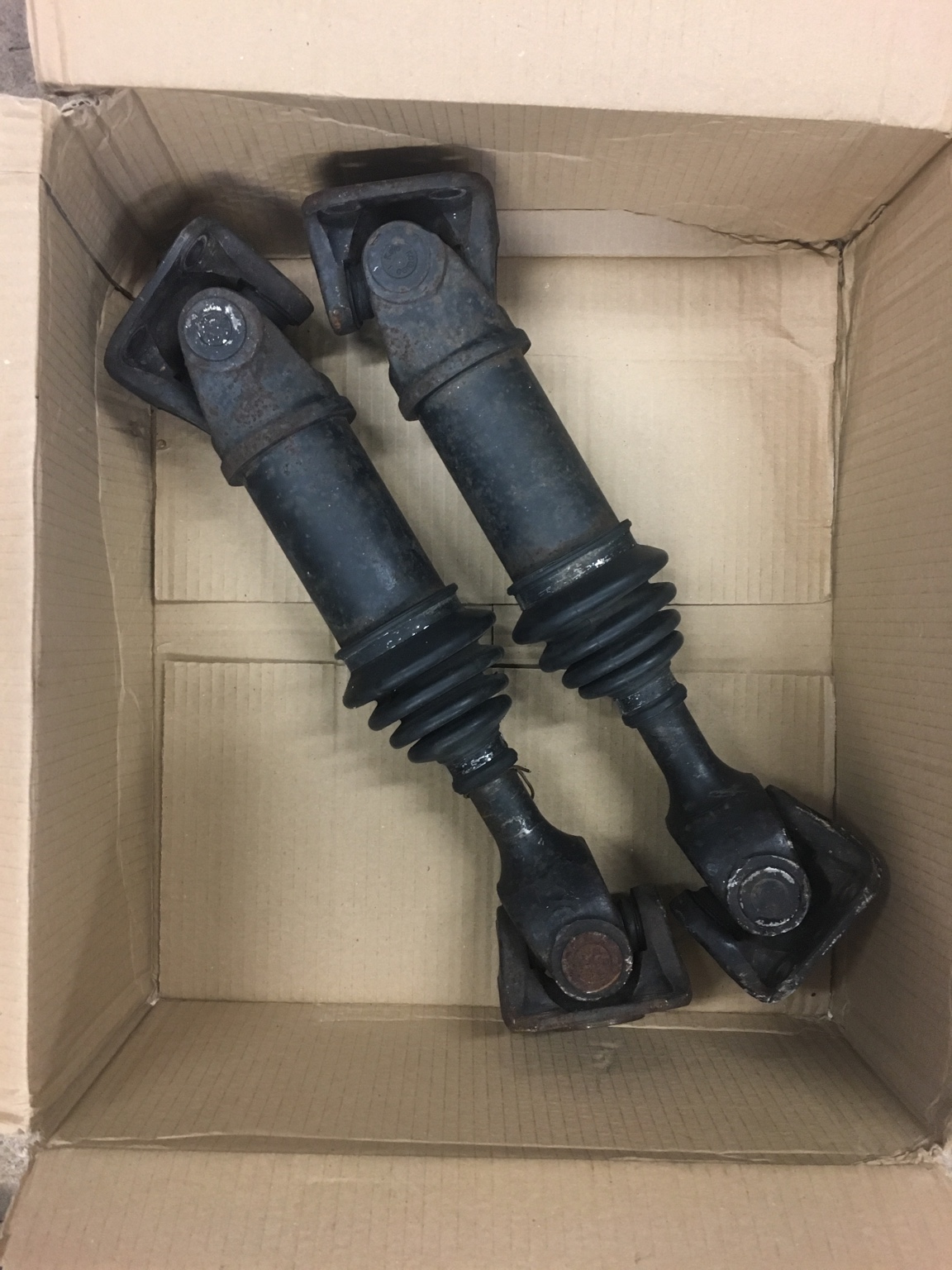

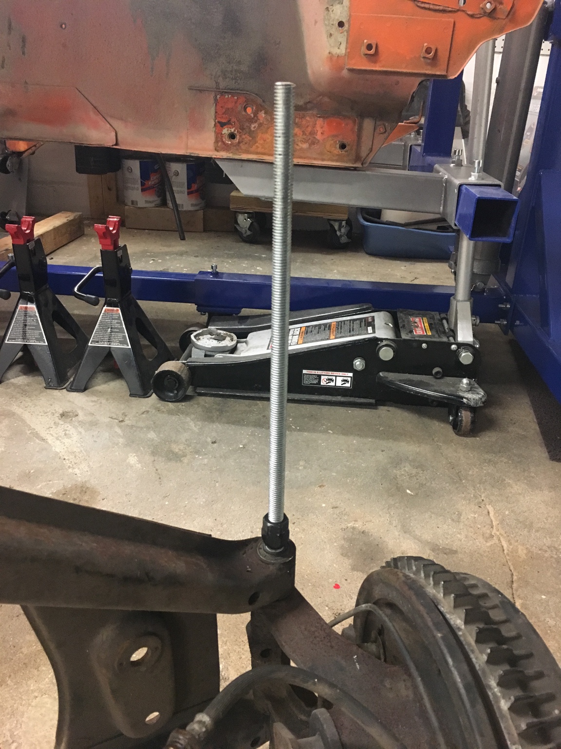

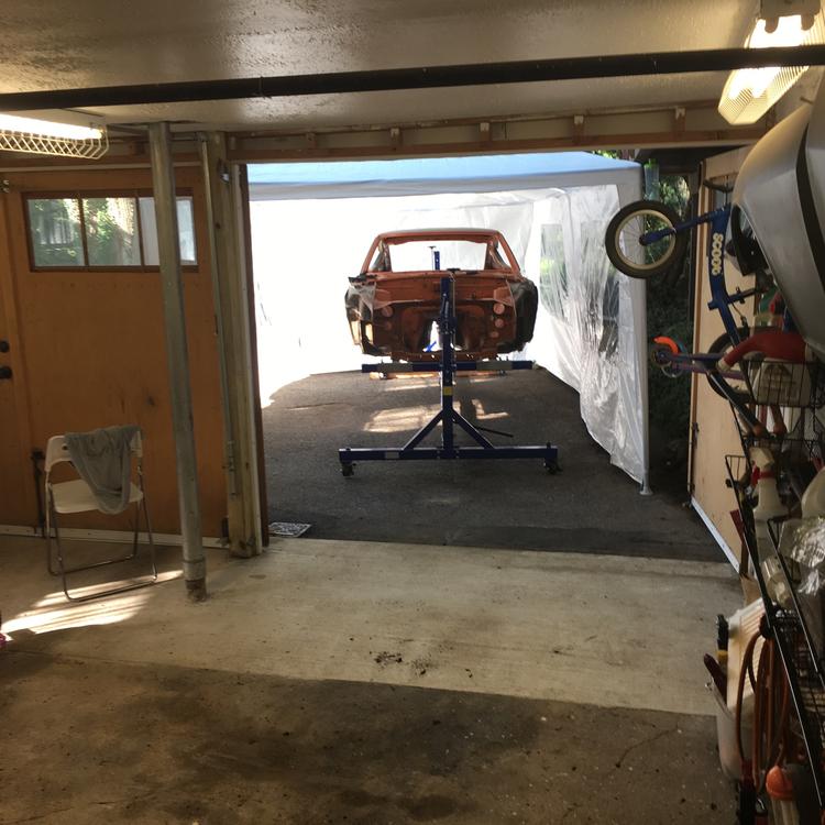

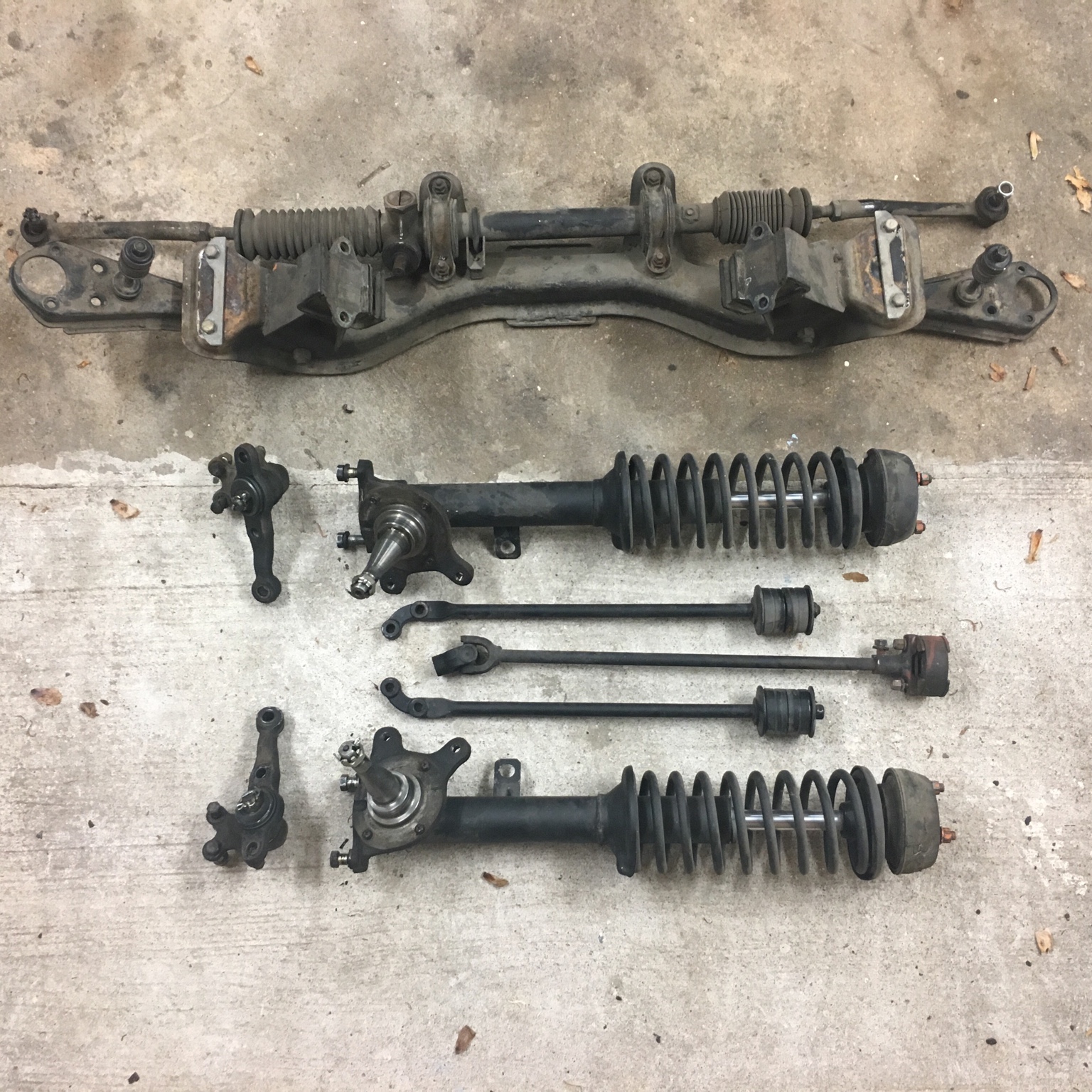

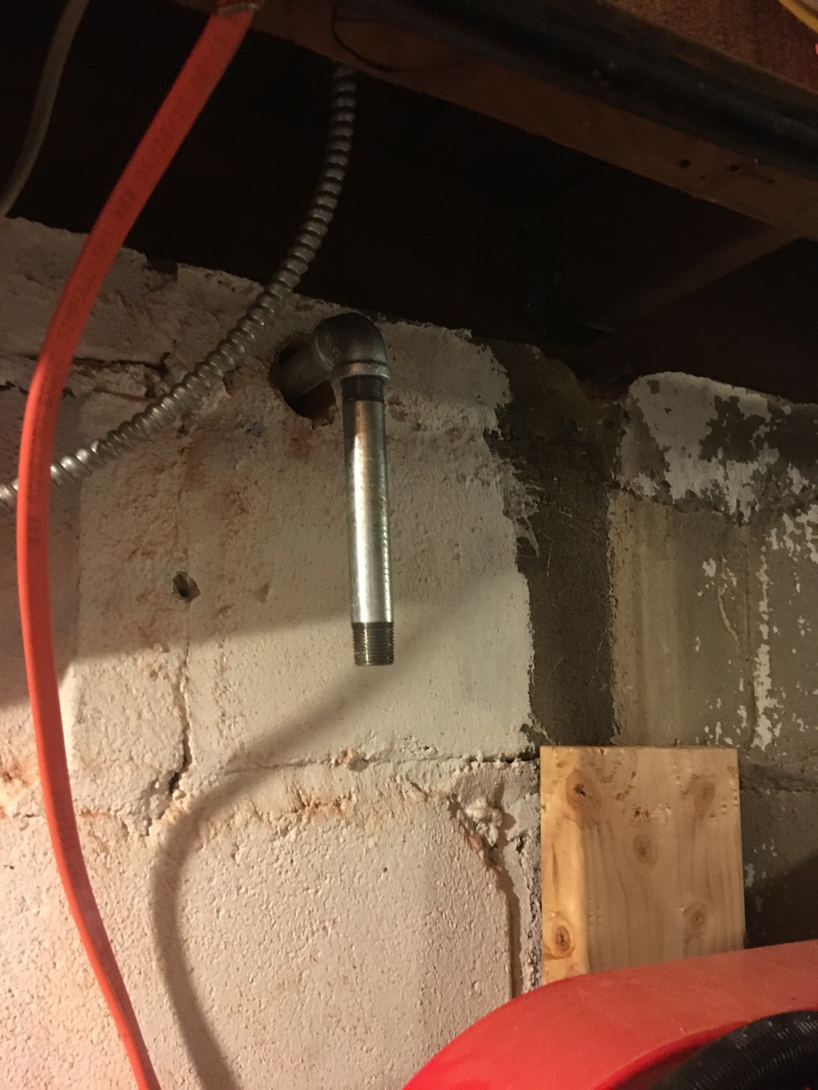

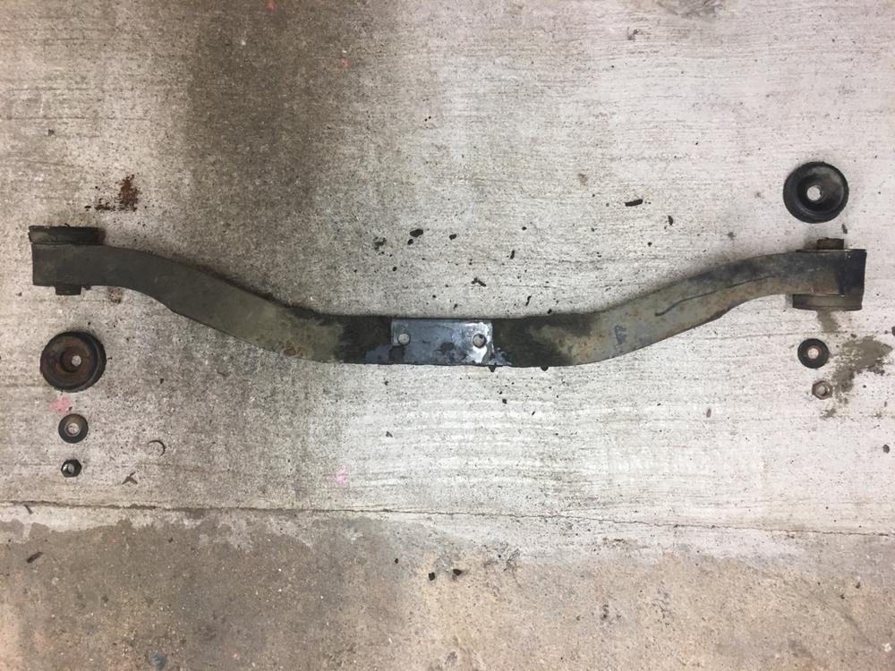

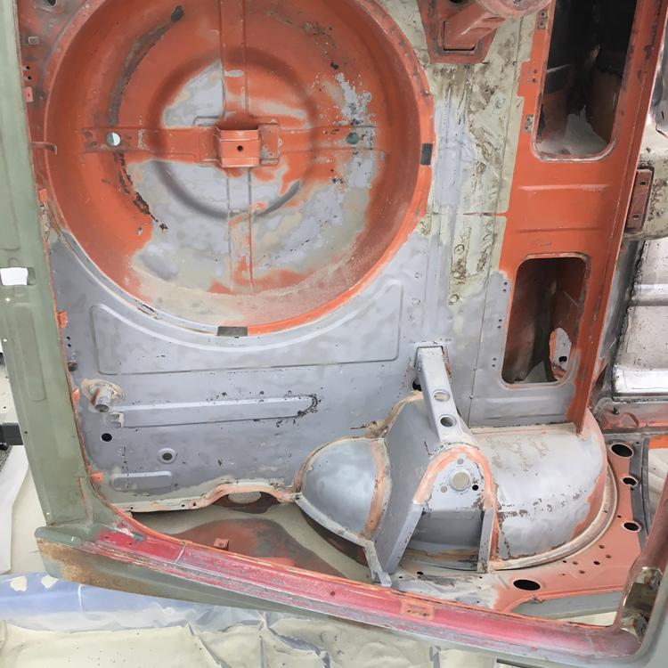

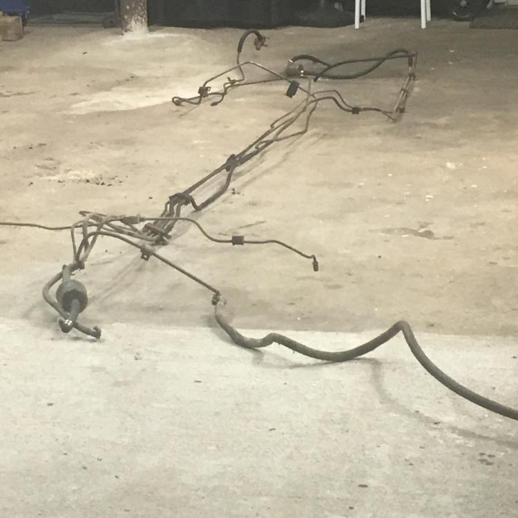

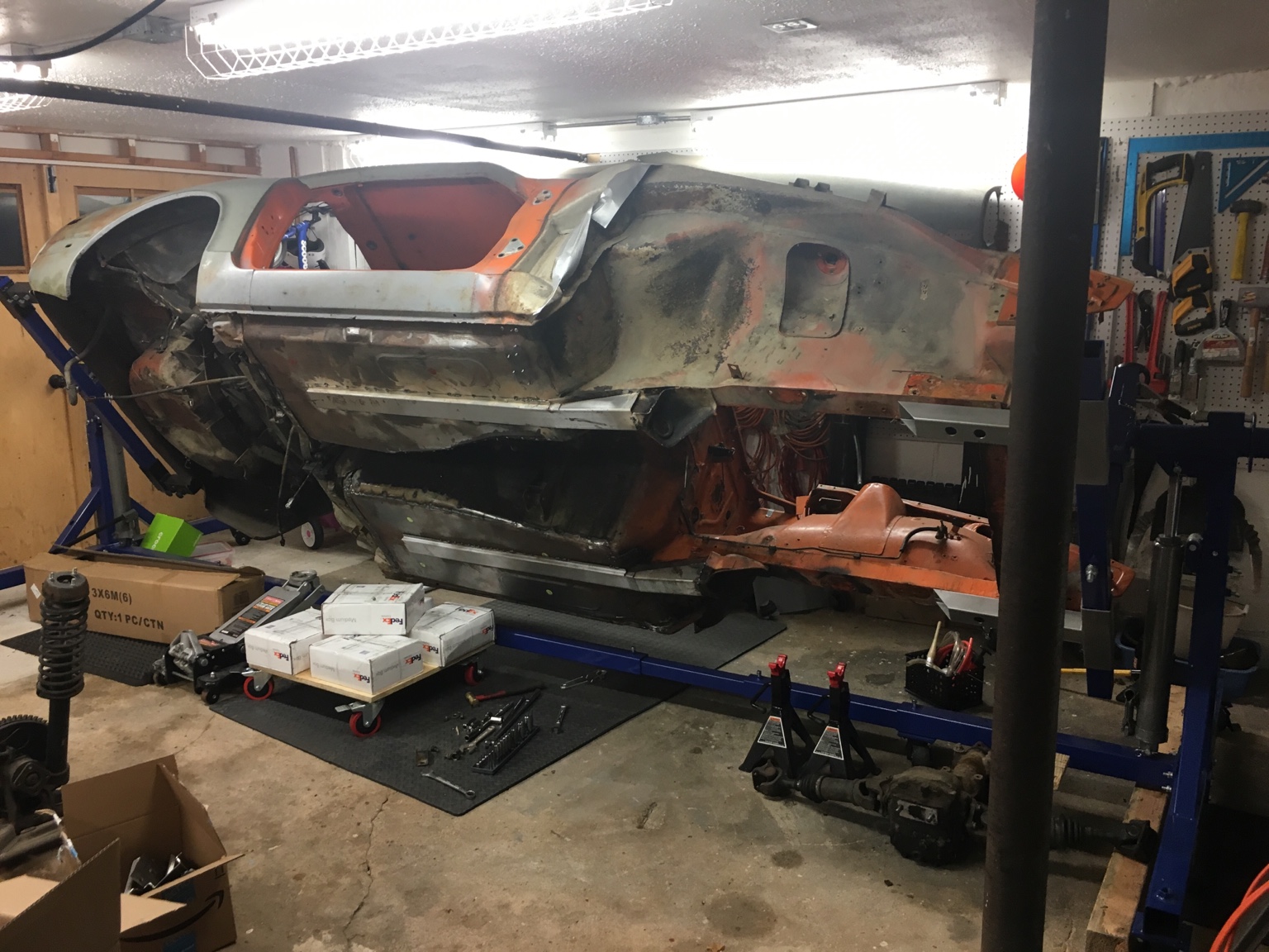

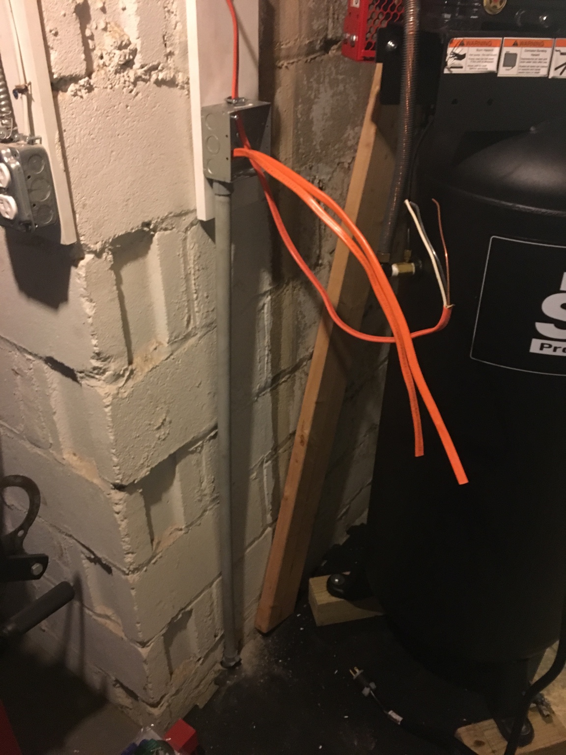

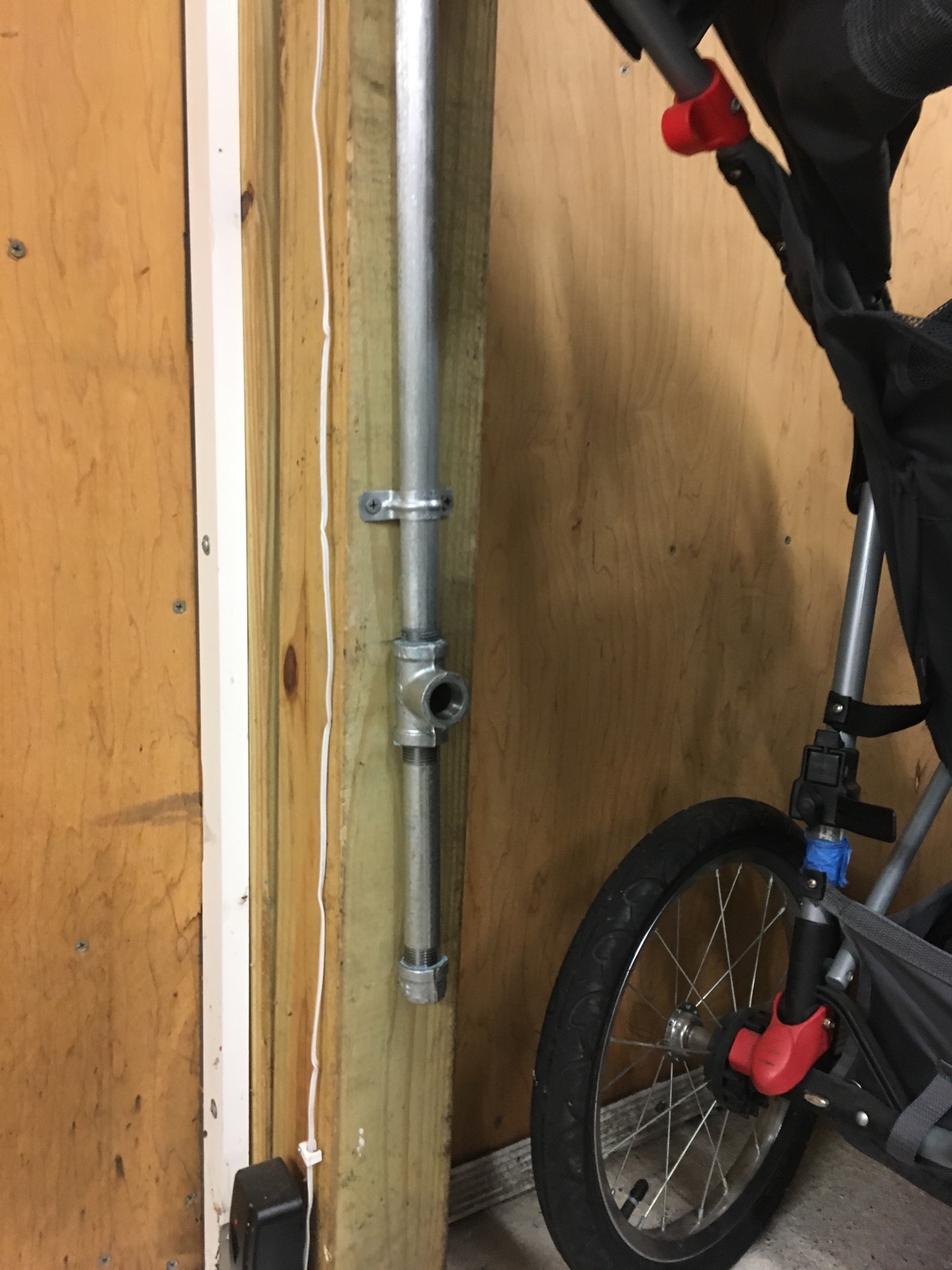

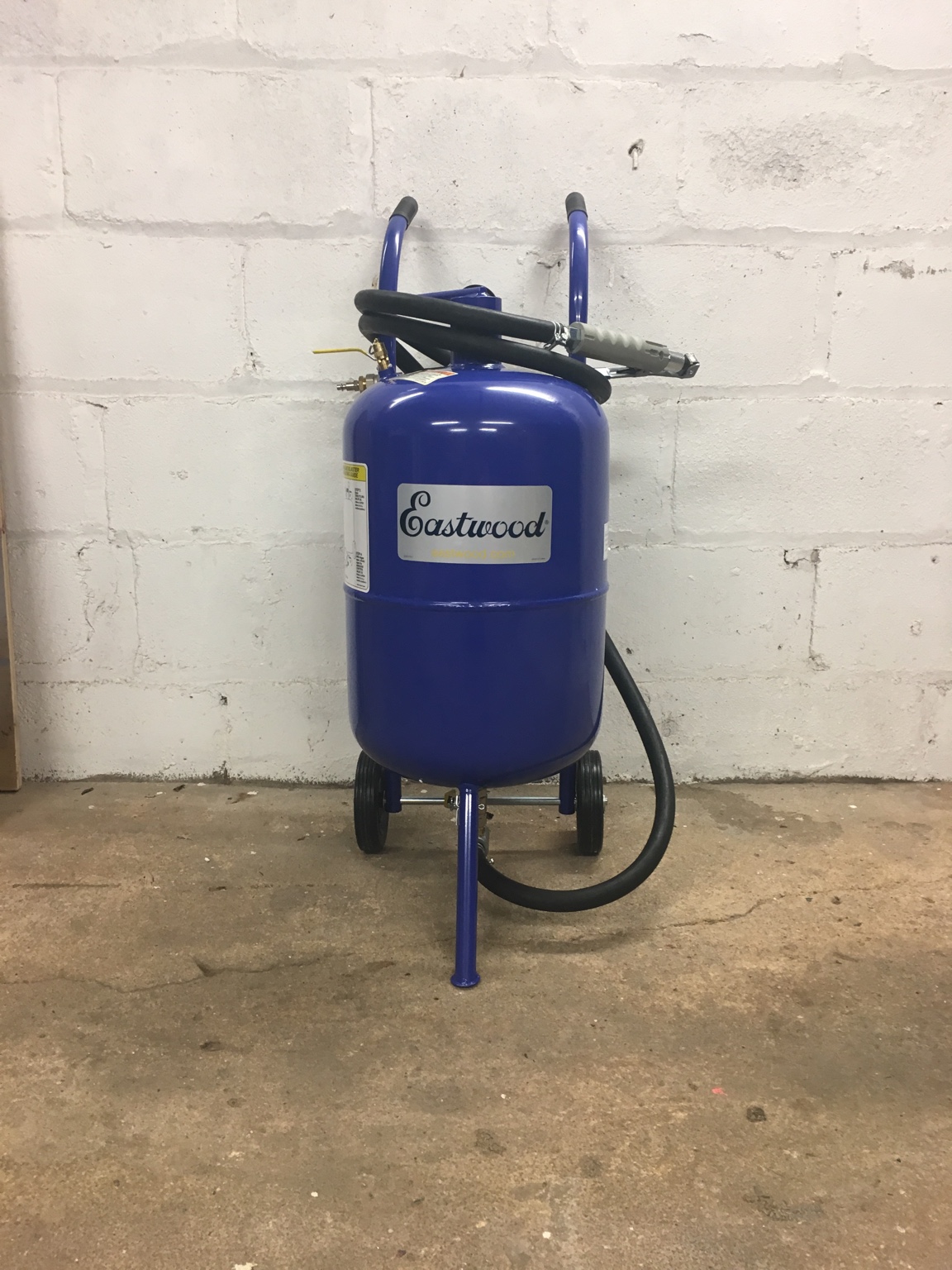

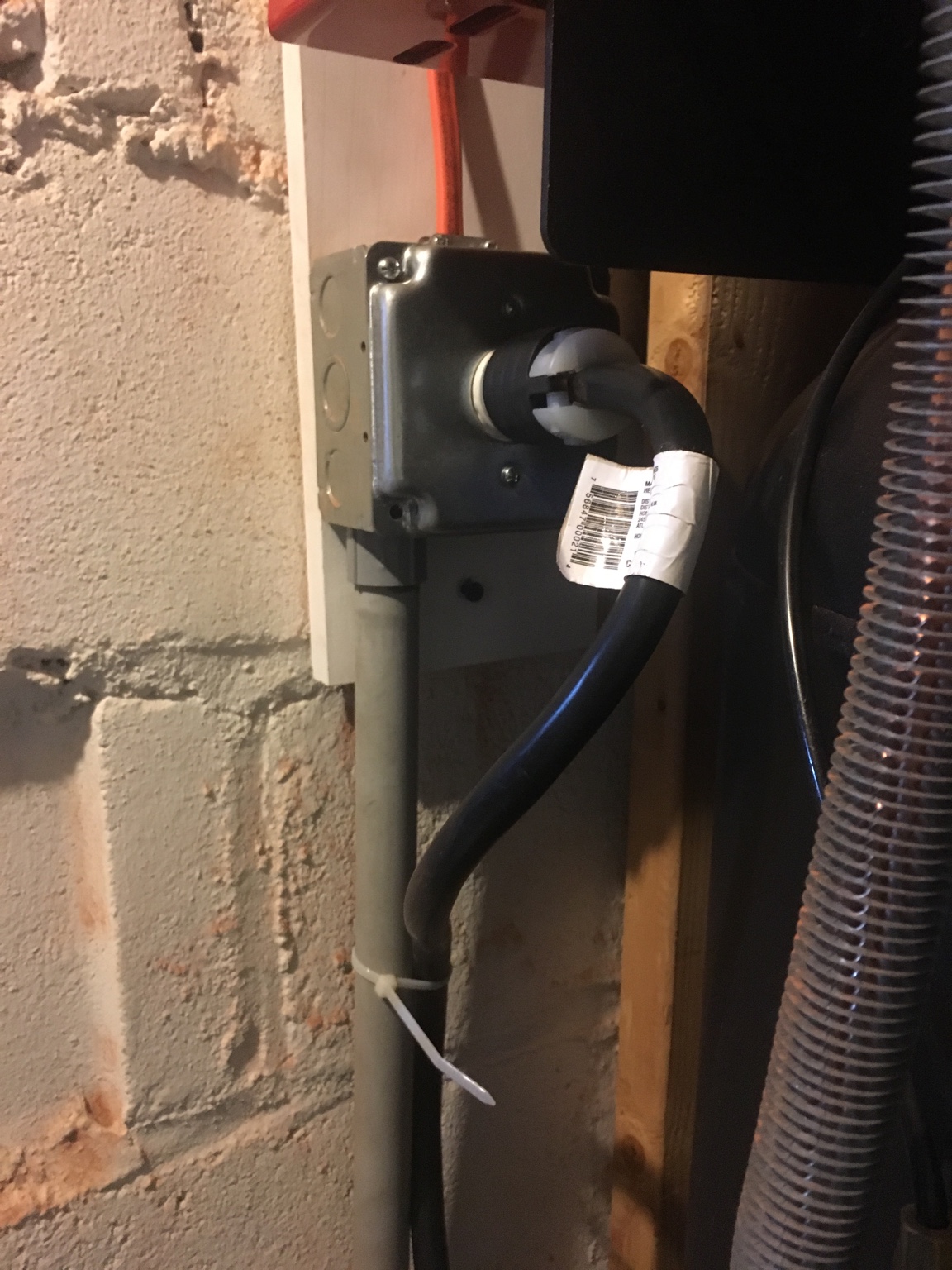

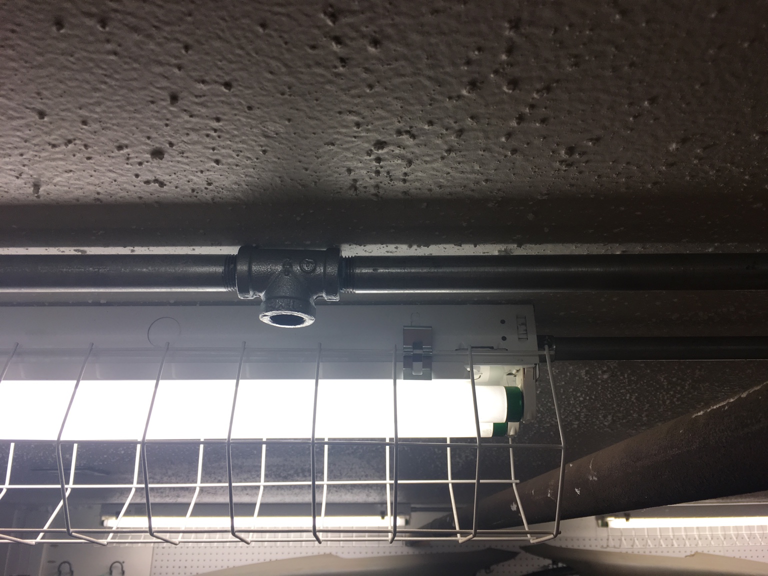

August 12, 20177 yr Author comment_527771 Pressed for time so just gonna throw some photos up. Â Â Â Â Â Link to comment https://www.classiczcars.com/forums/topic/51541-1973-rebuild/?&page=48#findComment-527771 Share on other sites More sharing options...

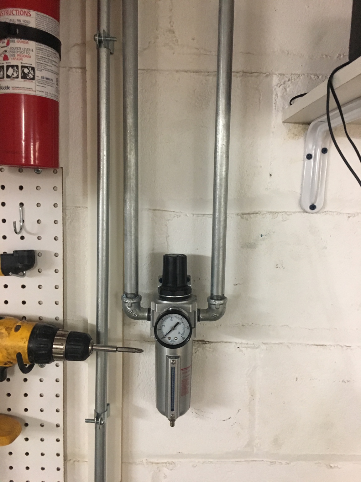

August 12, 20177 yr comment_527775 Nice! I can tell you have plumbed some air lines in the past or have some help from someone who has. So where is the body off to? Chemical dip? Paint work? Link to comment https://www.classiczcars.com/forums/topic/51541-1973-rebuild/?&page=48#findComment-527775 Share on other sites More sharing options...
August 12, 20177 yr comment_527778 That brings back both good and bad memories! Link to comment https://www.classiczcars.com/forums/topic/51541-1973-rebuild/?&page=48#findComment-527778 Share on other sites More sharing options...
