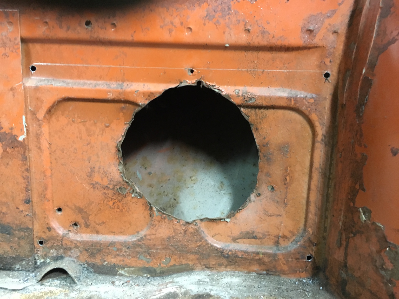

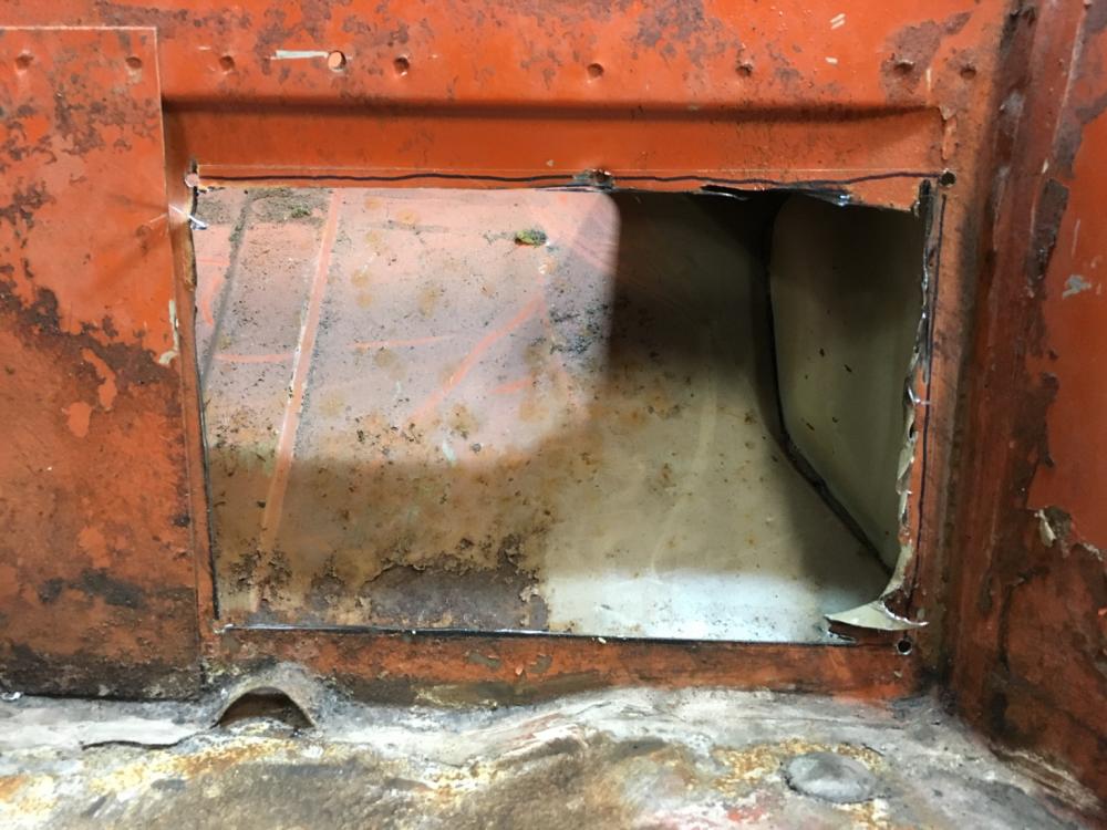

April 30, 20169 yr Author comment_493896 Things I learned cutting this hole: I need more light. I need a grinder that can work more finely. Maybe my deemed could work. I need better metal files. Link to comment https://www.classiczcars.com/forums/topic/51541-1973-rebuild/?&page=14#findComment-493896 Share on other sites More sharing options...
April 30, 20169 yr comment_493898 Mathew Do you have a straight die grinder? You need one with a 4" grinder wheel. You also need a right angle grinder and get a 2" Rolock head. Some 2" Roloc pads in 36 grit will help you straighten the lines. they cut really fast. You could also get a body saw but not really a necessity, sort of expensive but would work in this application really well. Also I don't use files for anything! I'm old and don't have time to waste... Edited April 30, 20169 yr by Patcon Link to comment https://www.classiczcars.com/forums/topic/51541-1973-rebuild/?&page=14#findComment-493898 Share on other sites More sharing options...

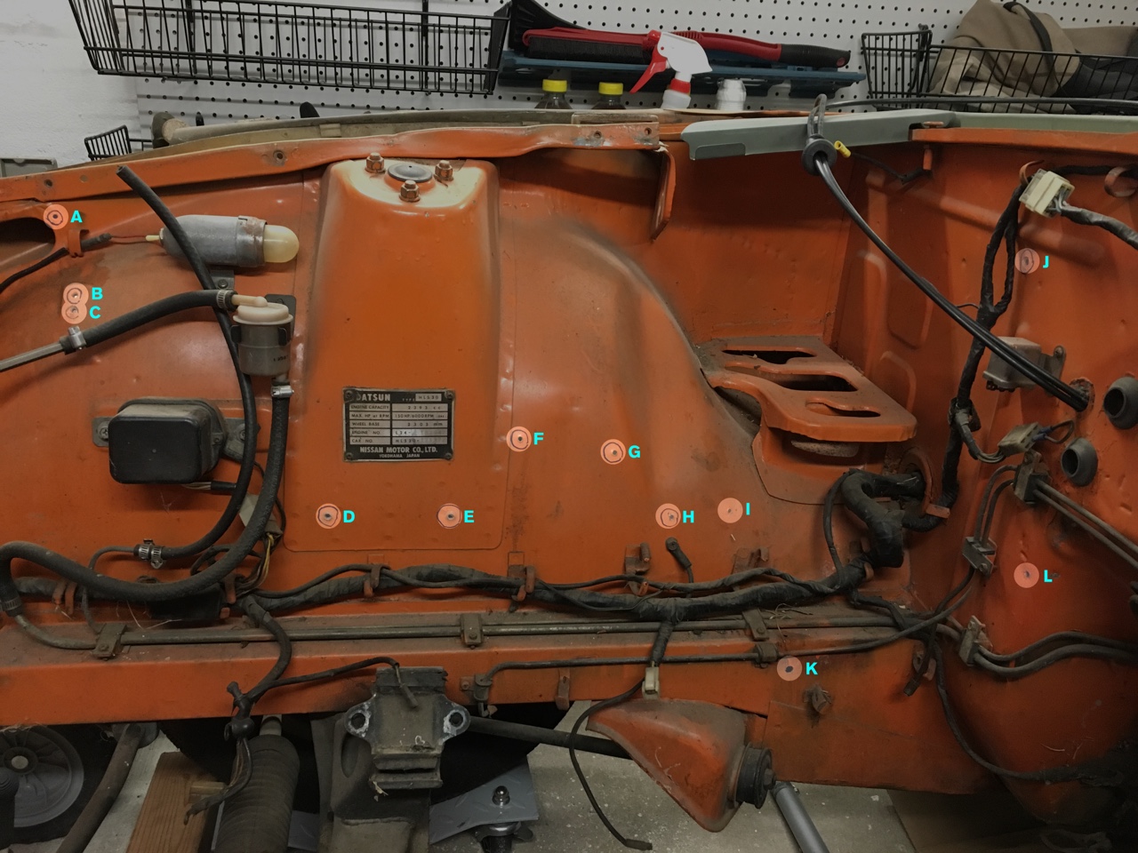

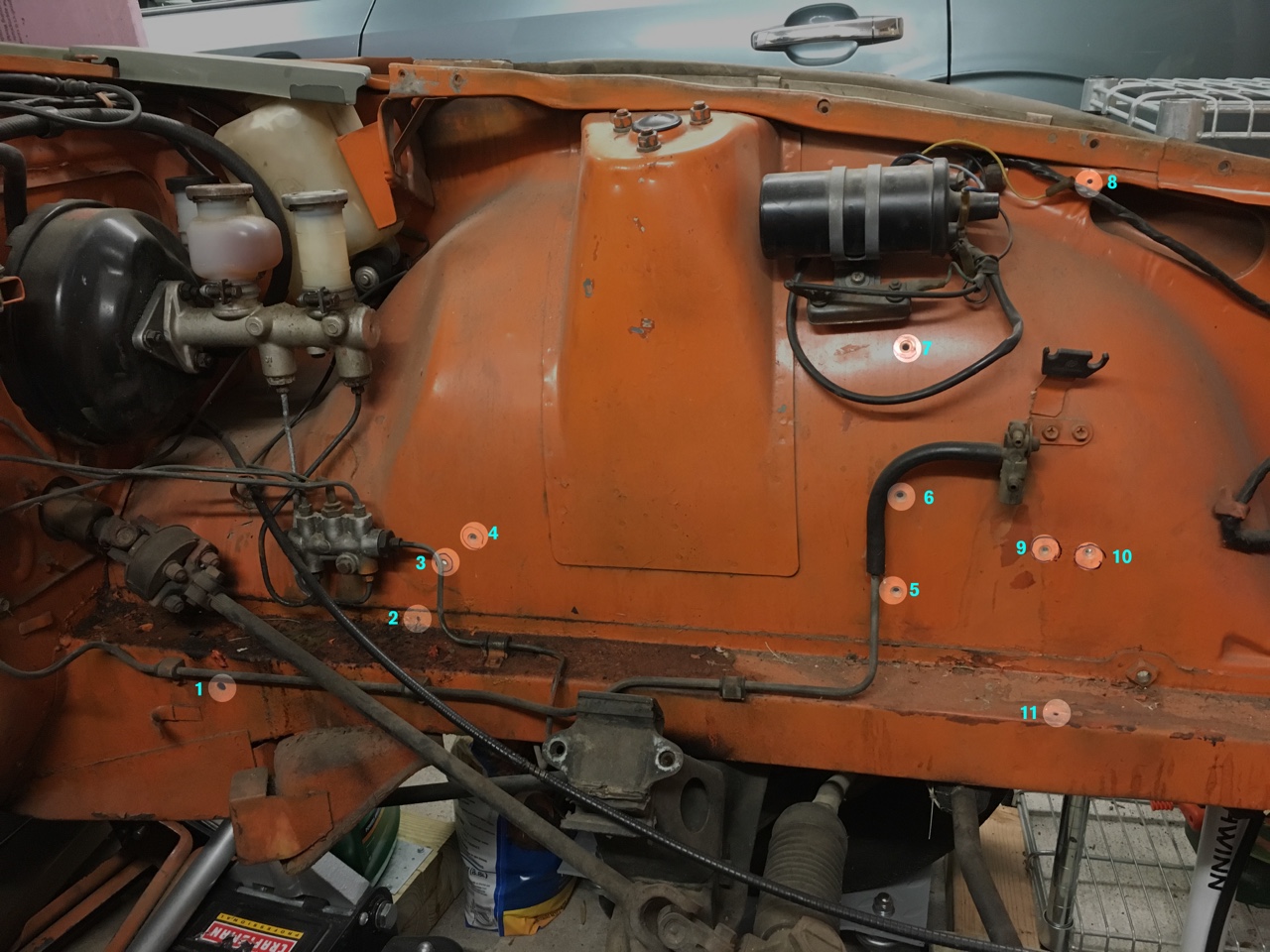

May 18, 20168 yr Author comment_495324 Last night I marked all of the holes in my engine bay that didn't have something screwed into them when I got the car (remember it was half disassembled when it arrived). Next step is to identify which ones can be welded up and which ones will need to stay. Link to comment https://www.classiczcars.com/forums/topic/51541-1973-rebuild/?&page=14#findComment-495324 Share on other sites More sharing options...

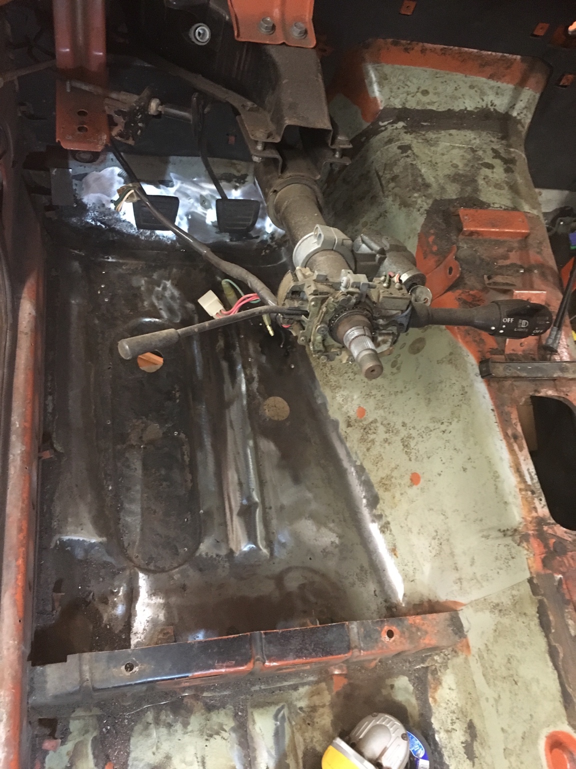

May 24, 20168 yr Author comment_495556 Worked on stripping the floors a little tonight. Not too much because I only had about 30 minutes, but the driver's side isn't as crazy rusted as I thought it was. Still gotta get in there under the seat brace, but I'm thinking I have less metal to cut out than I thought. Still beat up and full of rivet holes, though. Link to comment https://www.classiczcars.com/forums/topic/51541-1973-rebuild/?&page=14#findComment-495556 Share on other sites More sharing options...
May 24, 20168 yr comment_495561 Good news. Â Doesn't look too bad. Â Keep at it! Link to comment https://www.classiczcars.com/forums/topic/51541-1973-rebuild/?&page=14#findComment-495561 Share on other sites More sharing options...

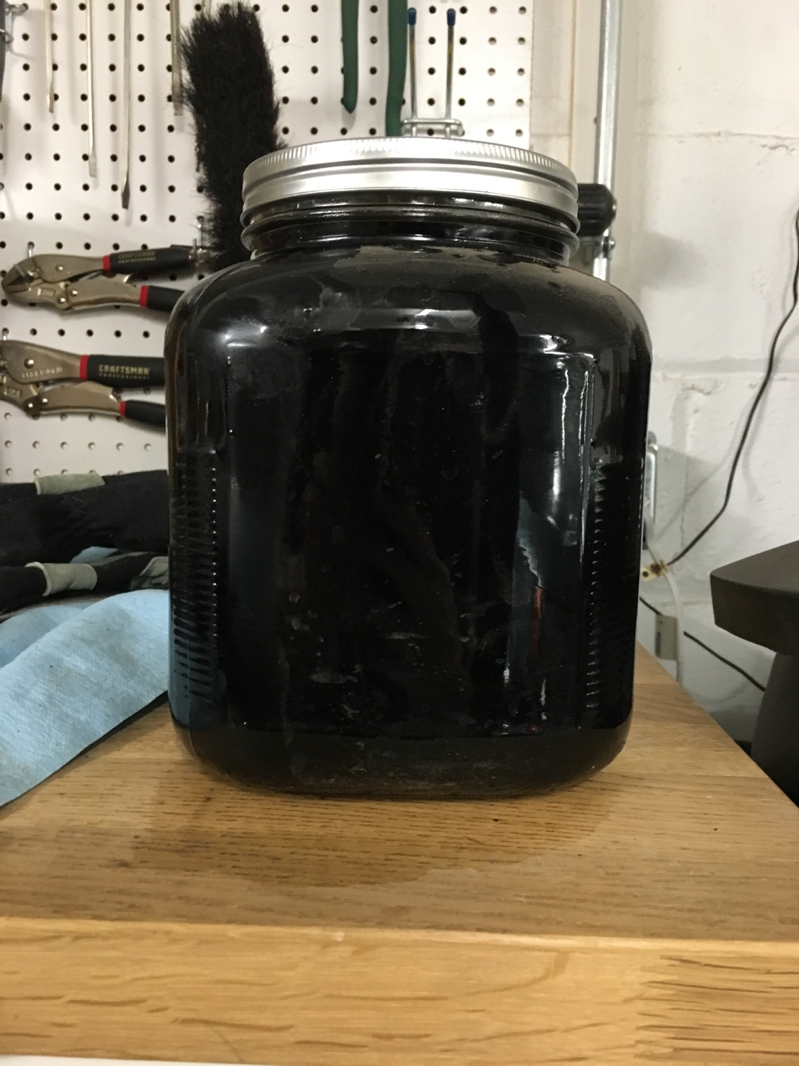

June 5, 20168 yr Author comment_496278 Drained my tank tonight. Last I checked this is not the correct color for gasoline: Also, it doesn't smell like gasoline. I don't know what kind of additives are in this but it's fumed up my house to the point where I am concerned about my children's future life potential. Link to comment https://www.classiczcars.com/forums/topic/51541-1973-rebuild/?&page=14#findComment-496278 Share on other sites More sharing options...
