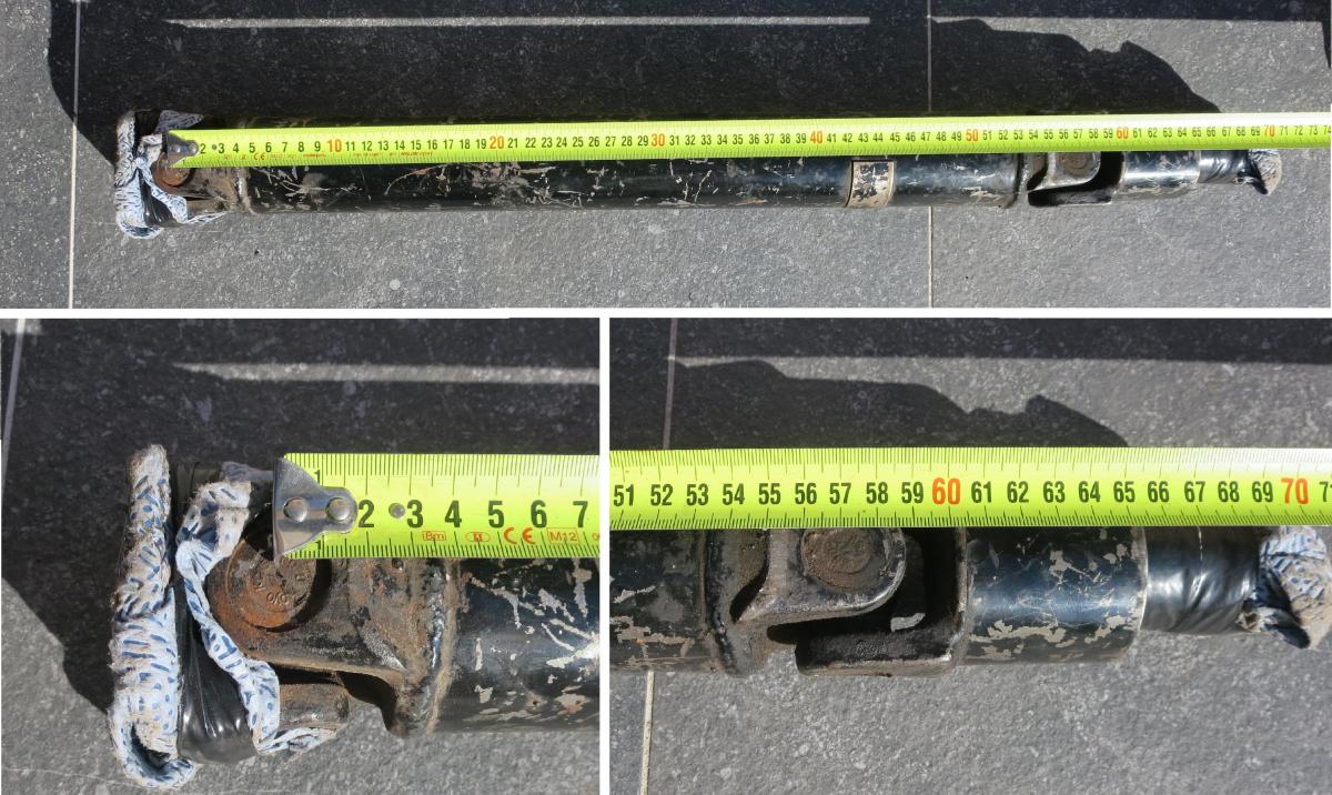

The standard (late) 240Z tailshaft is 22,5" (570mm). You could have the Series I tailshaft which is a little over an 1" shorter (30mm), but it is now a little bit shorter again due to the repairs. The series I should be a little under 21.5" like Steve mentioned in his post.
And for the info the 280Z, fitted with non servicable uni-joints, is 565mm (5mm shorter than the late 240Z).
I don't think you will be able to fit a late 240Z shaft in your situation. The shaft doesn't move around much (forward & backwards), but you still need 15 - 20mm to be able to mount it and allow some movement.
You could check if you have more than 50mm between the diff flange and tailshaft flange when the tailshaft is pushed all the way in the transmission.
33mm (22.5" - 21") + 15 - 20mm = 48 to 53mm.
A straight mustache bar doesn't say much. To move the diff back you simply turn it around (backwards). The way you can tell is by looking at the transverse bar connecting the lower control arms. If its straight than your diff is forward (early series I). if its curved around the diff than its been modified to the later position and the centerline is inline with the wheels.
If you are running with a 21" tailshaft I would suspect the diff in in the original position.
Here are some photos of one of my spares tailshafts. I thinks its from a 73 240Z.
post-25317-0-04570700-1429462910_thumb.j
