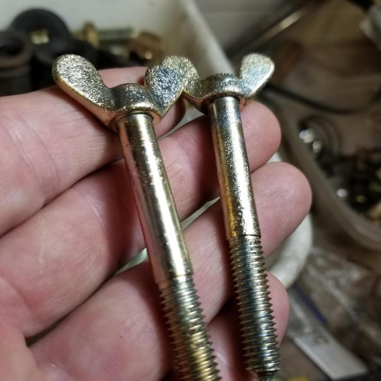

I did not realize that the ends of the air filter bolts were brazed on. It might be hard to see in this photo
The color and finish is pretty good on these but I don't like how the pitting showed up on the butterflys. I make take these back down and do some sanding on them to minimize the pitting. I am still running pretty high currents right now. So I have ordered some chemical and am going to try to reduce the resistance across the tank some on my next plating day.

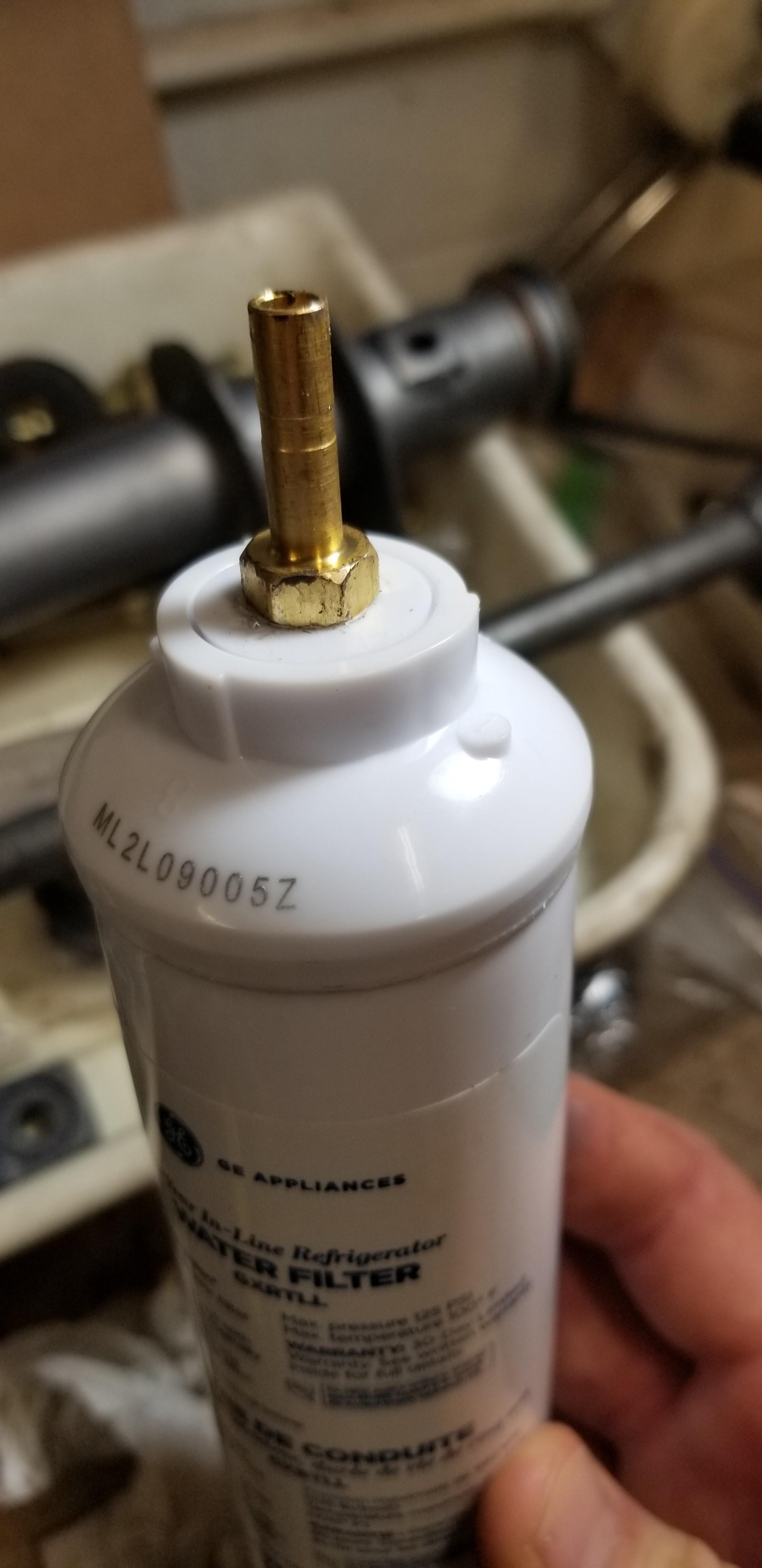

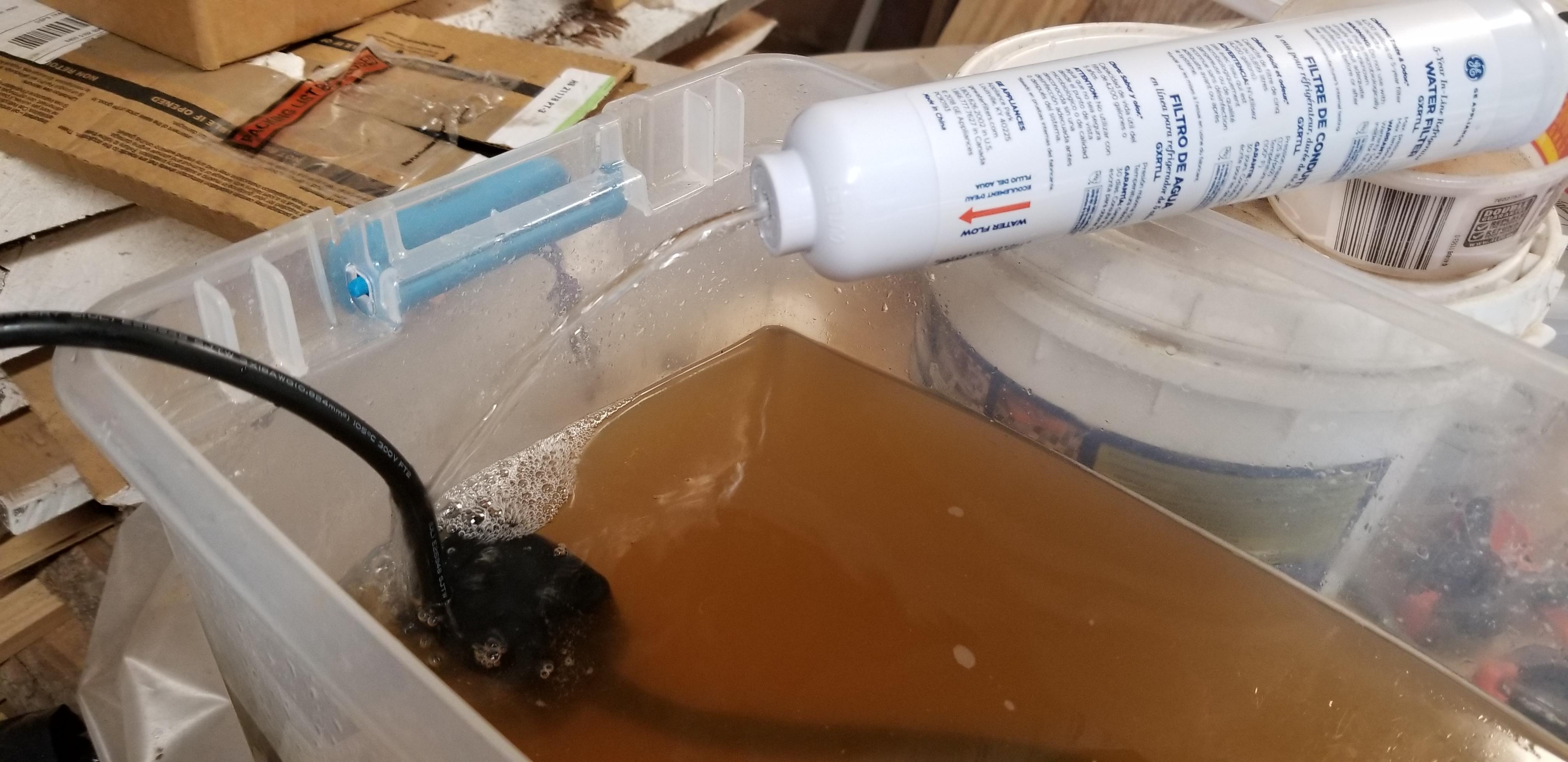

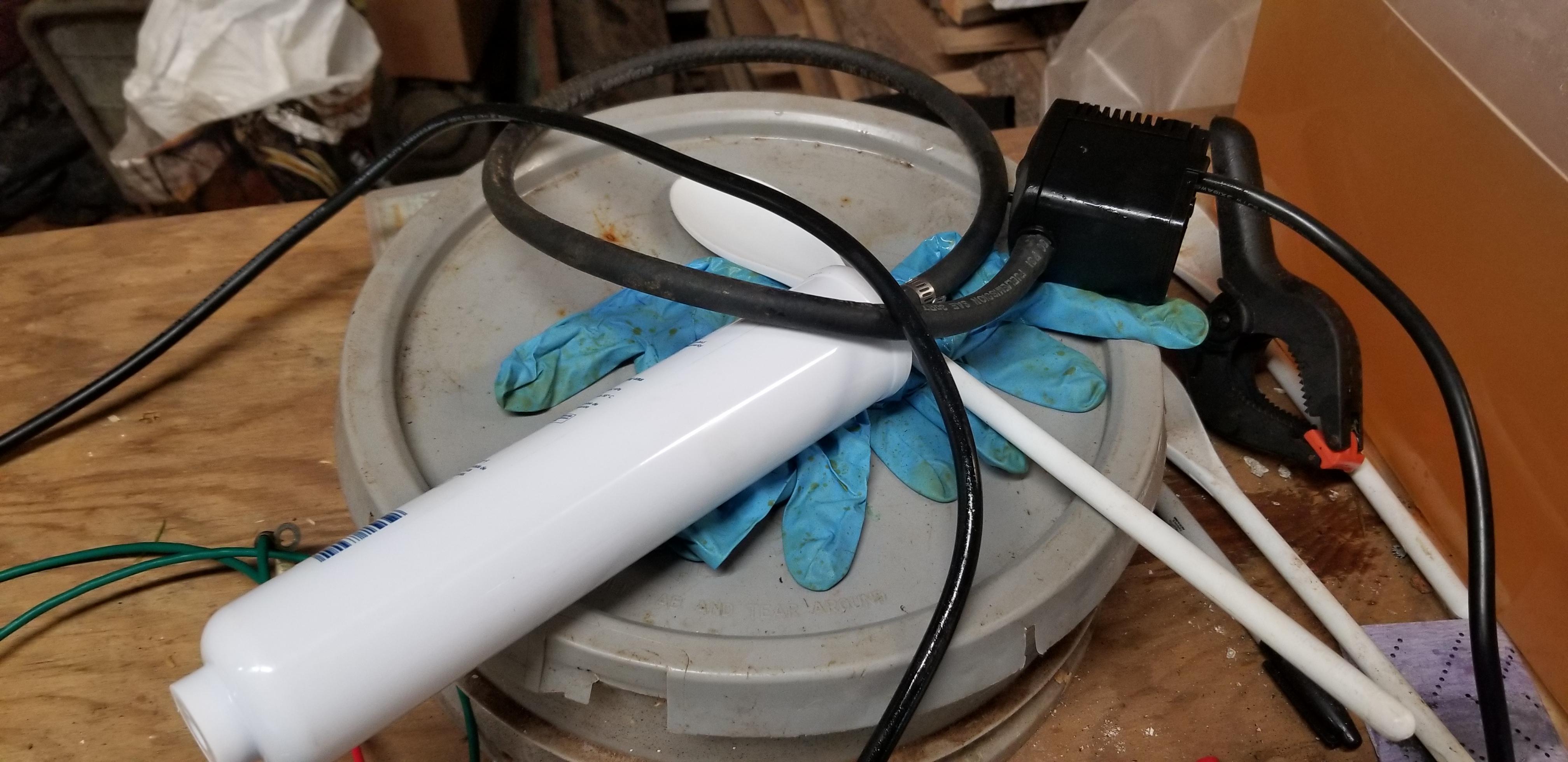

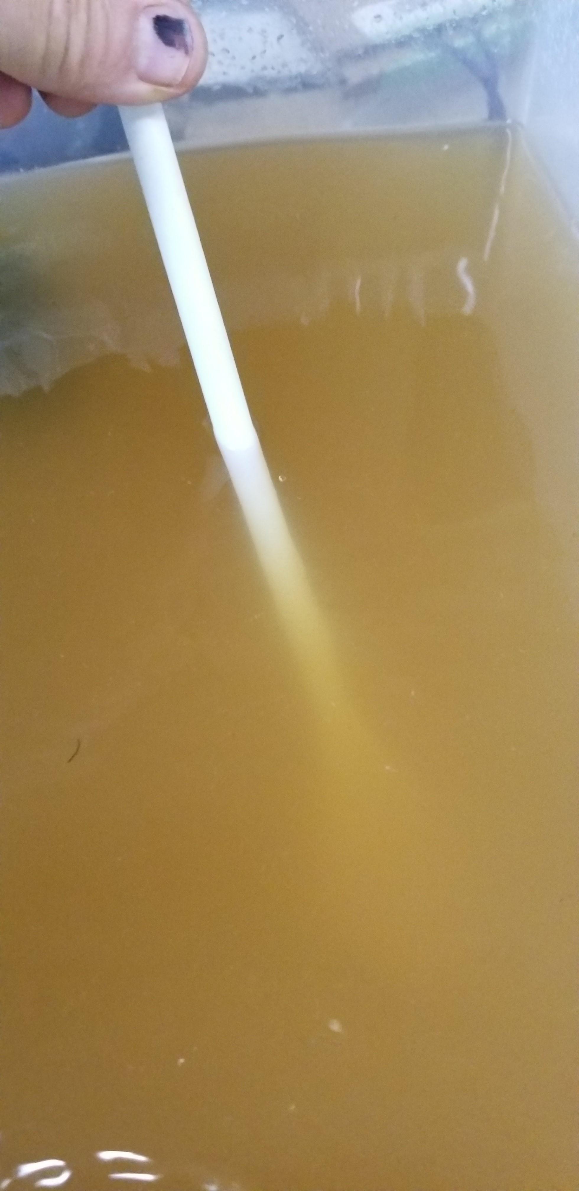

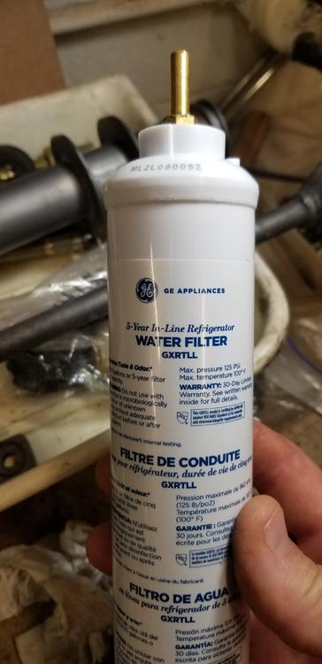

My bath had gotten kind of cloudy and I am sure I get a lot of "drag out" from my degreaser and pickle tank, so I decided to charcoal filter it. Seanc on the Caswell forum suggested a fridge filter hooked to the aquarium pump. Works great!
Now the brass end is supposed to be installed in the reverse way. Shank in and threads out, but I tapped the end of the filter and left the shank out to attach to the hose.
45 minutes later
Now the only downside is this will remove any brightener from the bath. Seanc said in some other posts on the Caswell forum that he doesn't even use brightener. That he gets better results with out it. So we will see how my next plating session goes and whether I can get shiny plate with out the brightener

There was a guy on you tube that ran a filter full time on his bath. He had a decent sized pump under his bench and like a 10 gallon tank. I tried to ask him on you tube, what kind of filter he was running. I assume is was a particulate filter, but I don't know what micron. I wouldn't run the charcoal filter full time. It would be nice to run a different pump setup. Caswell sells a little giant chemical pump, but I think it's overkill for my little tank and it's expensive. Maybe one day...

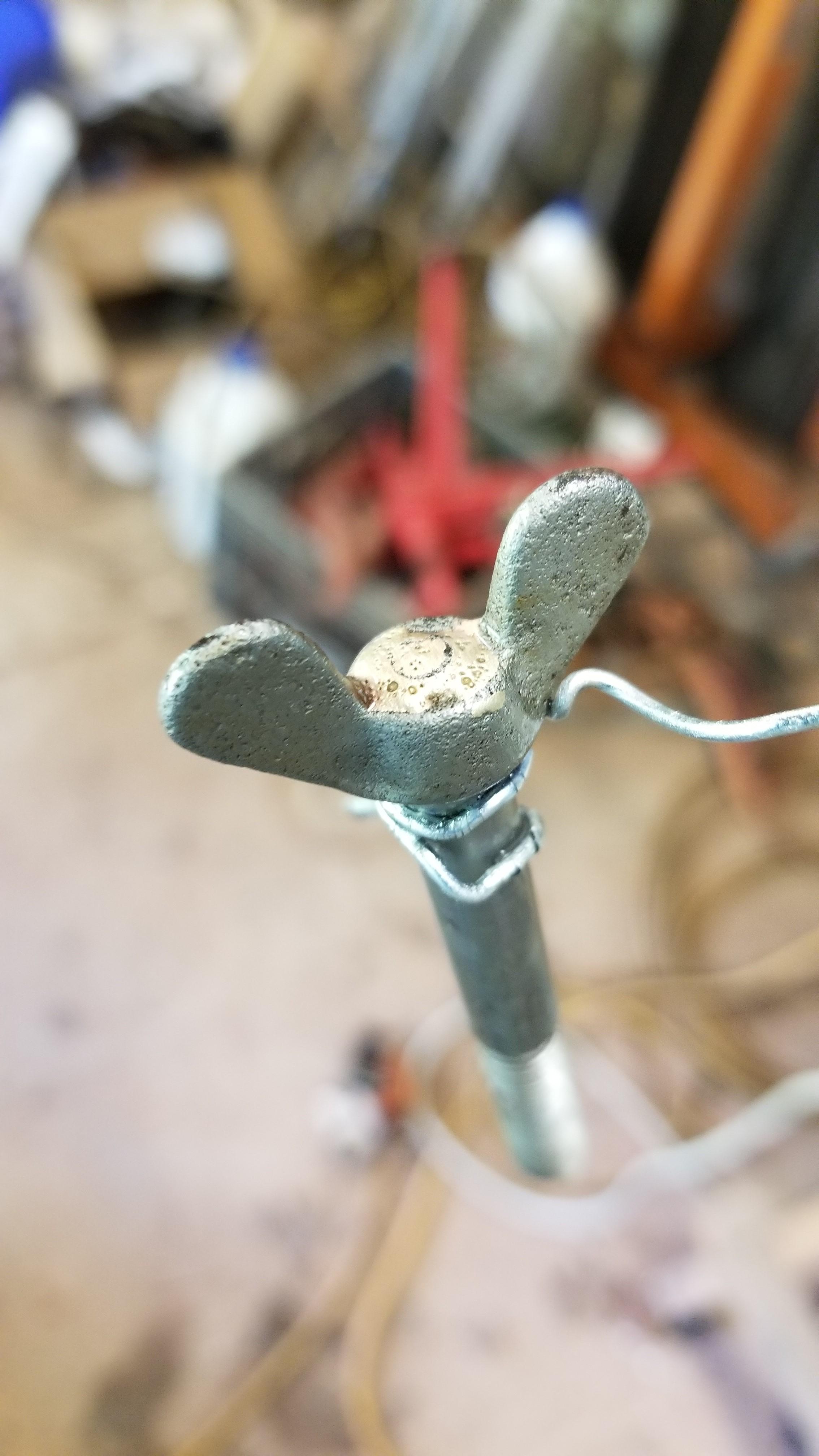

Tried to plate last weekend but my tank heater was dead. So I got another one and did some plating this weekend. One thing I did was plate some studs on a booster. This part is fully painted except for the studs
Wired up
Suspended right at the top of the tank

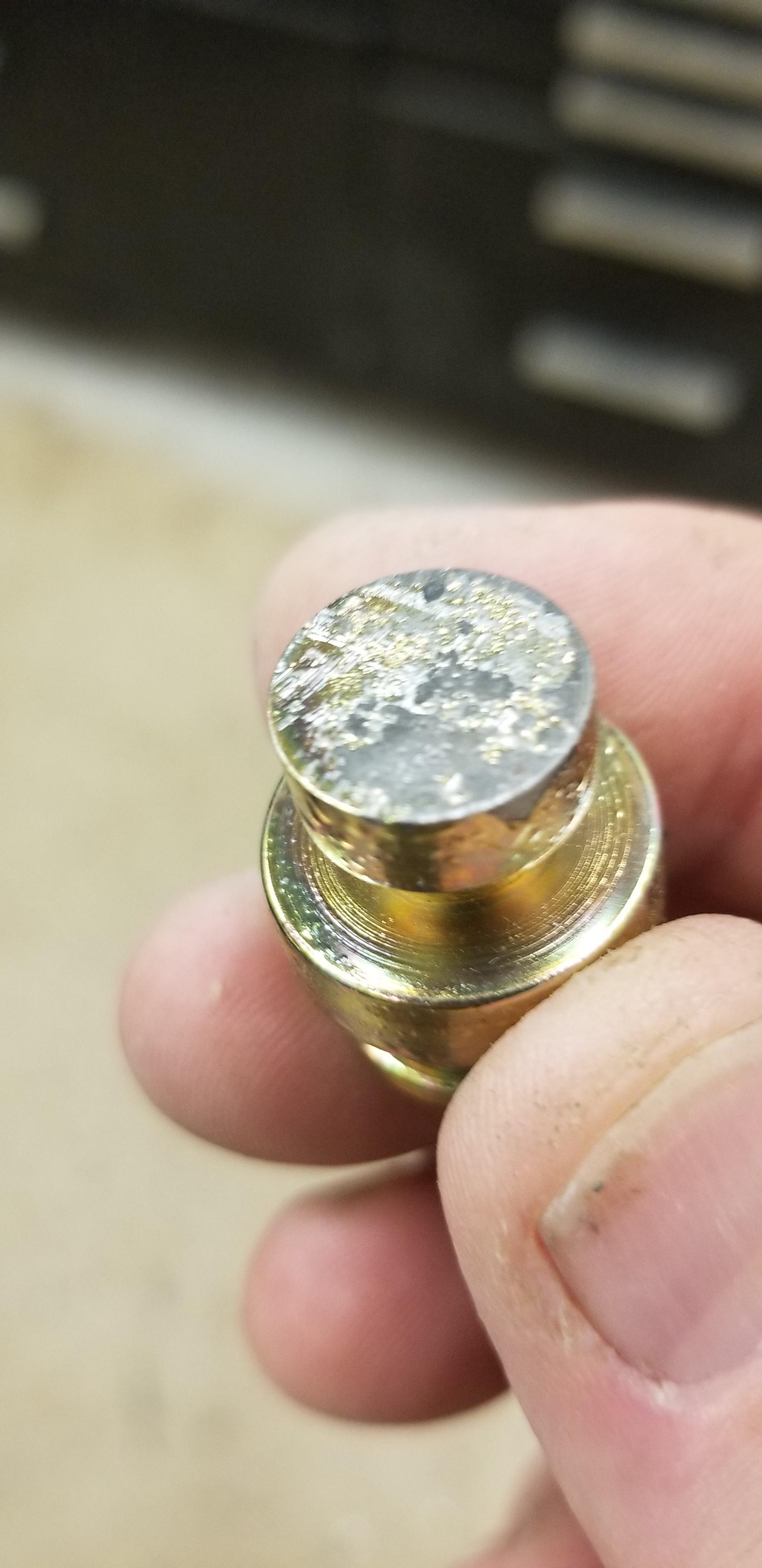

Turned out pretty decent. I am unsure why the ends of the studs didn't really plate. It will be ok, since these studs are under the dash

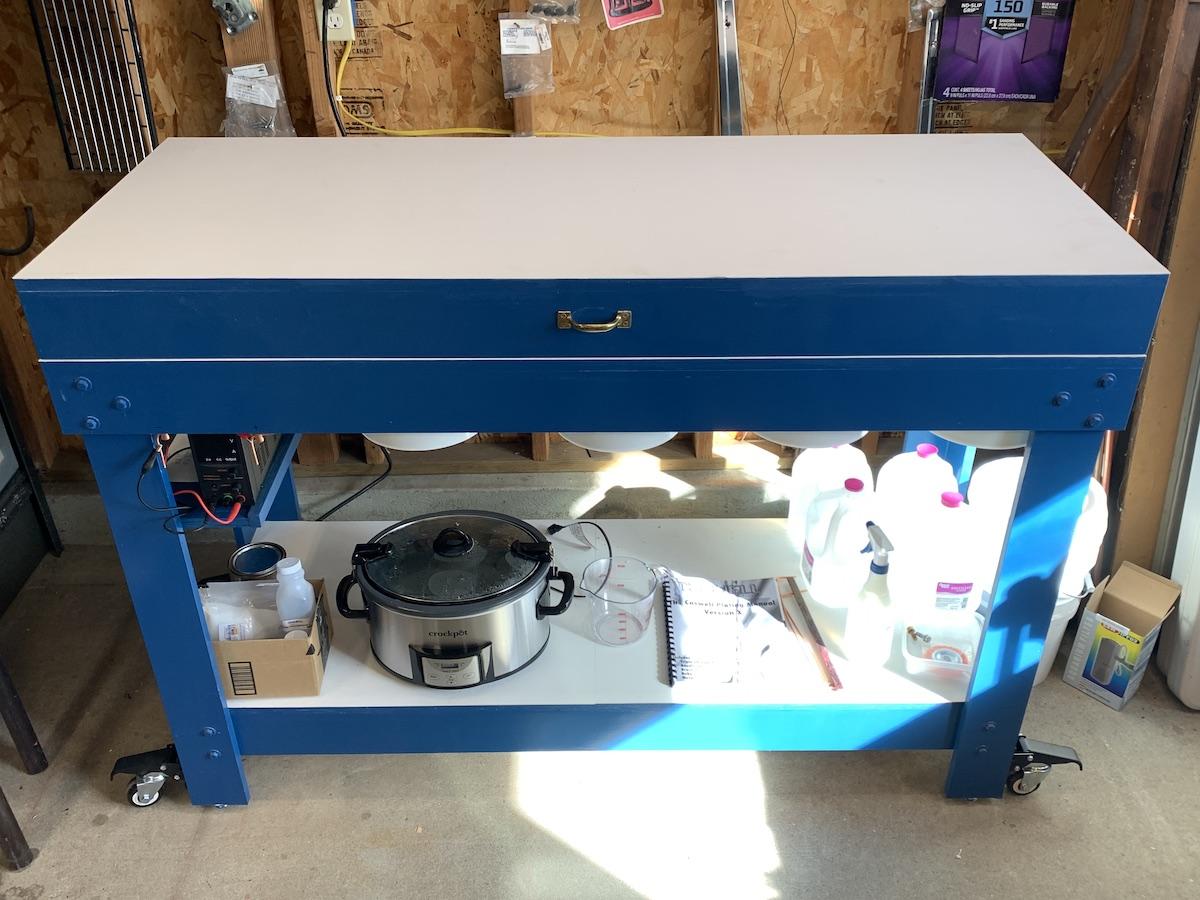

I've been lurking on the Caswell thread for months, and finally pulled the trigger and bought the 1.5 gallon system.  Built a cabinet: 2 sheets of plywood and sheet of poly from Home Depot, removable casters and power supply from Amazon, and Crockpot from Costco.  Didn't want it any longer than 6 feet long, and wanted a fold down top so it's not a wasted space and I can also use it to work on whatever.  Rustoleum Royal Blue paint looks surprisingly like the color of my 240Z block. 🤷‍♂️   Just starting off with small pieces and fasteners as I work on various stuff.  So far, some success, some so so.  Need more practice to get the routine down.  Nice to be able to learn from others experiences.
