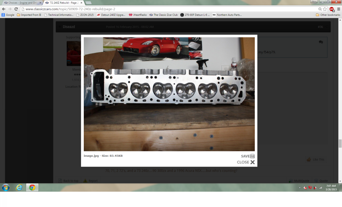

I'm doing an E31 now, or a machinest is.  They need the bronze intake vale seats replaced with steel, very basic start.  I am going with the big valves like your P79 has.  If you wanted to you could have the bottom of the P79 cut to raise the compression but you'd have to raise the height of the cam with shims to compensate.  Member "Dizeased" has done a few and loves them but he goes all the way with his, all new cam and valve train componets.  One day I'll hopefully be able to try his build.  :)
Here's a picture of one of his.

I've looked at the write ups on using the P79 and modifying the cam towers and shaving the head but decided not to go that way for a variety of reasons. Madkaw, I should have also said that if the E88 or E31 are used they would be completely rebuilt, not simply bolted on. Siteunseen, will your E31 go on an L24 or L 28 block? Are you leavng the exhaust valves alone and only adding the larger intakes, or making  other changes as well?
https://www.classiczcars.com/forums/topic/51195-choices/#findComment-466643

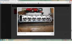

It has both of the larger valves.  It would bolt right onto a 2.8 block without any work but I'm putting it on the 2.4 block which requires some extra grinding so they won't hit the smaller bore of the 2.4.  Bore releifs, notching the block and valve releifs are some of the terms I've heard so far.  As for other changes I'm adding a better breathing cam coupled with it's accompanying componets.
I should add that a smaller cam isn't necessary, I'm just bored.  It's been a long winter.  :)
post-23570-0-29443500-1427061294_thumb.j
post-23570-0-60292400-1427061269_thumb.j
