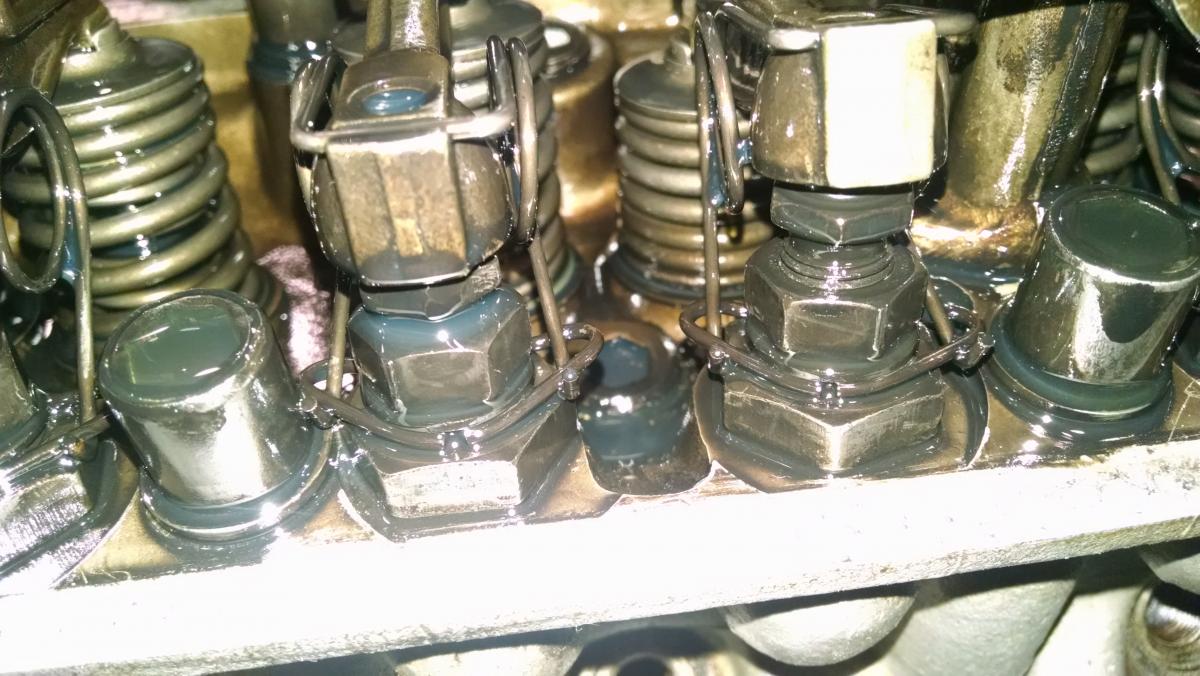

Hello .. I am in the middle of adjusting my Valve Lash and as I removed the Valve cover I noticed my rockers' lock nut and Adjusting nut are not Stock.  This leads me to believe my Cam is not also.. so before I go to far on adjusting I'd like help on getting some questions answered.  Engine was rebuilt about 25k miles ago and runs absolutely great.   Last valve lash adjustment was done about 20K miles by the prior owner and he does not know the specifics of the rebuild other than is was "enhanced" and has a 9.5 : 1 compression ratio as a result of new valves & seats, pistons, stock block bore & hone.   Any insight or help is appreciated.

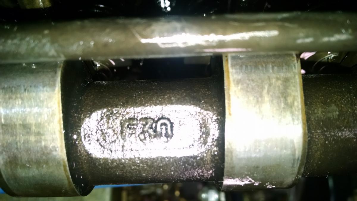

1) My L24 cam has F30 stamped on it (see photo), is this stock or not?
2) My adjusting nut is 17mm (vs 14mm stock) and lock nut is 24mm(vs 17mm stock).   Should I adjust the Valve lash to FSM L24 spec?

3) If the F30 Cam is not stock, what should I adjust my valve lash too or doesn't it matter?

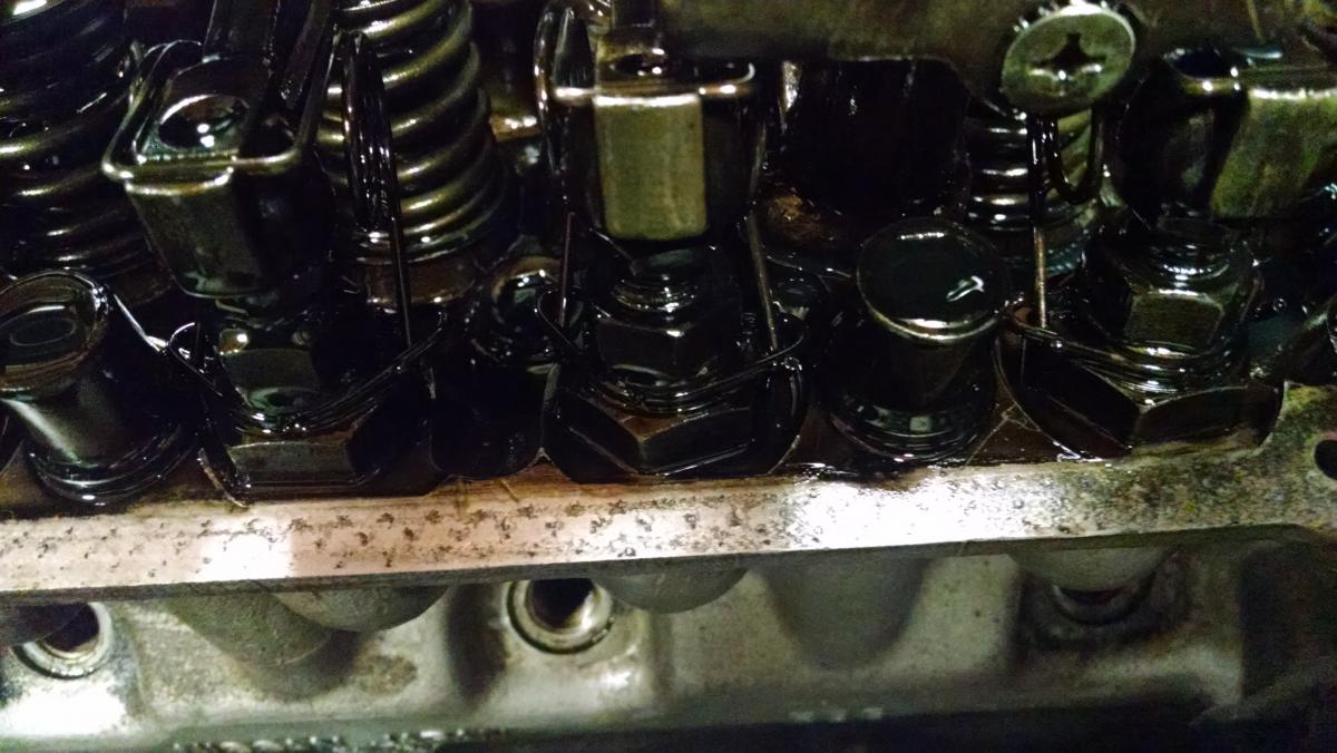

Sorry, I think you are confused about which hex items are the adjusters and the lock nuts. The 24mm hex at the base on the head surface are NOT something you undo. The 17mm lock nut is above that, and the 14mm hex that you rotate to adjust height, are on the top of the balls that seat in the end of the rocker arms. They are just hiding under the end of the rocker arms. Take a closer look, I see them in picture 4.
As far as correct lash specs, using stock specs is perfectly safe. All your sacrificing (maybe) is some performance. Just make sure you have SOME lash and you can't hurt anything.

Ah ... thank you ...   My error.  As you can tell I am new at this....
Great help here... will let you know how it turns out.

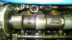

BTW......The cam doesn't look like a regrind (looks stock). If it has been re ground, the cam grinder usually etches the profile on the back end of the camshaft (you would probably need a mirror to see it in the car), but yours looks bone stock.
Well I'll be damned. You are absolutely right. Cam numbers and lobe separation are engraved on the sprocket end of mine. Learned something today.
