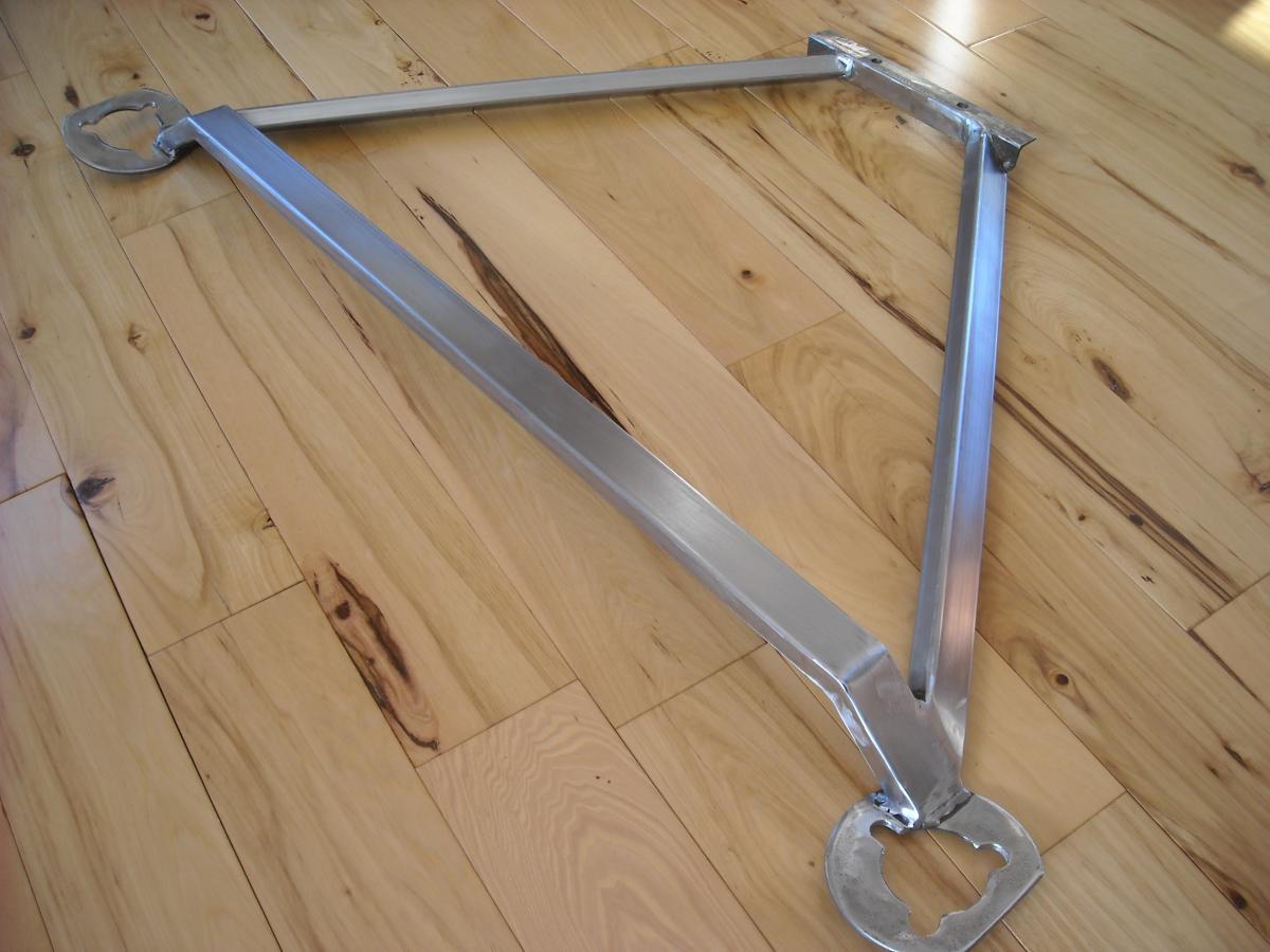

This is the rear shock tower brace I made for my Z,  I'm now making up a bunch of other sets for guys in my local Z club and started wondering if there might be an advantage to fixing the bottom of the diagonal brace to one side over the other.
Can anyone see an advantage one way or the other?

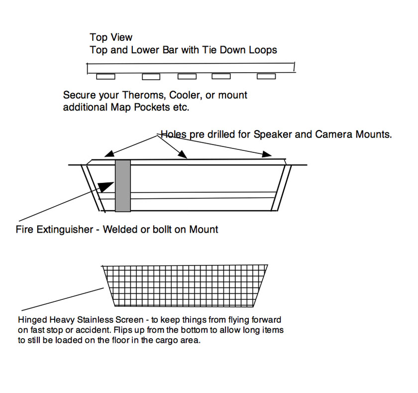

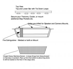

looks really nice - i've been thinking about a similar brace that was a pair of diagonals, or a horizontal "X" which would put a lower point in the center. this would make it easier to access/use the storage space between the brace and back of the seats (which is a perfect place for a couple bags of groceries).
not to hijack, but maybe a broader design discussion? any thoughts on this?
Regarding the direction of the diagonal brace:  it doesn't matter.  A straight bar is plenty given the factory diagonal braces already installed.

As to your question - I don't see any difference between bracing one side or the other - but then I'm not an M.E... I could see the suggestion of using an "X" between the two sides - to help keep the floor or that section of the body from flexing. Up front you have a strong cross member holding the engine - and a strut tower brace above. With the rear you don't really have a lower structure as strong. At least no one else is offering anything like that {effective or not - LOL}.

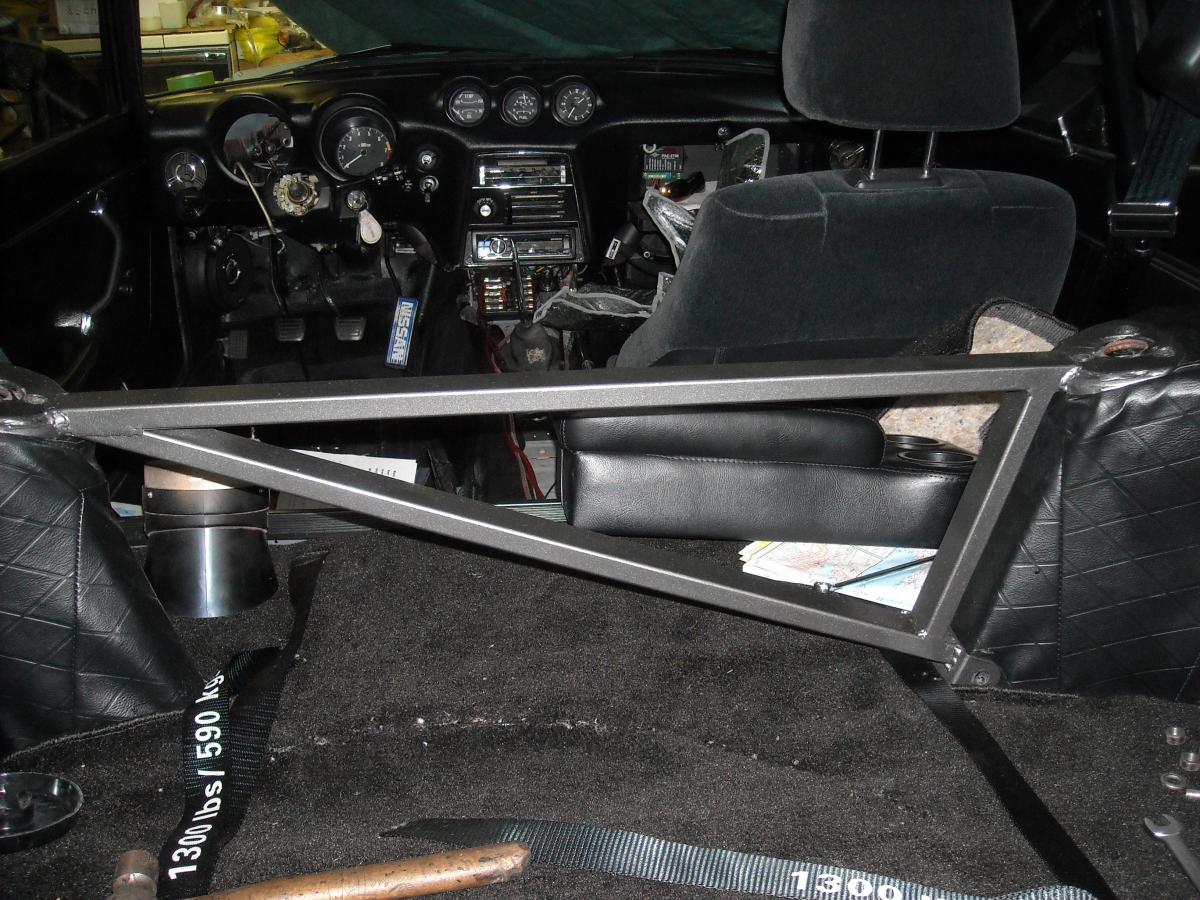

 Many years ago during a Conference driver training course at PIR, I found the rear end in my stock 71 Z wanted to hop rather than slide in an oversteer situation. I installed a roll bar, for novice racing, mounted to the shock towers & the front side of the wheel wells (no x bracing). The change was quite remarkable. The rear slid, instead of hop, in a very controllable manner. I've always wondered how much deflection, in all directions, that simple addition eliminated.
  Many people shy away from roll-bars in a street machine but they are a great way to reinforce a uni-bdy car.

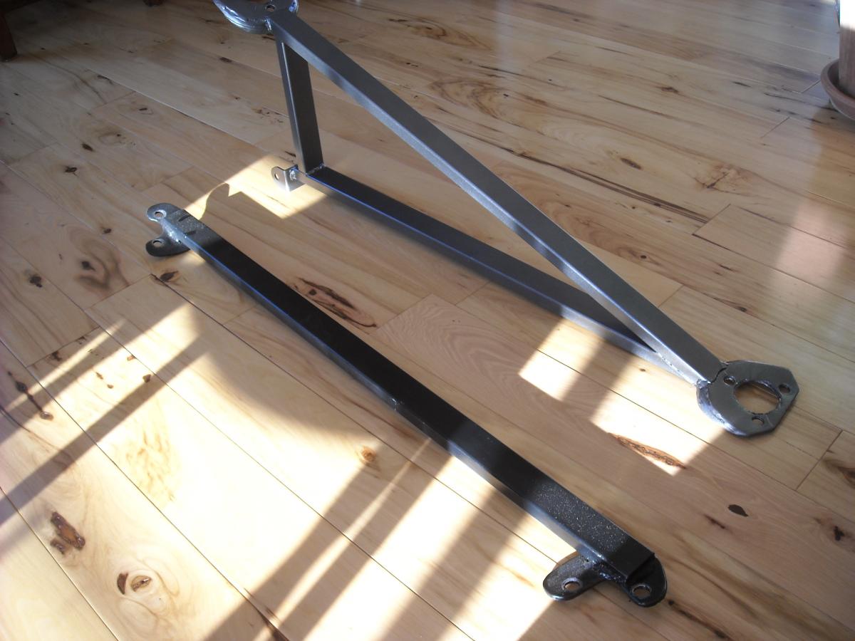

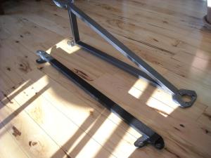

I built the black single bar rear brace in the foreground a couple of years back,
post-25243-0-43214800-1425073299_thumb.j
It seemed to me to really tighten up the rear end, but then read somewhere that the triangulated rear bar was even better so I put together the grey one behind it last fall. I haven't had a chance to wring the car out since I put it on BUT I noticed right away that most of all the squeaks from the  interior panels had disappeared. I hadn't really noticed how loud they were until they were gone.

Well that answers my question, also another good thing about having the
diagonal bar attach to the lower passenger side shock tower is it's a great place to secure a fire extinguisher that is easily reached from the drivers seat.
