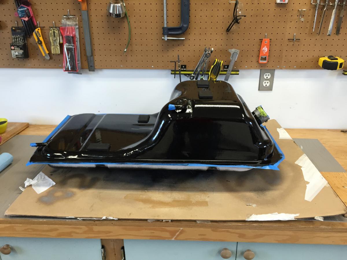

So my tank has been boiled out, POR15'd and ready to install.    I have new fuel sending unit, new filler neck, new vent and fuel lines on order (Should get them from GreenLine Hose early next week).
So I was wondering if anyone had any tips to help with the install.  All those damn hoses are going to be a pain to hook up.  I'm figuring I'll put the fuel filler, the vent tank lines in place and then with the tank supported, but not all they way up start with the fuel in and out lines as well as the fule filler neck and work my way around on the vent lines.
I remember when I dropped the tank, getting to some of the clamps and pulling the lines off was really tough so any hints would be appreciated.

Nice paint job.  You're pretty well on track with a sequence.  The new filler neck should be first, then the vent lines to the collection tank.  Position the tank as you said and connect the two topside vent lines visible in your photo.  Work the tank into position (a floor jack works well) and mate it with the filler neck - don't forget to pre-position the clamp.  A bit of grease inside the filler neck really helps.  If the new filler neck is too tight, warm it with a heat gun.  Finish getting the tank up and secure it with the straps.  The small vent and fuel lines on the front can be handled last.
I did all this solo on my back until mating the filler neck.  A neighbor help stabilize the tank while I fought it into position.  So...an extra set of hands can help a lot and getting the car on a lift is a bonus!  Good luck.
