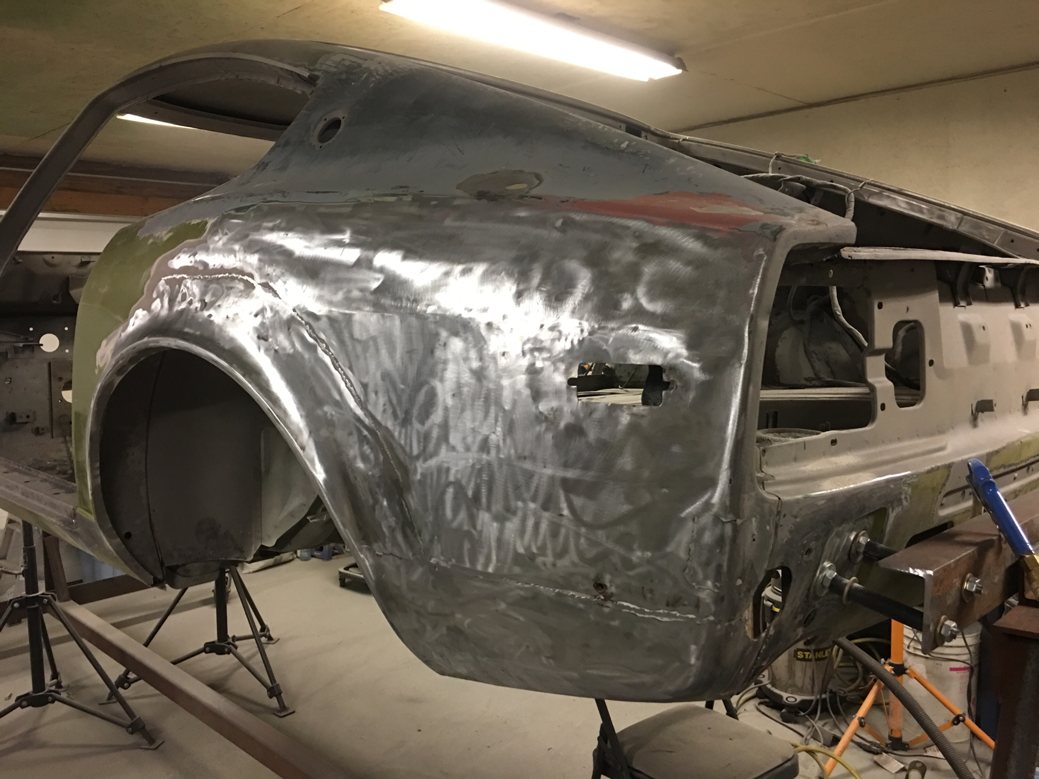

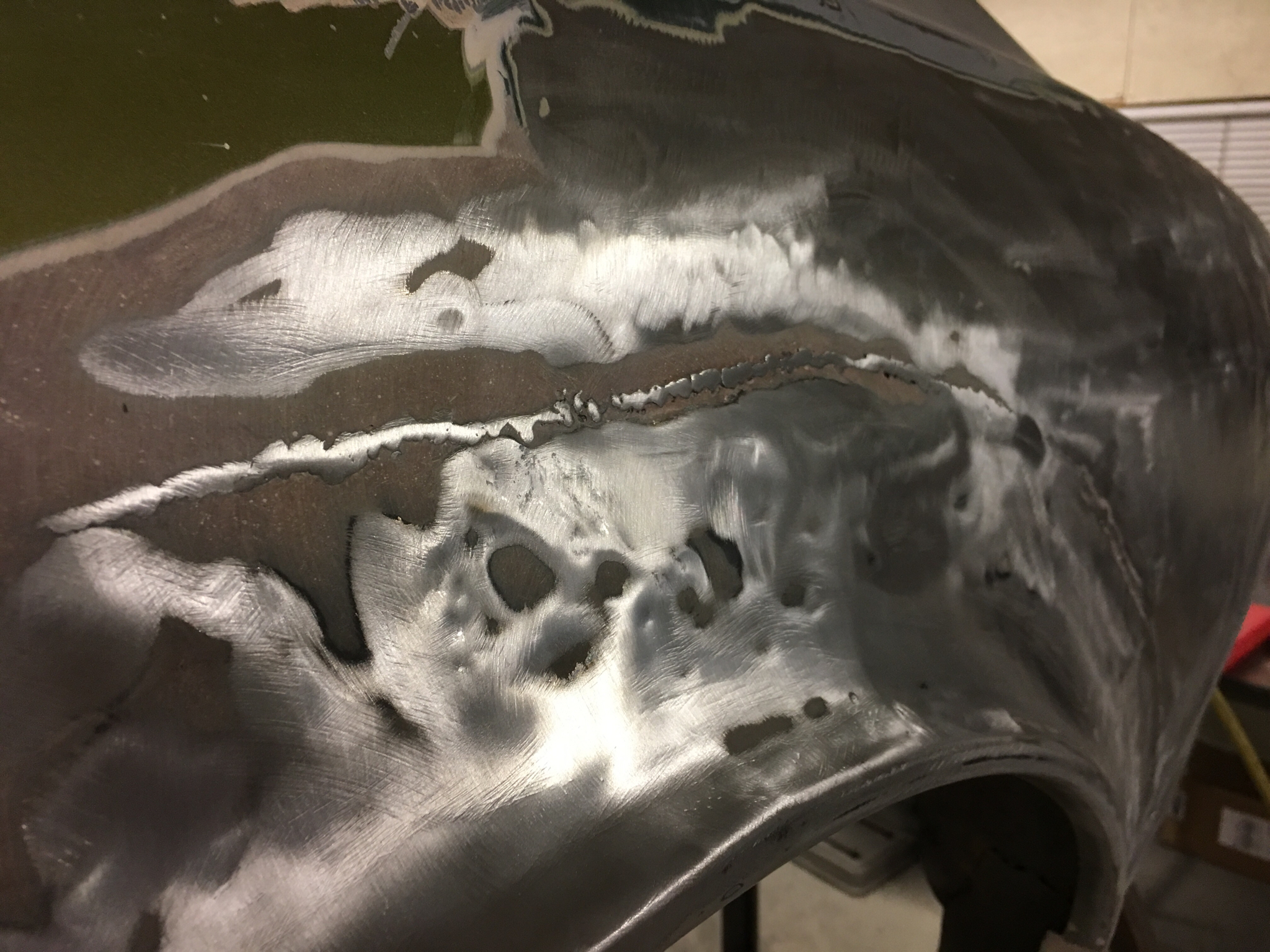

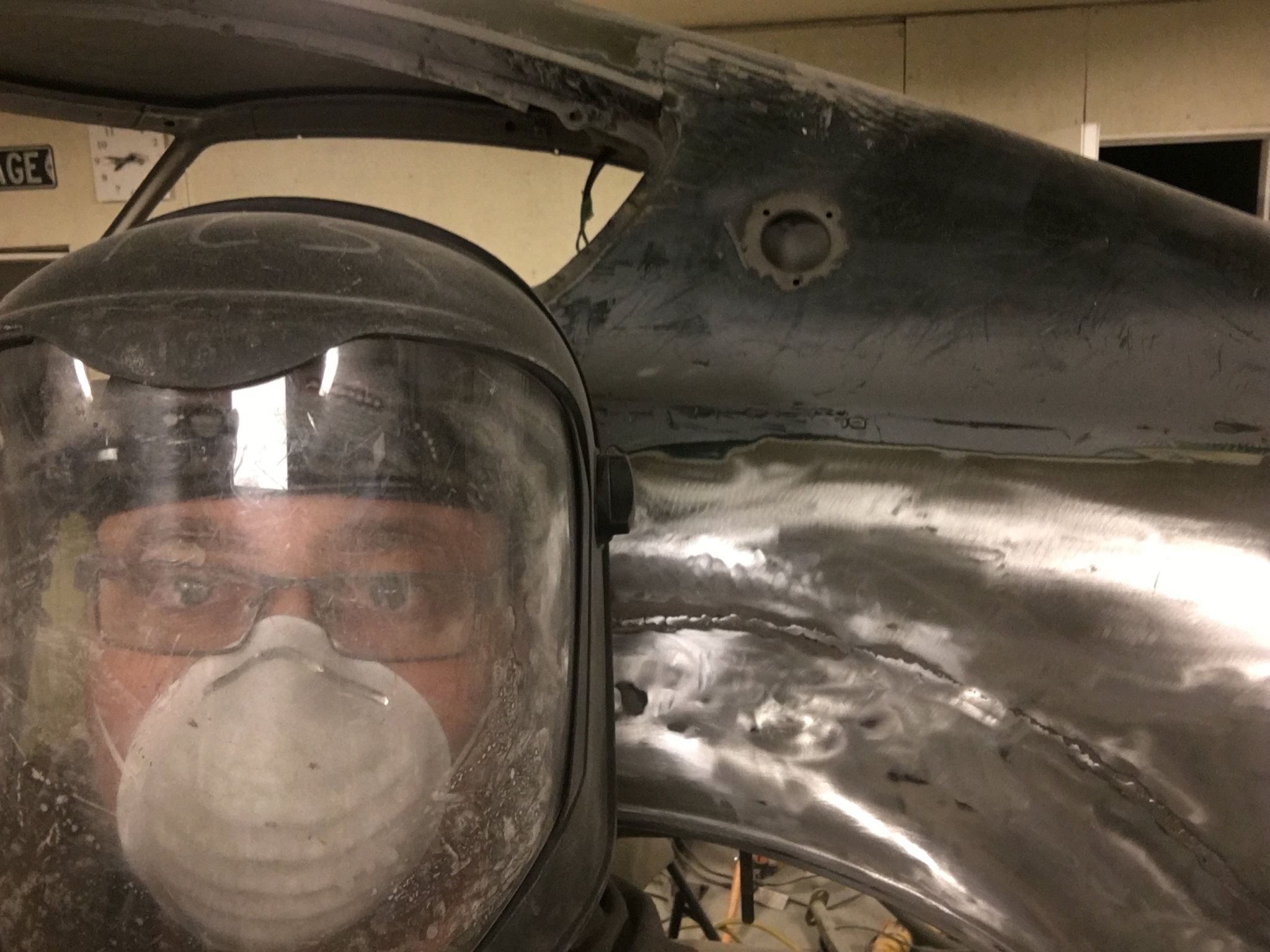

Nope. I am currently removing almost the same amount from the driver side. The metal is good but the welding/fitting was sloppy.

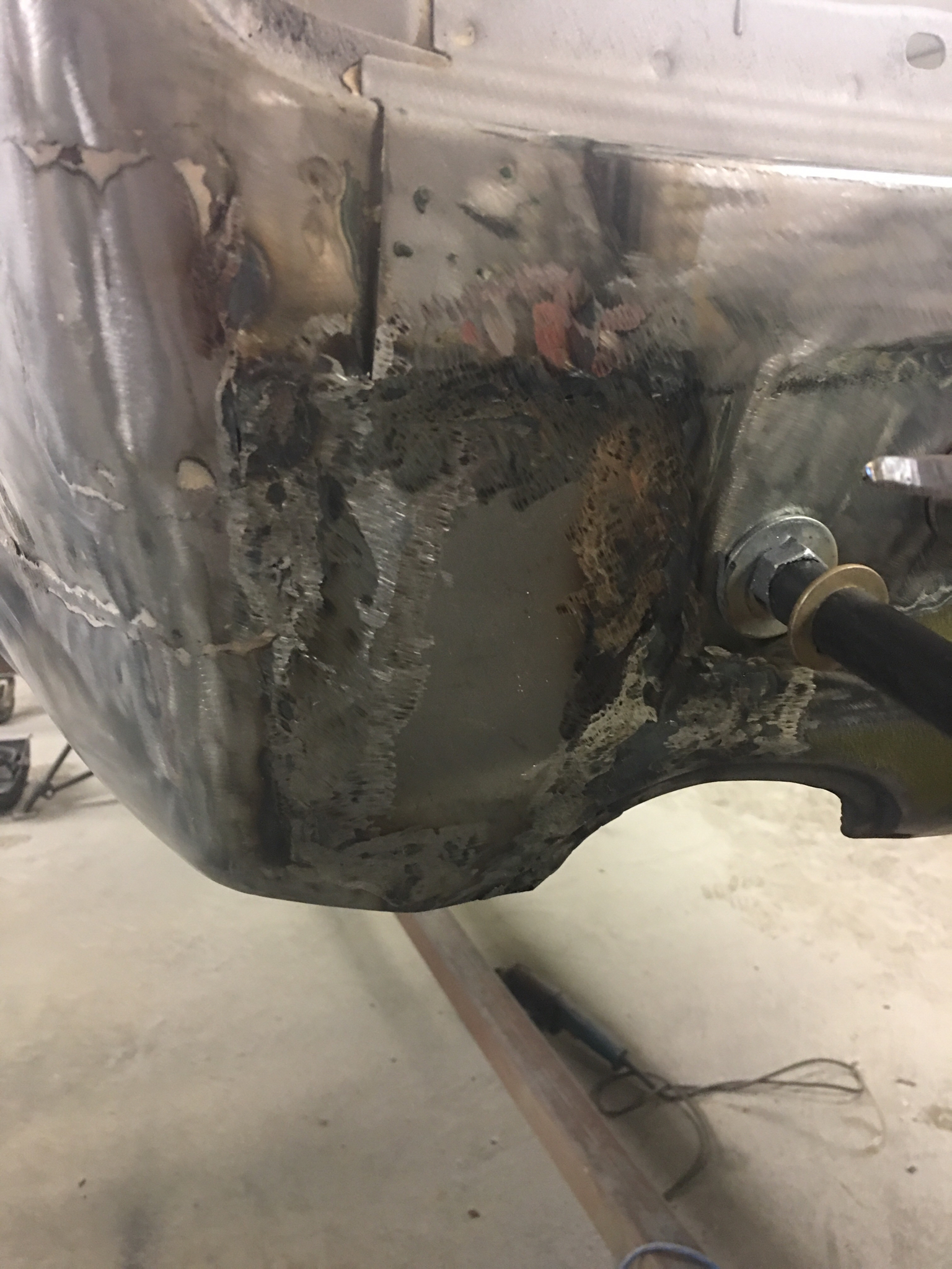

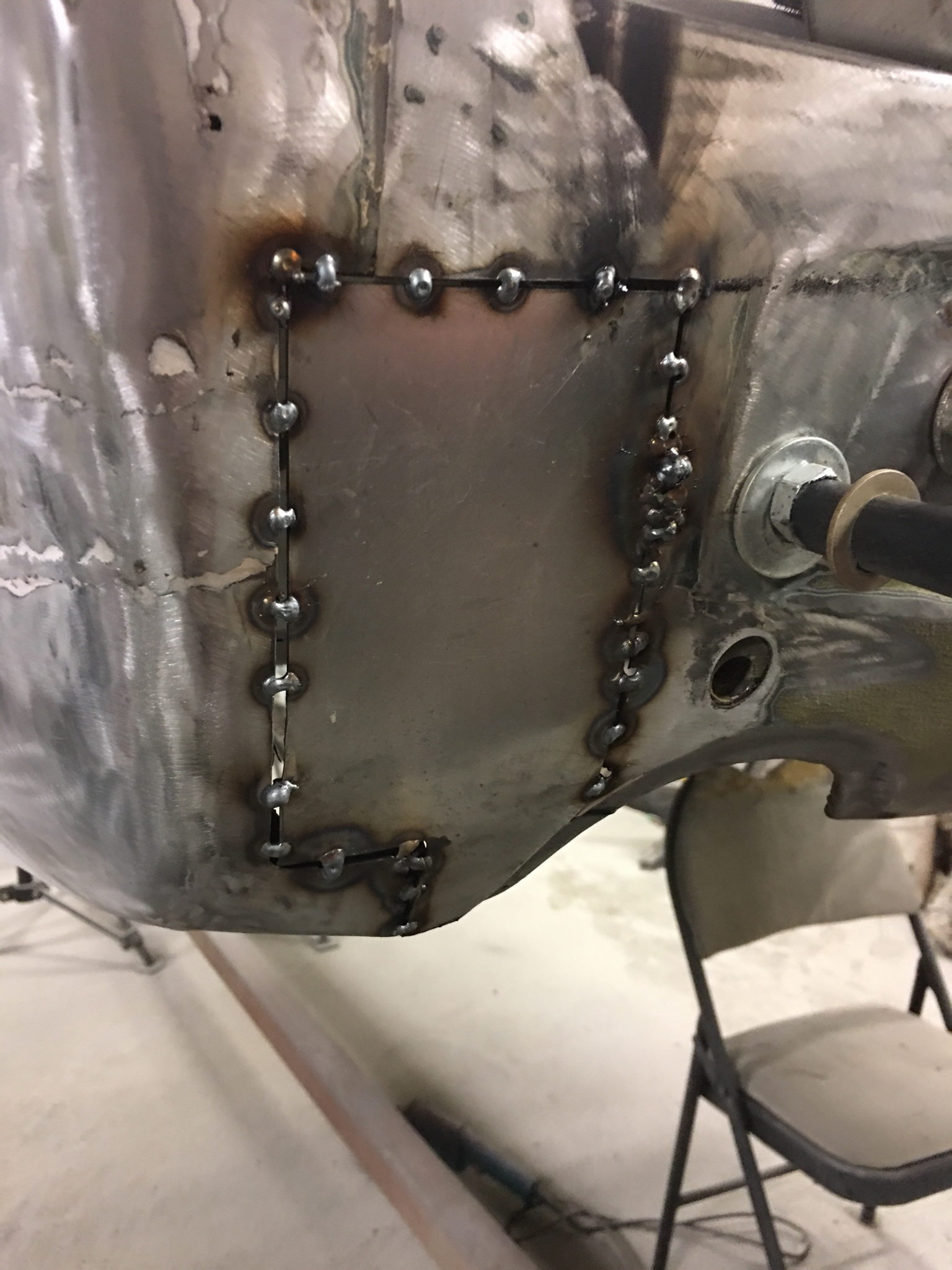

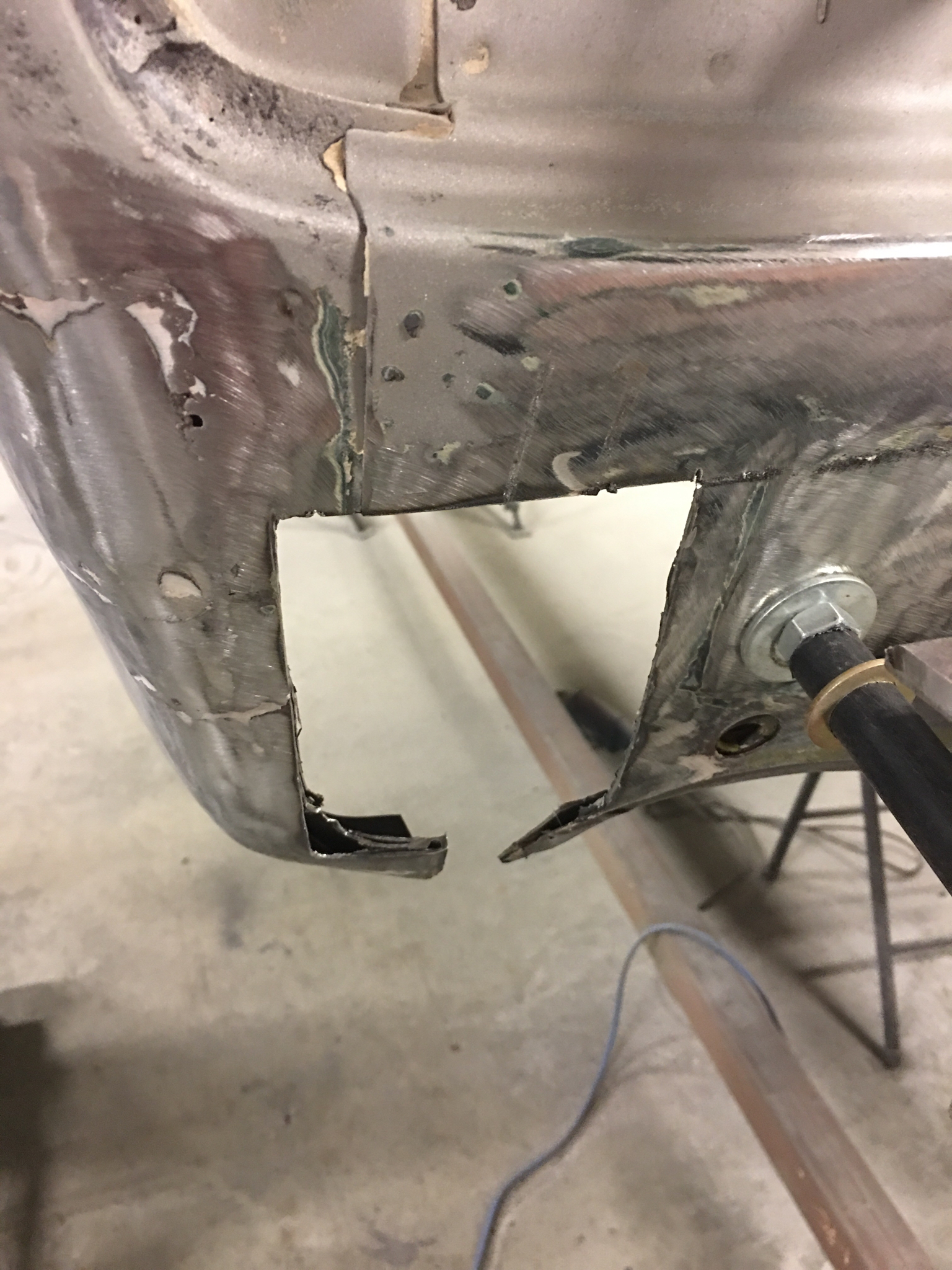

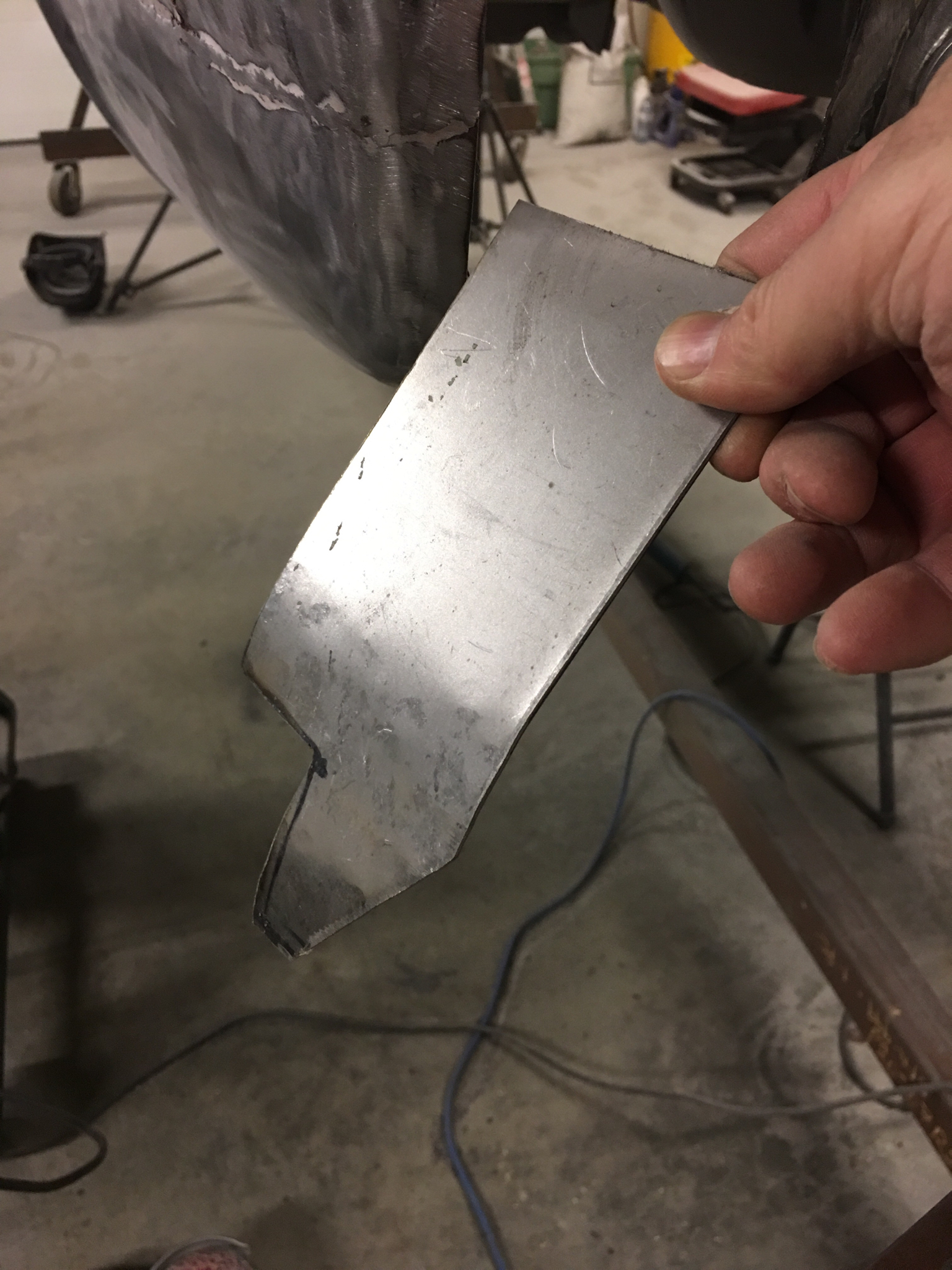

Decided to end the night with a little fab work. Cut a piece of 14ga to fill the old bumper shock mount and repair some bad metal work from the PO.

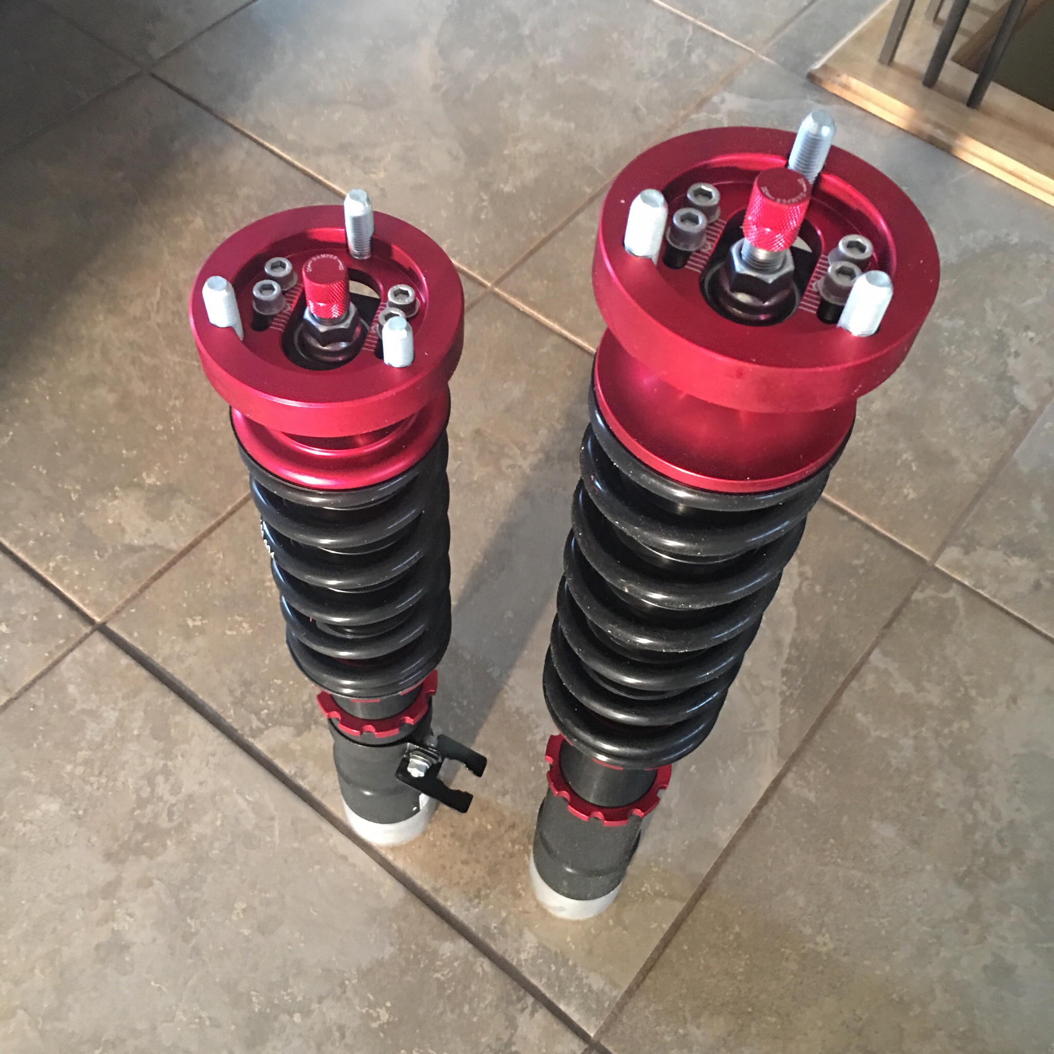

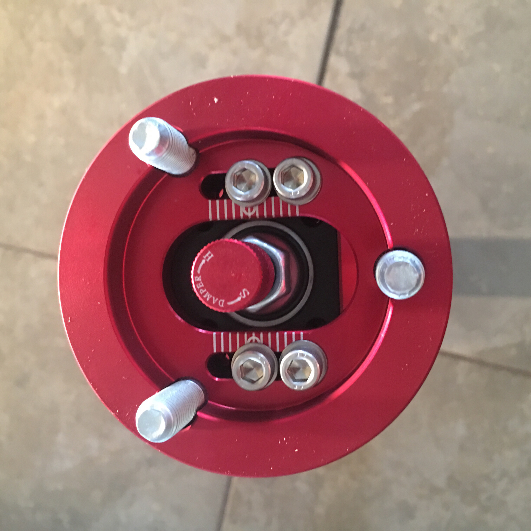

I might just do that. I ordered the coil overs with camber plates already and I will be using the TTT lower control arms that are quite adjustable.
My plan for tires and wheels was a set of Rota RB 16x8 or 9 and a 225 60r16. Offset I'm not sure of. I was planning on a factory order as I will also be going 5x114.3 with the big brake kit.
Rolling the fenders might help, but might not be necessary. I would like to run about -1.2 camber in the rear and -1.7 in the front.

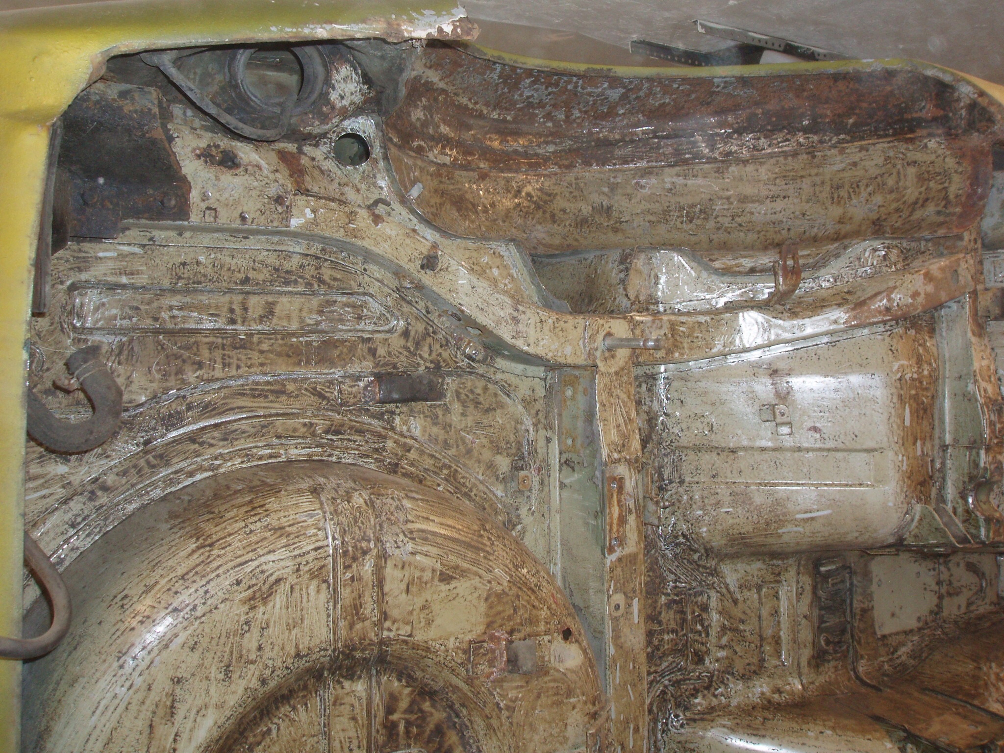

Did a little more welding and grinding. Took some time to start fabbing a complex curved replacement patch for the other side wheel well.
