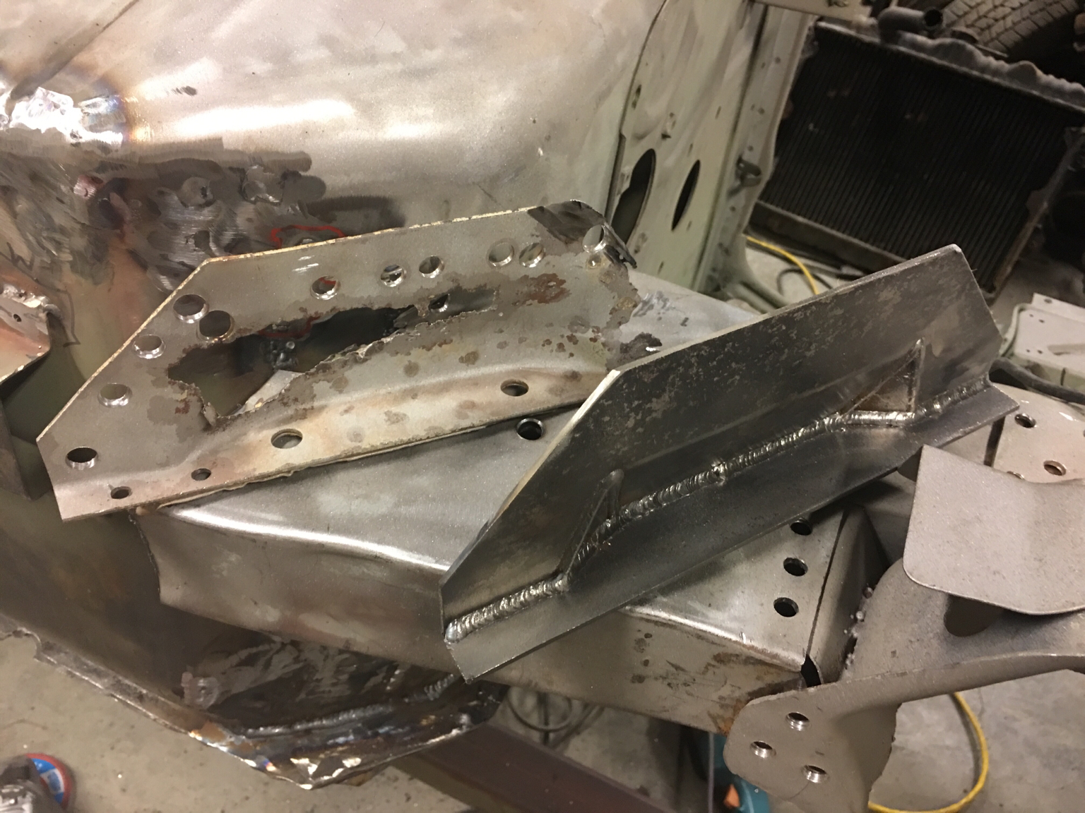

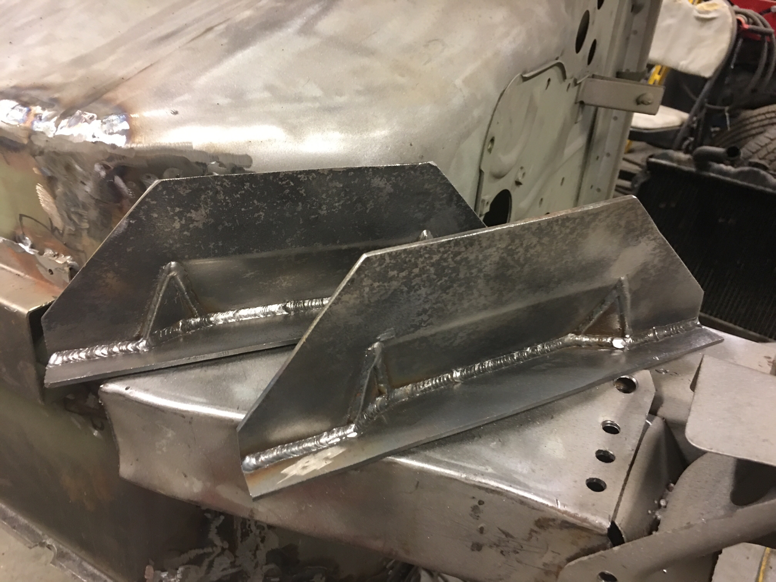

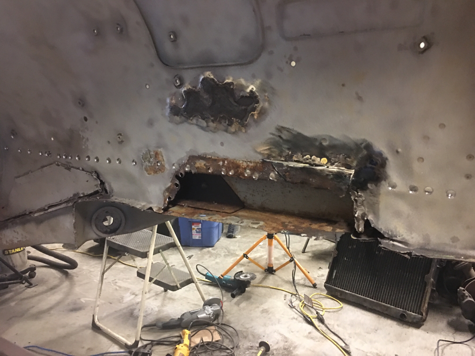

I have been chatting with Charlie from ZeddFindings. He has not had anyone else mention the 280Z frame rails being different than the 240Z before... strange! However, he also mentioned that he was considering manufacturing and selling the reinforcement plates like I made along with the frame rails. He hasn't had any requests for them though.
What do you people think? Would you be interested in a prefabbed set of replacement reinforcement plates from Charlie? Let him know!

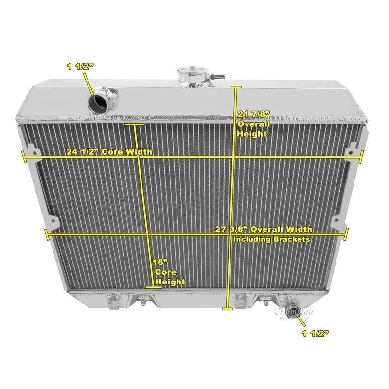

Be careful of the height on a replacement radiator. If it sticks up too high it will contact the hood. If it hangs down too low, it can take a rock if you don't run an airdam...
You still planning on using a narrower radiator or fix the frame rail up front?  The 240z rails also notch in about the same.

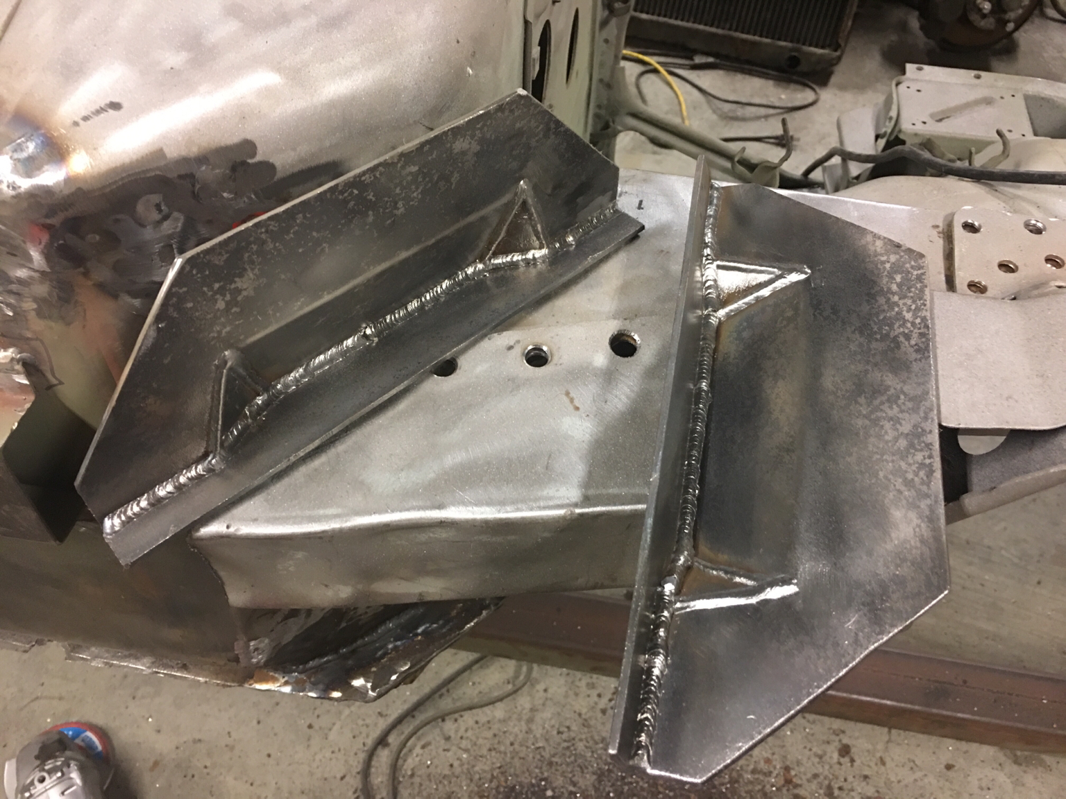

Picture of my 240z Frame rail removed from the car. kind of hard to see the indention at the front for the radiator clearance.

You may have to notch the frame rail up front though, to fit in the radiator support. Or maybe not, I dont have your replacement rail to really determine that. If you can get away without notching it, I would just find a aftermarket rad that will fit, like your were doing.

With the 280, all the rads are within the same height as a stock 280 rad. Nothing should go lower or higher if I go with a 240 style rad. Right?
Should be safe using a 240z rad as it isnt as tall and will allow for the bottom to hide behind the lower rad support and still have plenty room on top to clear the hood. Reason I went with the zx radiator, I needed something cheap and in the moment, It was the only good conditioned z radiator at a local salvage yard that somewhat fit and worked for the time being.  Im not sure but, are the 280z's bottom radiator supports lower than the 240z's?

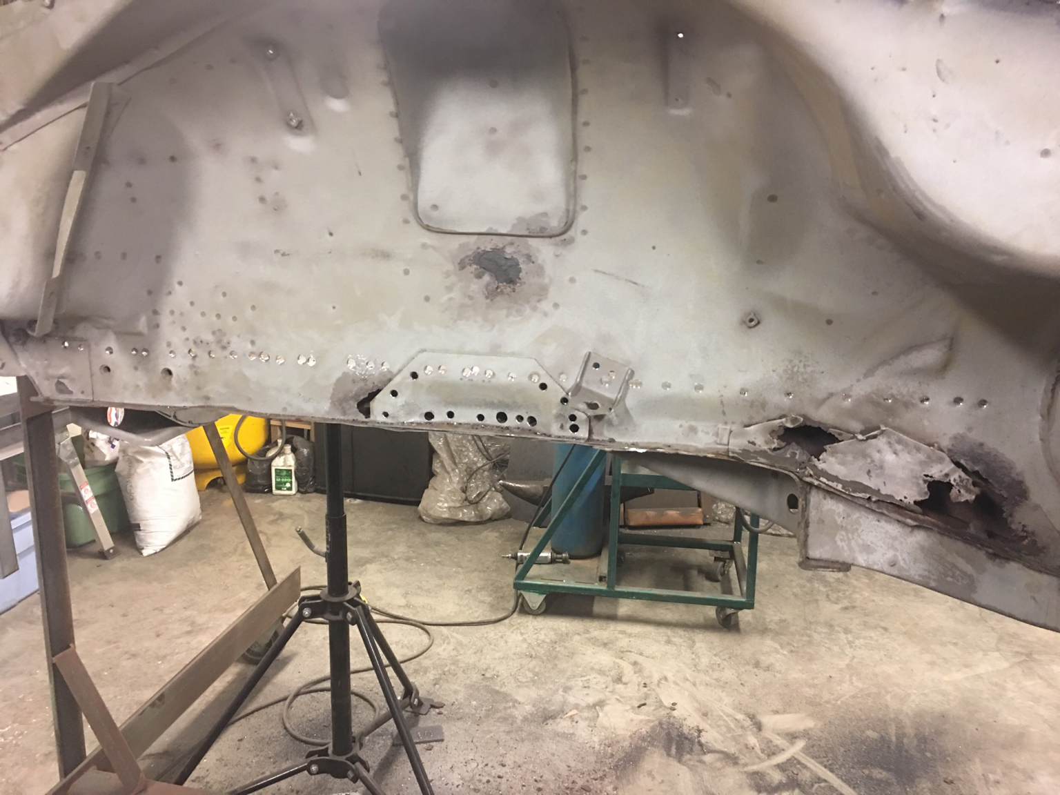

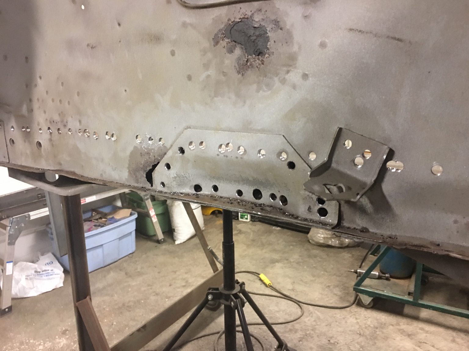

It's a shame those pretty welds are going to be painted over.LOL  Are you going to replace the sheet metal that was originally behind that strengthening plate or just weld in the new plate, it looks much thicker than stock.
