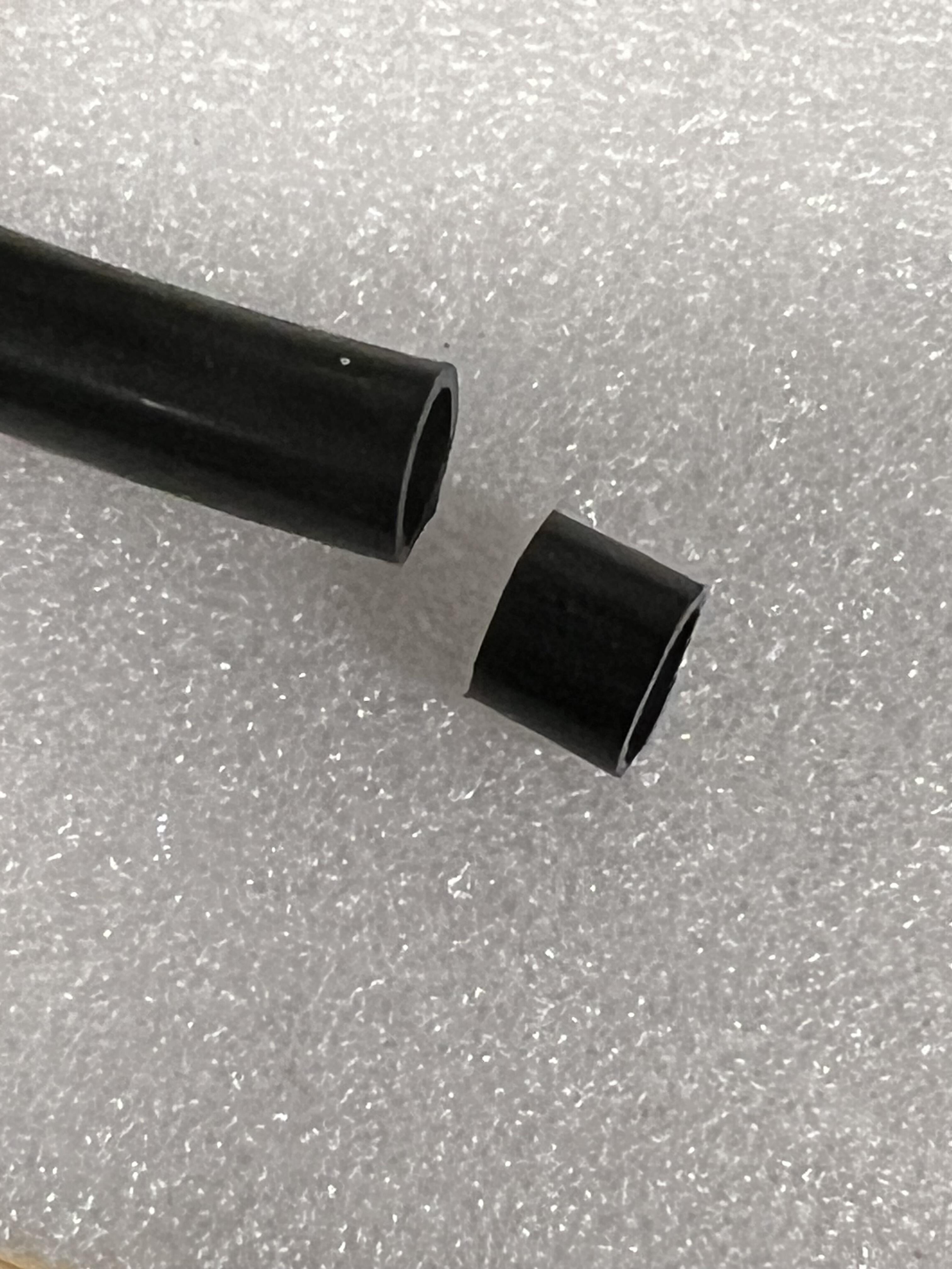

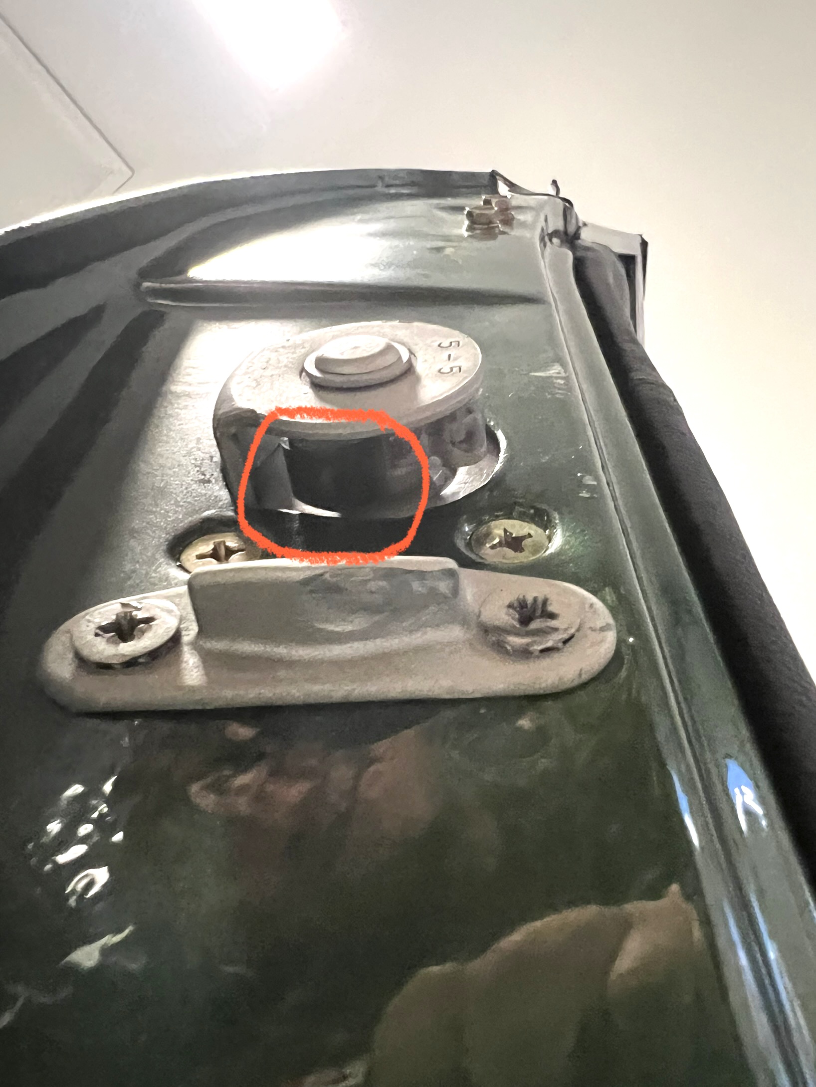

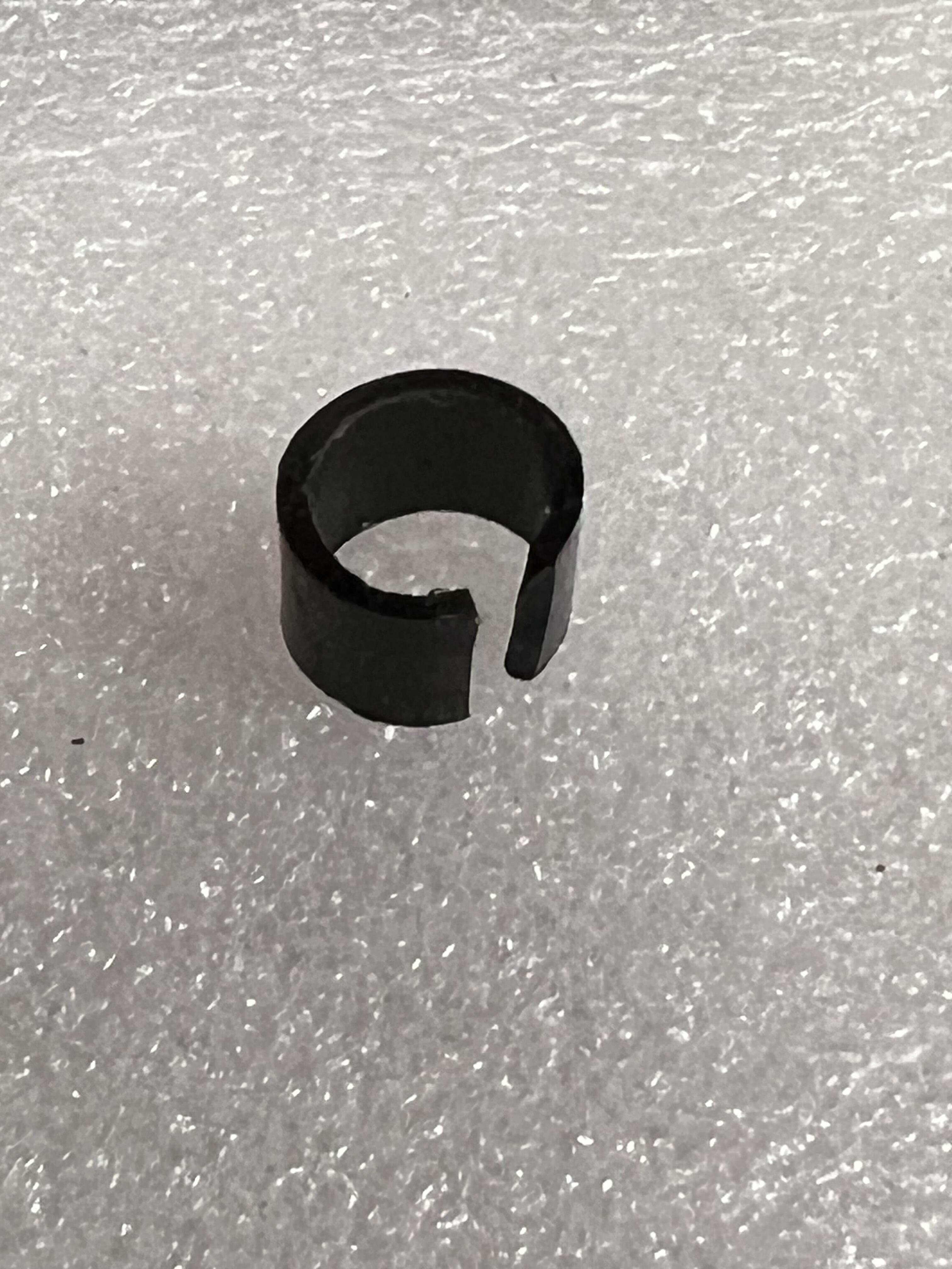

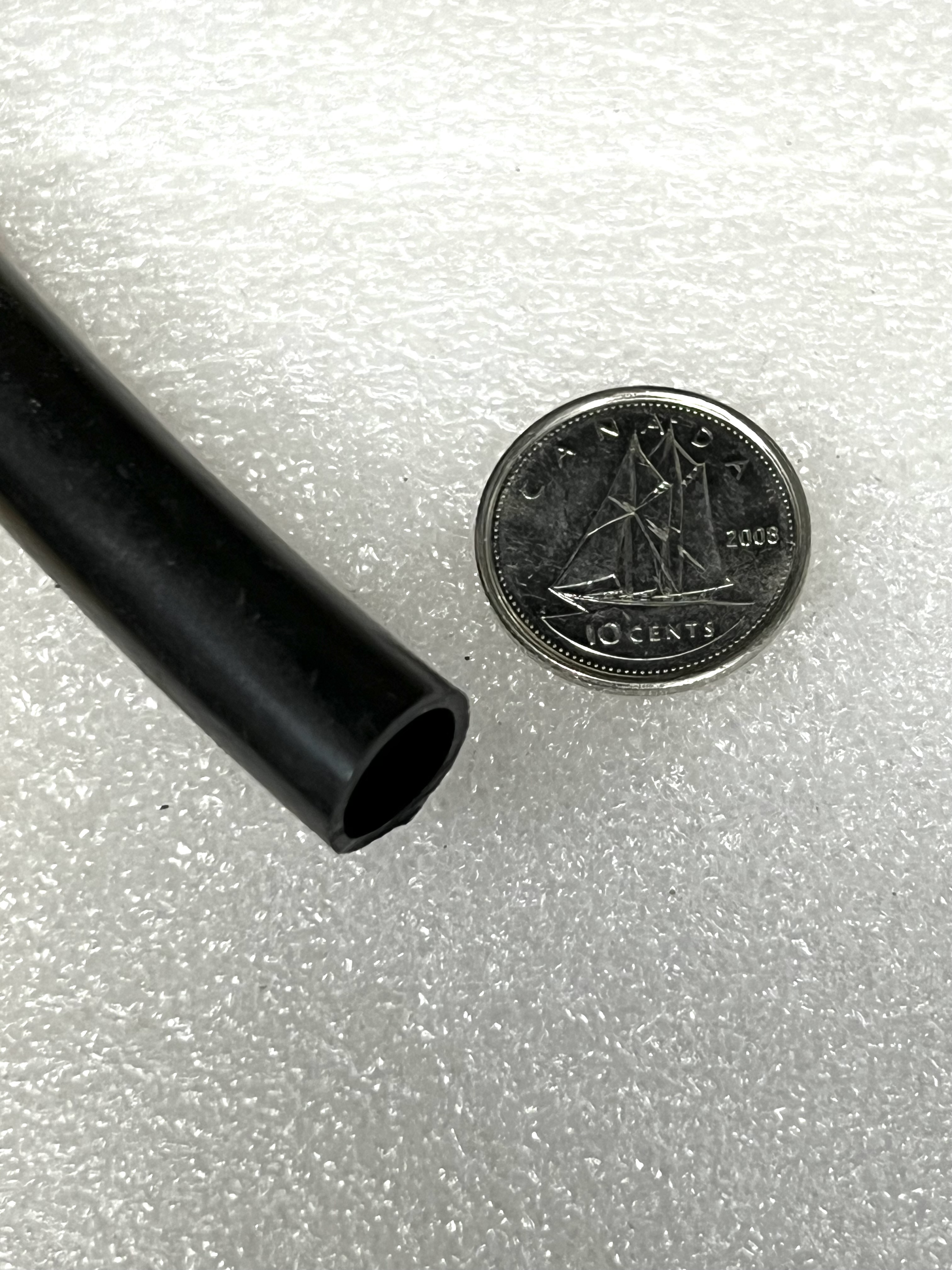

Ok class! Time to learn how to NOT slam your 70-76 Z doors!  Take a small plastic hose about 3/8” diameter and trim off a piece the same width as the bump roller in your door latch. Cut a section out to make a “C” section to clamp itself over the BOTTOM bump roller. Adjust the striker plate slightly if needed and then gently close your door. You’re welcome….
YEARS of slamming my doors are now a thing of the past! Thanks to an old Hybridz.org thread I was able to find the source of my frustration. Unfortunately the rubber snubbers that go in our door catches are long gone and sometimes are available for sale from 240zrubberparts.com, otherwise this quick and cheap solution works perfect and is easily replaced if it wears out!
