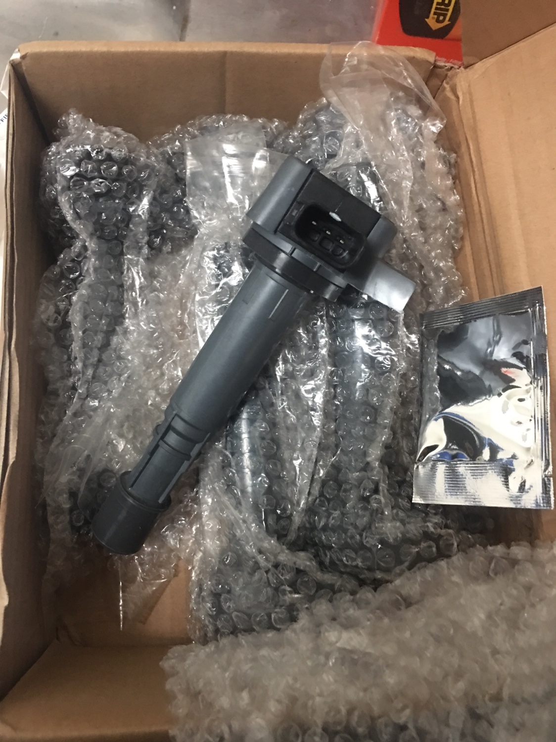

Yeah, I was wondering about that as well. There are three connection pins on the pack, right? Two of them have to be for the logic level signal (sig and ground), but what is the third wire for? I wasn't sure if that third connection was a ground return for the high voltage side or if that is a diagnostic "misfire" detection input back to the controller.
It would sure make sense if the spark current flowed through the mounting bolt. The smaller the circle for that current, the better. it's really noisy and I wouldn't want that in any harness if I could avoid it.
If the mounting bolt does provide one side of the high voltage coil, you should be able to measure coil secondary resistance by sticking one lead up the coil pack and the other on the metal part of the mounting boss. Without looking anything up, probably along the order of 10K-30K ohms maybe?
I have the specs at home, but the grounding point through the bolt is a redundant safety as I remember. It does not form part of the firing signal. You cannot test these COPs with a multi-meter,  you need a functioning system.

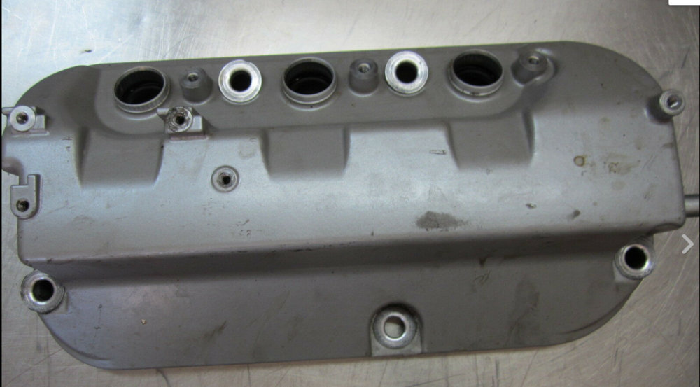

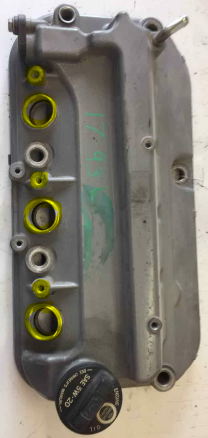

And from the look of a valve cover designed for these COPs, it seems the entire grommet seats inside the cover, then the bossing rises up to meet the bolt and COP head.

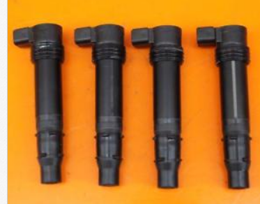

Some of the COP coils have their own dwell control, I believe.  I think it makes the head bigger.  There's a bunch of COP options out there.  Some smaller motorcycle COP coils might be less bulky.

https://www.ebay.com/itm/09-12-KAWASAKI-NINJA-ZX6R-ZX600R-OEM-IGNITION-COILS-COIL-SPARK-PLUG-CAPS/153137994597?epid=18017017407&hash=item23a7bc5b65:g:-6sAAOSwZthbZzSc

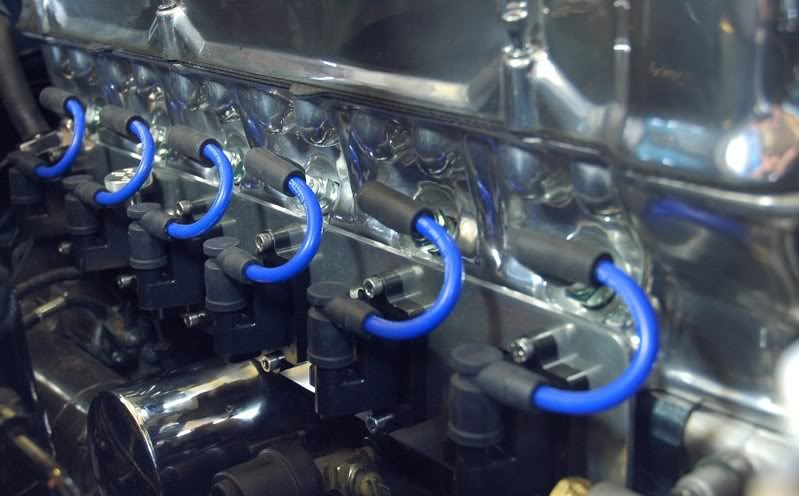

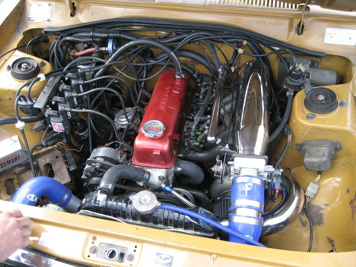

I don't know if you call this bendy thing a wire, but it's what one guy does.  Blake Machine.
http://www.blakemachine.com/performance_parts_by_blake_machine/datsun_coil_on_plug_brackets_6__4_cylinder
Yup. I've not messed with those specific COPs before, but that's what I figured.
And thinking about the wiring connections a little more... If they're logic level triggered, then the other two connections have to be +12 and ground. So the three connections would be trigger, power, and ground, but not necessarily in that order.  It's still unknown if the high voltage side shares the same ground connection or if it snags a separate ground through the mounting bolt.
I did a little digging looking for a wiring diagram for how those COPs are connected in-situ (same part on Acura's and Hondas) and didn't turn up anything. And I would take that as good news... Seems reliable enough that not a lot of people are asking questions about the wiring diagram?   LOL
