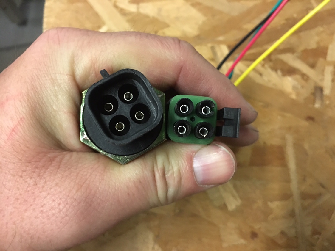

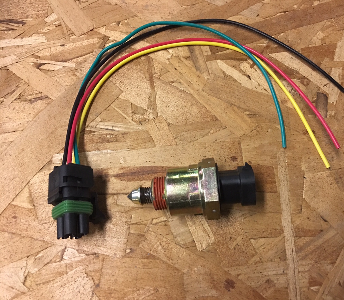

Received the harness for the GM style Idle air Control Valve and they pinned it with female pins! Arrrgh
Luckily I am Electro Optronics tech and have the pins/skills to rebuild this. Just disappointed when things like this happen. Make-work projects that should be straightforward.

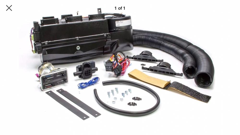

Gen II Mini AC
Heat Cool and Defrost
Still need the compressor and lines and condenser and..... stuff.
12 minutes ago, grannyknot said:
Does that mean you have to remove the existing airbox and blower?
None of the stock components are re-used basically. I will have new heater lines, new vent hose, all new evaporator and condenser, new blower etc etc
This will be a modern replacement of the old system. It should provide a nice quiet, leak free version of the old basic functions, but also give me AC! Of course, that means a bunch of new lines and a compressor and drier and yadda yadda yadda, but it will be worth it.
Mark,
Do you have a compressor in mind? Last time I was solo junkyarding, I saw that the early Pathfinders/D21 trucks used a V-belt pulley compressor. I didn't pick it up, but hopefully giving you a nudge to check that compressor out. R-134A too.
Wayne
Thanks Wayne. I have one in mind... the Sanden 508 style v belt. I was thinking used too... but I can get a new one for about $175 Cdn pesos from fleabay.
I have the mount for a Sanden already.

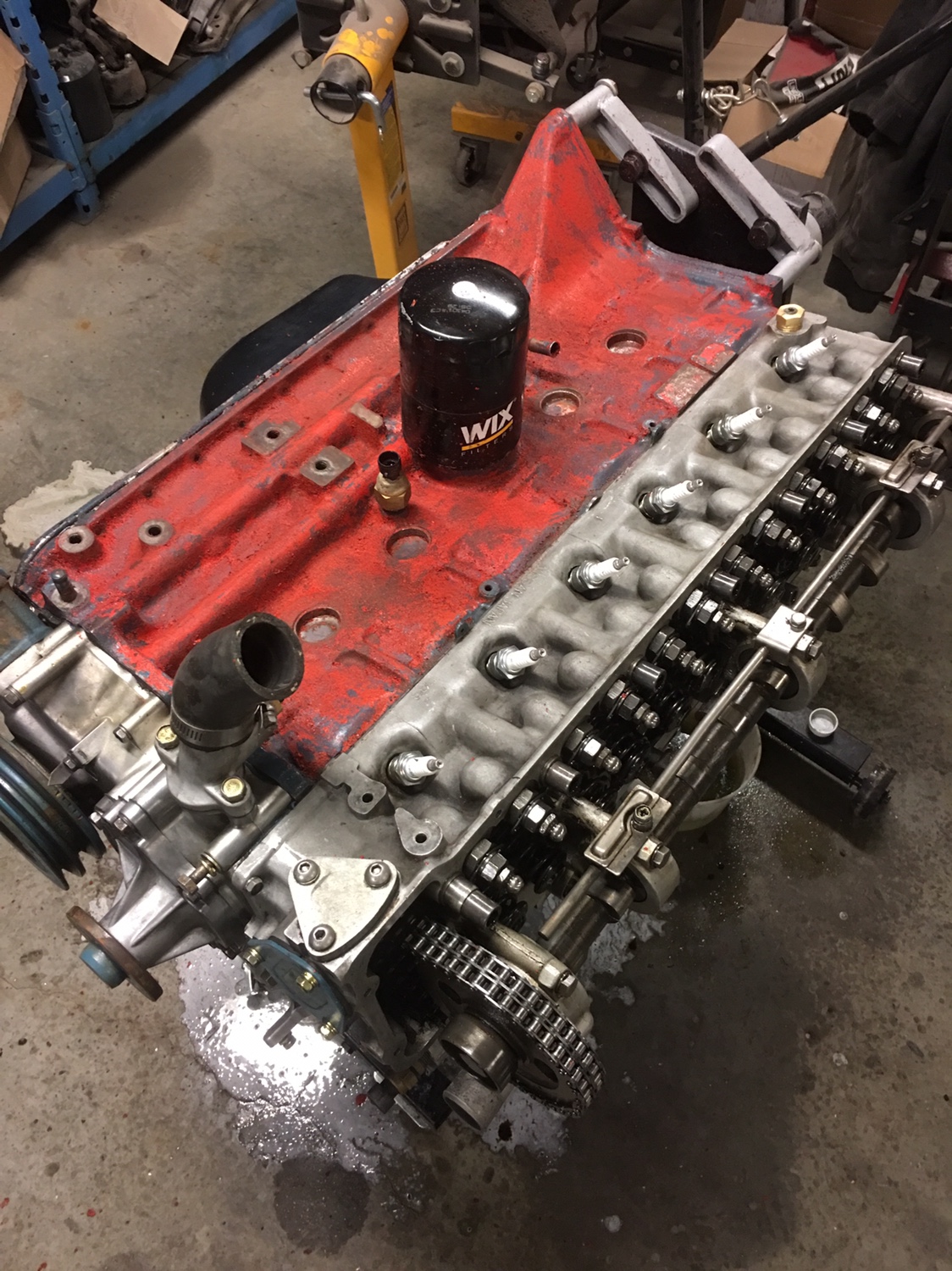

So with temperatures around minus 30 Celsius for the last two weeks, my shop furnace decides to stop working this last weekend. Hot surface igniter died. Luckily, I was able to get a new one locally Monday night and get heat back into the shop. Unfortunately, I probably froze a lot of paint and chemicals that will need to be replaced.
In the meantime I was inspired to strip some of the old blue paint off the Stroker... and found... more paint!
