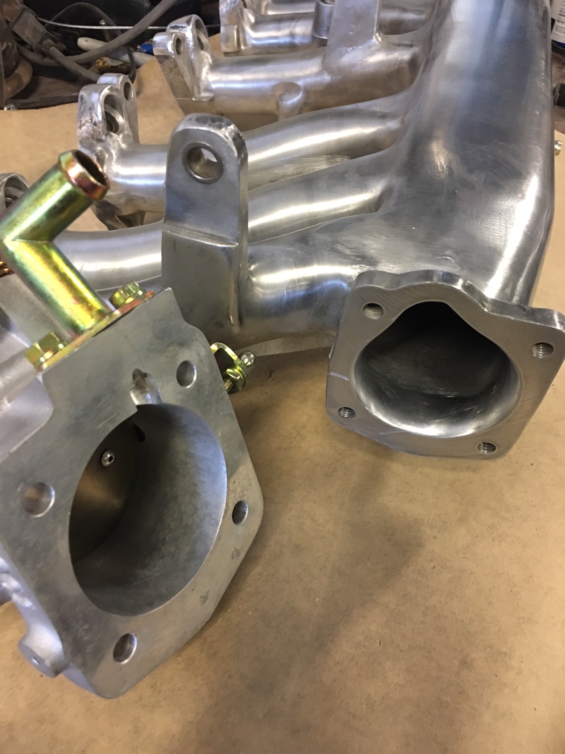

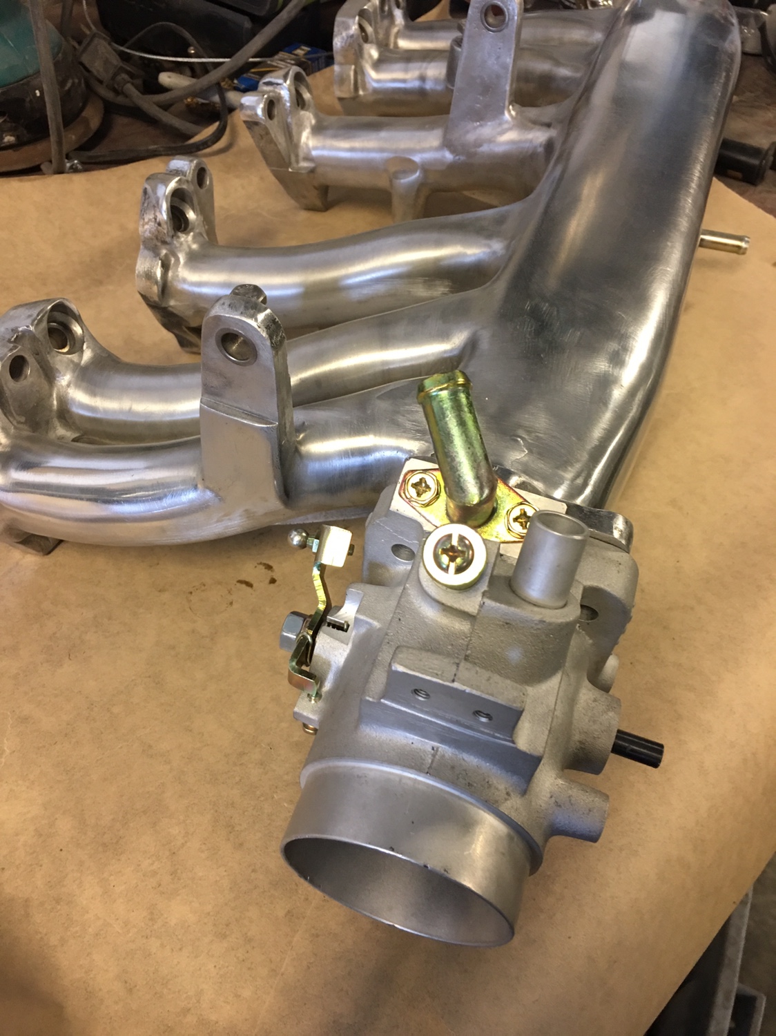

An e88 with injectors.  I'm curious, can't wait to read more. 8^)
I've got the nissan p/n for the e88 gasket with metal on the exhaust ports.   No injector cut outs though. Let me know if you want it, also the one for my n42 with cut outs. Nissan but no metal.  Cliff
Thanks but Jim has me covered. I will need to drill the E88 for the N42 manifold and port the injection slots into the head too.
The head has been performance built already and seems a shame to waste it and start fresh on the P90 I have sitting on the shelf. I can always run the E88 with carbs again in the future.

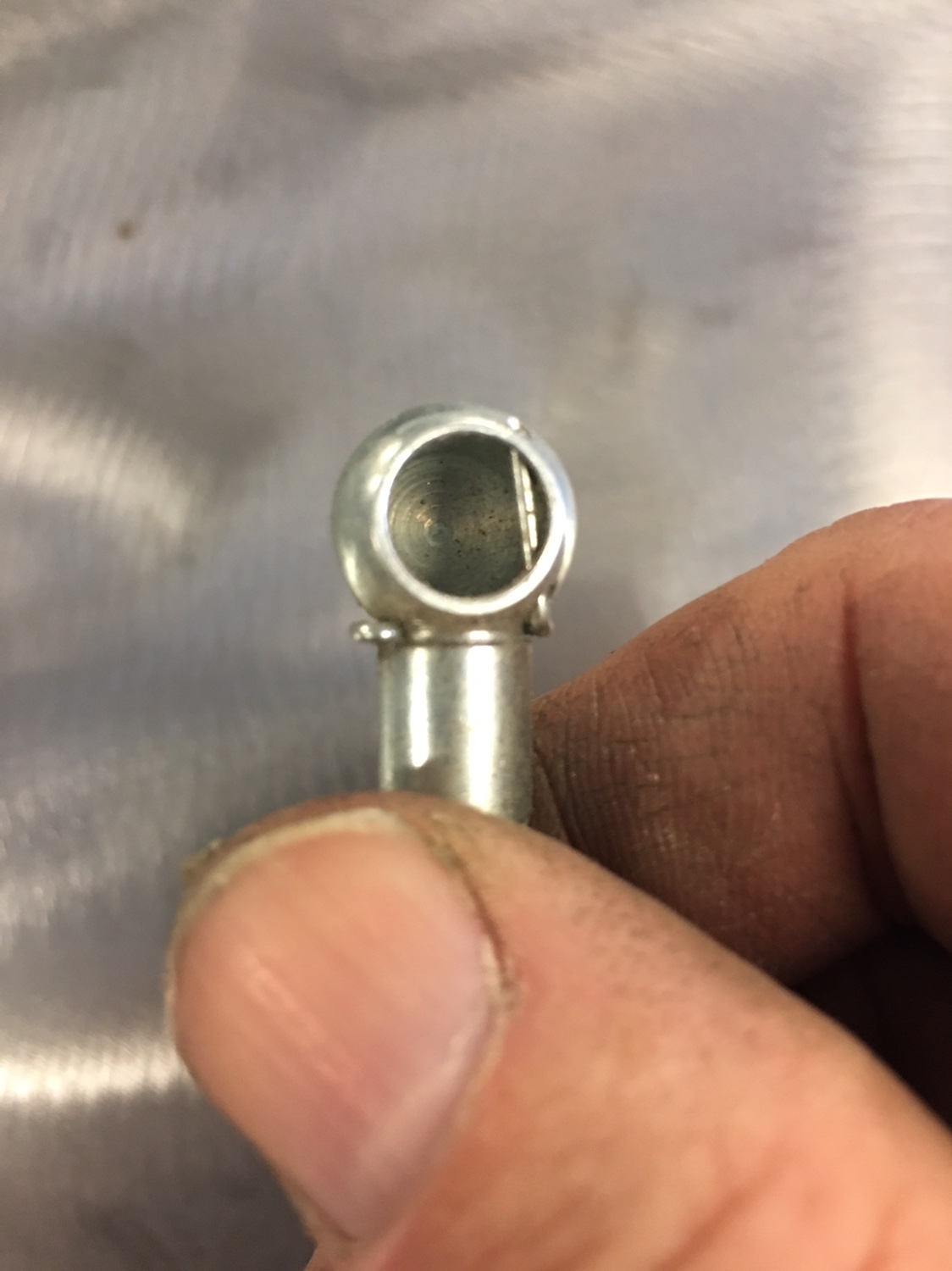

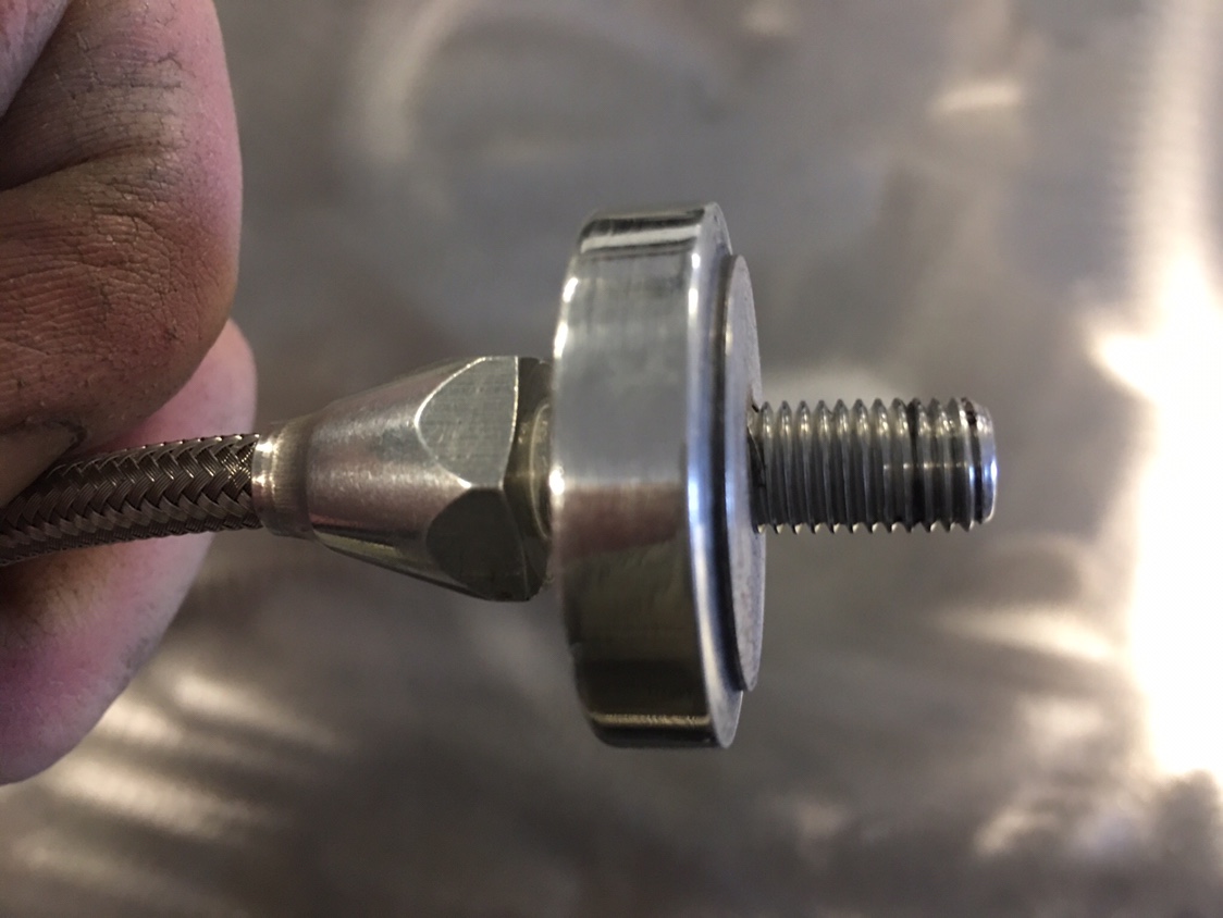

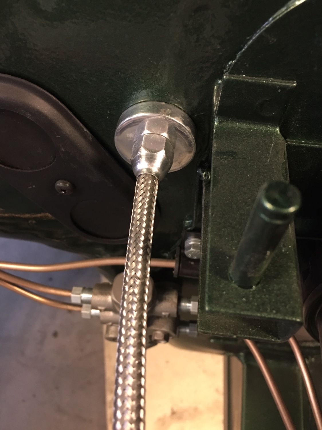

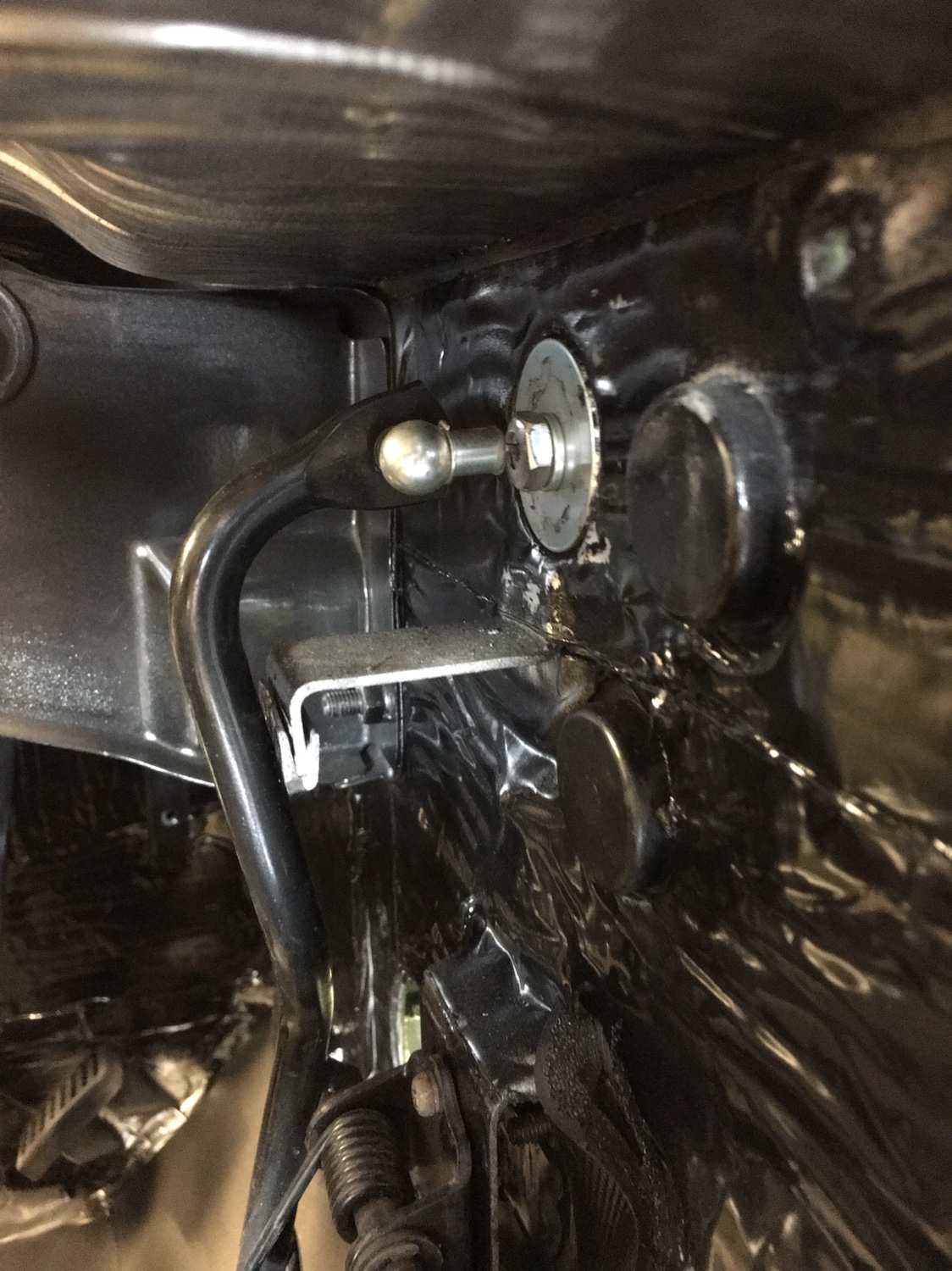

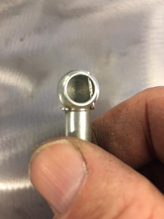

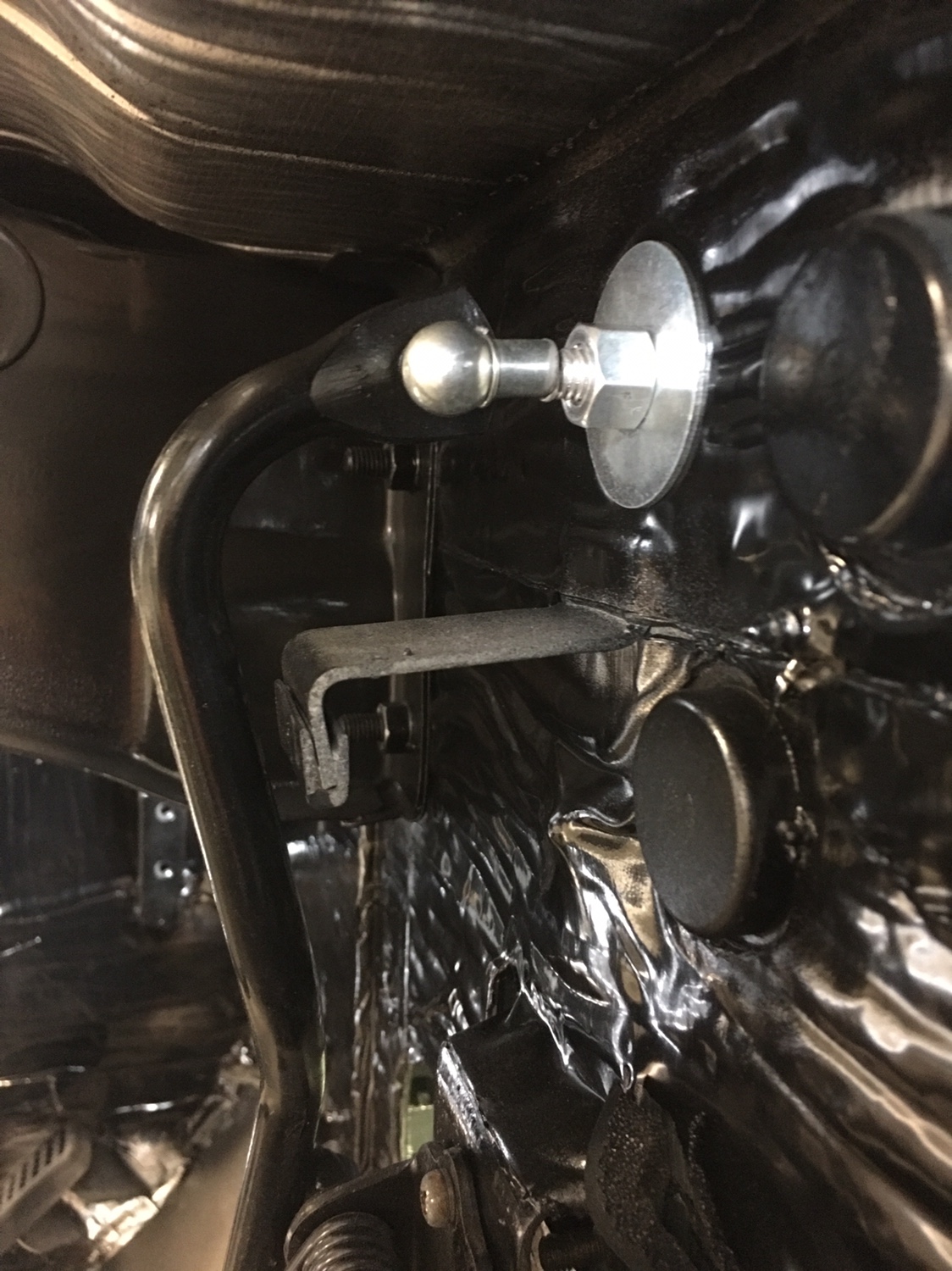

So Jim arrived with goodies in hand yesterday. The shiniest part is the throttle cable wall adapter and throttle pedal ball connector. Custom made by the legend himself.

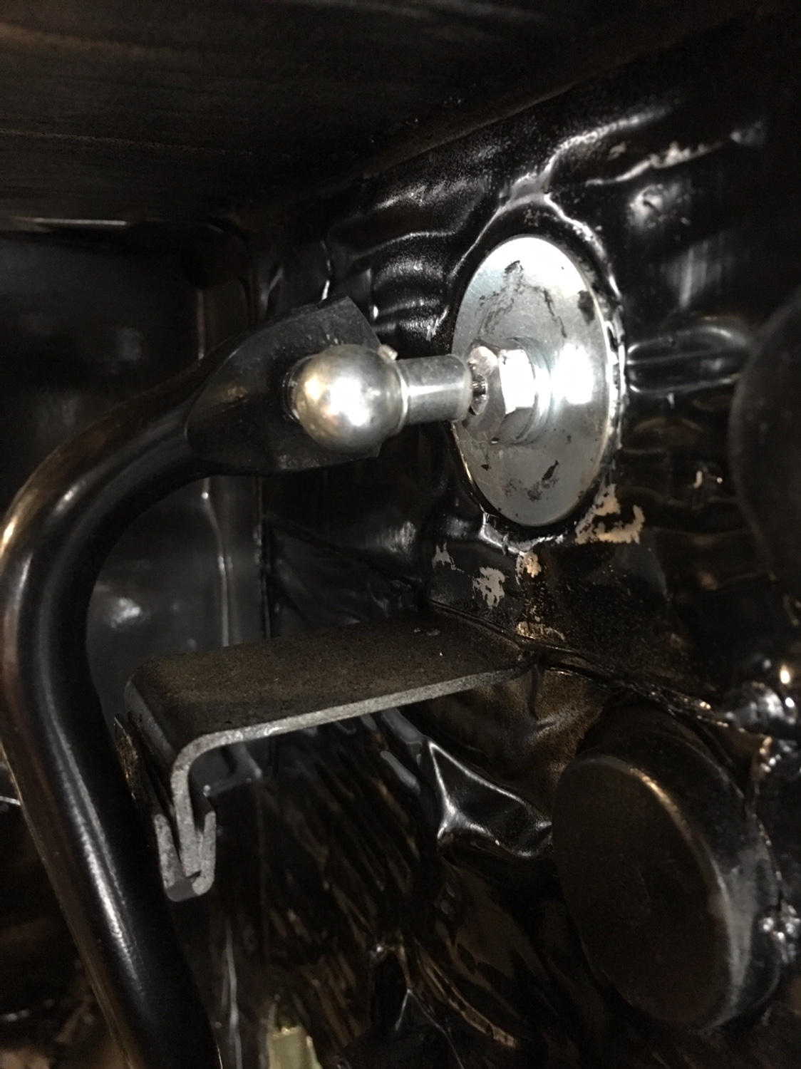

Install was straight forward. It starts with a stepped piece that is threaded that aligns in the firewall for the throttle linkage.
After that, the throttle cable is threaded thru and the custom end with the soldered capture ball for the throttle pedal is locked into place in the pedal ball. A few test fits and trims to make sure the pedal stops on the pedal rest and not on the cable end. Alignment was perfect with stock pedal!

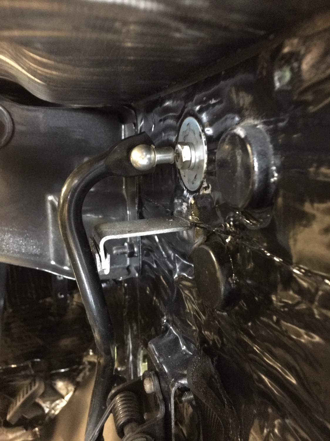

And a couple shots of the engine bay side.
Thanks Jim!

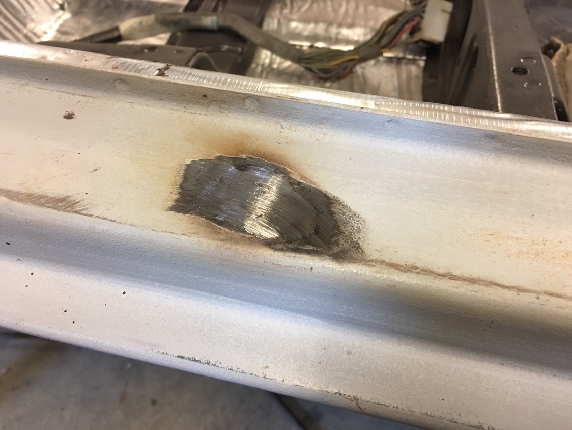

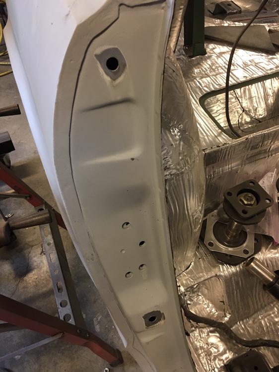

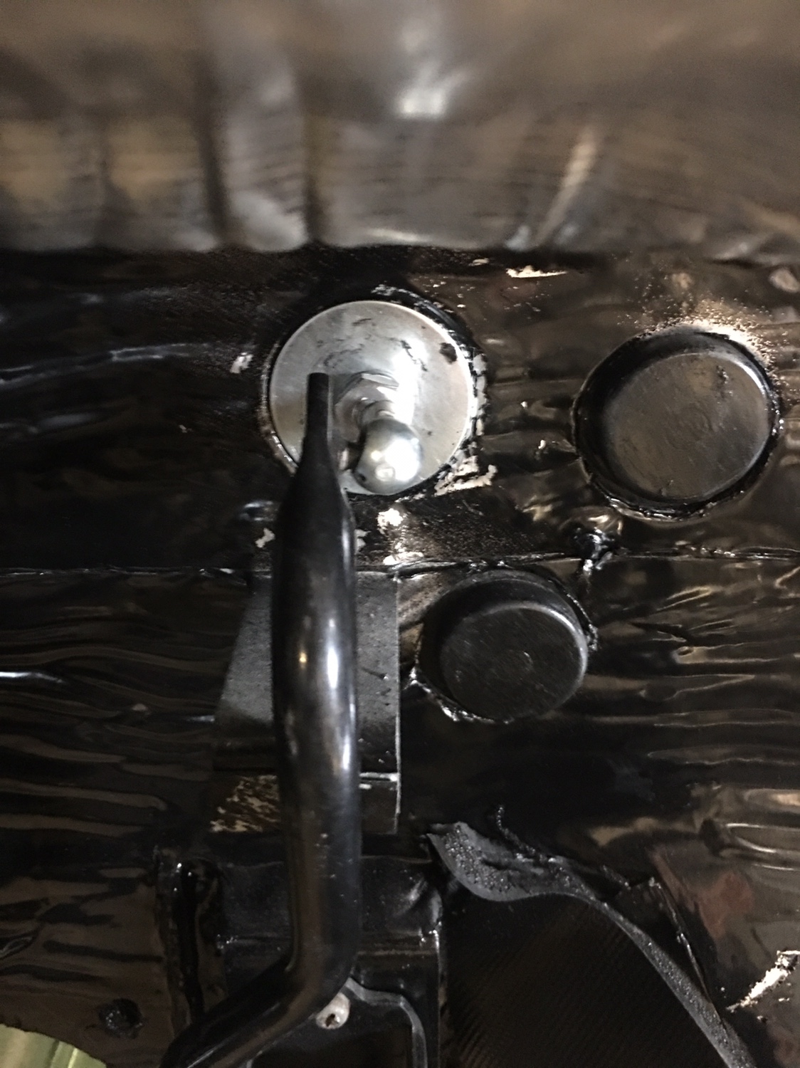

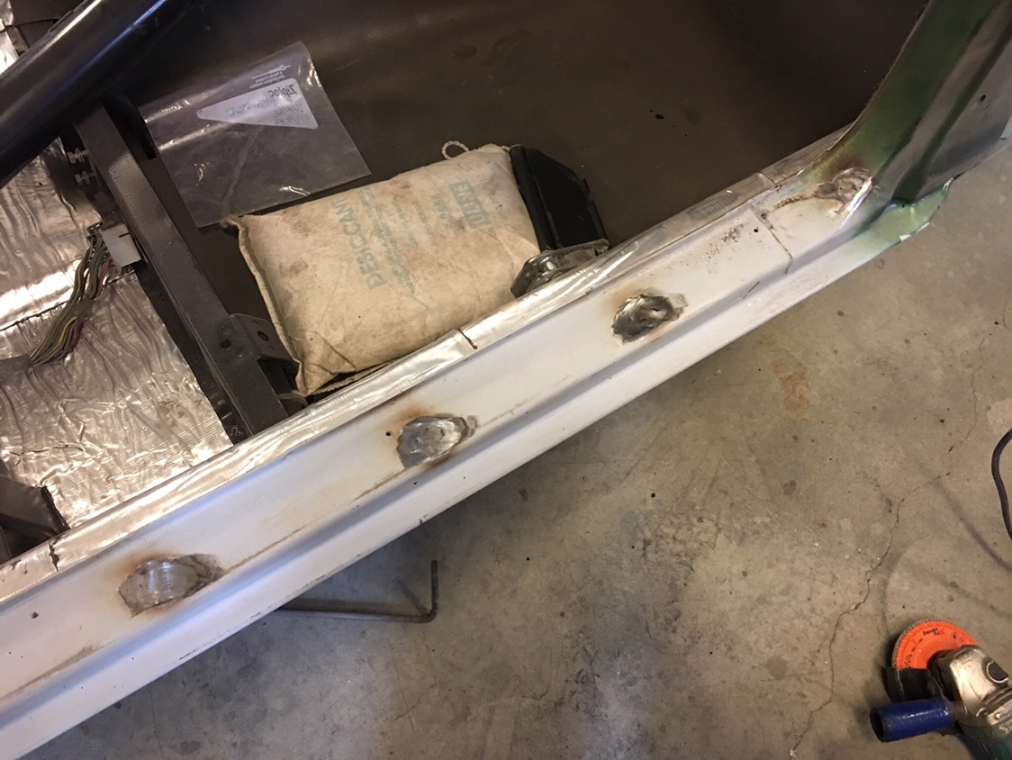

Repairing the holes left in the door frames by the PO rust proofing.
A finish coat of fine strand fibreglass filler will seal these up nice.

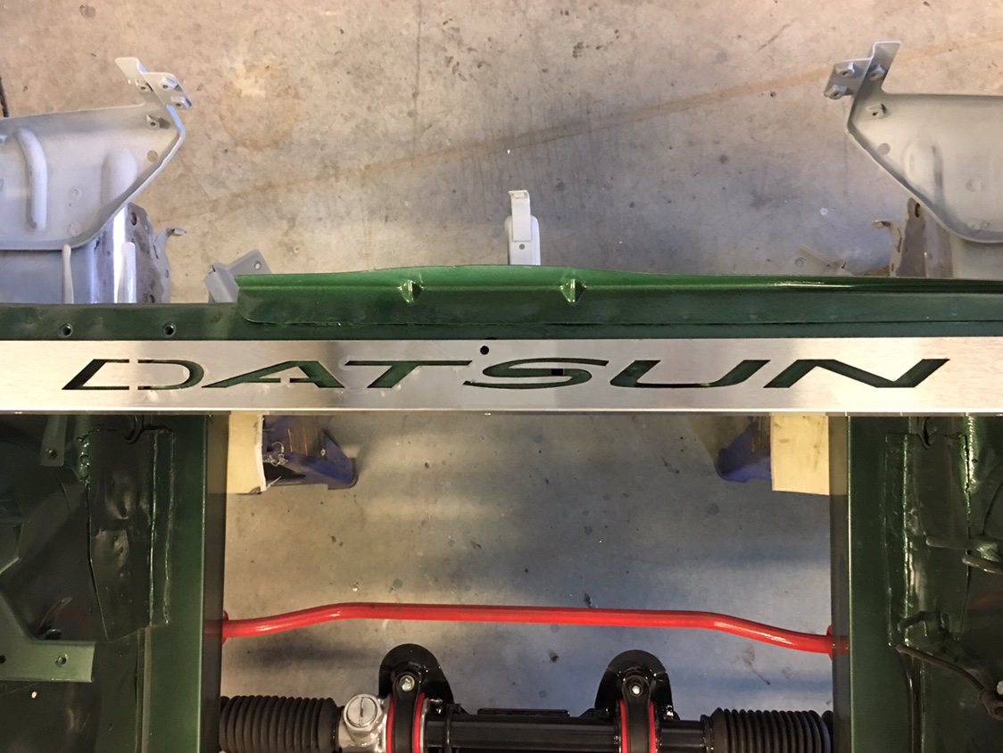

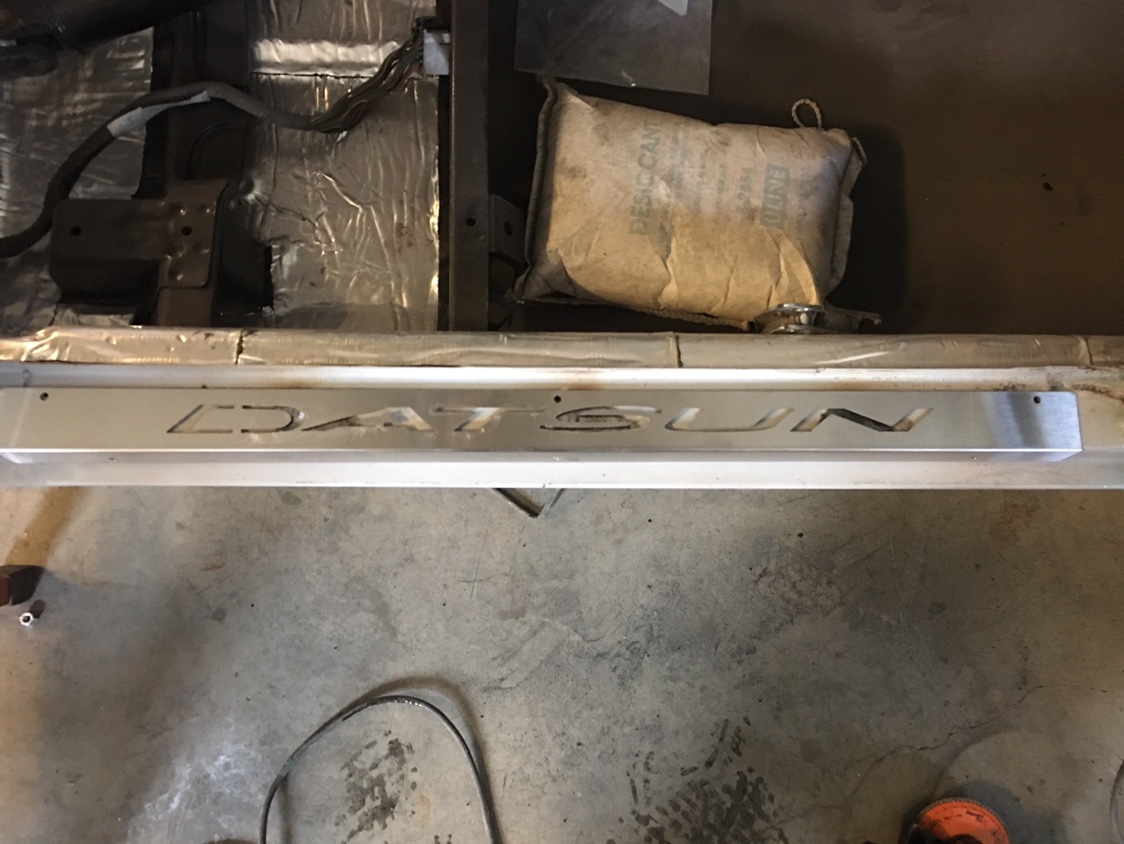

The reason for the repairs is that I have the Skillard stainless door sills with Datsun cutout. I will have these overlaying the painted sill so the green comes thru!
Example below.
On a patch of painted shell for example

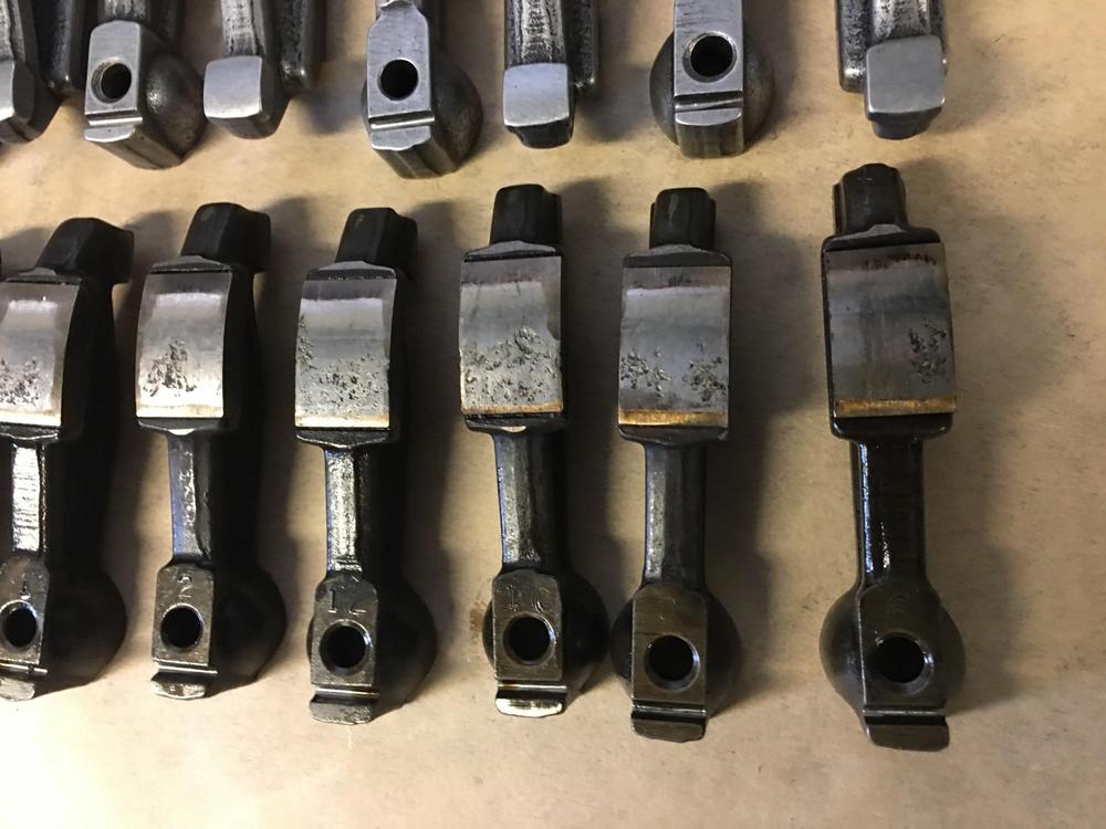

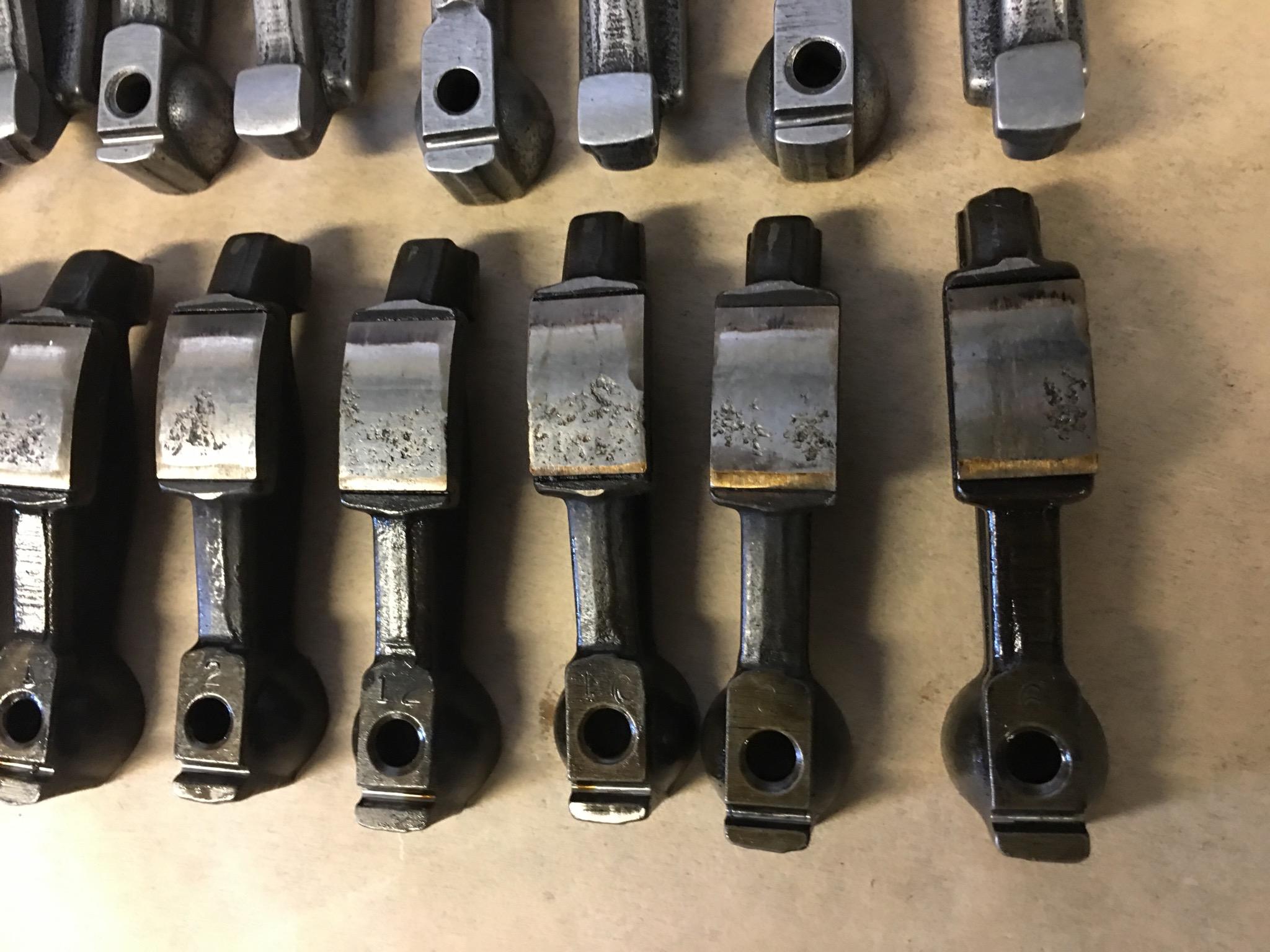

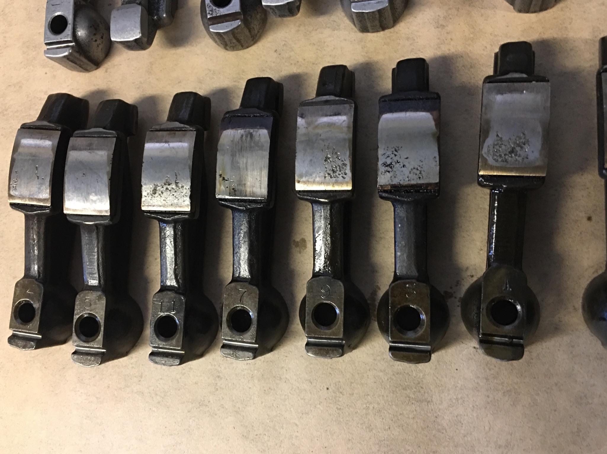

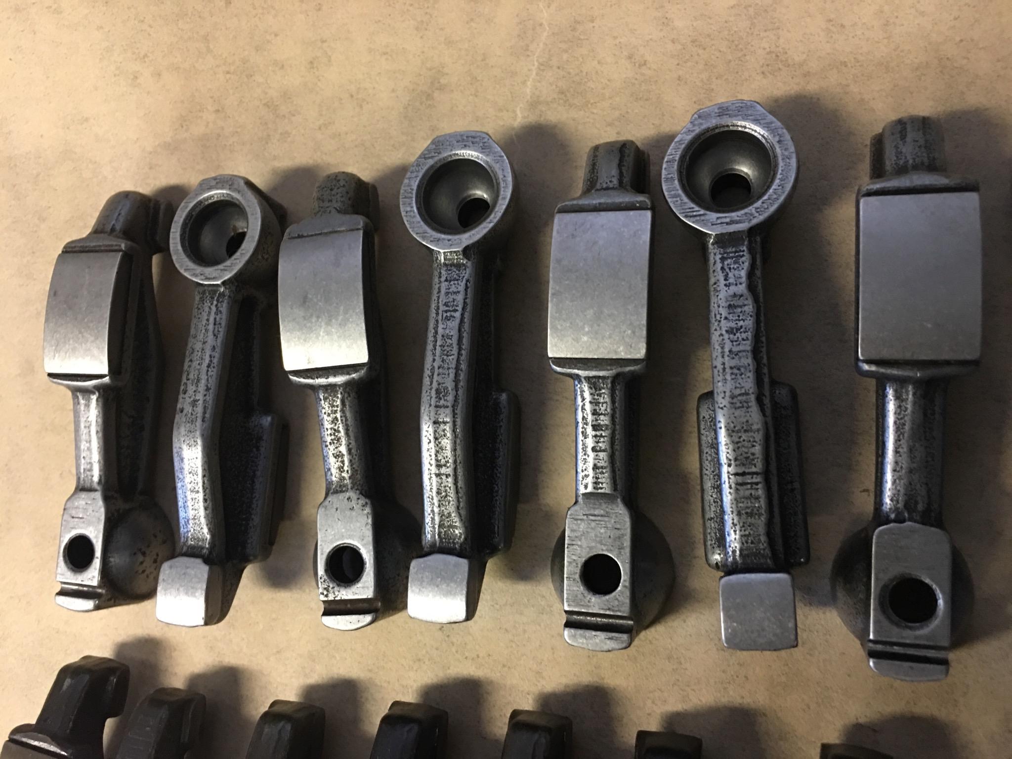

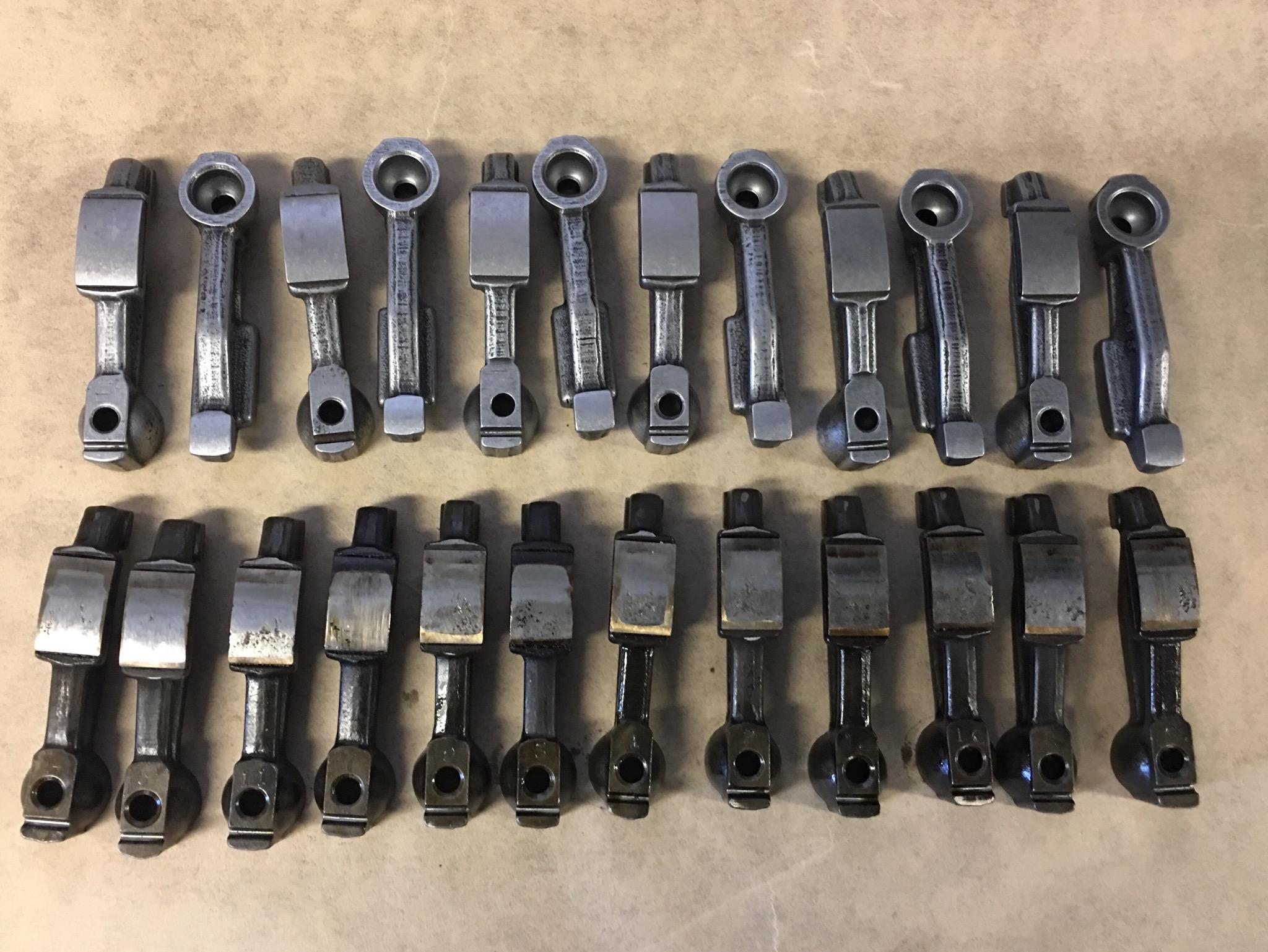

Weird how warped and twisty the pattern looks on the old rocker arms.  Even besides the pitting.  Looks like a whole lot of wrong.  Are you reusing the cam shaft?  Better check the lobes closely.  Check the wipe pattern there also.
Nice pictures.
