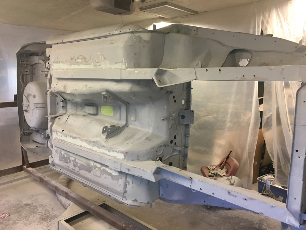

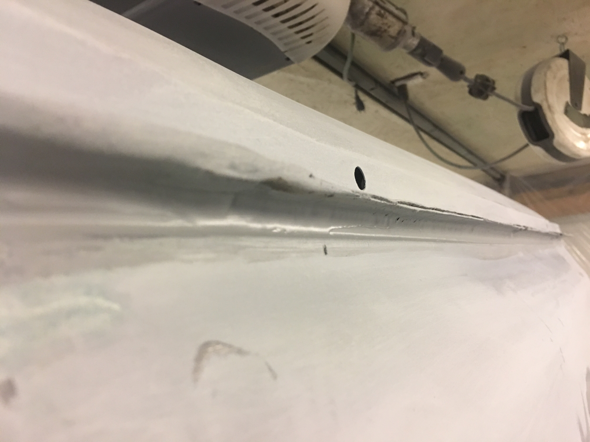

I guess this is more like practice for the outer shell. The more I do here the more confident I get for doing the body work on the outer panels. Still have a couple more days of hand sanding the base primer before seam sealer. Then a major clean up before the sealer coat of the interior, underside and engine bay.

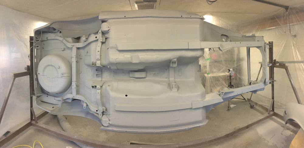

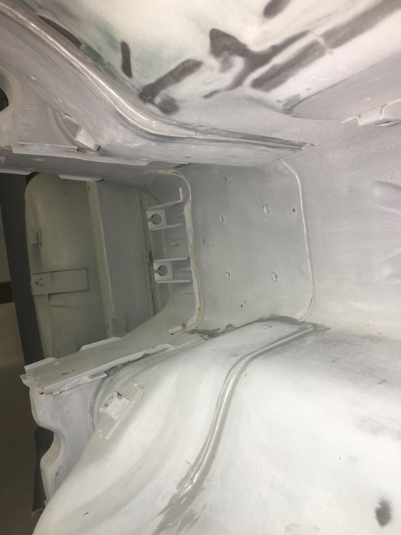

All right. That's it. No more sanding and filling the bottom chassis. Cleaned the shop up tonight. Will do it again the next time I'm in there, then on to the seam sealing! Whew!

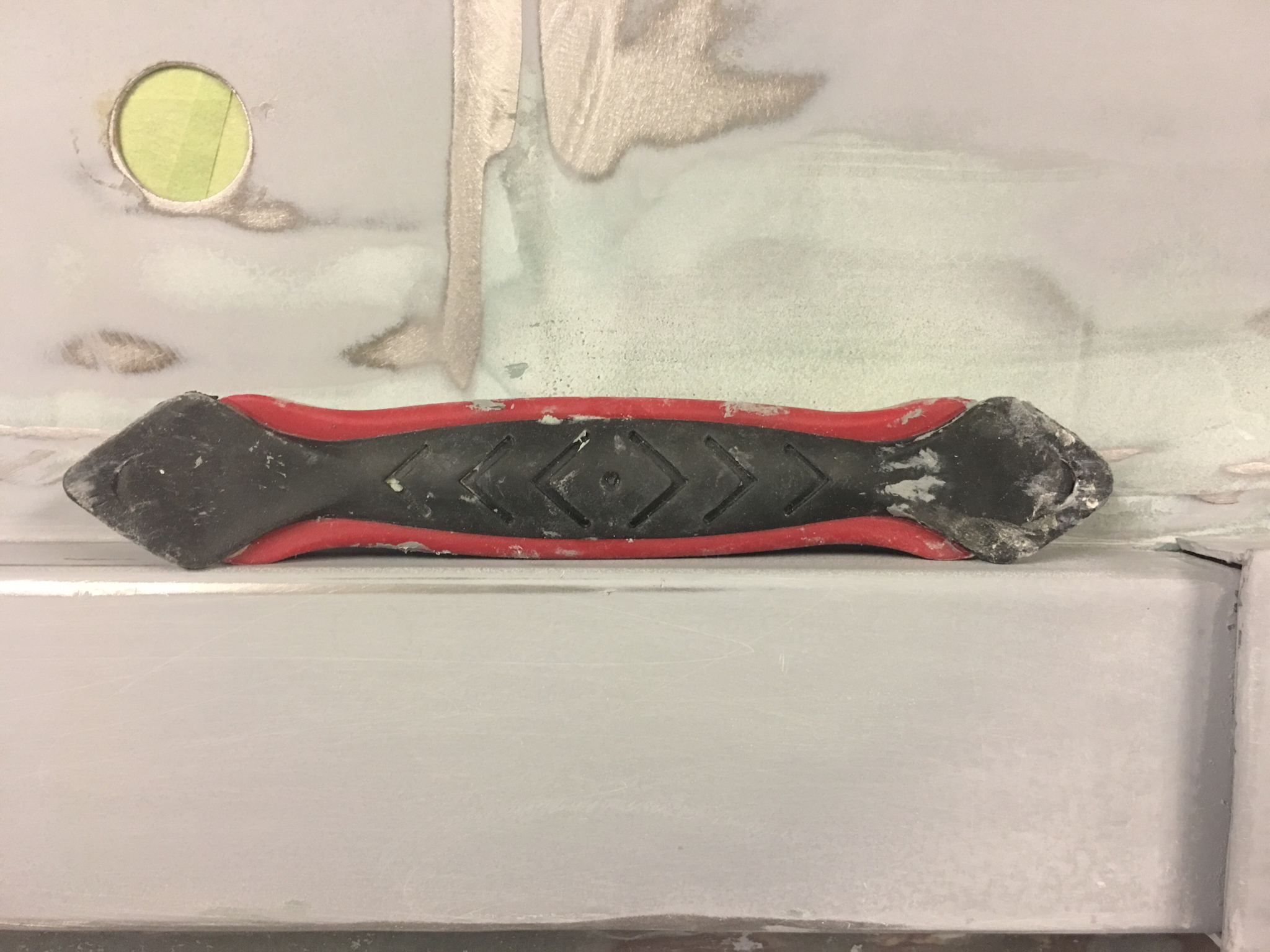

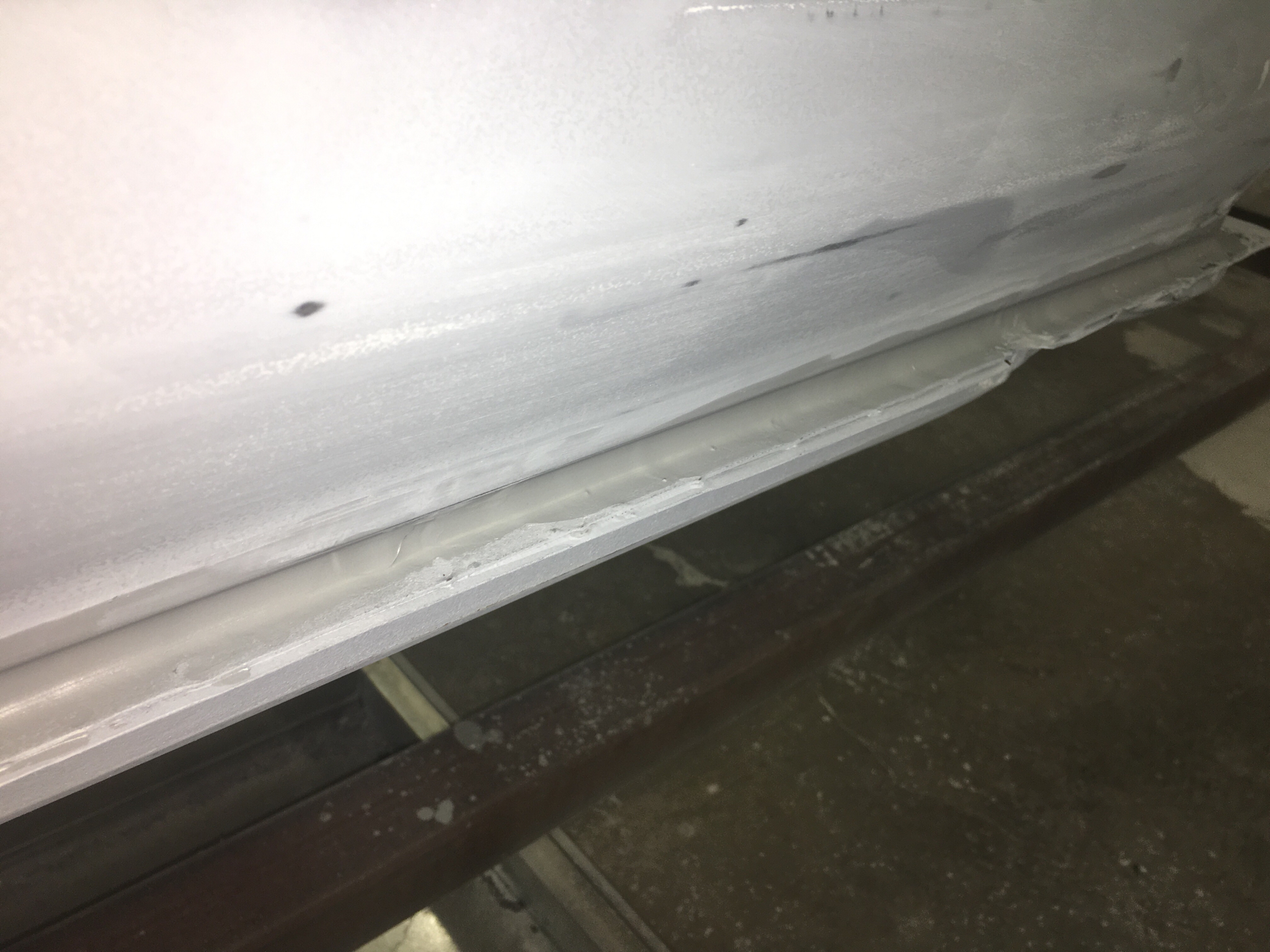

Seam sealer going in nicely.
Used a rubber scraper and a lot of latex gloves!
Seam sealing is complete. Next up is another complete wipe down and clean of the car before spraying the sealing coat on the bottom of the car , inside of the car and engine bay area.
Still feels like a lot of work with little to show for it. But yes, I know it will all be worth it later!

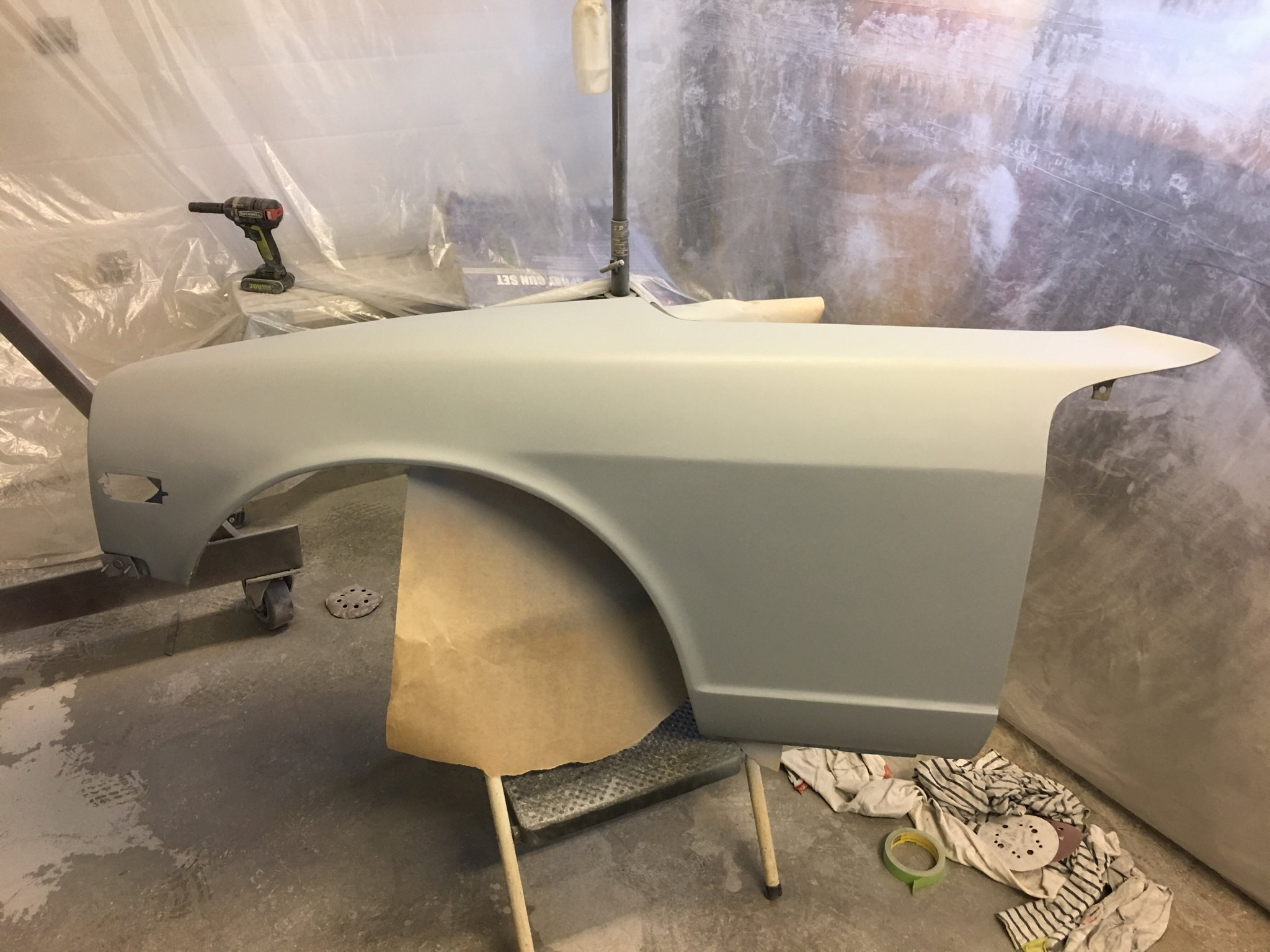

Finished wiping down the car; cleaning the shop up. I plan on spraying the sealer coat this week and prepping a spare fibreglas fender to use as a test mule for the body colour. I plan on getting at least four shades of green mixed up in the water based paint to test spray sections of the fender. That way I can get a good idea of what the car will look like when I'm done in different lighting etc. Hope to be able to get that done in the next few weeks. Summer is such a busy time....

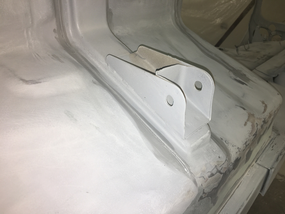

Well, a little progress tonight!

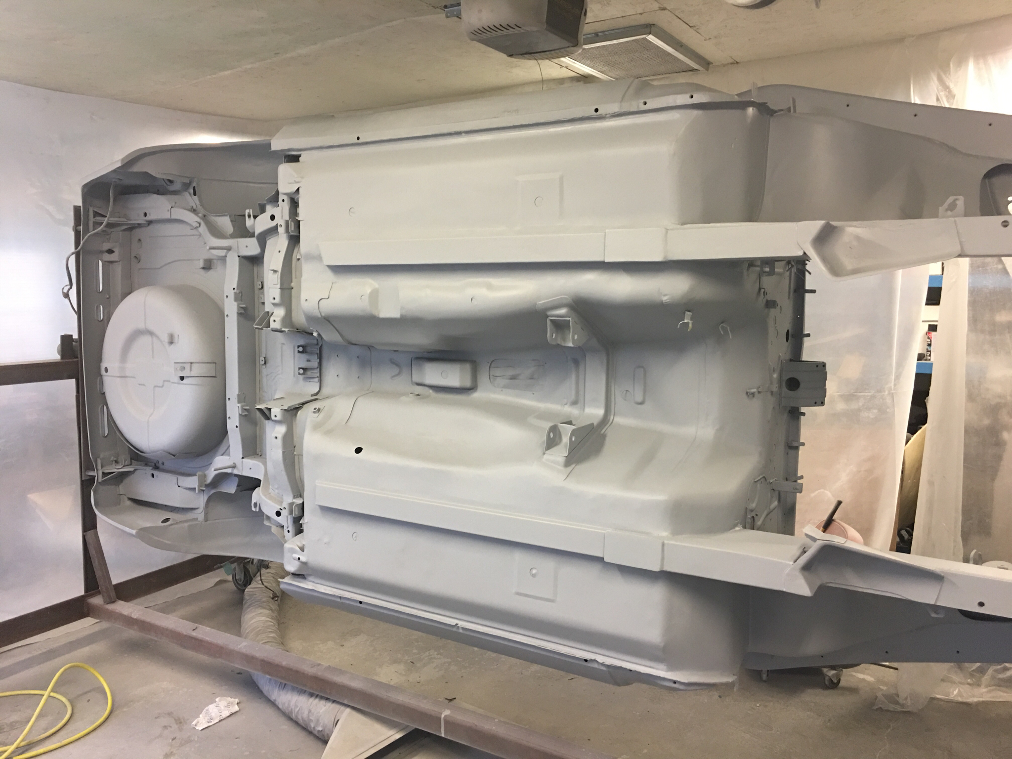

Got the sealer coat down. Looks pretty nice and smooth. I'm liking it!

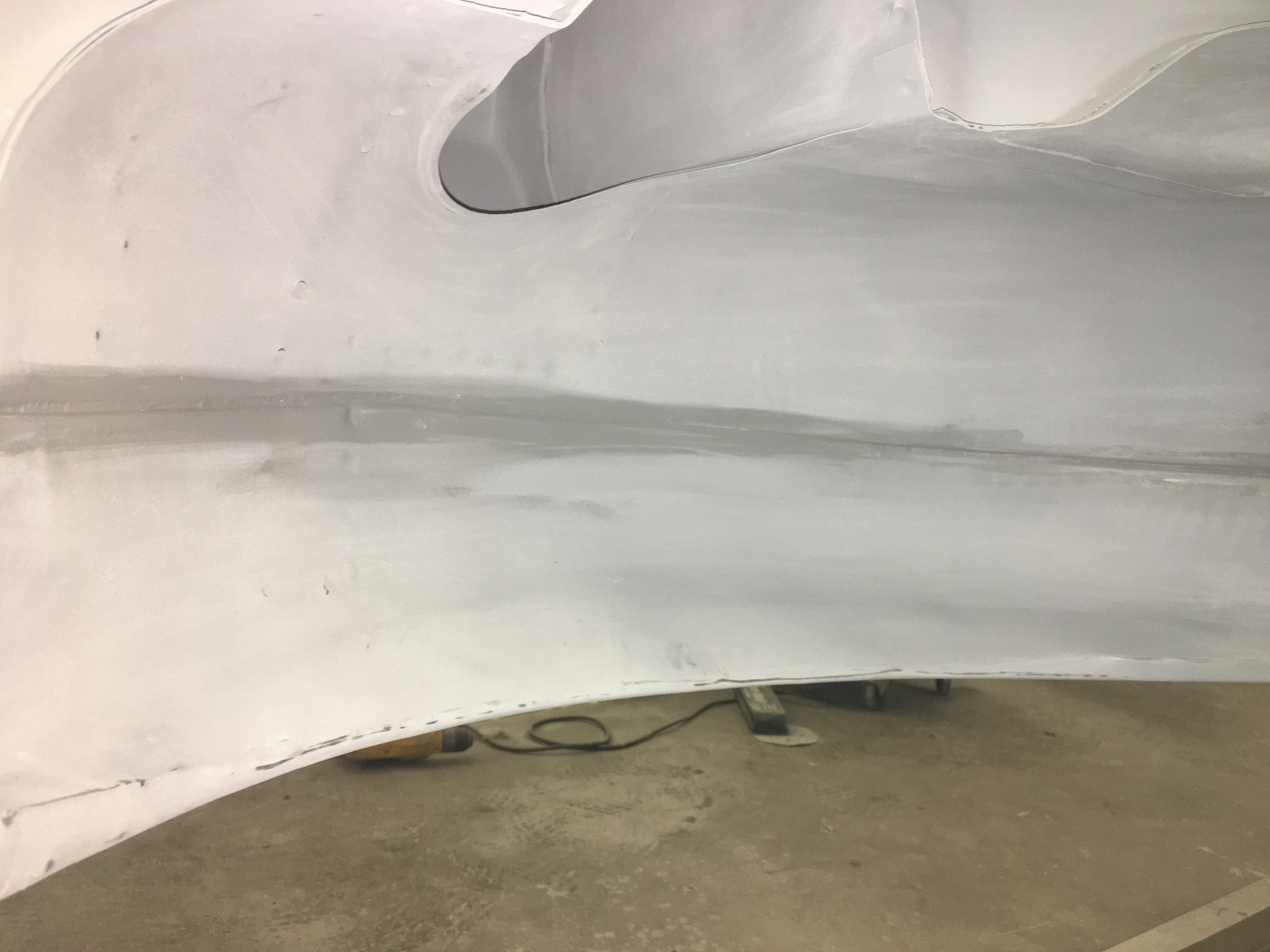

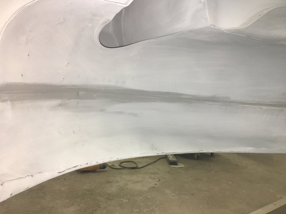

Also prepped the spare fibreglas fender I had so that I can spray some base colours on it. I would like at least four sample greens on the fender that I can compare in real light with contours etc.
