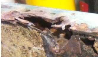

This part worries me:
post-22075-0-77945100-1450463798_thumb.j
Do you know how to weld?  That's a pretty important part of the structure and it needs to be strong when your done.
My son in law is a B Pressure professional welder. He will be doing the difficult stuff.
I have access to a lot of good tools, so I imagine I will be fabricating new patches on good thick steel and prepping them as you mentioned. I plan on making it stronger than stock but with as little evidence of a repair as possible.

the picture in post #427, the reinforcement plate right above the frame rail is gonna have a hole behind it.
