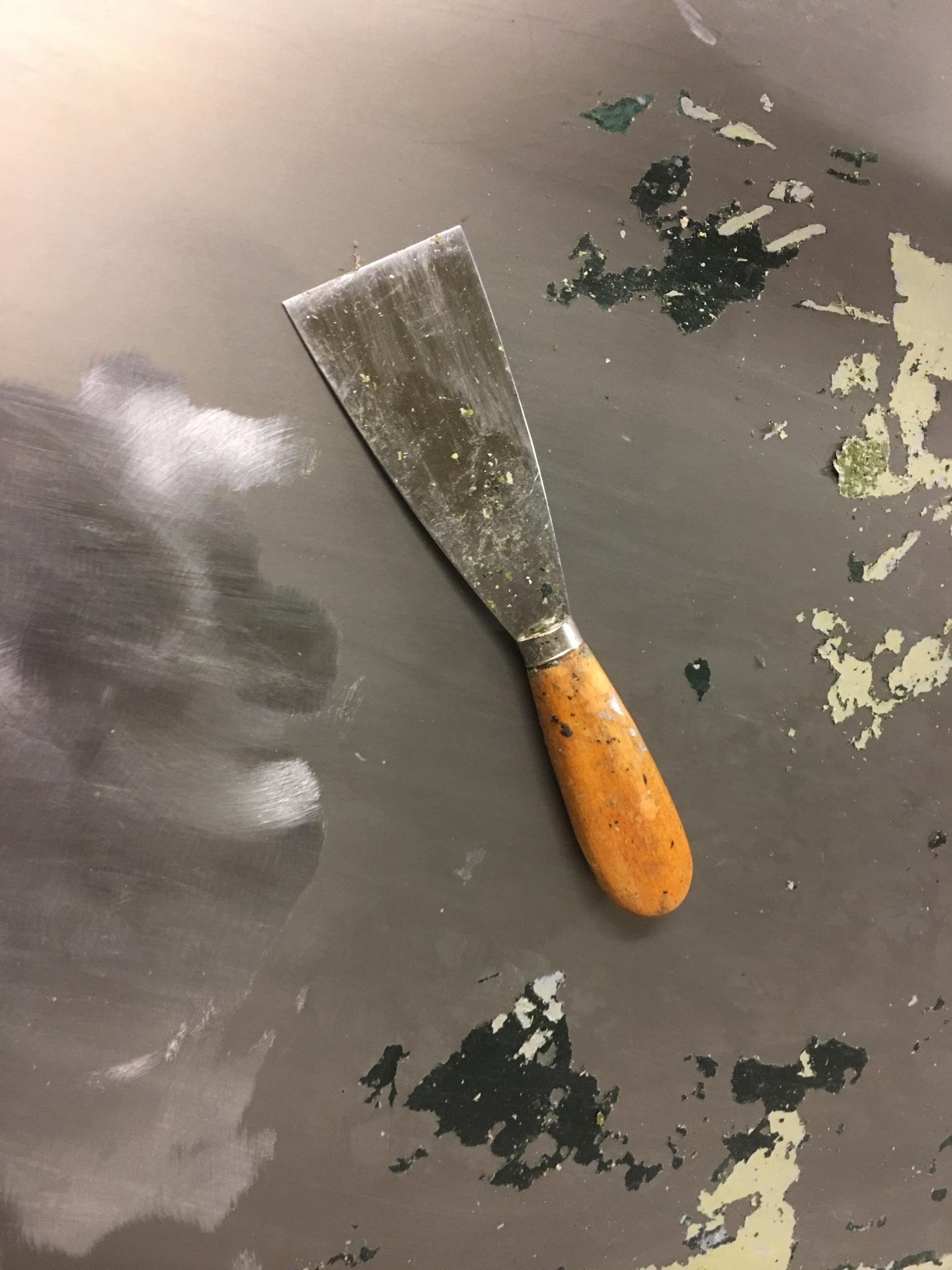

November 8, 20186 yr comment_561185 What are you scraping with Mark? I found that using a long handled razor blade scrapper worked best when I did mine. Link to comment https://www.classiczcars.com/forums/topic/50908-1976-280z-restoration-project/?&page=184#findComment-561185 Share on other sites More sharing options...

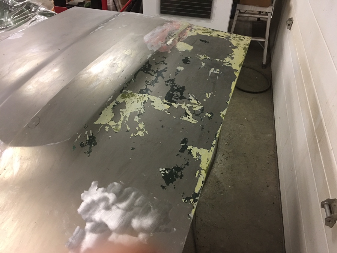

November 8, 20186 yr Author comment_561187 Scraping after 7 minutes with a flat bladed putty knife. Needs another pass. Edited November 8, 20186 yr by wheee! Link to comment https://www.classiczcars.com/forums/topic/50908-1976-280z-restoration-project/?&page=184#findComment-561187 Share on other sites More sharing options...
November 8, 20186 yr Author comment_561189 Somewhat done... Link to comment https://www.classiczcars.com/forums/topic/50908-1976-280z-restoration-project/?&page=184#findComment-561189 Share on other sites More sharing options...

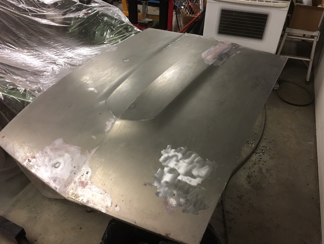

November 8, 20186 yr Author comment_561206 Overall I am impressed with the chemical stripper. At $40 a gallon, it is not cheap, but comparable to the cost of EZ Strip plastic wheels at about $12 each. The finish is left like factory fresh metal when done compared to a granular sanded surface. The amount of effort is minimal with the stripper and no piles of dust and debris (HUGE plus for me). In the end, I will continue to use the stripper method and then go over the bare metal with an EZ Strip wheel to remove some stubborn primer/bondo that is stuck to the metal. This will reduce the dust and mess considerably versus not using the stripper first. I still have the remainder of the hatch, doors and one fender to strip. Link to comment https://www.classiczcars.com/forums/topic/50908-1976-280z-restoration-project/?&page=184#findComment-561206 Share on other sites More sharing options...

November 9, 20186 yr Author comment_561257 I worked on the inside of the rear hatch last night. It was a painted mess with old and new paint plus undercoating. The stripper cleaned it all up pretty good and revealed a lot of surface rust on the lower part of the hatch. But the bare factory metal.... gorgeous. Link to comment https://www.classiczcars.com/forums/topic/50908-1976-280z-restoration-project/?&page=184#findComment-561257 Share on other sites More sharing options...

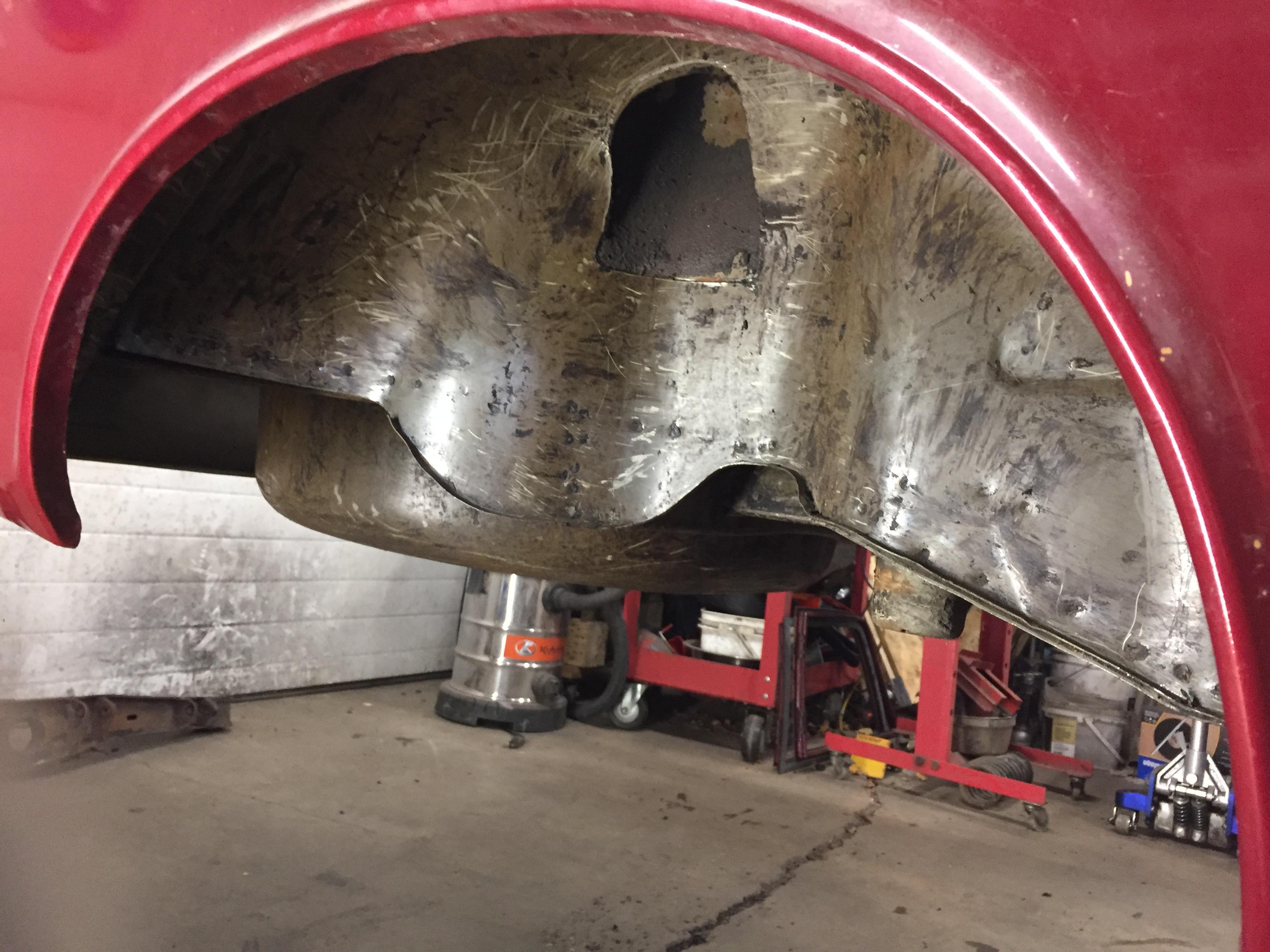

November 13, 20186 yr Author comment_561528 Took the EZ strip wheels to the hatch and finished it up tonight. Some light sanding to do, a little oil can removal, and then primer. Started cleaning up the old passenger fender. Spent the night removing the undercoating from the inside of the panel. Hopefully this is the very last of the undercoating!!! Link to comment https://www.classiczcars.com/forums/topic/50908-1976-280z-restoration-project/?&page=184#findComment-561528 Share on other sites More sharing options...

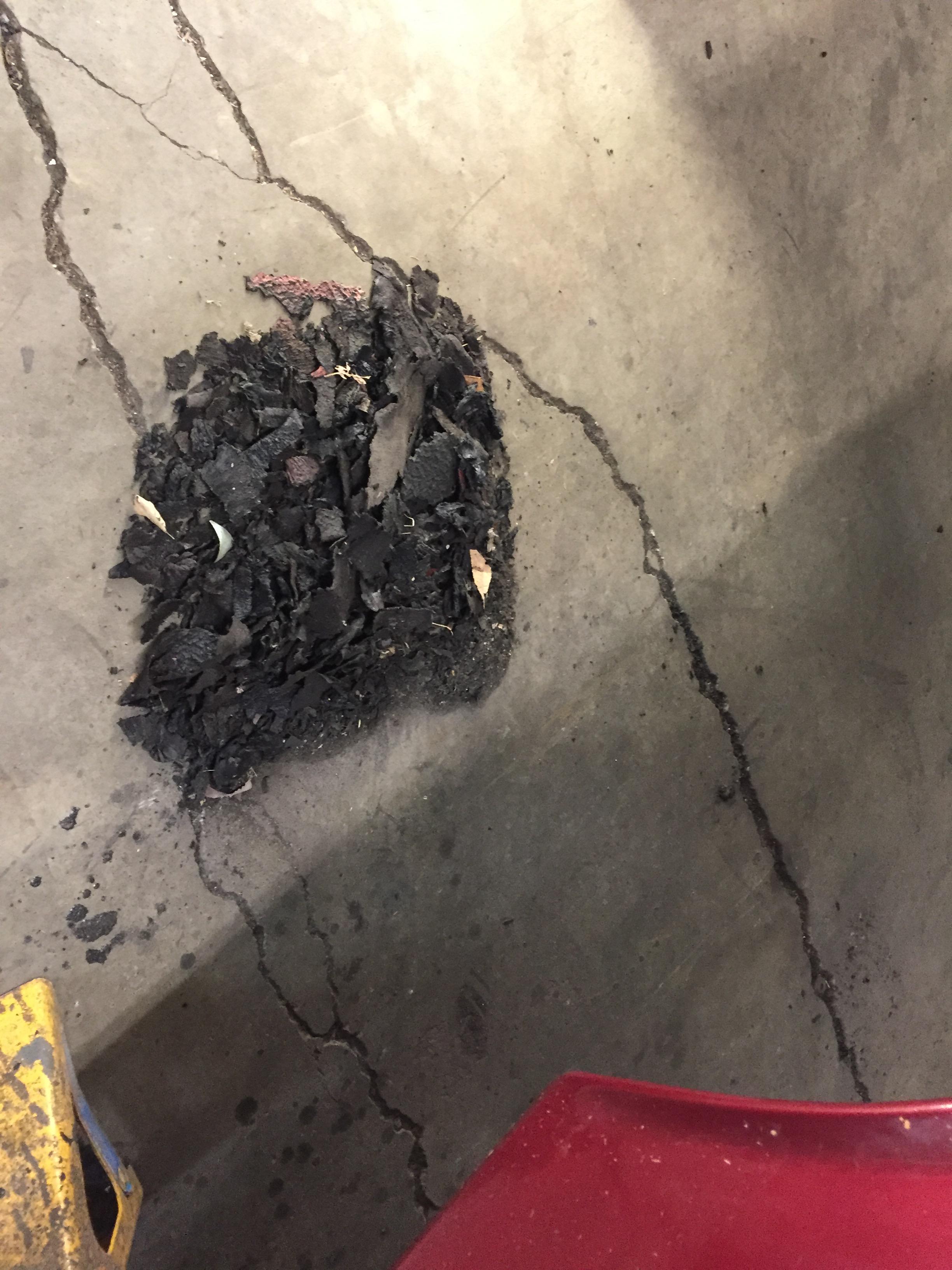

November 13, 20186 yr comment_561556 Undercoating. Love it.... Love it even more when you remove it, and find...... NOTHING! Edited November 13, 20186 yr by zKars Link to comment https://www.classiczcars.com/forums/topic/50908-1976-280z-restoration-project/?&page=184#findComment-561556 Share on other sites More sharing options...
November 13, 20186 yr Author comment_561557 That was super thick...! Link to comment https://www.classiczcars.com/forums/topic/50908-1976-280z-restoration-project/?&page=184#findComment-561557 Share on other sites More sharing options...
November 13, 20186 yr comment_561558 There was nothing over 3/8 thick, most was 1/8 or so. The usual buildup in certain spots. It was applied properly with great prep apparently. It was hiding absolutely NO rust and was stuck on like you always wish it should be. Nothing just fell off, it all warm and scrape, repeat. It's a beautiful fall day here today, highs of 14C, so I'll have the big door open to get the draft going so I don't gas myself or go boom when I do the massive laquer thinner wash that comes next to get it down to pure virgin stock paint. Yes Dad, I'll wear organic vapor breathing protection.... Edited November 13, 20186 yr by zKars Link to comment https://www.classiczcars.com/forums/topic/50908-1976-280z-restoration-project/?&page=184#findComment-561558 Share on other sites More sharing options...
