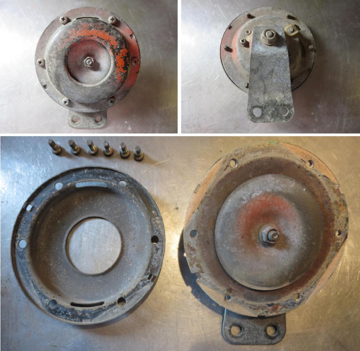

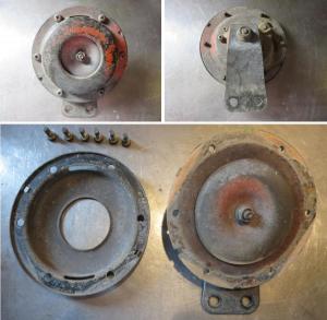

I was almost positive there was only one gasket and it was on the back side of the vibrating plate thingy. To be sure I took the cover of one of my spares and took some photos.
My gaskets were pretty sad too. I made new ones out of the thinest gasket paper I could find in that tan colour. Measured it with the calipers and it was 0.25mm.
If you need anymore info just ask, glad to help.
BTW: They sound awful without the paper. Thicker paper might alter the soaund too.

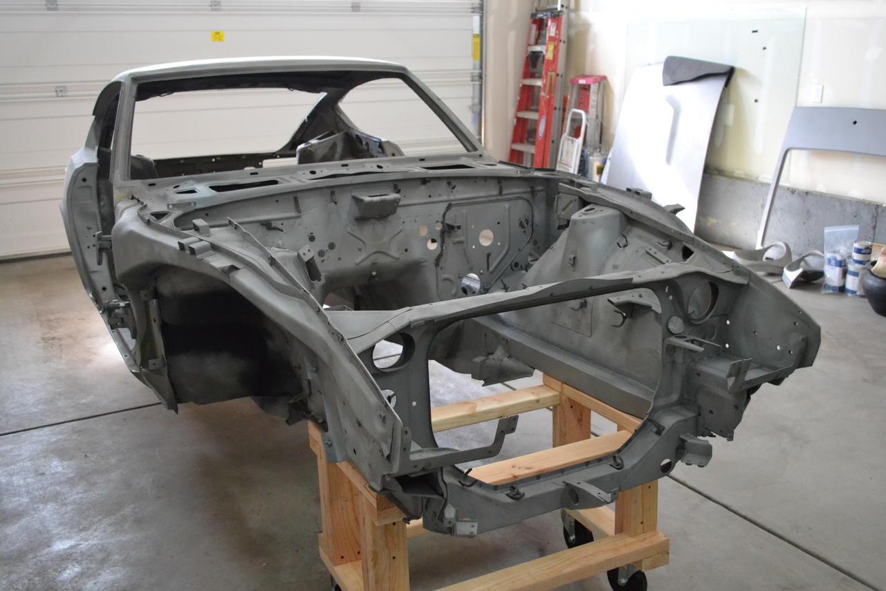

Mine is an early model, 9/75 so I think it matches the position from Hazmatt's thread, along the crossmember.
Sent from my iPizzle ringy dingy device....
great pic - love the dollies, must be nice to roll her around in the garage.
just a thought, might want to slap a diagonal on the sides or some plywood just in case - it would be a major drag to see that body come down, especially on it's owner!
sorry! That pic is from Hazmatt's Rustoration thread. It was showing the front crossmember horn locations only. Mine is still in a more, ahem, "rugged" condition as of yet....!
Once again, thanks Chas! I will see what I can find. I'm sure I have some gasket paper around somewhere. Also need to replace half the screws. Mine were extremely tight and the Phillips head couldn't take the torque. I would rather replace them with Allen head screws or Torx but don't want it to be obvious....

They look like they did a pretty job on the repair though.
I haven't seen the extent of the repairs but there does appear to be a lot of bondo on the panels. I am hoping the future bodywork I have to do will be minimal. I will repair any bad welds and sheet metal work as I go....
That concave area can be hard to get really smooth with a weld joint there. Not saying this is the case but what looks like a lot of filler can just be a really wide thin layer. I am ok with thin layers. If it starts getting thick, that is where the problems come in. If you have ever seen shows cars get skimmed and blocked they look like they haves tons of filler but it is really pretty thin but it makes the panels soooo straight... B)
