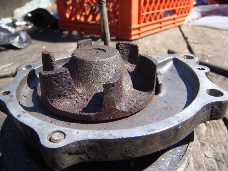

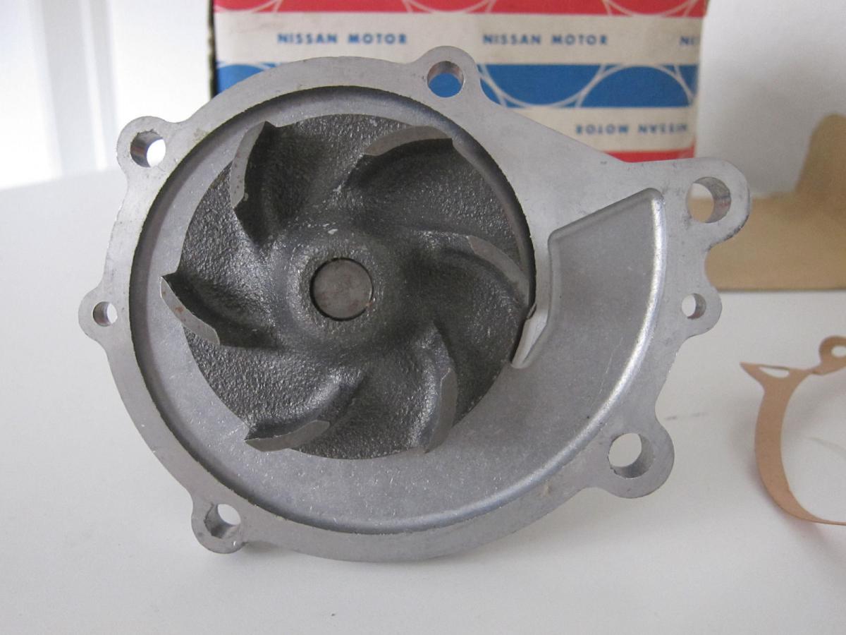

While in my search for water pump swaps, I found out that you can use an L28 water pump on an L4.  Just use the water pump pulley from
a SOHC KA in the hardbody.
post-23403-0-71209300-1422059378_thumb.j
post-23403-0-00048000-1422059391_thumb.j

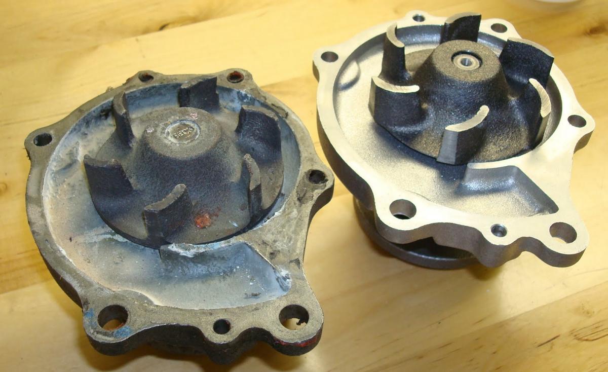

For comparison, the LD28 is the new pump on the left and the Z22 pump is the right picture.  Is it my imagination that the z22 impellers look bigger
than the stock L28 pump thats to the left of the LD28 pump? They certainlay look taller. But does taller move more water? There is more
surface area but is it the length of the impeller that makes the difference?
The bigger impellers do work. There was a guy down in australia that hooked up a fuel pressure gauge to measure before and after water pressure.
Before 28 psi and after installing a larger water pump 35 psi.

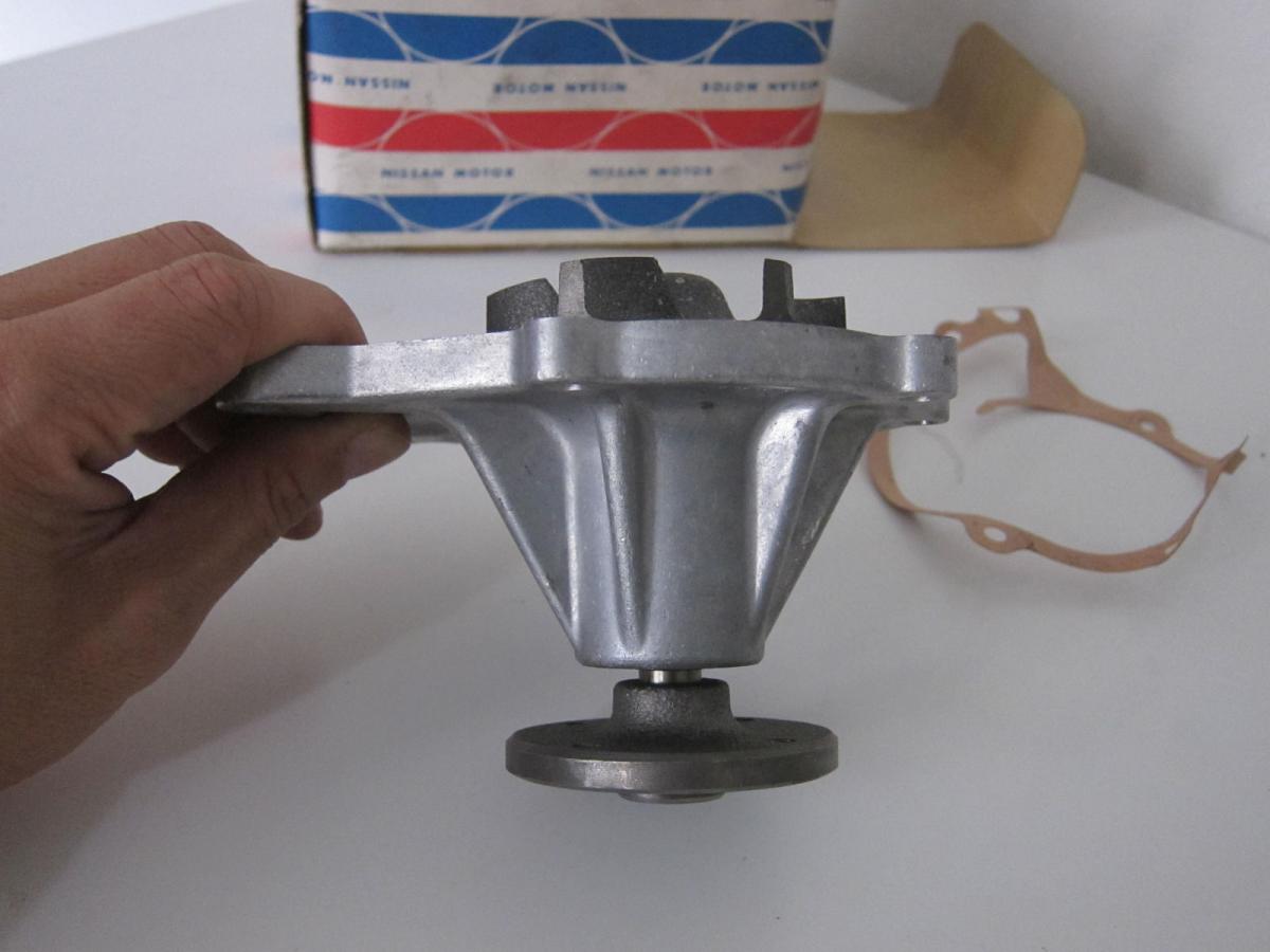

post-23403-0-51197200-1422060557_thumb.j
post-23403-0-41014700-1422060571_thumb.j

That narrows it down.  The LD28 pump is typically used by people that want more coolant flow.  The cast impeller pumps are commonly available though for the typical L28.  The LD thing confused me.
Still not totally clear though, to me.  I think that you're saying that the height of the water pumps are different, putting the pulley mounting flange closer/farther from the front of the engine.  You didn't say specifically but it looks like you're assuming that the L$ pump impeller will fit the L28 timing cover and bolt up correctly, and the only issue is the pulley mounting flange offset.
Anyway, looks interesting.  If you supplied some measurements people could check their pulleys.
