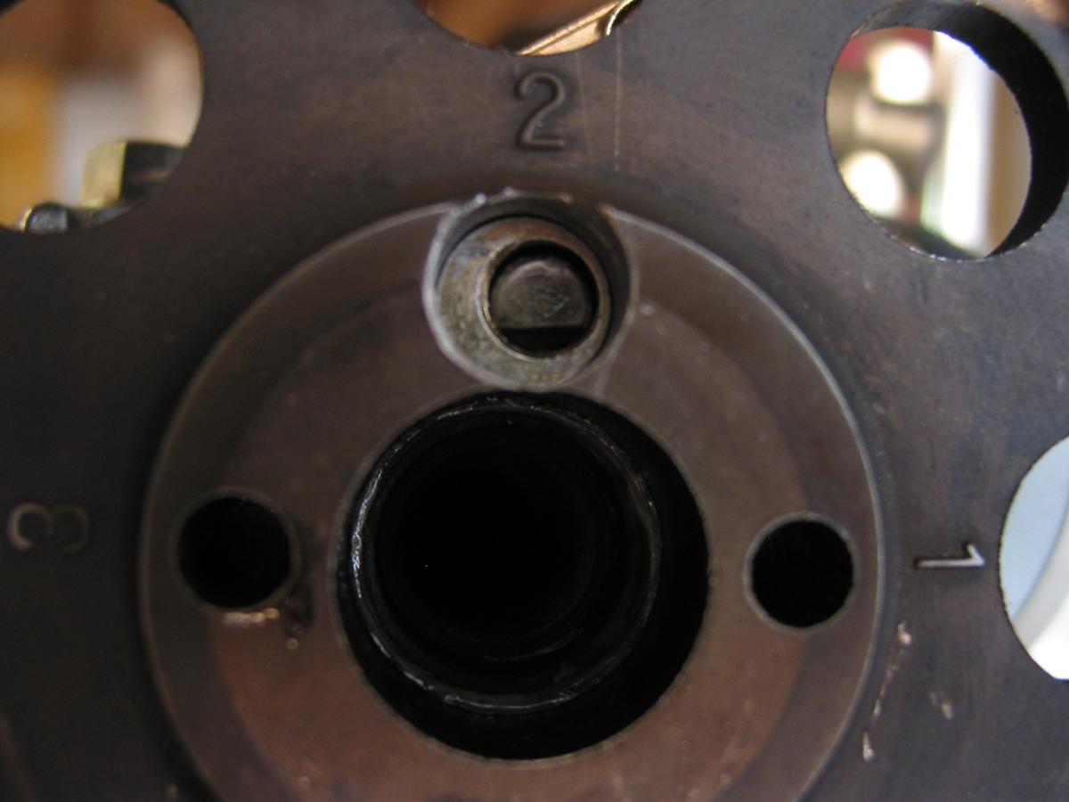

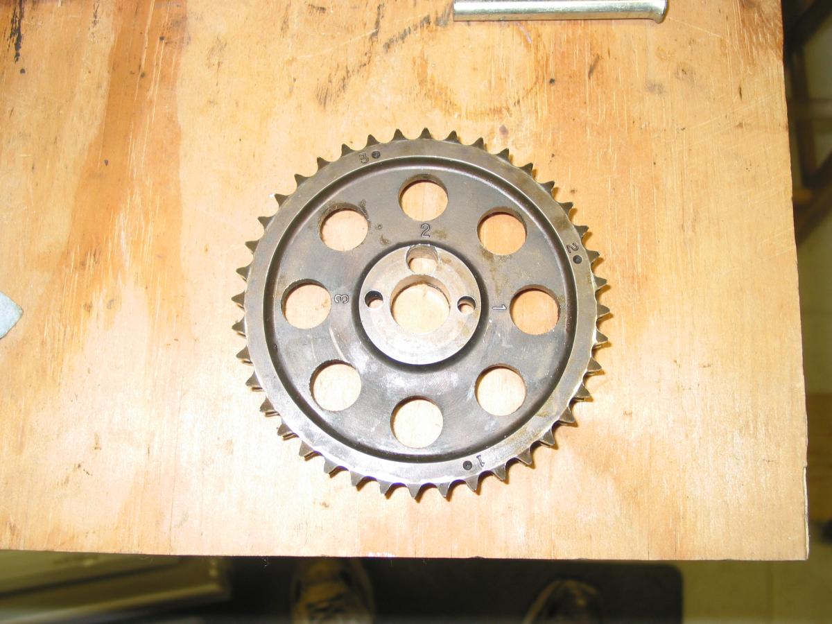

The "standard" shave for a P79 is 0.080" from stock.  To do this, you will need to swap the N42 valves and add 0.080" tower shims.  I did not go that route.  Instead, I shaved 0.050" and left the valves and towers stock.  I then modified the cam gear as shown in the "How to Modify..." book using the Chevy eccentric cam gear spacers.  I also modified the chain guides to get more travel and I oversized the guide bolts from M6 to M8.  With this setup, I get about 9.4:1 CR and it makes great power with little worry about detonation.  I think you get 9.83:1 if you shave 0.080".

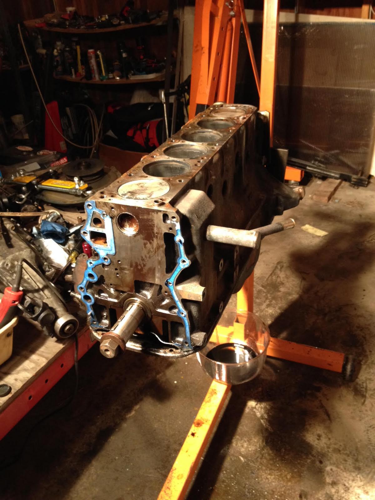

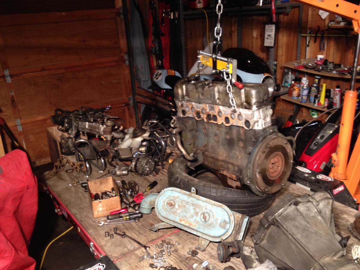

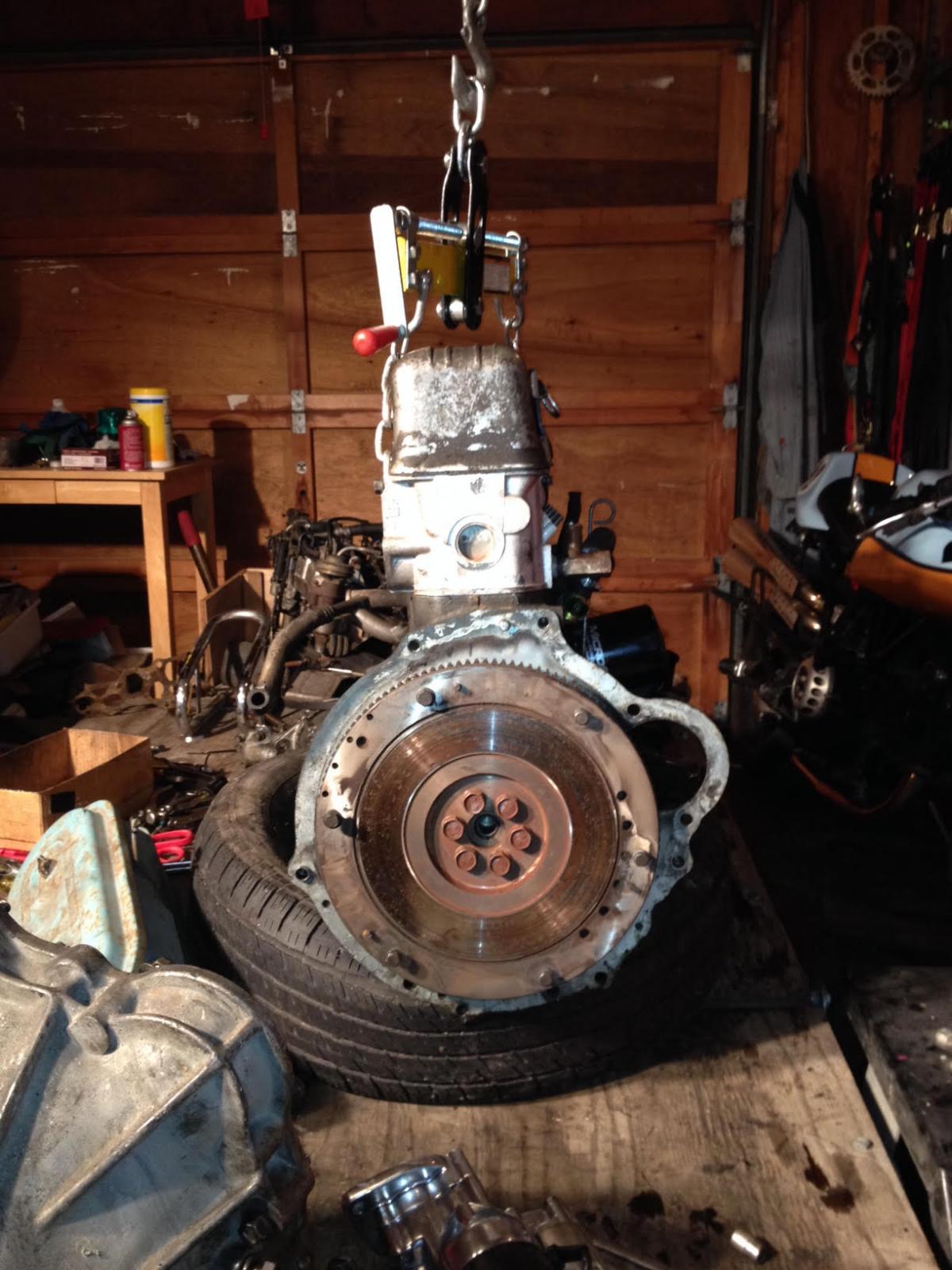

got busy over the weekend tearing into the lump and got it down to the short block. amazing pile of crap that came off it (power steering, a/c, efi manifold) and it looks so nice and simple once all that is removed. looking forward to seeing it all cleaned up with nuthin but a pair of su's on it :)
the po had a re-built head put on and drove it about 5 miles before pulling it in disgust to swap for a v8. he was pissed about it running pig-rich and couldn't adjust the efi (i'm guessing a temp sensor was bad) so i got lucky on this one. in addition to the new head, he also replaced the timing chain/sprockets/chain tensioners so those are some more nice re-usable parts. really the best part of all is that the head and manifolds were both recently removed, so no frozen/rusted fasteners!! what a joy - it all came apart w/no drama in a couple of hours.

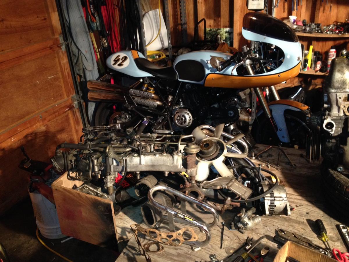

post-28907-0-14896600-1422288070_thumb.j
look at all that crap...
post-28907-0-28861700-1422288072_thumb.j
post-28907-0-58896000-1422288073_thumb.j
post-28907-0-12308300-1422288075_thumb.j

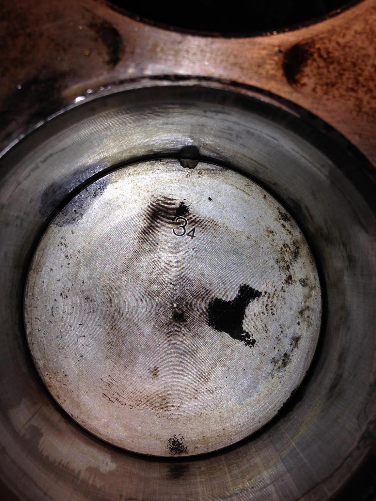

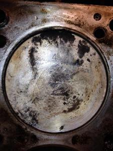

one thing i did notice was that the pistons had numbers stamped in them that were different from each other - any idea what this is about?
post-28907-0-58919100-1422288076_thumb.j
post-28907-0-38694500-1422288078_thumb.j
Feel free to PM me and we can discuss the specifics of the engine mods I did.
I'll have to looks at my pics and see how the pistons were marked.  Those numbers *might* be fit.  I know that the rods are numbered 1 through 6, but I can't remember if the piston numbers were cylinder numbers.
Seems like I read those piston numbers were weight related.  The 3s weighed so much then the 4s & 5s, etc.  A way the factory could balance the motor a little better.  Mine have P79 stamped in the middle too.  It was a ZX motor also.

@ siteunseen - the piston weight/balancing sounds like a plausible explanation, there were 3 marked "34" (1, 2 & 5) and 3 marked "45 (3, 4 & 6). i didn't see anything about to fall apart, but the PO that had the p79 re-built hadn't torqued the head bolts, as they were all over the place on removal and he re-used the old ones, some of which were pretty corroded. when i pulled the freeze plugs i found a decent amount of crap and... an old q-tip behind the #6 drivers side plug ??!? inside the bottom end was pretty clean - a bit of crud in the oil pan, a few bits of metal but nothing that really scared me. the oil pickup screen was quite clean. there were a few odd bolts used here and there which i will replace and repair threads, but no biggie.

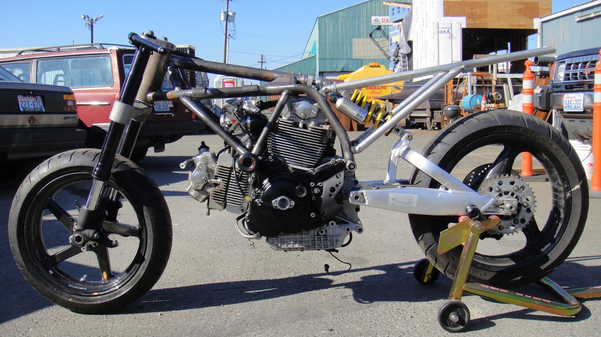

thanks for the compliment - the bike with 42 on the tail is a customized ducati that i built about 6 yrs ago. keeps me sane in between car stuff...
that build was mostly bolt-up, and i was craving a little more challenge so i built this one (43) as a full custom. frame, bodywork, etc. and pulled all the electronics from a modern ducati 2-valve engine and returned it to carbs. as you can see, a trend is emerging...
43 build pic
