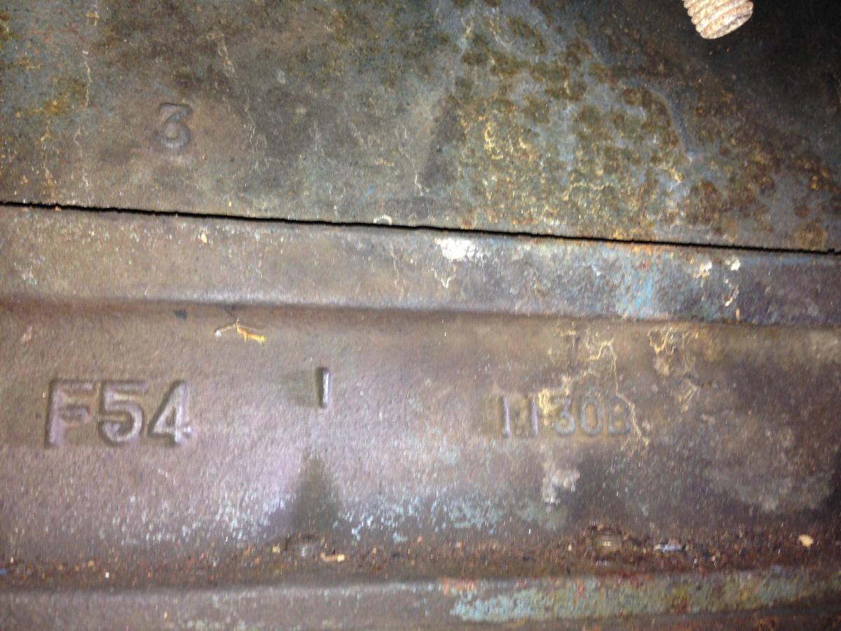

i found a complete flat-top F54 motor w/a close-ratio 5 speed and plan to put the N42 on it for a high-comp setup. the motor comes with a P79, (wrong exhaust port shape) which i'm hoping someone else might be interested in. i've been wanting to do this for a while, and once the head comes back i should have a running car (fingers crossed) and the other motor on a stand in the garage, offering the time/patience to pick away at the build and do a nice job.

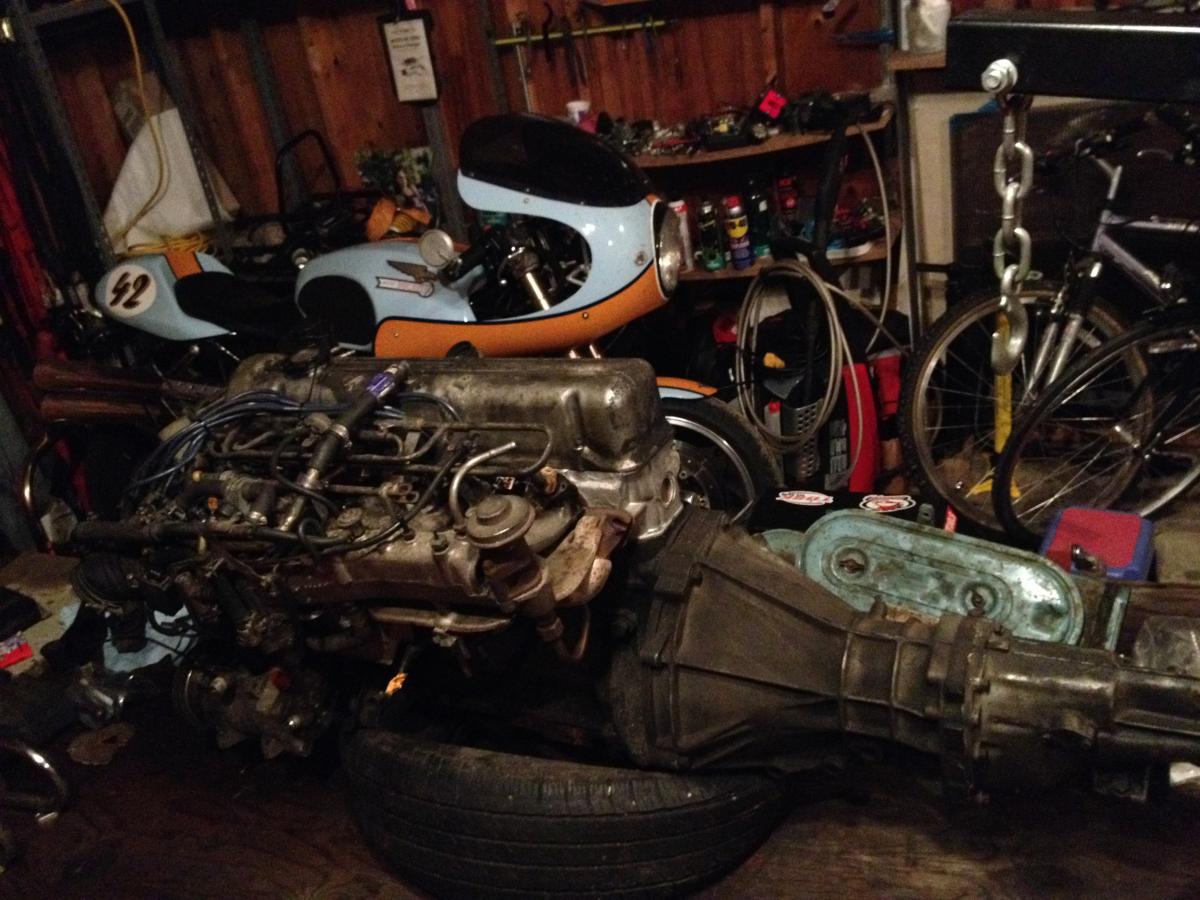

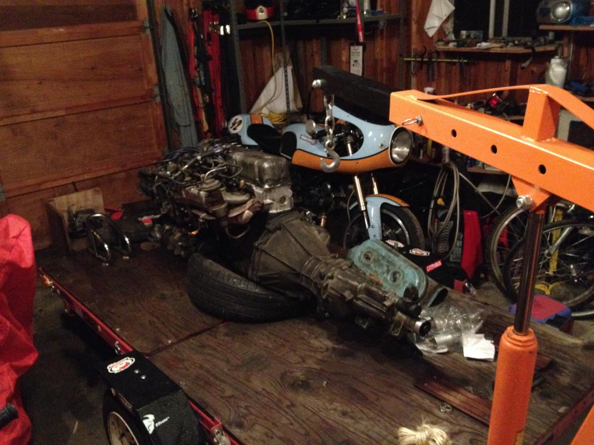

brought the lump home - a few "before" pics:
post-28907-0-68049600-1421005915_thumb.j
post-28907-0-99914700-1421005919_thumb.j
it looks like my square port 6-1 msa header should work fine on the round port p79 so i've decided to use it instead of the n42.
