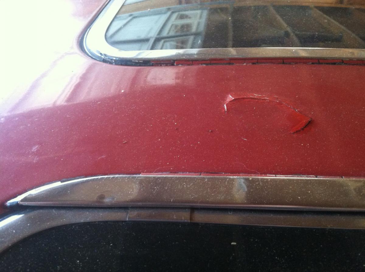

I'm going to be looking it an '83 ZX on Saturday.  The owner and I have talked, and he says there is this one suspicious spot between the T-tops.  Obviously there are signs of repaint work, and the paint appears very thick.  Is this probably just cracked paint/filler, with surface rust underneath?  Or is there a chance it's worse than that?

Take a magnet to the body.  That looks like a thick body filler layer, that came loose for some reason.  Might be signs of damage on or under the headliner, inside, also.  If they put body filler there, it could be anywhere.  Also, if it's as thick as it looks, that gives a sign about the quality of the work overall.  Thick is not good.

Is this a typical area for penetrating rust (e.g. from condensation underneath the roof panel, or would it most likely just be bad body work?  (The paint looks pretty sloppy too.)

Well, supposedly (and we can trust everything people tell us, right?) this car is pretty rust free.  I just didn't know it had lousy body/paint work until I saw the photo.  The owner has always stated the car needs a paint job.  However, I would think it would need to be stripped down to the metal at this point.  The other car I'm considering looks pretty nice in the photos, and the owner claims it's rust free -- painted 6 years ago by Maaco.  (Yes, I already know about Maaco's work, but I suppose it's possible to have a relatively rust free car made shiny by Maaco, no fault of the poor car.)  II suppose we'll find out!
Sarah, I have a crack in the paint that looks similar, but not as big. The car has been resprayed (thick coat) over the original paint. I left a screwdriver on the frame in front or the AFM and closed the bonnet:(
It could be caused by something like that from inside. Sure doesnt look nice. Looks like some sort of repair work underneath.

Looks like body filler letting loose and lifting due to rust under it. The seal near the spot looks ragged, like it's not doing too much sealing. The magnet test will tell the tale.

Thanks, guys!  Dennis, I think that's my impression too.  The owner says he suspects rust underneath also.  I think the temporary fix might be to sand it out, down to the metal, re-fill, prime and spray as close to that shade of red as I can find, and re-seal the T-tops.  It might not look perfect, but at least I can stop the rust.  Then down the road, we might get an "OK" paint job -- a notch higher than the typical Maaco mask-and-spray job.  The thing is, I think all the old paint and bondo would have to come off, and I don't know how difficult or expensive that might be.  EDIT:  Just talked with a body shop I trust, and they suggest it would probably be from penetrating rust -- probably needs patched with some new material.  They also said the old paint doesn't necessarily need to come off, even if it's a repaint job.
