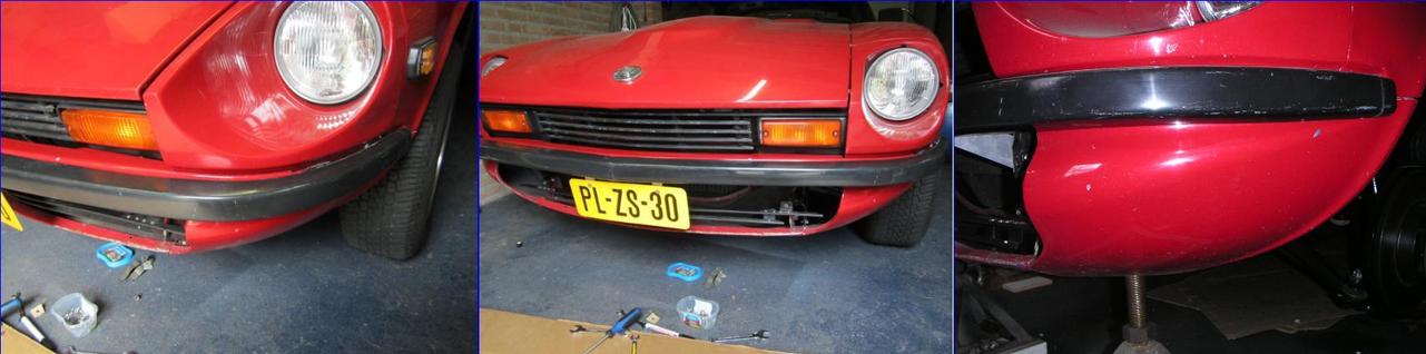

I have one on the fornt of my 280Z. I bought it in Feb 2014.
Positive:
Fitted well. Did need a little sanding on the inside line to match passenger side valance.
Mounting brackets are slotted which allows room for adjustment.
No pitting in fibreglass surface. I have seen others with a lot of pits in the surface.
Cheap. Im using it for testing. Plan to buy a harrington SS bumper (much) later when car is resprayed.
Negative
It will need some work to look really neat. The end "Caps" are not finished very well.
Storage scuffs. Will need painting to fix it. Nothing serious, but its visable.
See photos.

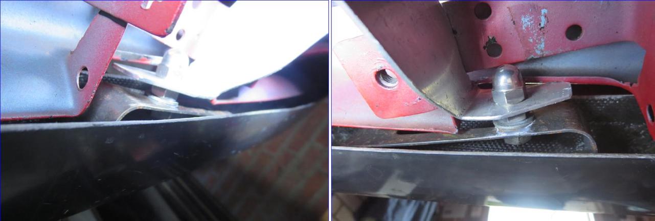

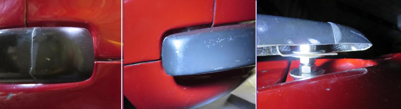

I managed to take a couple of snaps of the bumper mounts. Mind you its on a 280Z, so I imagine it will be a little different on a 240Z.
The slotted mount for the front two mounts should be centered better on the 240Z. Mine are at the inner limit of the slot because I using the old shock mounting points for now.
I also used bolts with a lock nut in the bumper so I could adjust it easier. You can see them in the side ear photos. The photo also shows the poor finish of the left side end compared to the right which is clean.
It was a quick and easy mod and I am pretty happy with the end result. Ill fit the air-dam this winter.

Thank you, thank you! I really wanted to see how the wedge shaped landing was made into the fiberglass, your 2nd picture is perfect. That left end looks like an additional piece of fiberglass, hopefully my painter can sand it down enough it won't be too noticeable.
I will order 1 today. Thanks again.
