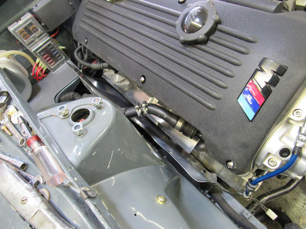

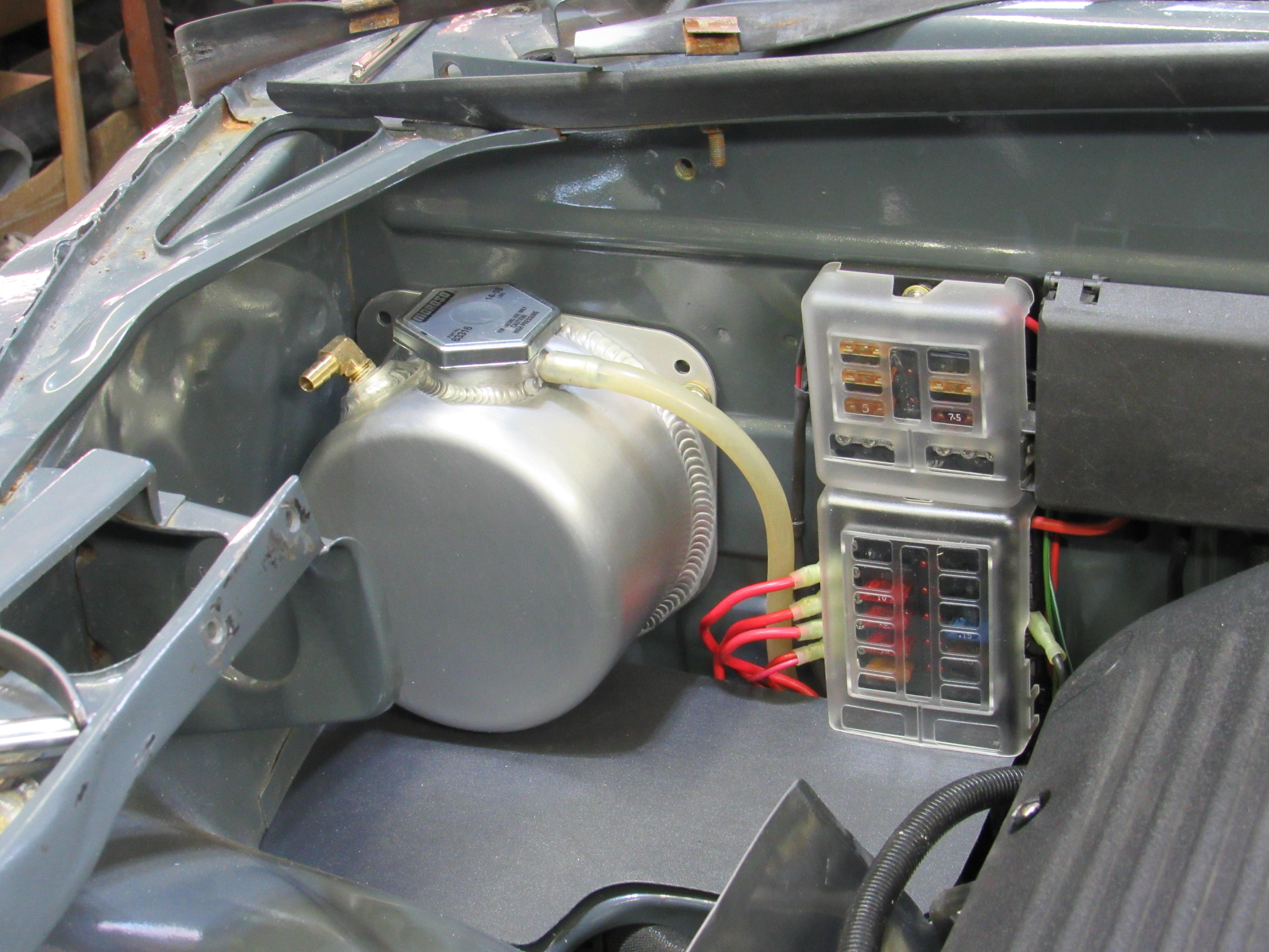

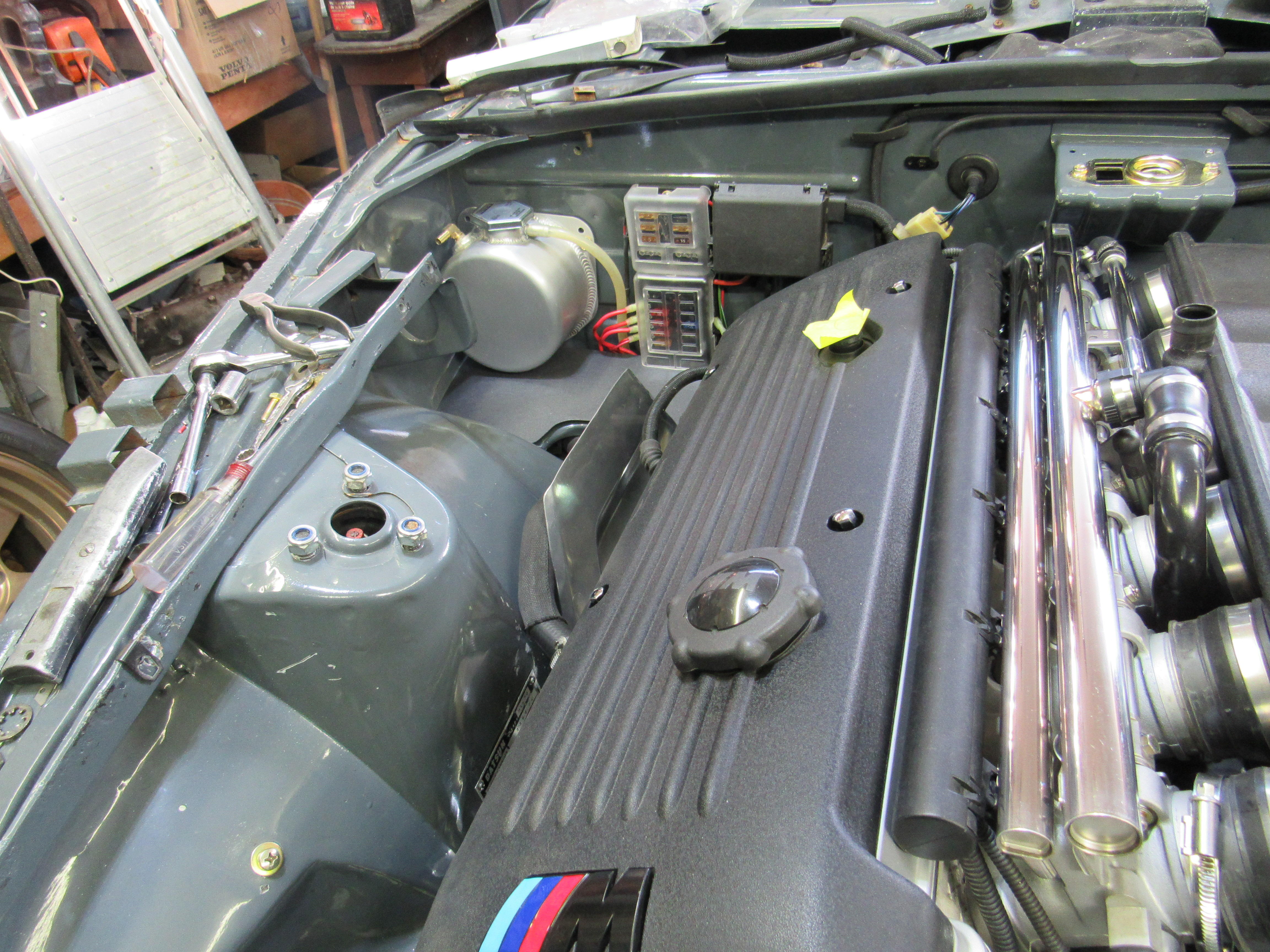

I ended up needing 3 separate water temp sensors, one for the ECU in the stock position, one for the Speedhut water temp gauge and another one for the electric radiator fan controller.  So I had to get creative finding a spot for them,  made the plugs for the sensors with some 80 grit paper, crude but it works and won't be visible anyway.
I got the air box funnel back from Ben, some day when I grow up I want to weld just like him.?  Worked out the location for the oil cooler and try as I might I could not have the drive by wire throttle removed from the ECU.  If I had gone with a stand alone system I could have used a steel cable, so I'm stuck with it.  Everyone says it has a very good feel to it, I hope so.

Big milestone today, the exhaust system is finished and installed now which allowed me to move along with installation of the heat shields, coolant pressure container and finish up the engine bay electrical.

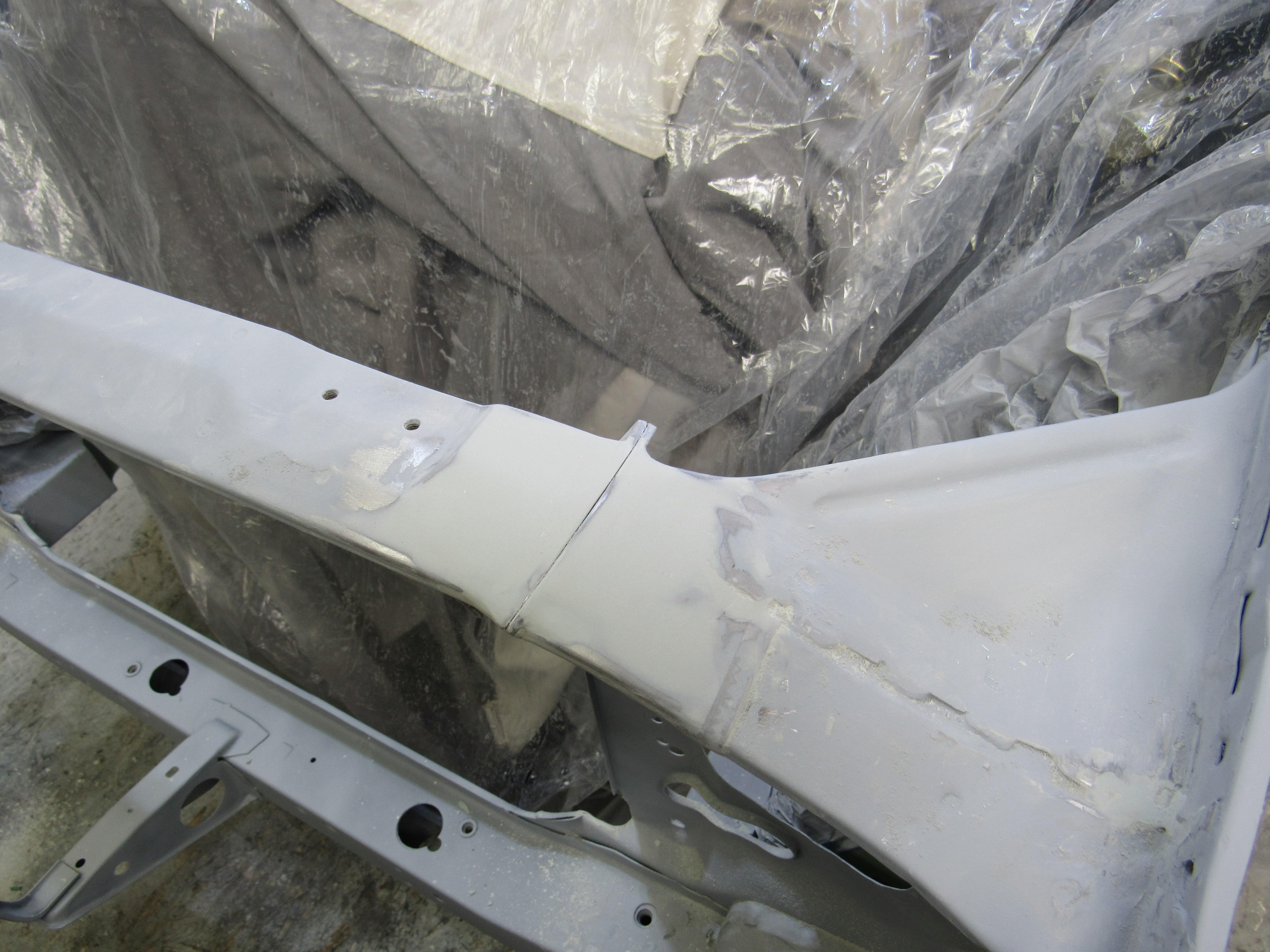

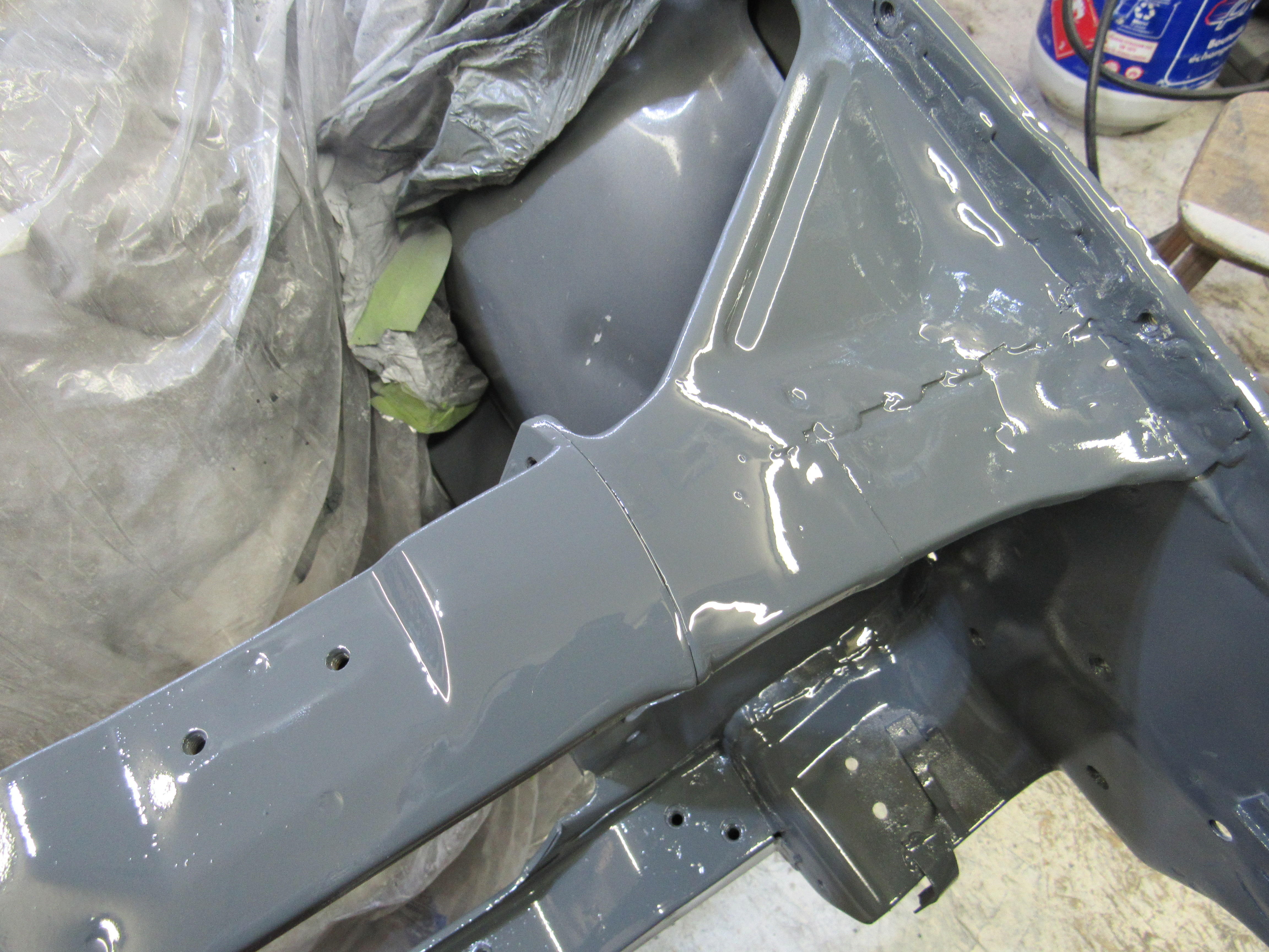

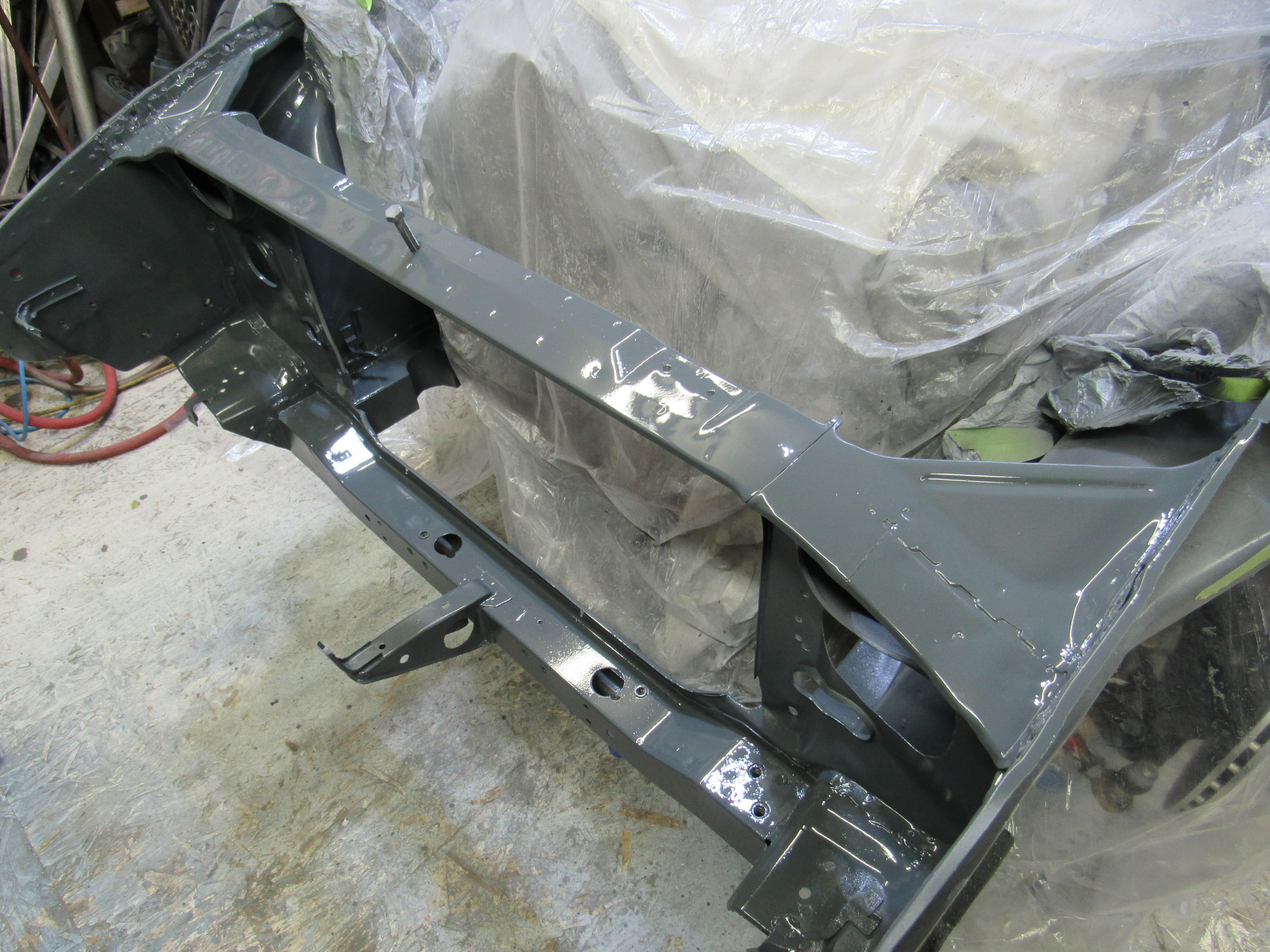

The rad support crossover got some filler, primer, colour and 2 coats of clear today so the rad and oil cooler can go in now, just waiting on one more fitting for the new fuel system and I think I will be ready to turn the key!  Of course then I will spent the following week trying to track down why it won't start, that's my usual MO.
