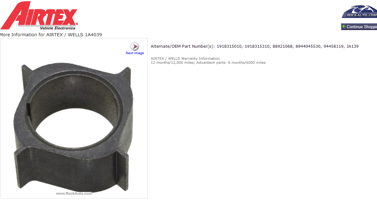

Funny, but the GM people call the reluctor, the metal piece with six outward pointing projections, a "timer core". And the stator (the ring in the ZX distributor with the inward pointing teeth, a "pole piece". And I thought the weird simple names in the Nissan manuals were from translation issues.

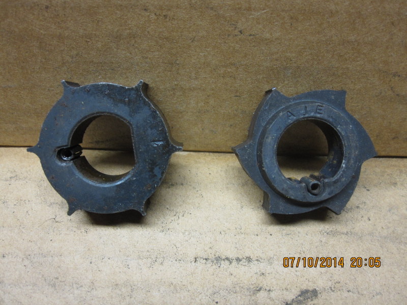

Here's a picture of the Z and ZX reluctors showing the different shape of the ZX's. The GM timer cores seem to look like Z parts, with no fancy shaping. The ZX part has a ramp up to the trigger point, CCW, top-view.
Here are some links to other reluctor images, various manufactures. Odd that the ZX is different. Geek stuff.

Interesting that the Z reluctor looks similar to the original GM units.

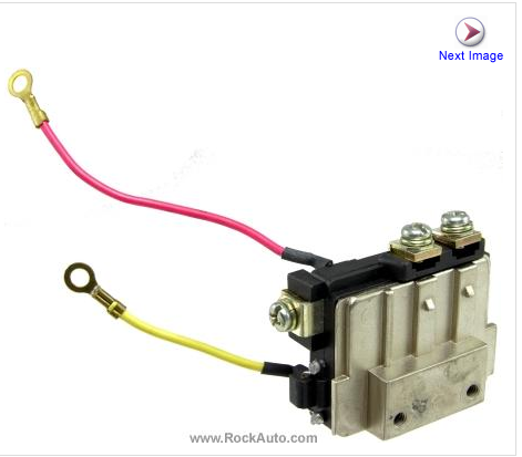

Here is a 1985 Toyota reluctor. It looks like Toyota also had a module that controlled dwell, before they went to ECU timing control. I haven't figured out which year does what. But the reluctor shape is like the ZX's.
If the right person had posted a Toyota module conversion this whole discussion could be about Toyota modules. They're going for about $42 though, so a few dollars have been saved.
Added a module picture. Too bulky!

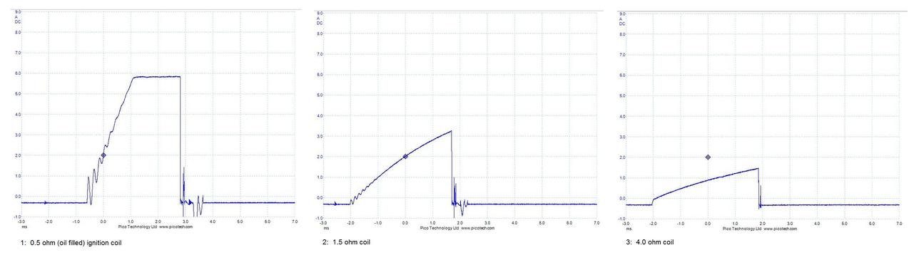

OK, so reluctors and stuff. Here's the pic that started the conversation:
And I did check to see if I have a ZX dizzy, and I do. I hooked it up to the scope and the pickup works, but I didn't get to taking pics yet.
But in the meantime, I had my own "Doh!" moment... You know all that stuff about rotational direction? It's BS. With the Z distributor, the waveforms look the same regardless of which direction you spin the shaft, and here's the reason:
The voltage changes you see on the scope are caused by the changing magnetic field through the wires wound inside the pickup.
You approach the pickup point and the magnetic field increases - Current is induced in one direction.
You reach the pickup point and the field stops increasing - Current stops.
You move away from the pickup point and the magnetic field decreases - Current is induced again, but in the other direction.
But here's the thing... It doesn't matter which way you approach the pickup point from, since the pole of the magnet isn't changing, the current will always be induced in the same direction regardless of what direction you approach from. The steep zero crossing will always be in the same direction regardless of the rotational direction.
The only way to change the waveform polarity would be to use the other magnet pole (which you can't do) or to switch the wires to the scope. In reality, the only way to change the direction of the steep zero crossing is to swap the wires.
Doh! I should have known that... :stupid:
The ZX dizzy changes the waveform a little because of the assymetric shape of the reluctor, but the Z would be the same in either direction. Only way to change the polarity is to swap the wires.
