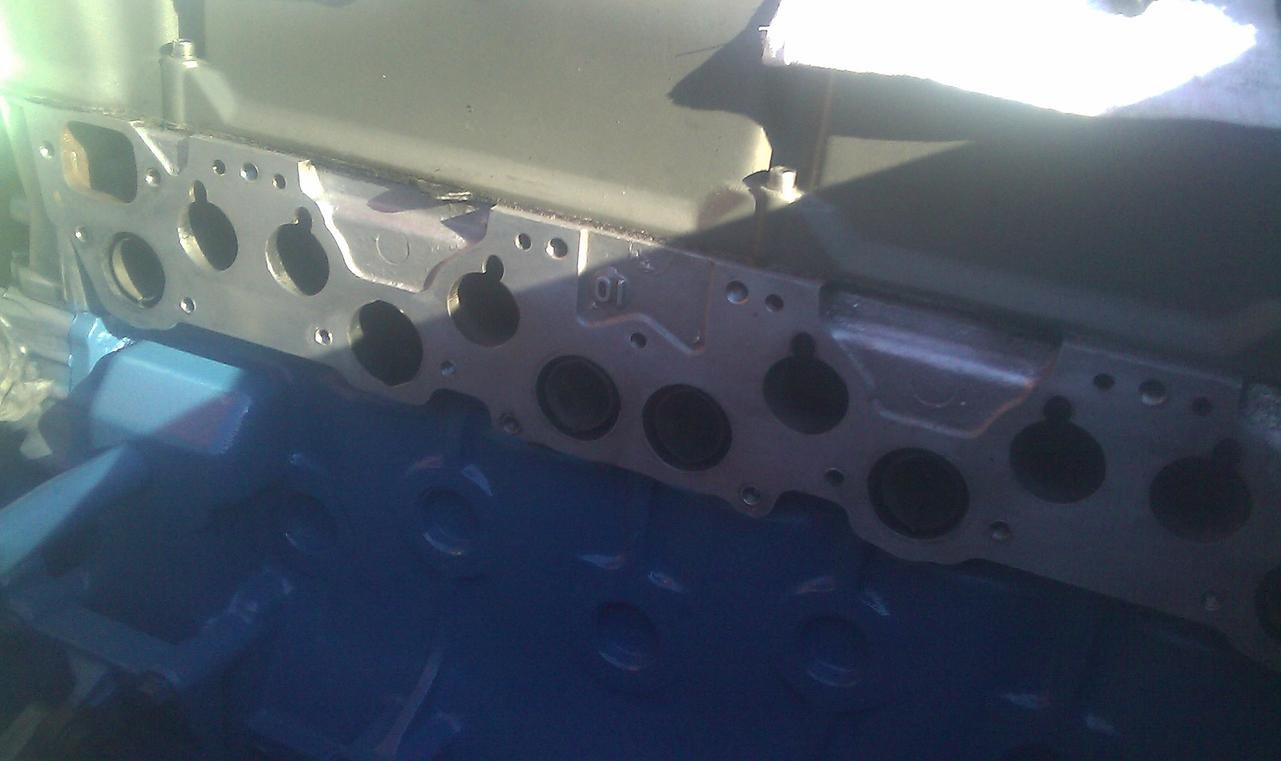

Chased all the threads and prepped the head for the new gasket. All is looking very good so far.

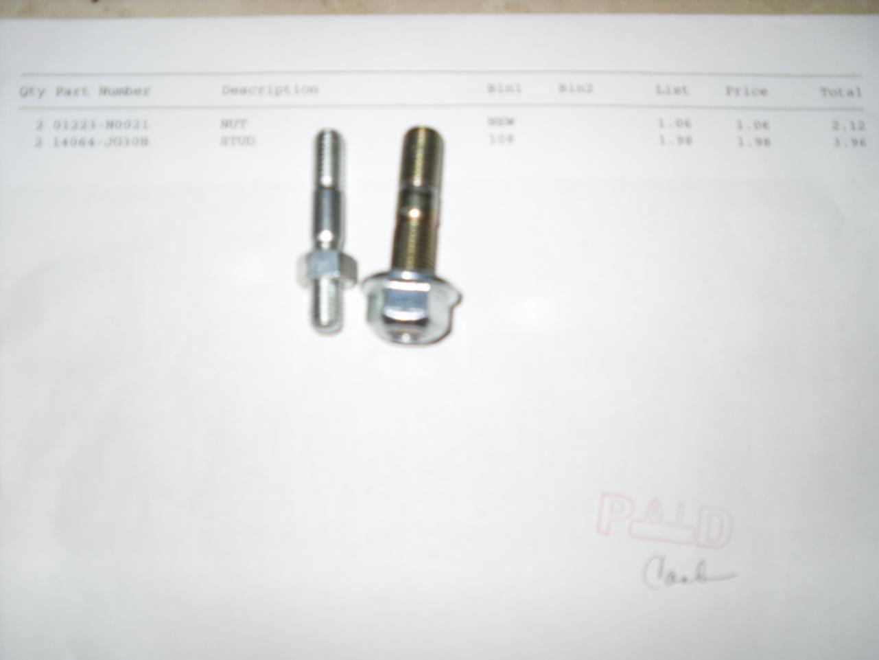

You can get Nissan factory-quality manifold studs from the dealer. Designed for the application. High numbers in a bolt or stud grade doesn't mean that they're better. Just that they're different. You don't need super-high yield or ultimate tensile strength, you need fatigue and heat resistance. Constant bending and heat-cycling is what breaks the studs. Better to get a stud that's been tested for the application by the factory.
You can get the part numbers here, and your dealer will have them. If you get a good parts guy he can find them on his own by car model. They're common and cheap.
Datsun 280Z Cylinder Head, Rocker Cover & Thermostat L28E
You can get the nuts also. Notice that there are no lock washers.

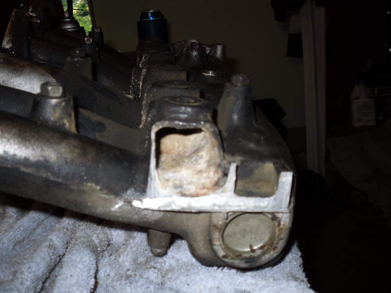

My last hole at #6 was so wallerd out I had to go bigger and the 1st hole at #1 under the thermostat housing had a heli-coil in it that I drilled out and went bigger. Do you have the N47 intake manifold? If you do, does it have any rot around the EGR tunnel where the tube from the exhaust manifold connects? My '77 did and another guy, Rossi, had the same problem with his. Here's a picture of mine after I sawz-alled the EGR mount hoping I could have it welded up. No way said my welder so I lucked up and found an early edition N47 without the EGR openings.

Thanks for the insight you guys. I want the high grade studs for number 1 & 6, heat treated, for exhaust use. Nissan used grade 7 studs. The others don't suffer from the tension - breakage problem. Am replacing all the studs & bolts (except for the big intake bolts) because they were in poor shape and I don't want any issues with removal in the future.
The last thing I would do is over tighten steel stud in a aluminum head beyond factory spec.
I think Nissan used pinch nuts instead of washers - except on 1 & 6 which had washers.
Site - yes, my intake is N47 and the egr portion of the manifold was in good shape. I am deleting the egr however.
Ya - Rossiz's intake was interesting, glad I didn't have to deal with that.
Come the think of it - all his threads are interesting.... waiting to see how his new head works out.
It's not a tension problem. The threads would probably pull out of the head before the stud failed from tension. But it sounds like you've made up your mind. Probably not a big deal either way.
Why are you following Nissan on the nuts, but not on their stud grade? Don't you want to use lock washers and threadlocking compound?
