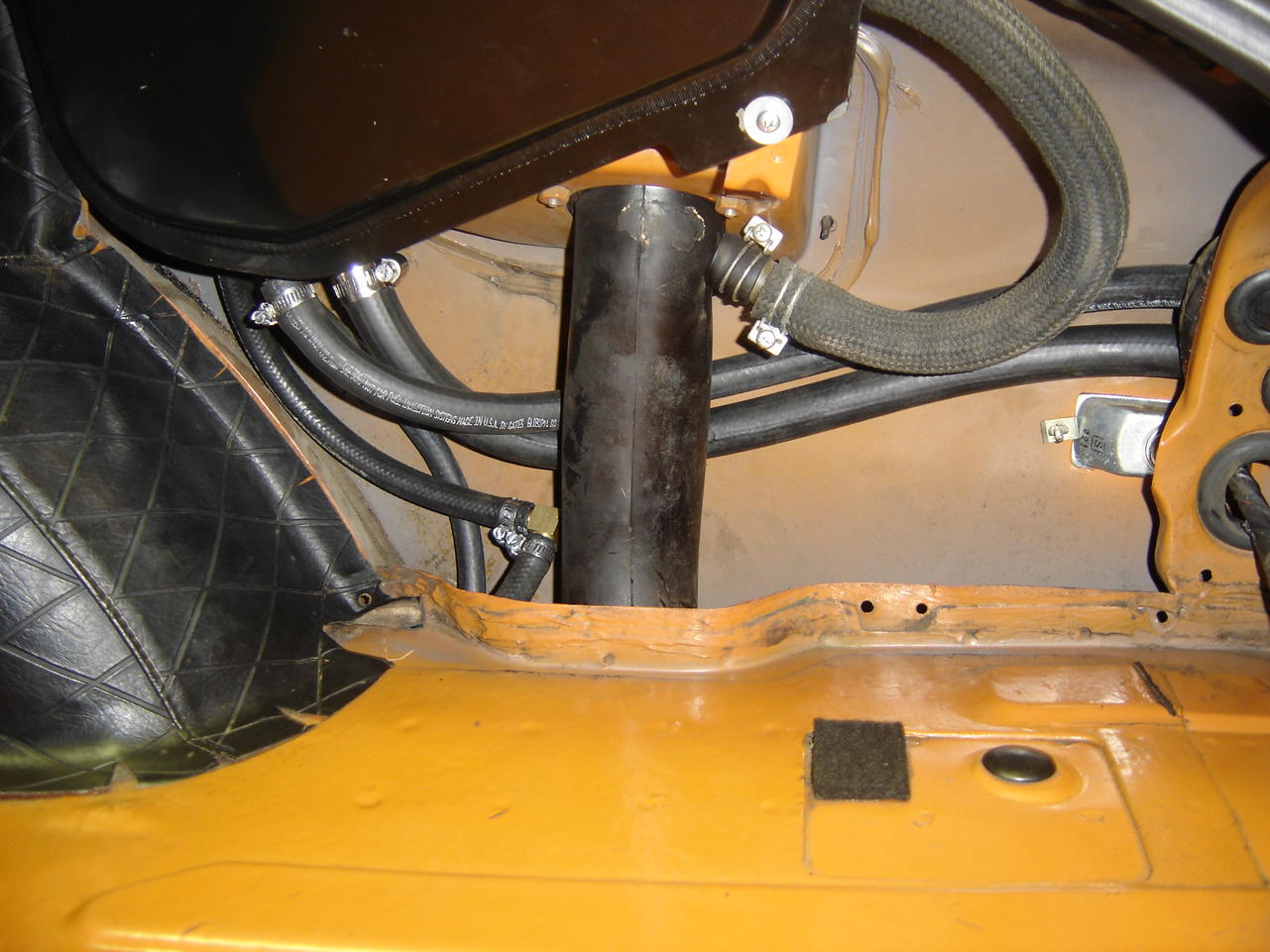

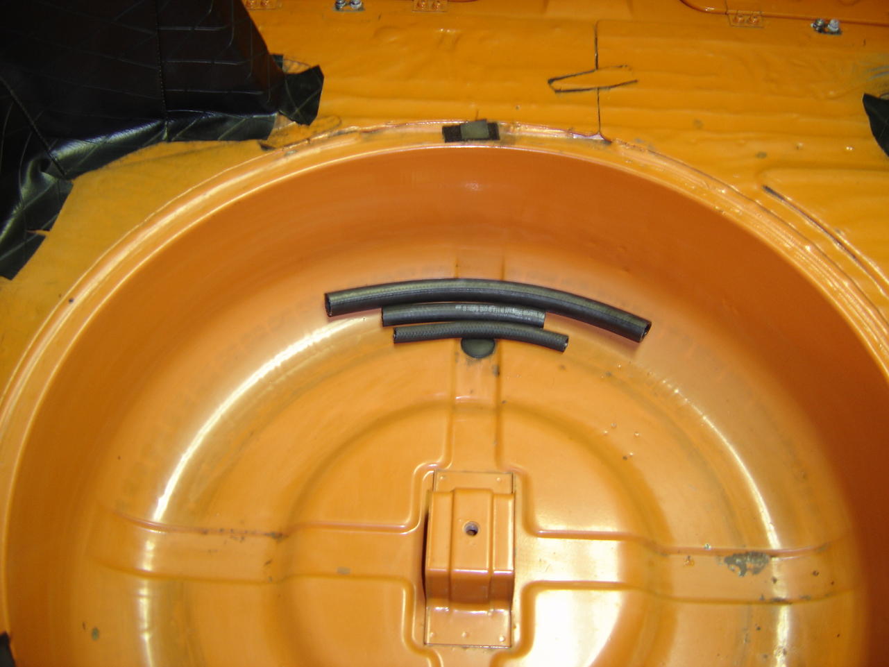

I got it all put back together Saturday morning. $65 worth of fuel hose and clamps from O'reillys. Two 3/4" pex elbows for the 180 turn on the 5/8" hose off the back of the tank. Two 1/2" pex elbows for the 3/8" line that hooks in above the sending unit. 1 where the hose goes into the tank, the other under the vent tank to keep the line from pinching together. Started at 5:30 a.m. and was finished at 10:30 a.m. Cleaned up and laying on my couch at 11:30, drinking beer. The universal hose was cheaper but a bit tougher to deal with I'd imagine. Vaseline and a hair dryer were my #1 tools.
I'm happy with the end results.
