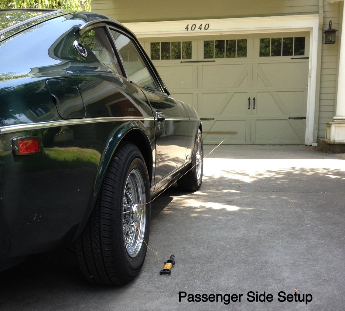

  • get a rod or piece of wood that is a bit longer than the width of your tire spacing (outside to outside)
  • attach it to a wall or some heavy object - concrete blocks will work (you need to get some tension on the strings)
  • mount it at the wheel centerline height, or a little lower if required to clear hub caps or center caps stick out
  • park the car square to and centered on your rod/wood bar, about 15' or so away (i was lucky to have a centerline in the concrete pattern)

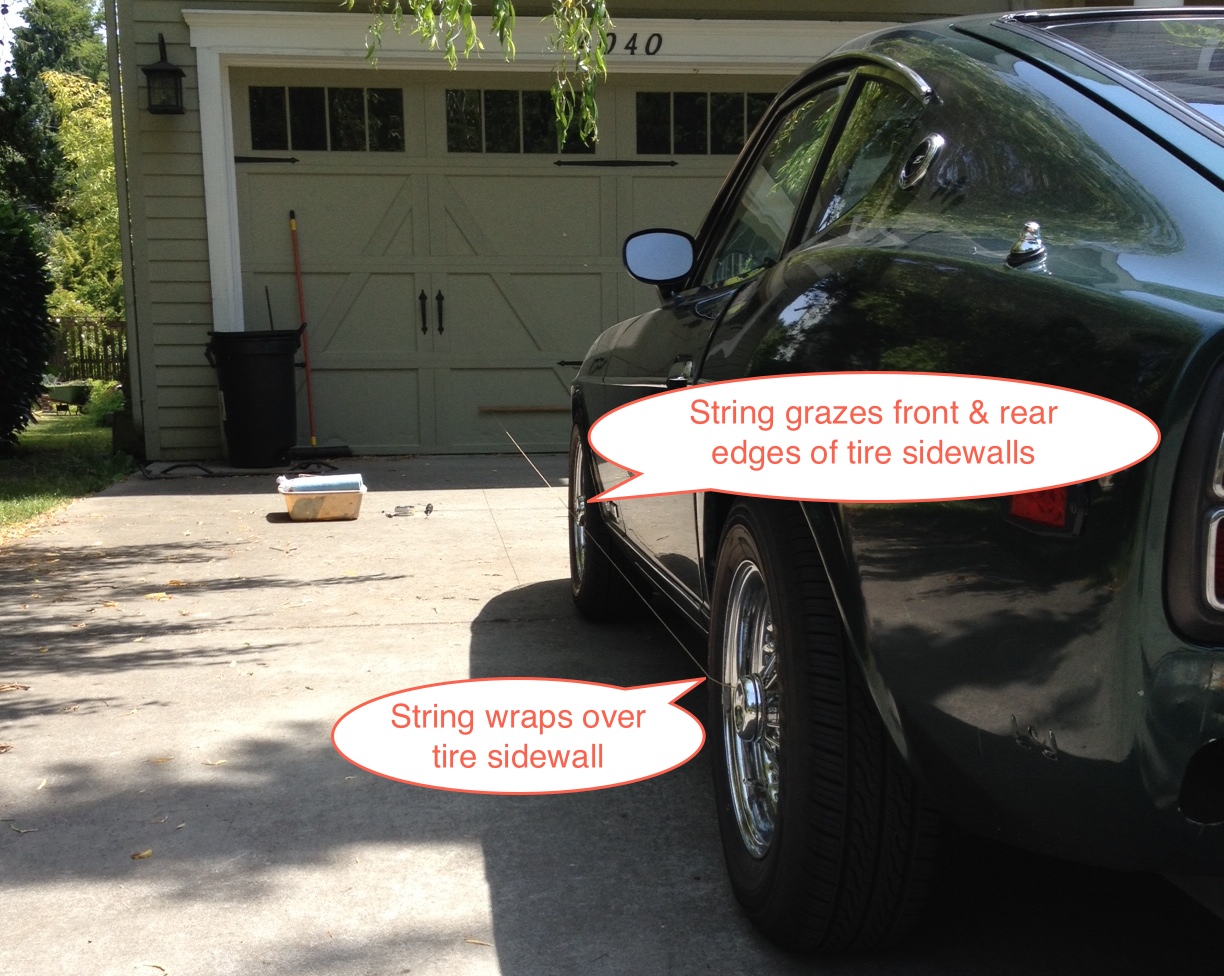

  • tie the string to the back wheel at a lug nut or the wheel itself, inboard of the plane of the tire, such that the string runs over/touches the tire sidewall when pulled forward
  • pull the string forward, loop it around the rod/bar and pull it taught, adjusting it in small increments to get it to just graze the sides of the front tire
  • do the same on both sides of the car

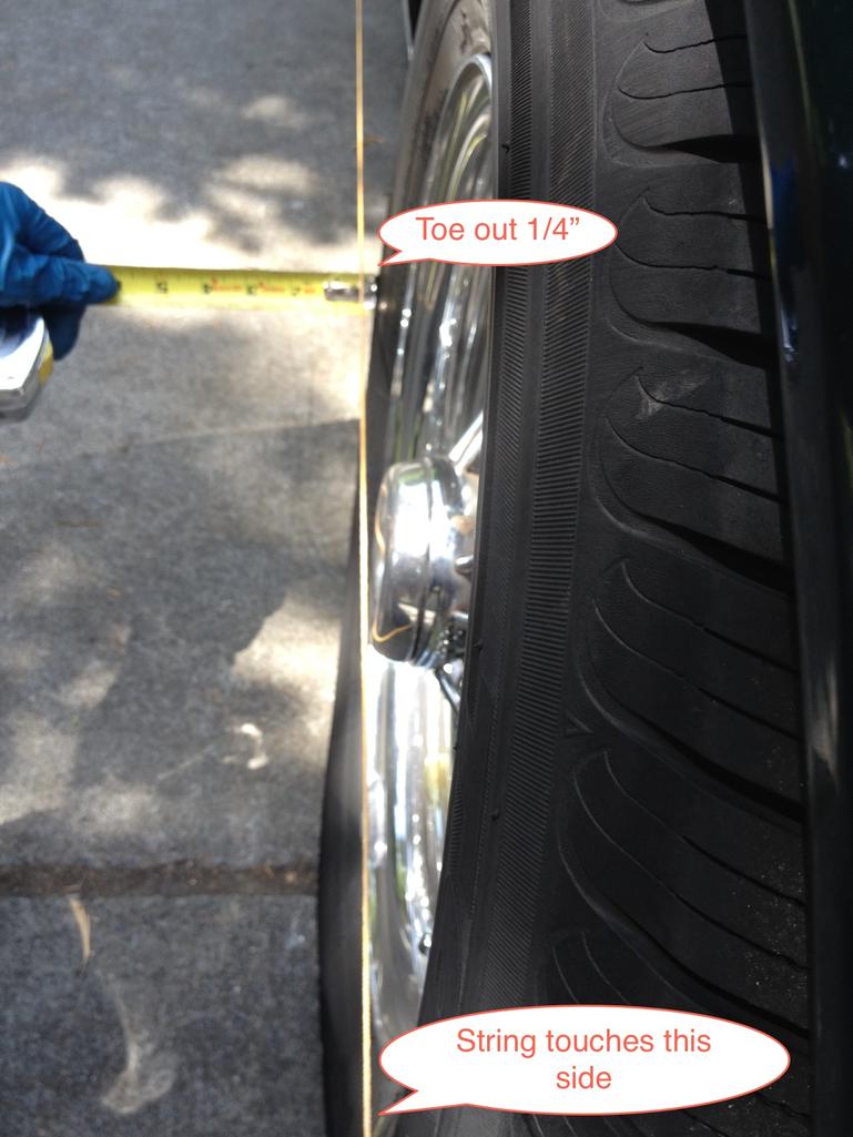

  • measure width of string at tires, then match dimension at the rod/bar

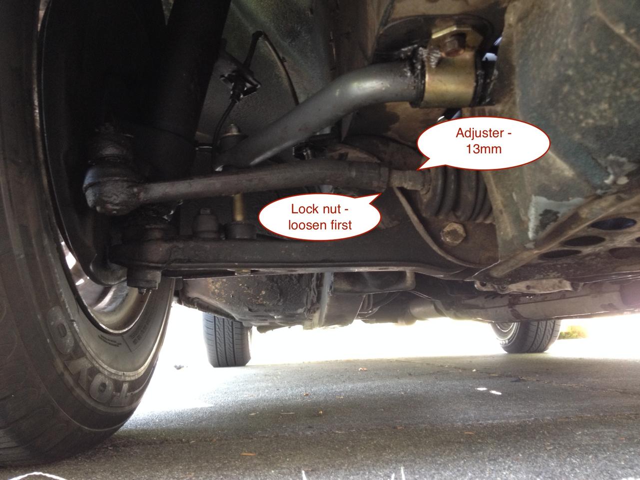

  • undo the lock-nuts on the tie rod adjuster rods, turn the adjusters in or out as required to line up the wheel w/the string

set up rod, line up the car, pull the strings:
get strings lined up with the tire sidewalls one side at a time, checking dimensions at the wheels and at the rod do ensure strings are parallel
measure how far out you are and in which direction
as you crank the adjuster keep an eye on the tire - you can watch it move as you turn the wrench and dial it in
