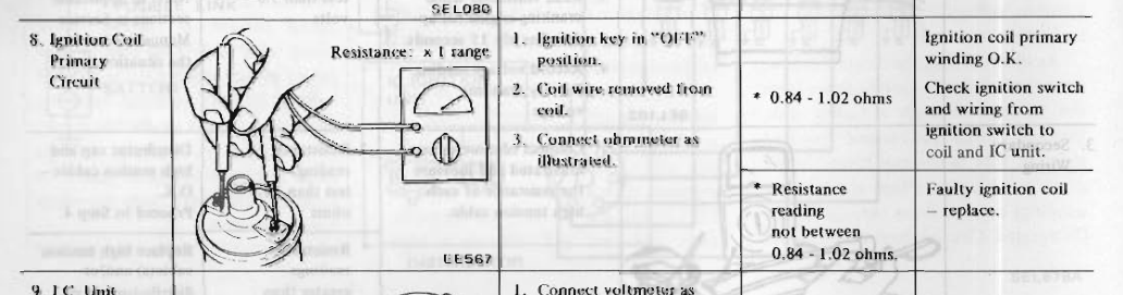

If you want to match the Nissan system specs. then about 08. - 1.0 is the range. You want to match the coil's resistance with the module's. Lower resistance might give a stronger spark but it will put more heat in to the ignition system since total resistance will be lower. Hotter coil and hotter module. There's probably room in the Nissan engineer's design safety margin for lower resistance. Your dice.
Copied a picture from the 1981 FSM.

I believe Zed is right and you want around 1 ohm. My coil was for the stock ZX dizzy. I thought my flamethrower was giving me fits and I bought an OEM coil to troubleshoot. The problem was my carbs and I didn't need the coil at all.
