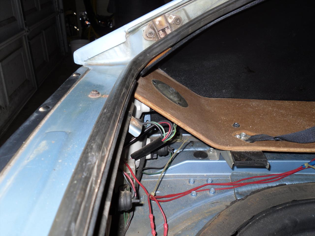

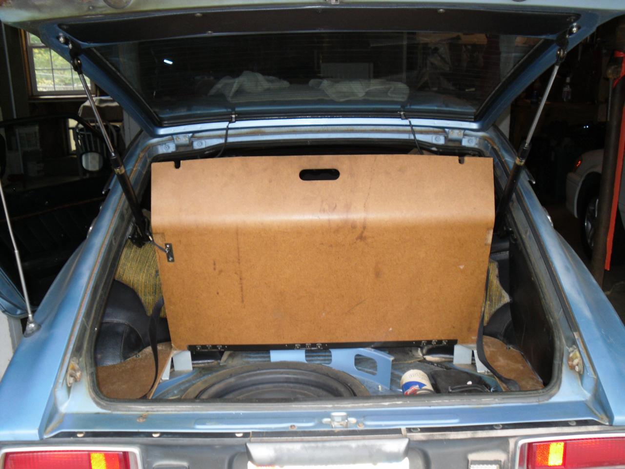

May 11, 201411 yr comment_447631 Mine is a 9/'76 build date but titled as a 1977. When I buy things they call it an "Early '77" with the sloped rear deck. Is yours sloped up at the rear, by the hatch or flat? Do you have a factory 5 speed? When I went to download the '77 FSM from Xenon it was a "coruppted file" according to my computer and wouldn't let me download it so I got the '78 manual. Link to comment https://www.classiczcars.com/forums/topic/49209-serial-number-_vs_-factory-service-manual-information/#findComment-447631 Share on other sites More sharing options...

May 13, 201411 yr Author comment_447746 I have 78 rear strut assemblies on my 1/76, 289117. It's a direct swap, I did it myself.Tiny grammar issue - jibe. Thanks All for your comments. I have not been able to find a 77 manual, and have no luck downloading one yet. It has the angled rear deck-and 5speed. The carpartsmanual is a great resource, along with xenons fiche. Dr ZedHead the americanenglishdoctor.com website does indicate some geographical variations. We accept all here at TheClub - even expat Brits maybe we'll see you at Canby this year.... @DatsunsNW . The serial number does seem to be out of sequence with a spreadsheet I've seen - Maybe MrBeck? Link to comment https://www.classiczcars.com/forums/topic/49209-serial-number-_vs_-factory-service-manual-information/#findComment-447746 Share on other sites More sharing options...
