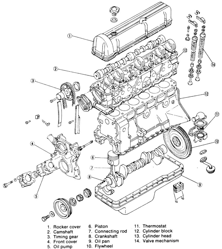

April 25, 201411 yr Author comment_446566 not the distributor, can't be the water pump (no belt, it wasn't turning) i found this exploded view and i'm just scratching my head about what could be making this happen - nothing LOOKS like it would do that. Link to comment https://www.classiczcars.com/forums/topic/49096-strange-whirring-noise-from-engine/?&page=2#findComment-446566 Share on other sites More sharing options...
