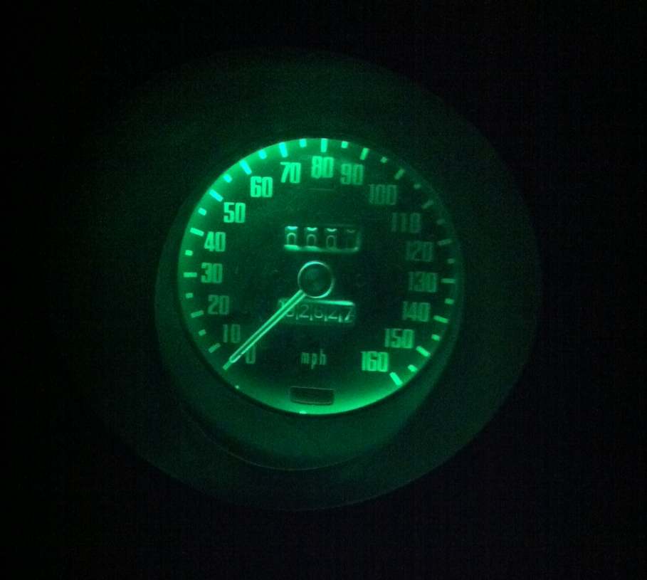

I've been doing some experimenting lately. I bought some wedge bases for the instrument lights (10 Pcs Heavy Duty T10 168 194 2825 Wiring Harness Sockets Pre Wired | eBay) and some low-profile wedge bulbs (green - Amazon.com: Jtech 10x T10 8-SMD Green LED Car Lights Bulb W5W, 147, 152, 158, 159, 161, 168, 184, 192, 193, 194 2825: Automotive red - Amazon.com: Jtech 5x T10 8-SMD Red LED Car Lights Bulb W5W, 147, 152, 158, 159, 161, 168, 184, 192, 193, 194 2825: Automotive blue - Amazon.com: 8x T10 194 168 501 4-smd 3528 LED Car Light Bulb Blue: Automotive). The green bulbs have 8 SMD LEDs, and they all point forward, illuminating my test gauge fairly well. The low profile bulbs make it where I don't have to remove the lenses from gauges, too. I am looking forward to doing the conversion.

Here's a picture of a speedometer I used to test the new LEDs and bulb sockets I described in my earlier post. I know I'll be able to see that better at night.
