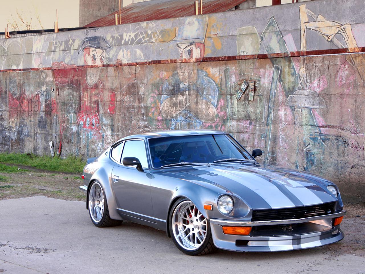

I am wanting to get one of these cars. As my username says i am a BMW fan. I know a lot about the E30 BMW and the S motors. However i have always liked these cars ironically a S30. Well what im wanting to know is what are the common issues of these cars? And i also saw a Z that i thought was absolutely gorgeous. http://static.cargurus.com/images/site/2010/10/05/09/00/1973_datsun_240z-pic-7827081713729940921.jpeg
What are those fenders?
I cant get one of these just yet unless i find one with no engine.
I think it's the M30 engine that is similar to the Z's L Series engine, straight 6 with overhead cam and timing chain. I had a '89 325is that I drove into pieces, best car I've ever owned, sold it in 2010 with over 300K on it. It had a cast iron block like the Z's have. Nissan parts are so much cheaper than BMW's it makes owning one or more a lot easier to do, for me anyway. You'll see that a lot of the folks on here also have Beamers. That car is sort of a mystery to me, I heard it was in Atlanta but someone said otherwise. Gray with white stripes and flared fenders to accommodate those wheels, beautiful. It's a 240Z, find you one!
That very picture was one of the reasons that sold me on my Z. As others have stated, rust is a major concern. And maybe your girlfriend getting jealous of all the time you spend with your car.
