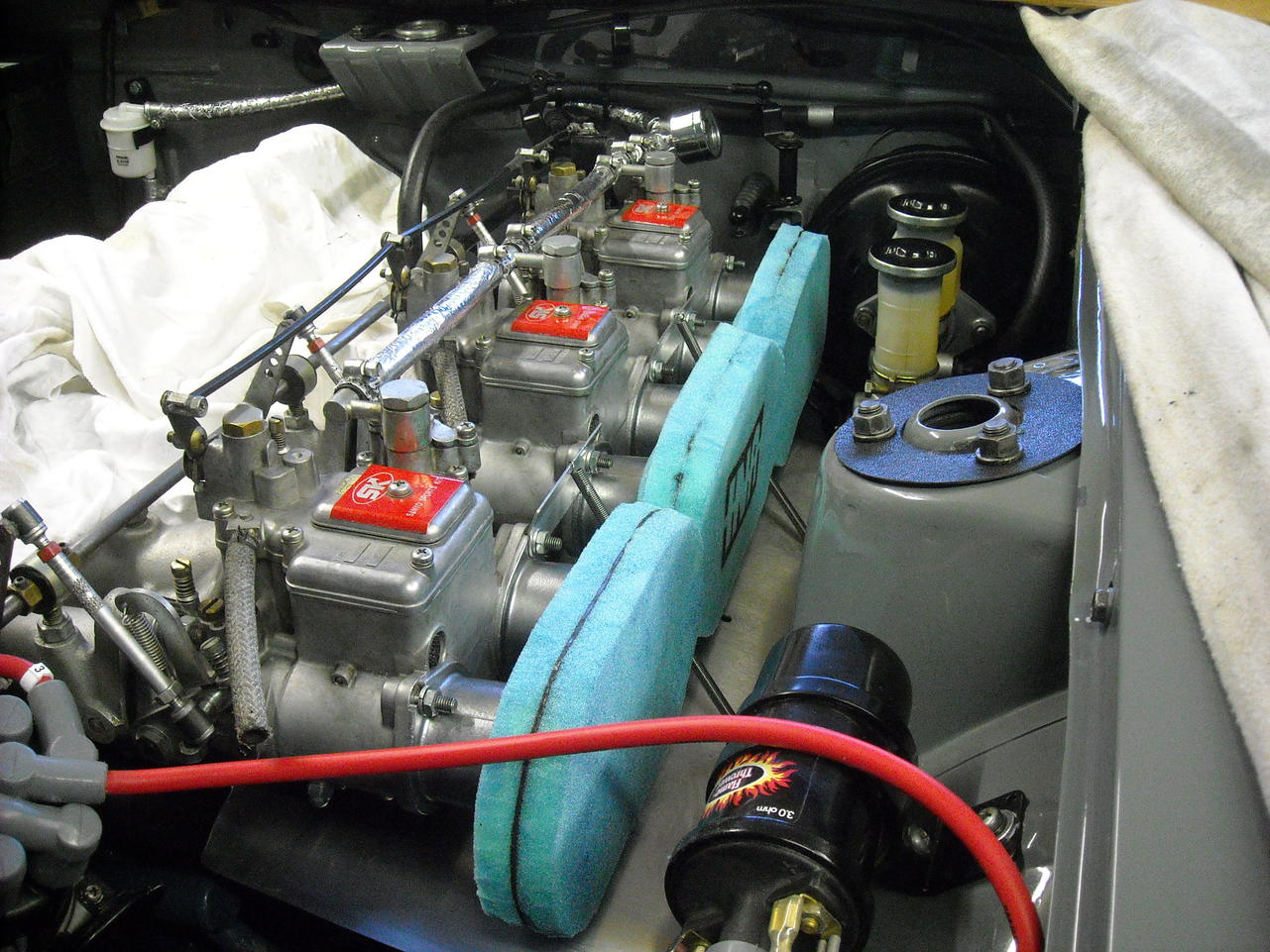

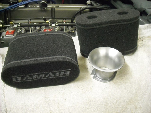

November 27, 201311 yr Author comment_436940 Hey, I'm hoping they are good too, I haven't had a chance to start up the engine with them yet, but they do breathe well. As I said before, I'm going to oil them first regardless of the treatment that Ramair has done. I'm not up on all the new stuff out there but it seems to me that they may have sprayed them with some kind of static spray that attracts dust, oil I knowand oil I trust.Chris Link to comment https://www.classiczcars.com/forums/topic/47931-air-horn-filters/?&page=3#findComment-436940 Share on other sites More sharing options...

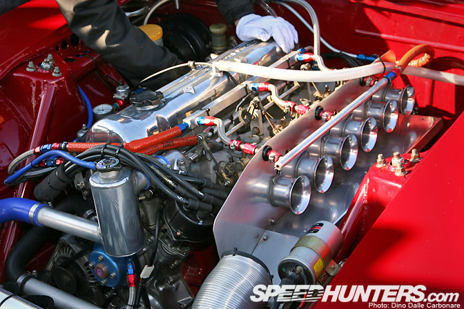

December 5, 201311 yr comment_437428 Here is an interesting twist for cold air - a little stainless steel and a little fab time - could be a thought Link to comment https://www.classiczcars.com/forums/topic/47931-air-horn-filters/?&page=3#findComment-437428 Share on other sites More sharing options...
December 5, 201311 yr comment_437430 The fuel flow (right to left through 3 carbs in parallel) , turbo distributor? and the fixture in front of the thermostat are interesting as well.[ATTACH=CONFIG]68233[/ATTACH]Here is an interesting twist for cold air - a little stainless steel and a little fab time - could be a thought Edited December 5, 201311 yr by Blue Link to comment https://www.classiczcars.com/forums/topic/47931-air-horn-filters/?&page=3#findComment-437430 Share on other sites More sharing options...
December 5, 201311 yr comment_437446 I have had ITG'sThose round metal wire that clip to the opening of the DCOE air hornand Now I run the K&N FilterOne thing to note. There is an opening on the side of the DCOE that allows air into the system to mix with the fuel idle jets and emulsion tubes. That little circle lets in air, and most of the time all of these filters DO NOT filter that air. So you could still be letting dirt into your fuel bowl. After my 1000 mile rally there was DIRT inside my fuel bowl. NOt much, but I feel that little circular opening NEEDS to be covered up. Link to comment https://www.classiczcars.com/forums/topic/47931-air-horn-filters/?&page=3#findComment-437446 Share on other sites More sharing options...
December 5, 201311 yr comment_437452 Excellent point Zedy. In fact, other than the dirt intake issue, the fuel bowl has to be at the SAME pressure as the inlet air going into the air horns. This is why that vent hole is right next to the intake, they are DESIGNED to be in the same air space, ie INSIDE the filter. With rad fan and other "wind"while moving, racing past the exposed vent holes, and the pressure drop inside the filters, the vent and intake air will not be at the same pressure. Now maybe, most of the time, the pressure difference is negligable, but not always.... Link to comment https://www.classiczcars.com/forums/topic/47931-air-horn-filters/?&page=3#findComment-437452 Share on other sites More sharing options...

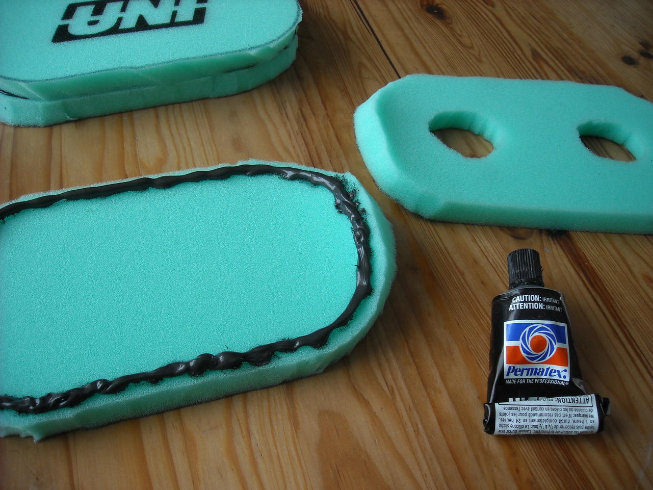

February 25, 201411 yr Author comment_442206 An update. I'm still going to use these filters, but I put together these filters from the UNI foam so I could get them on and off quickly for test and tuning. They might also be good for going to car shows as the Ramair filters are much tighter. Unless...I cut larger holes in the back so they install and remove easier - hmmm, worth thinking about. Link to comment https://www.classiczcars.com/forums/topic/47931-air-horn-filters/?&page=3#findComment-442206 Share on other sites More sharing options...
July 28, 201411 yr comment_452391 Not a bad idea. I like the look of open polished air horns for the Z, but also would never dream of operating like that for long drives. A quick pop off air cleaner would not be a bad idea for the bling factor. Link to comment https://www.classiczcars.com/forums/topic/47931-air-horn-filters/?&page=3#findComment-452391 Share on other sites More sharing options...
