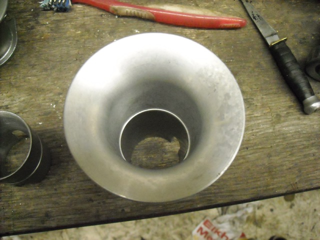

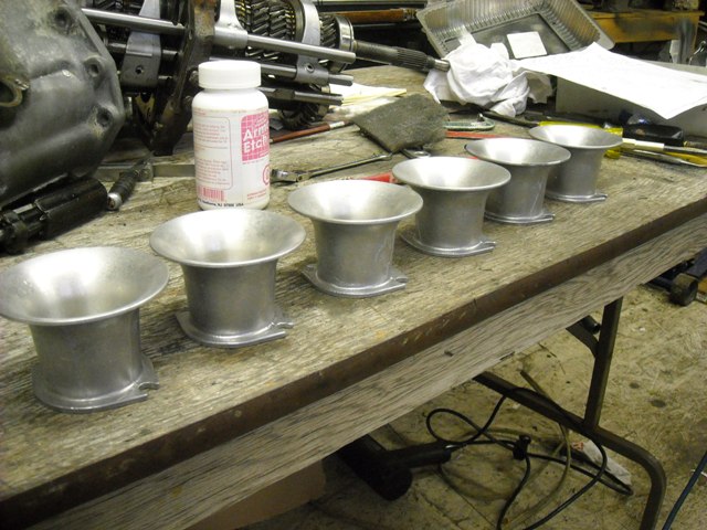

I just lucked into a deal on these air horns,post-26437-1415082650473_thumb.jpg
45mm choke, 57mm tall and 87mm wide at the lip. Big lip, I spent a few hours today hunting through sites that sell air filters for air stacks and haven't found anything.
Wondering if the Z collective (love that term, kinda like the borg collective) has any suggestions, foam socks or stainless steel mesh caps?
Worse case, I could have a few mm cut off the lip so a standard filter would fit but would rather not do that if I don't have to.

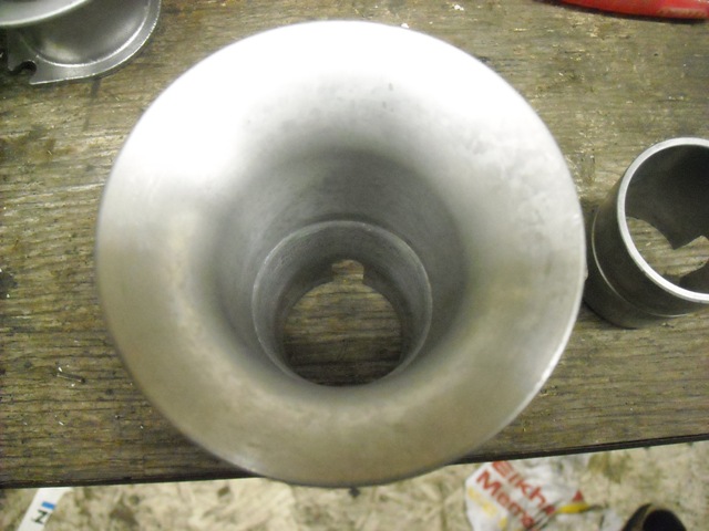

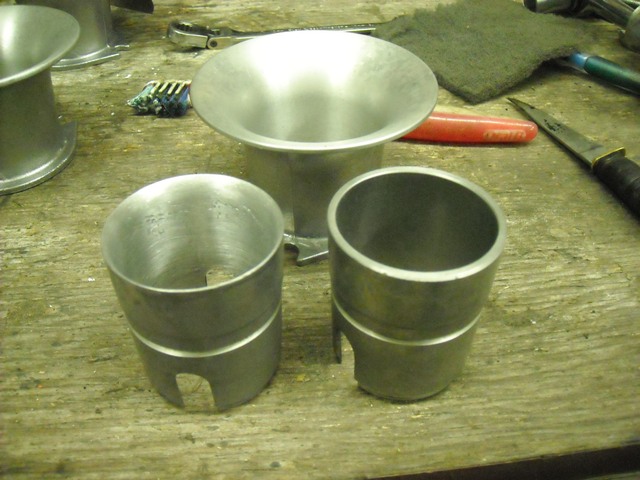

btw how do those 45mm horns mate to the SK's opening. Is there a step?
I would have to find the same kind of foam they use for air filters so that sticky oil would work properly, a good option.
There is about a 1mm lip on the barrel sleeve that needs to come off, a couple of seconds with the dremel and some emery paper and almost a perfect match.

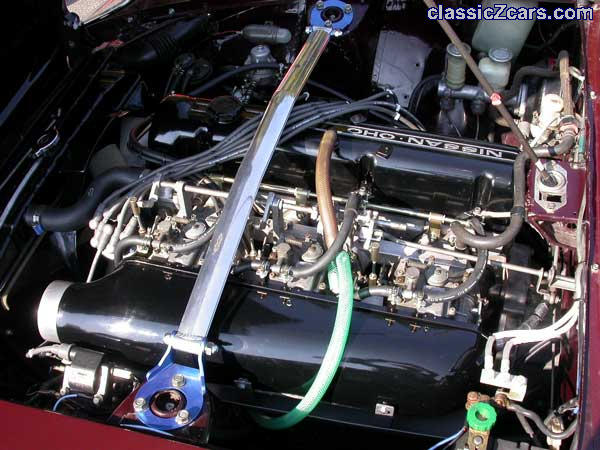

This may be the best route to take - I'm thinking seriously about one. I really like my horns showing, and the air flow around them but the micro dust is not very healthy for my engine.
Air Boxes

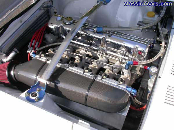

Yeah, I have been looking at those for a while, this is the CAI box I would really like to get,
As far as I can tell these air boxes were made in Japan for their market and NA never got them.
Very slick looking. But in any case I would have to cut down my present air horns so they would fit so I think I'll try and build one out of filter foam first and see how that works before I spent the big money.
