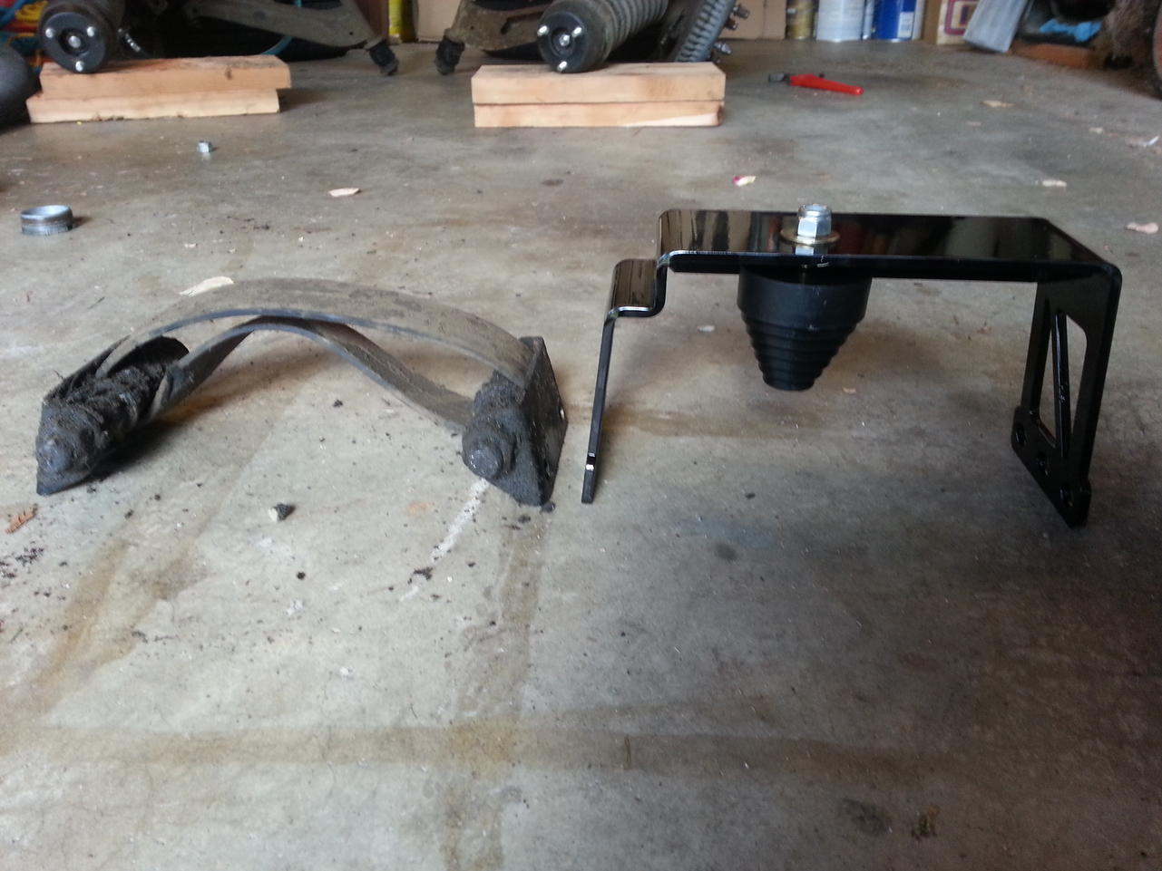

November 19, 201311 yr Author comment_436388 My seals and my rear diff cover came in today. Just waiting on some hardware and we can start zipping this puppy up. ON quick question, do you have to trim the bump stop on the RT mount any? I recall some folks having to shorten it a bit. It would be good to know BEFORE I bolt it in and have the diff suspended over my head. Link to comment https://www.classiczcars.com/forums/topic/47810-starting-a-new-projectsubaru-sti-differential-swap-into-my-z/?&page=8#findComment-436388 Share on other sites More sharing options...

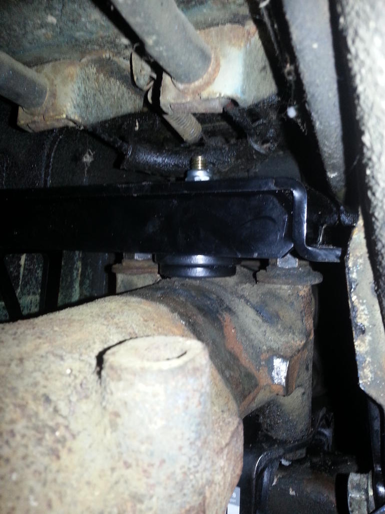

November 19, 201311 yr comment_436392 Yup, 3/4" for an r180, which is three 1/4" steps on the bump stop that was supplied with my mount from TechnoVersions. Pretty easy to do with the bump stop in a vice with a hacksaw. Disclaimer, I forget the nominal height of the bumpstop if you have a different one than I did, I'm pretty sure it's available in at least one thread in this forums. Here's a rusty crusty picture I got of it installed by jamming my phone up into the tunnel when I did mine and a picture of my uncut bump stop before the install (check out the shiny spot on the diff! That's where it was clunking from broken mounts!) Link to comment https://www.classiczcars.com/forums/topic/47810-starting-a-new-projectsubaru-sti-differential-swap-into-my-z/?&page=8#findComment-436392 Share on other sites More sharing options...
November 19, 201311 yr Author comment_436402 That pic is spot on bud, thanks! I will check out the other RT mount threads to get an average, but your picture is what I remember! Link to comment https://www.classiczcars.com/forums/topic/47810-starting-a-new-projectsubaru-sti-differential-swap-into-my-z/?&page=8#findComment-436402 Share on other sites More sharing options...

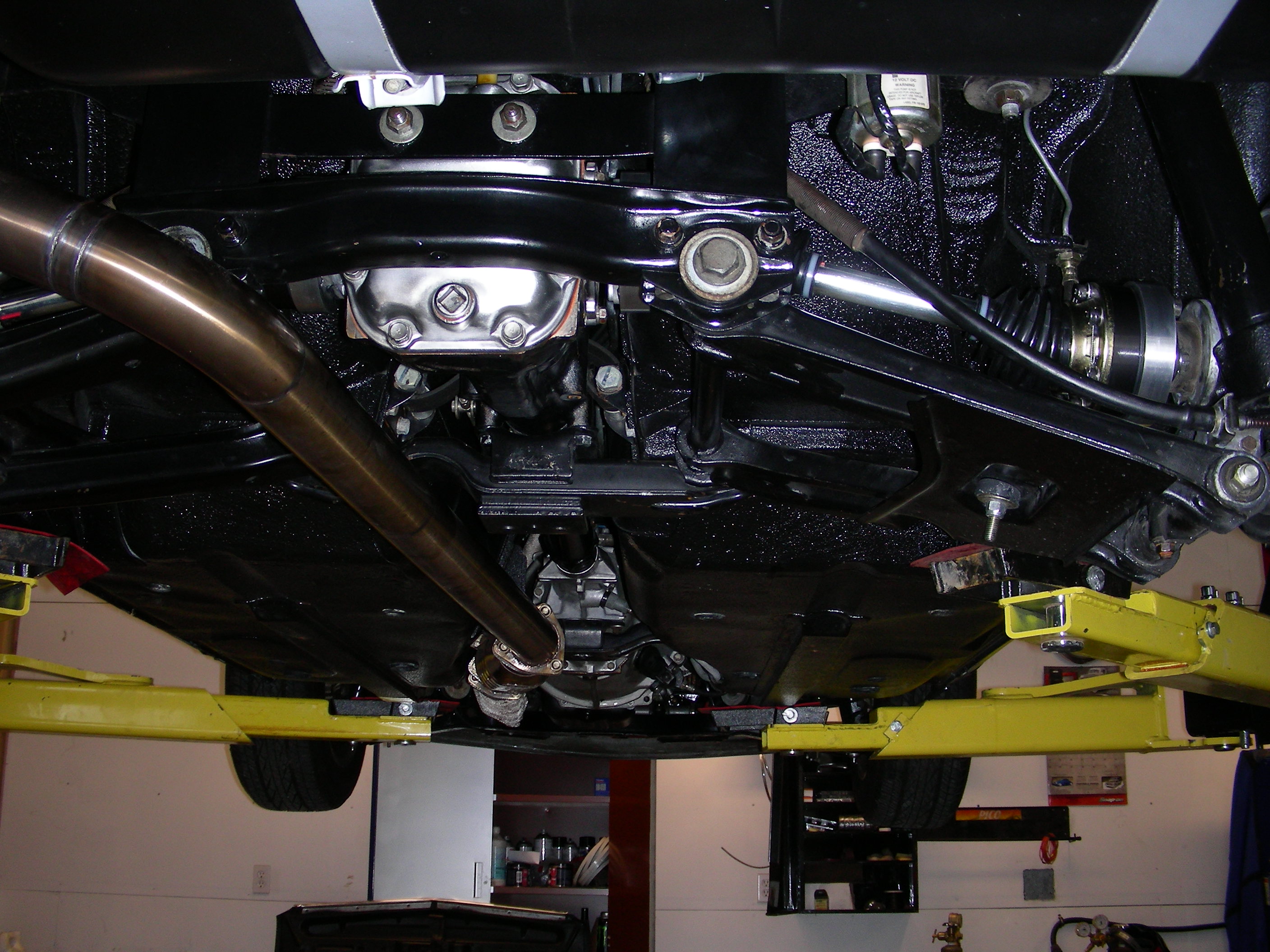

November 19, 201311 yr Author comment_436424 Oh Oh, I am starting to think I leaped before I looked... Looking at this image from wolf creek racing, it would appear that the bar that joins the lower support for the rear A-arms may interfere with my shwanky new diff cover.. in the words of yo semitie sam. RAzzle Frazzle fragget Link to comment https://www.classiczcars.com/forums/topic/47810-starting-a-new-projectsubaru-sti-differential-swap-into-my-z/?&page=8#findComment-436424 Share on other sites More sharing options...
November 19, 201311 yr comment_436427 The diff is the same exact dimensions as the one you took out- you don't need that curved bar. Link to comment https://www.classiczcars.com/forums/topic/47810-starting-a-new-projectsubaru-sti-differential-swap-into-my-z/?&page=8#findComment-436427 Share on other sites More sharing options...
November 19, 201311 yr Author comment_436430 You are saying I do not NEED that curved bar. I would think it would provide some sort of useful stiffening. Or else why would Datsun engineers put it there. I know the diff is identical, but my new Perrin Cover sticks out further than my OEM cover did. It may hit the curved bar in question... This may require some investigation.. I If you get rid of that curved bar, then what holds the bearings? without that bar, the curved sections would be missing. I need to get back under the car again to see what is going on. Edited November 19, 201311 yr by Zedyone_kenobi Link to comment https://www.classiczcars.com/forums/topic/47810-starting-a-new-projectsubaru-sti-differential-swap-into-my-z/?&page=8#findComment-436430 Share on other sites More sharing options...
November 19, 201311 yr comment_436434 Oops - didn't see the previous post and pic Stephen - you might be screwed with that cover. I did the whole r200 LSD thing with the big finned cover and had to make a large Heim joint to connect the LCA's. so either dump the cooler cover and put a stock one on or you have some fabbing to do Link to comment https://www.classiczcars.com/forums/topic/47810-starting-a-new-projectsubaru-sti-differential-swap-into-my-z/?&page=8#findComment-436434 Share on other sites More sharing options...
November 20, 201311 yr Author comment_436442 Well there is always this option Edited November 20, 201311 yr by Zedyone_kenobi Link to comment https://www.classiczcars.com/forums/topic/47810-starting-a-new-projectsubaru-sti-differential-swap-into-my-z/?&page=8#findComment-436442 Share on other sites More sharing options...
November 20, 201311 yr comment_436443 Zedy......The so called curved bar was so that the diff could be moved back in the later Z's to move the half shafts back so they didn't come out at an angle. Your Z is obviously an early 71 with the straight bar and the short driveshaft. While you've got the diff out, you could get the curved bar, longer driveshaft and fix the early angular flaw. Simply install the curved hangar, longer driveshaft, late style diff mount and flip the mustache bar and you're updated. You can get the used parts at a Z wrecking yard. BTW .....installing the R/T mount in the early Z's (your Z) requires mods to the mount for clearance purposes. Edited November 20, 201311 yr by Diseazd Link to comment https://www.classiczcars.com/forums/topic/47810-starting-a-new-projectsubaru-sti-differential-swap-into-my-z/?&page=8#findComment-436443 Share on other sites More sharing options...
November 20, 201311 yr Author comment_436449 That is an interesting thought Guy. But I was under the impression I would need to get different half shafts as well? I may just sell the Perrin Diff and use the stock diff cover and call it a day. Shame, loved the bling. Link to comment https://www.classiczcars.com/forums/topic/47810-starting-a-new-projectsubaru-sti-differential-swap-into-my-z/?&page=8#findComment-436449 Share on other sites More sharing options...
