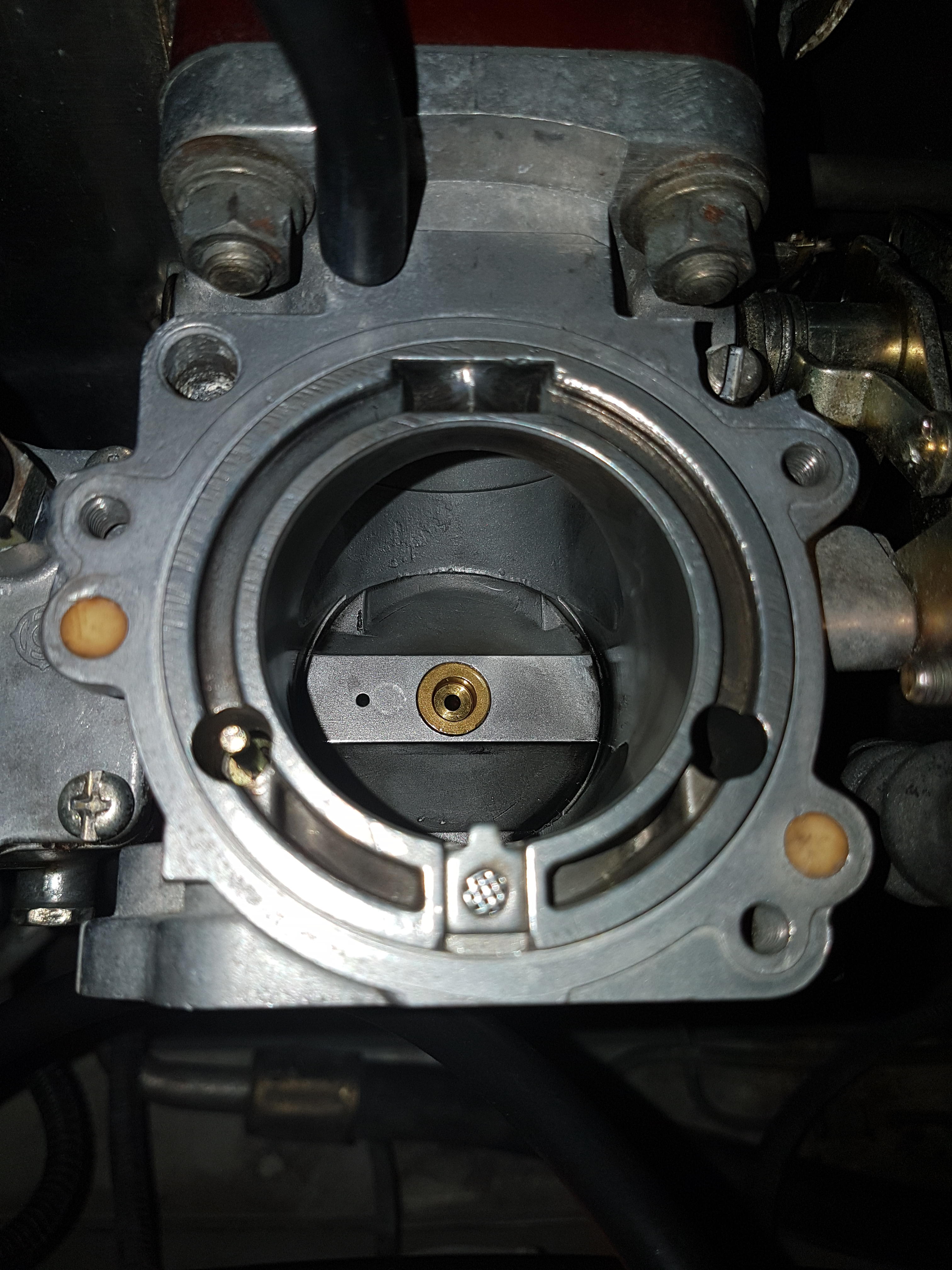

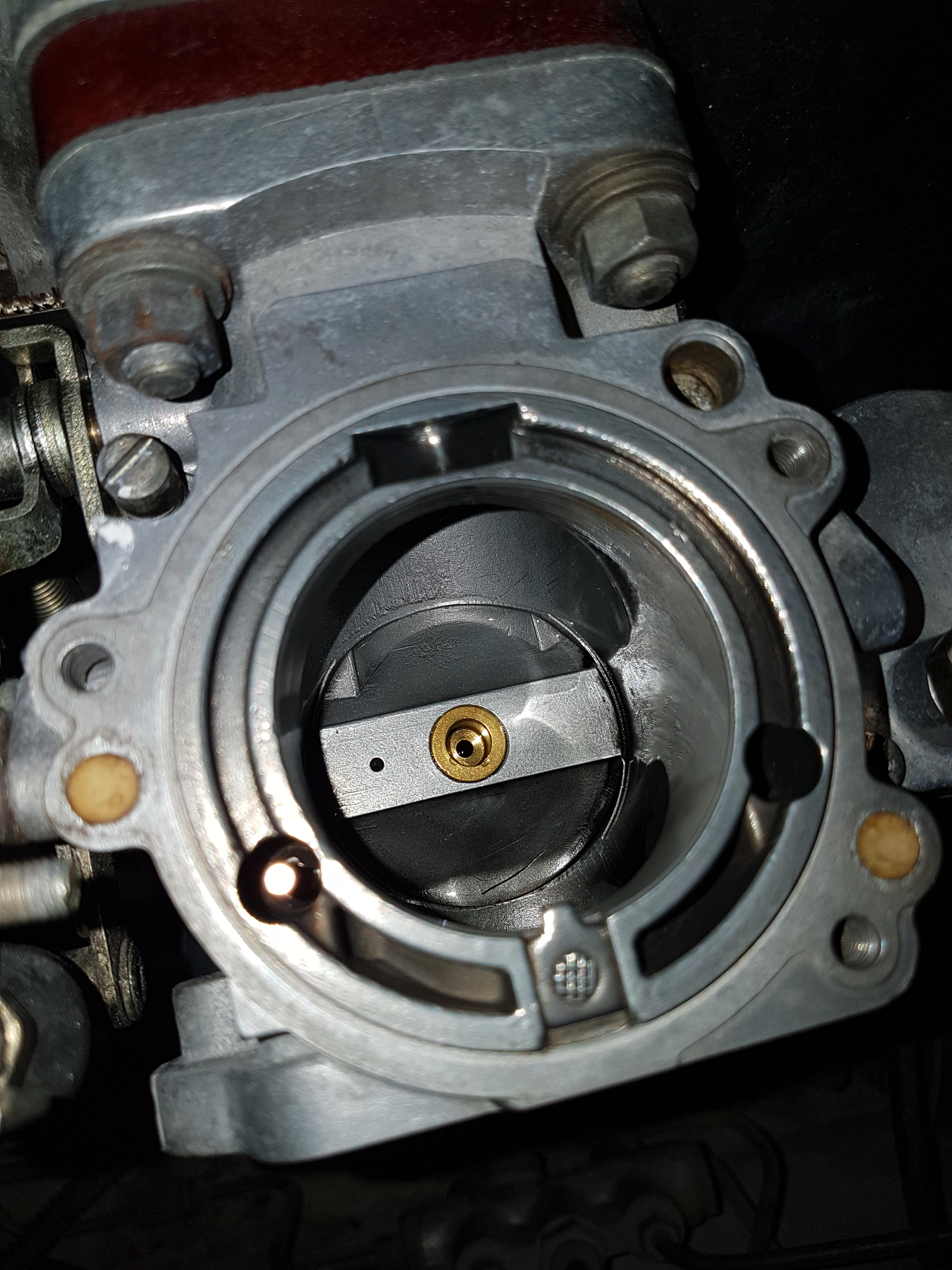

April 6, 20187 yr comment_546766  We want to be sure the fuel level is BELOW the top of the nozzles. No matter where the mixture screws are set. No fuel above the nozzle tops is the goal. The nozzle top is the part with the little hole in it. Pull the domes, pistons and take a look at that little hole in the center of the nozzle. Now pull the choke on and take another look. You'll see that the nozzle has been pulled down. If you couldn't see the fuel level in the little hole before pulling on the choke, you should be able to see it now. While the choke is on (nozzles pulled down), it's a good time to compare the fuel level in both carbs to see if they're the same. Link to comment https://www.classiczcars.com/forums/topic/47304-1972-float-adjustment/?&page=42#findComment-546766 Share on other sites More sharing options...

April 6, 20187 yr comment_546781 5 hours ago, Mark Maras said:  We want to be sure the fuel level is BELOW the top of the nozzles. No matter where the mixture screws are set. No fuel above the nozzle tops is the goal. The nozzle top is the part with the little hole in it. Pull the domes, pistons and take a look at that little hole in the center of the nozzle. Now pull the choke on and take another look. You'll see that the nozzle has been pulled down. If you couldn't see the fuel level in the little hole before pulling on the choke, you should be able to see it now. While the choke is on (nozzles pulled down), it's a good time to compare the fuel level in both carbs to see if they're the same. So i crank up the car with the choke knob fully pulled for 1 minute. Turn off the engine, pull out the domes and pistons and verify fuel level? Link to comment https://www.classiczcars.com/forums/topic/47304-1972-float-adjustment/?&page=42#findComment-546781 Share on other sites More sharing options...
April 6, 20187 yr comment_546789  No need to crank it up.  Pull the tops and pistons being careful not to damage them.  Next, with the choke off, view the fuel level in the nozzle holes. if you can't see the fuel level in the holes, that's OK for now.  Next, pull the choke lever all the way back.  Next, look at the tops of the nozzles again. The nozzles will be down from the previous, no choke position. You should be able to see the fuel levels now. Verify the fuel levels are similar in both carbs.   Link to comment https://www.classiczcars.com/forums/topic/47304-1972-float-adjustment/?&page=42#findComment-546789 Share on other sites More sharing options...
April 7, 20187 yr comment_546792 Be very careful with the pistons!!!!! The needles are brass and bend easily. If you bend one you just about have to replace it to prevent binding Link to comment https://www.classiczcars.com/forums/topic/47304-1972-float-adjustment/?&page=42#findComment-546792 Share on other sites More sharing options...

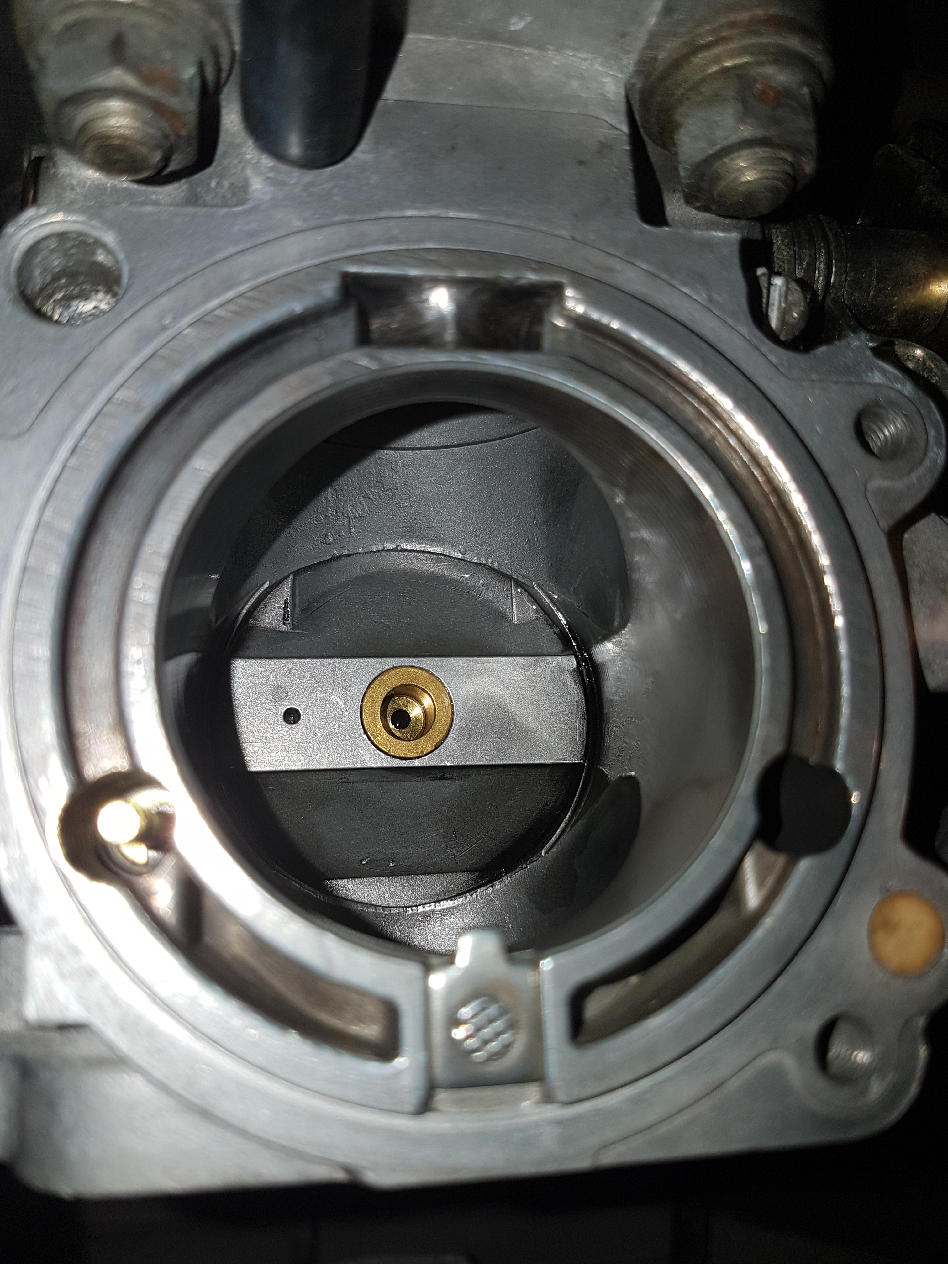

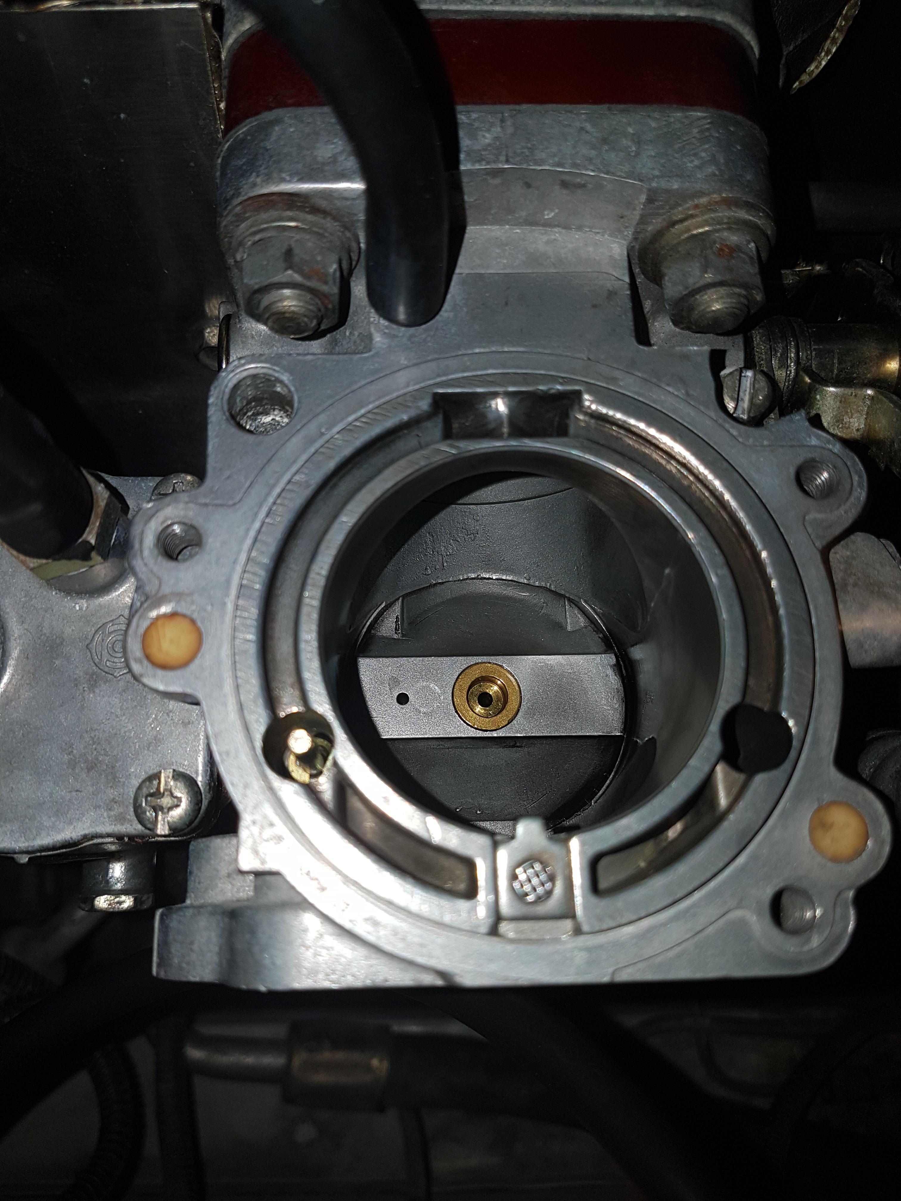

April 7, 20187 yr comment_546794 1 hour ago, Mark Maras said:  No need to crank it up.  Pull the tops and pistons being careful not to damage them.  Next, with the choke off, view the fuel level in the nozzle holes. if you can't see the fuel level in the holes, that's OK for now.  Next, pull the choke lever all the way back.  Next, look at the tops of the nozzles again. The nozzles will be down from the previous, no choke position. You should be able to see the fuel levels now. Verify the fuel levels are similar in both carbs.   Choke off (lever not pulled) front and rear carb. Cant see fuel level on top of nozzle. Link to comment https://www.classiczcars.com/forums/topic/47304-1972-float-adjustment/?&page=42#findComment-546794 Share on other sites More sharing options...

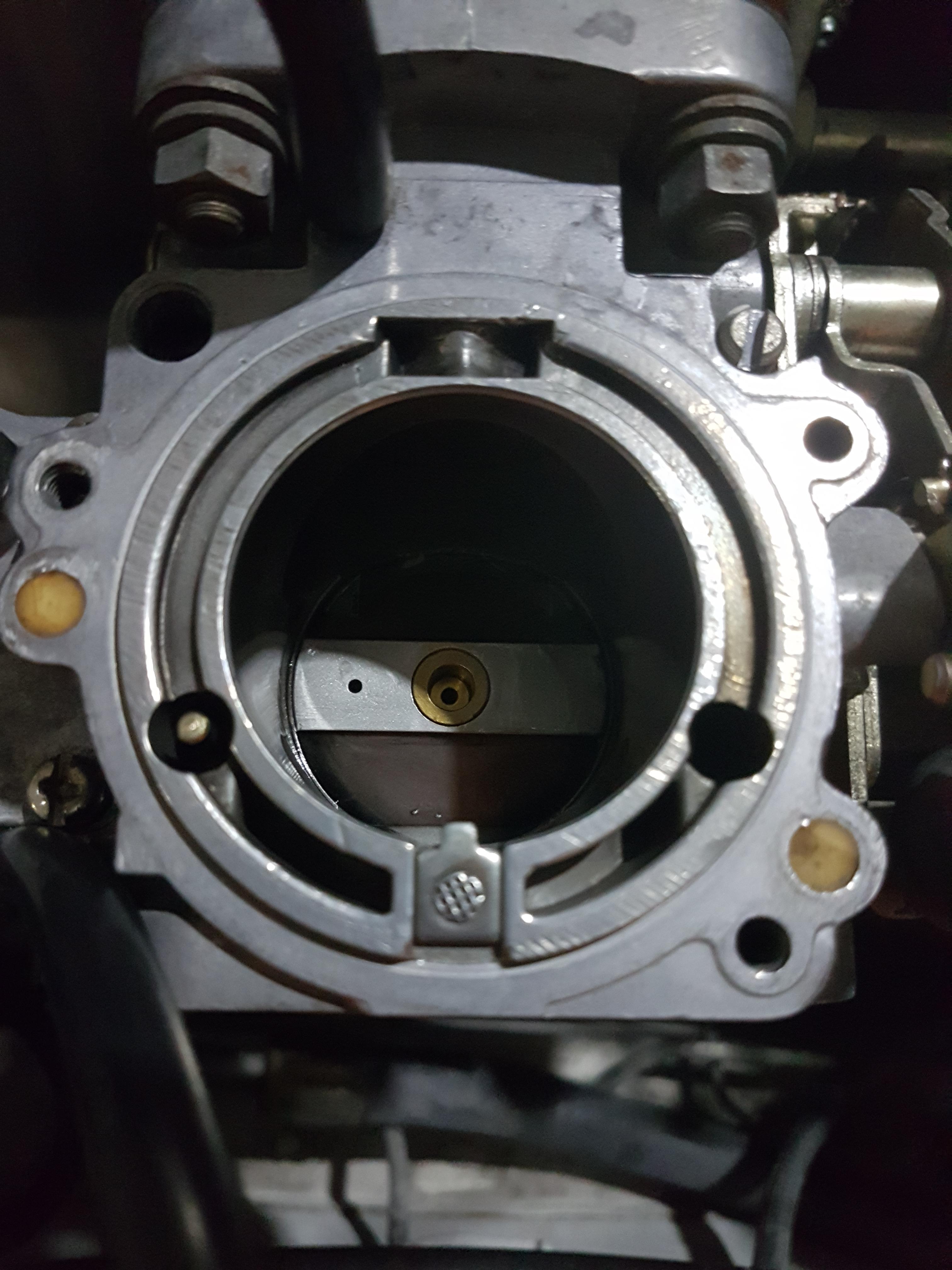

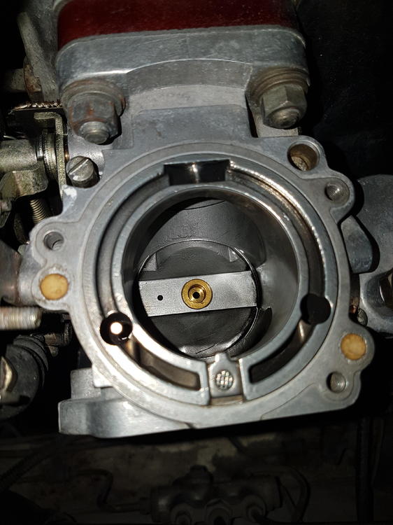

April 7, 20187 yr comment_546795 Choke on (pulled lever all the way back) Link to comment https://www.classiczcars.com/forums/topic/47304-1972-float-adjustment/?&page=42#findComment-546795 Share on other sites More sharing options...
April 7, 20187 yr comment_546797 Shouldn't there be puddling with full choke, Mark? Tick tock, barbershop I hear bells ringing!  I prefer cherry jelly. Edited April 7, 20187 yr by siteunseen Link to comment https://www.classiczcars.com/forums/topic/47304-1972-float-adjustment/?&page=42#findComment-546797 Share on other sites More sharing options...
April 7, 20187 yr comment_546799 No puddling dude with choke all the way back! Both carbs dialed at 3.70 turns clockwise and full choke on Edited April 7, 20187 yr by jalexquijano Link to comment https://www.classiczcars.com/forums/topic/47304-1972-float-adjustment/?&page=42#findComment-546799 Share on other sites More sharing options...
April 7, 20187 yr comment_546804  @jalexquijano Good pics. I think I see a pinpoint of light reflection in the nozzle holes. I assume that pin point of light is the surface of the fuel. Can you confirm that and that both levels are approximately the same? Also, is it possible for you to determine the distance from the top of the brass ring that holds the nozzle to the current fuel level? Or, how far below the nozzle holes is the fuel? Either approximation will work. Link to comment https://www.classiczcars.com/forums/topic/47304-1972-float-adjustment/?&page=42#findComment-546804 Share on other sites More sharing options...

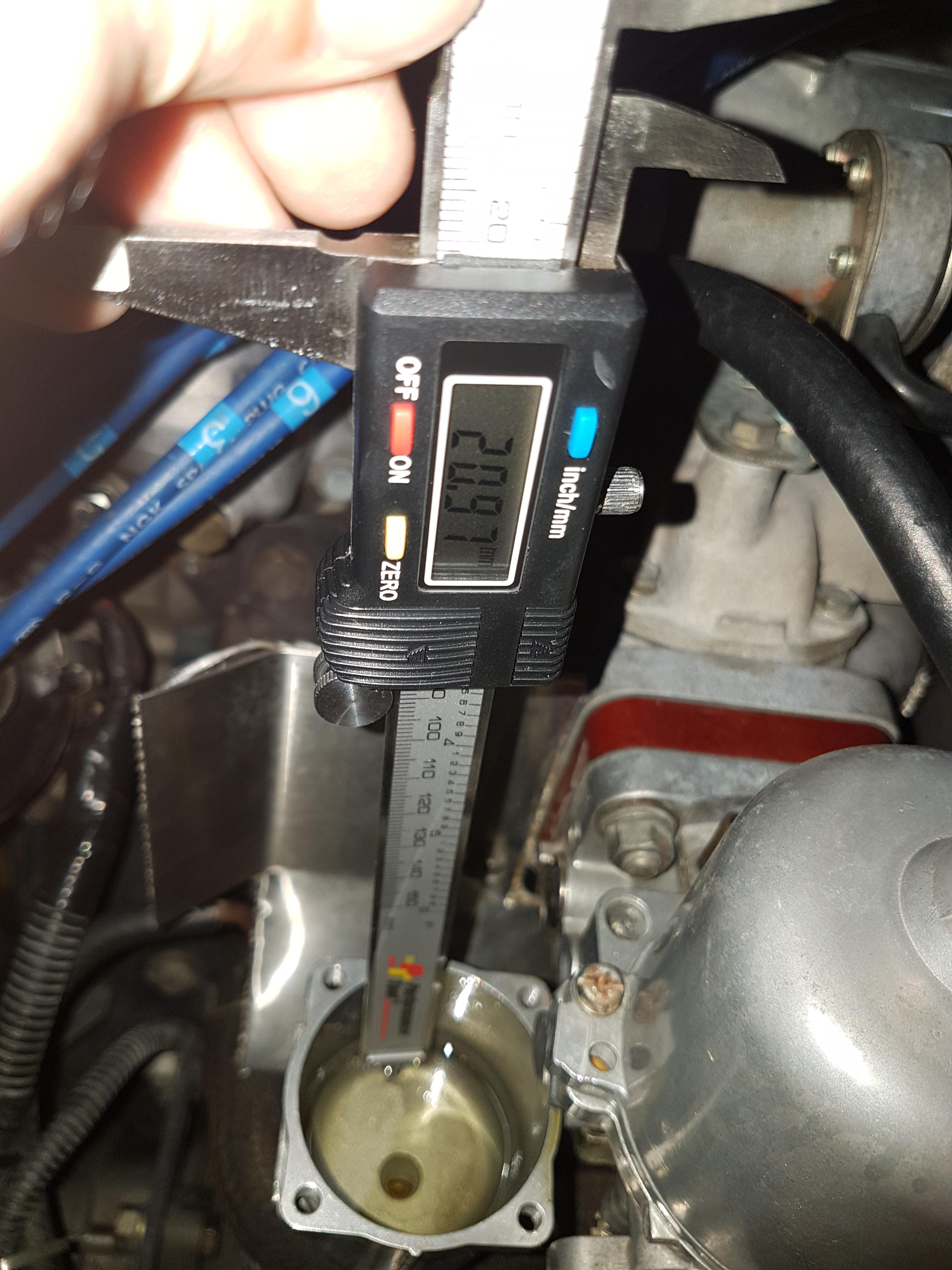

April 7, 20187 yr comment_546805 I can try and measure it with this tool. Dont know if it will fit in that small hole. Link to comment https://www.classiczcars.com/forums/topic/47304-1972-float-adjustment/?&page=42#findComment-546805 Share on other sites More sharing options...
