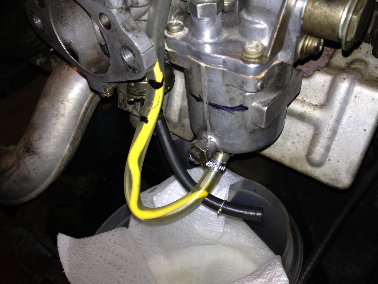

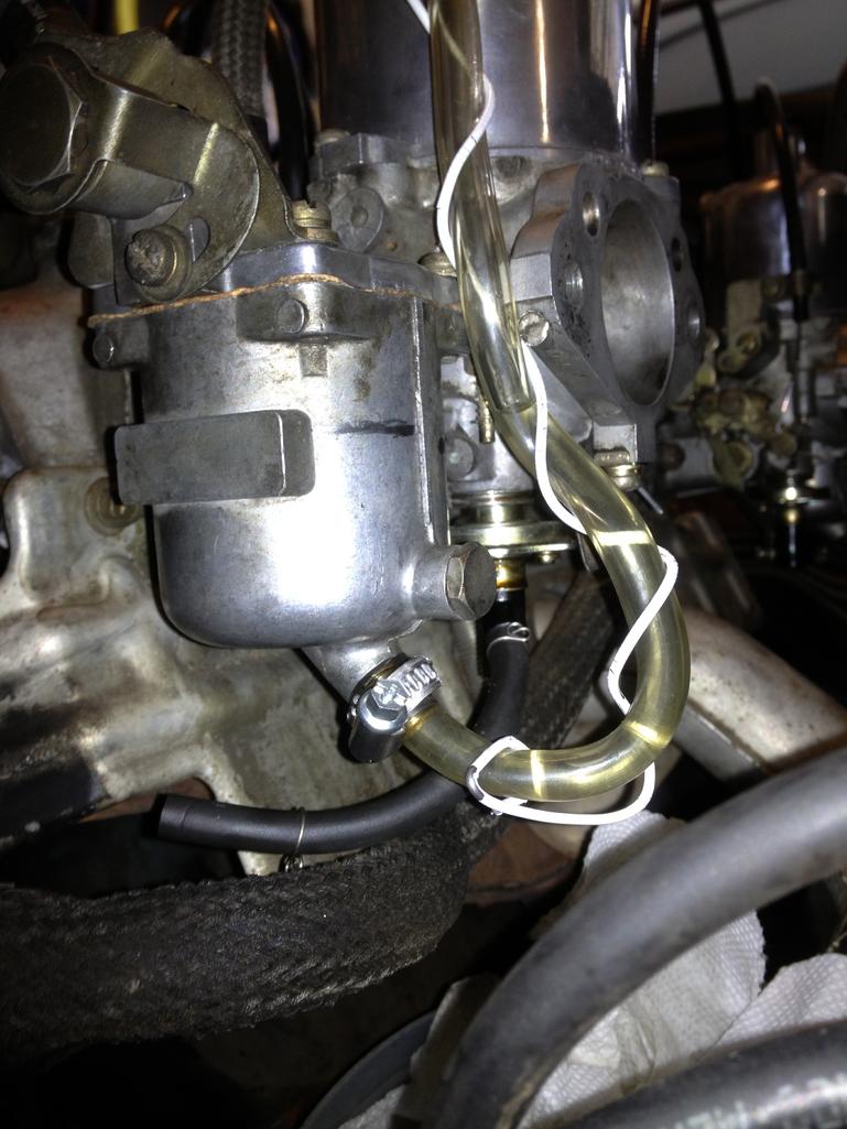

May 29, 201312 yr Author comment_424381 Here are two early designs that I played with to give you an idea... Link to comment https://www.classiczcars.com/forums/topic/46649-su-sightglasses-available-see-fuel-bowl-levels/?&page=2#findComment-424381 Share on other sites More sharing options...

May 29, 201312 yr comment_424389 Dave:Well DUH on me. I get the fluid level in both sides of the U tube part, it was the "just where are you hooking it up" part that eluded me. There are 3 nipples on an SU bowl of course not two, I neglected the one on the bottom as connection point for your site tube. Thanks for the clarification. This does remove the issue with some bowls not having the drain plug. I like it!Blue, the idea of a permanent site glass right in the side of the bowl! Now that's brilliant! Nice simple 1/4 NPT. The glass center seems to be about 3/8 in diameter, ~ 10 mm which is plenty to see the level. Just make sure it doesn't protrude too far into the bowl and interfere with the float. Install it on the engine side of the bowls or on the ends, so you still have a chance to see the level with the air cleaner in place. Edited May 29, 201312 yr by zKars Link to comment https://www.classiczcars.com/forums/topic/46649-su-sightglasses-available-see-fuel-bowl-levels/?&page=2#findComment-424389 Share on other sites More sharing options...

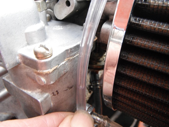

May 30, 201312 yr comment_424408 Here's mine, from ztherapy: It works ok but I'm thinking maybe install a permanent one, maybe one of these:McMaster-Carr Happy reading ! Also, I got some new float bowl gaskets and stuck them to the bowl with the blue stuff on the bowl side. They're doing fine and I had to remove the reinstall the lids on both carbs about 10 times to get them more or less right. It would help to have an adjuster screw or something on the tang on the float to make it easier to adjust, but at least once they're set they should stay that way, unless the needle valves get bad or the fuel pressure changes. Link to comment https://www.classiczcars.com/forums/topic/46649-su-sightglasses-available-see-fuel-bowl-levels/?&page=2#findComment-424408 Share on other sites More sharing options...
