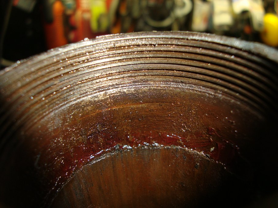

After some digging I found one of the gland nuts I took off the car. The threads were in perfect shape and I cleaned it up really good before attempting to use it. I took a big c-clamp and pressed the the ends that were pushed out back together. It acutally helps as the gland nut would now sit nicely on top of the tube and no rock back and forth. It would now screw in about 2 threads and then require my wrench to turn it. It got progressively harder to the point there were still 4-5 threads showing and I could not turn it anymore. Upon closer inspection it appears a PO cross threaded the tube at one point. The threads are flattened and it just does not appear its going to be usable. Once the the new gland nut arrived from KYB I am going to take the tube and gland nut to a machine shop to get their advice on it. In the mean time I may need to start shopping for a new strut tube/hub assembly. A disappointing end to an other wise productive day.

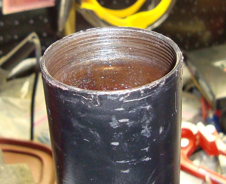

I took a pick with a 90 degree tip on it and cleaned out the threads really good. When I ran the pick around it did not get caught on anything. I did not compare the threads or pay a lot of attention to them when I pulled everything apart. Now, all I seem to do is stare at them. Below are some pics of what they look like. Hopefully the new gland nut from KYB will come in tomorrow.

The threads look useable, but if the tube is out of round it will be tough. Have you used a big washer or something to drop into the tube so you can see if it is out of round and where it's out of round?
You might need something better than a c-clamp to pinch it back in shape. You need something that clamps with a radius like curved-jawed- vise grips or something. My vise actually has a curved section under the jaws for gripping round objects.
Maybe take some calipers and measure the tube to see if/where it's out of round? Can you press down on the nut while you thread it on?

About the out of round strut tube... How did you hold the strut assy when you loosened the gland nut to take it off? If you clamped the tube in a vise up near the nut, you may have ovalized the tube in the vise?
And if it is oval, you could use your new hydraulic press to squeeze it round again. :bulb: Would be a lot more controllable than a C-clamp.
The top of the strut tube is ovaled. Squeezing with a clamp of any kind probably won't help much. You have to work the oval out. Tale a 14mm x 60mm x 1.5P bolt, clamp the bolt head in some big vice grips, put on some thick leather gloves, lay the threads iof the bolt n the threads at the top of the strut tube, and hit the side of the bolt with a hammer. You want to push the bent in part of the strut tube out. Work the bolt around the strut tube and don't try to fix the bend with one smack. If you heat the top of the tube with a torch it makes this easier.
And ALWAYS, ALWAYS, put a gland nut in the top of any strut tube. Keep your old ones for just that purpose.
