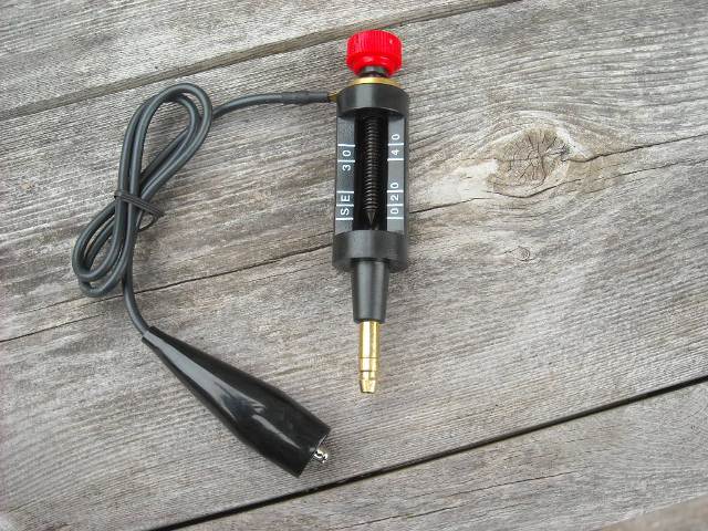

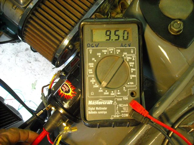

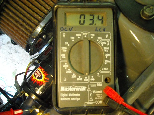

April 29, 201312 yr Author comment_421941 If you have an ohmmeter, measure resistance from the positive terminal to the negative terminal and then from the center post to the negative terminal and post the results. SteveJ, I just noticed this post, sorry. So, with the ignition key on I'm getting 12.20v between the pos side of the coil and true ground. With the multimeter set on the 200 scale of ohms I get 3.4 measuring between the neg and pos terminals of the coil and the reading is the same with ignition key on or off. With the multimeter set on the 20k scale of ohms I get 9.50 measuring between the neg terminal and the centre post of the coil and the reading is the same with ignition key on or off. I used those scales because they gave the best results. I just p/u this spark plug tester today from NAPA and it has no instructions of any kind. It looks pretty straight forward but I'll hunt through youtube first to see some how to vids before I use it, Link to comment https://www.classiczcars.com/forums/topic/46324-engine-will-only-run-above-4000-rpm-carbs-or-timing/?&page=4#findComment-421941 Share on other sites More sharing options...
April 29, 201312 yr Author comment_421948 Just tried the spark plug tester on every plug with about and 1/4 of an inch between the fixed point and the screw in point, it looked like a decent spark with a bit of blue as it starts then yellow to white as it reaches the other side.Just did it again, and I'm not seeing the white and yellow so much but more blue with some violet and orange. I haven't tried screwing the point farther out than 1/4", and I would say that all of the sparks are pretty consistent looking compared to one another. Edited April 29, 201312 yr by grannyknot Link to comment https://www.classiczcars.com/forums/topic/46324-engine-will-only-run-above-4000-rpm-carbs-or-timing/?&page=4#findComment-421948 Share on other sites More sharing options...
